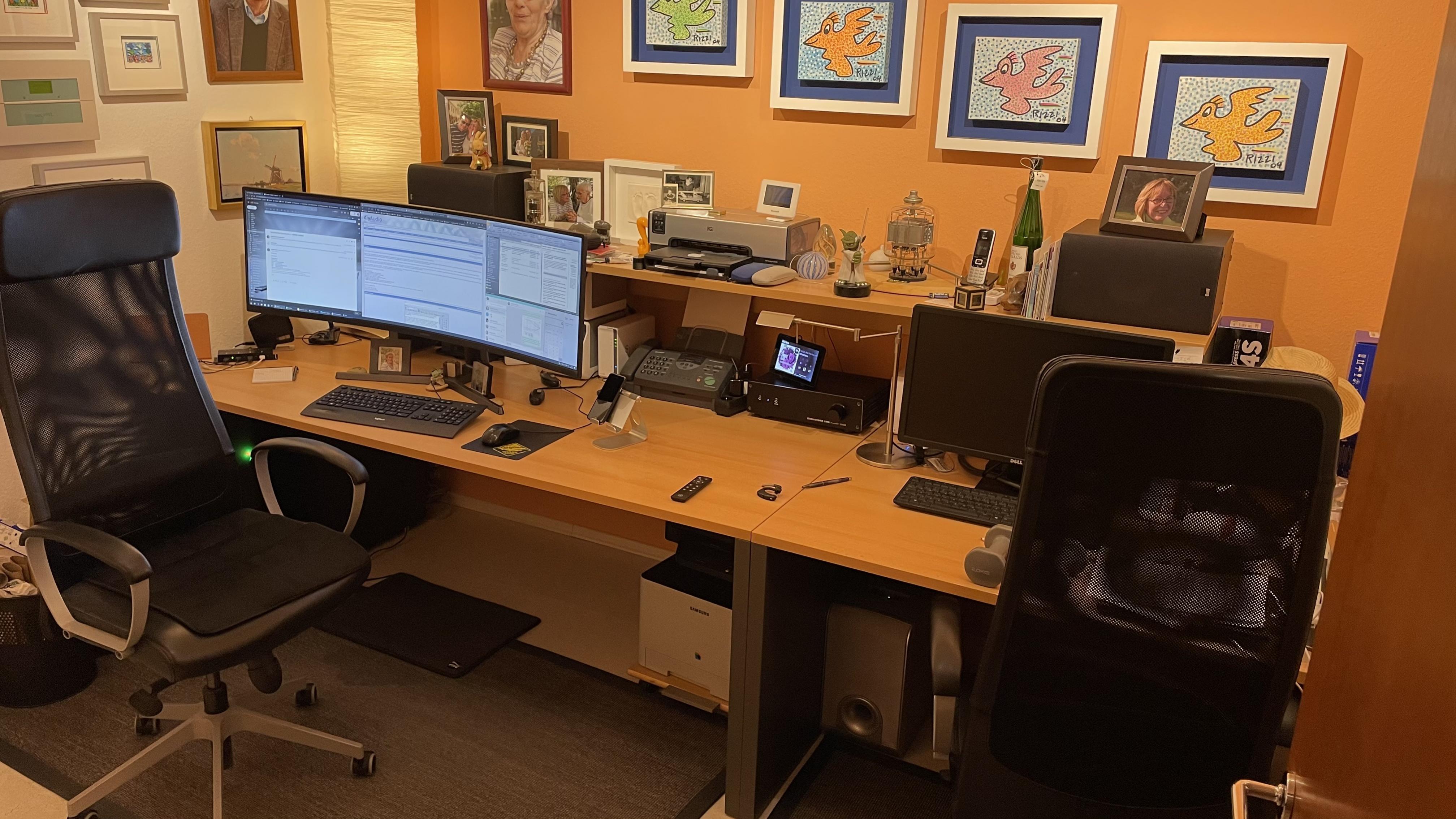

Hard to give recommendations where to start and for all where to STOP, when making a second (or third) DDDAC. It is all about expectation management.
Never forget, the original DAC with RED Mainboard, non tweaked 12V supply and one original DECK, driven by the WaveIO (even at USB Power) with a good quality coupling capacitor (Like an Auricap or something) already sounded very good. The character of the DAC (Analog and natural sound) was always there. All the tweaks and improvements after that are 200% worth it, but... it is all expectation management...
You want the best possible - well Yuri made very valid comments. Yes all the tweaks covered over the years also. Extreme care on power supplies, multiple Decks (we have seen up to 15) super clocks, output transformers, UltraCaps etc etc. (Nice hobby right?)
You "just" want have a use for your old "Crap" Boards lying around? Just would like to have some nice music in the attic, living room, work shop, home office? I would not over engineer it and just take the basic stuff you have lying around and at least take a half way decent power supply for the 12 Volt (not a wall socket thing used for charging your whatever) - Only thing I would do is use a good coupling capacitor.
So, as I am writing this, I am in my "Office" - Of course I like some music playing here. I am enjoying it 100% - but compared to my equipment down in the "man cave" it is relative normal and still very enjoyable but MUCH nicer sound than coming straight from my PC sound card or even a PI with a DAC hat. You do NOT need expensive High End for that to beat that 😉
so what it is I have (so you have a reference what I am talking about)
My "Power DAC":
USB in with WaveIO, USB powered
Red Board with one old deck (no tweaks)
7812 kind of 12V "home brew" power supply
balanced output through a 24 step switched attenuator
2x Hypex UCD 180 power amp
2x B&W 685 book shelf speakers (that is indeed where they are)
1x B&W Subwoofer AS1 active subwoofer (100€ in eBay)
Except for the 685 speakers, all that stuff I had lying around or bought used and cheap in eBay. Also this way the hobby makes fun and produces a satisfying result 🙂
Just my 2 cents worth....
and here is a busy picture where you can find (you have to look good...) the equipment I use there 😀
My "Power DAC":
