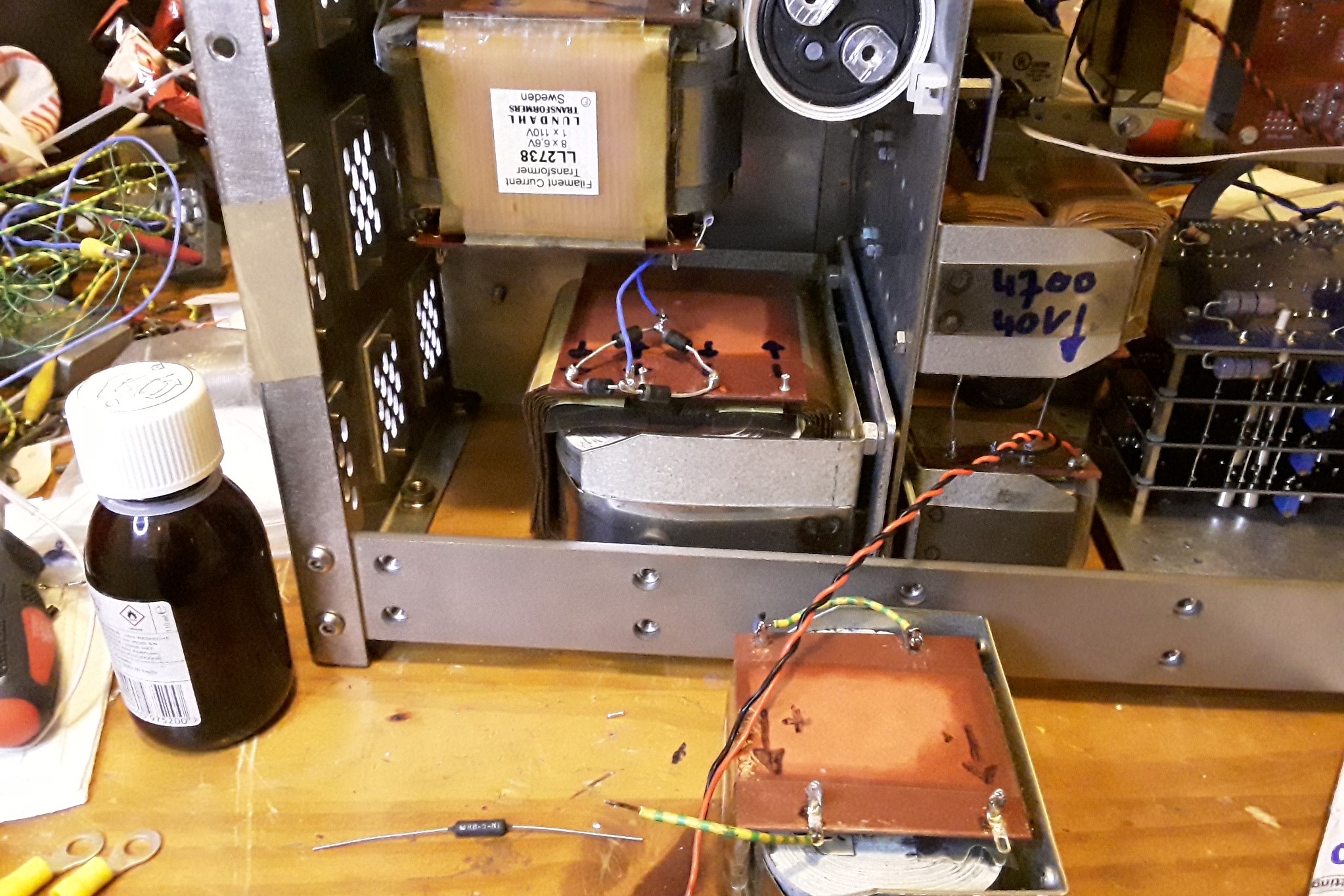

I did do some changes in the 12 volt power supply. I mean i dont use the 12 volt supply as designed by Doede but use a LCLC to create around 12,5 volts to be connected to the mainboard like other have done in this thread. It is surely more expensive. For those afraid to use a choke the expensive supply designed by Audio creative uses a choke too.
I am using a Lundahl heater power supply because it has multiple secundary windings that i needed because i wanted to adjust the AC voltage going into the SBYV28 diodes.
The last two years i have been using split bobbin transformers like the Triad FP30-1600 which is 30 volts 1,6A. If you use the LL2771 ( 3000mH 1A) for choke input you will get a substantial voltage drop because each coil of this choke is 5,6 ohm DCR. This Triad cost around 15 euro, With choke input NO NEED to get a 3A transformer because the choke will keep the current at 1A all the time.
Depending what you will use after the first choke and of course the load presented by the circuit itself you can also get an FP transformer with eg 24 volts.

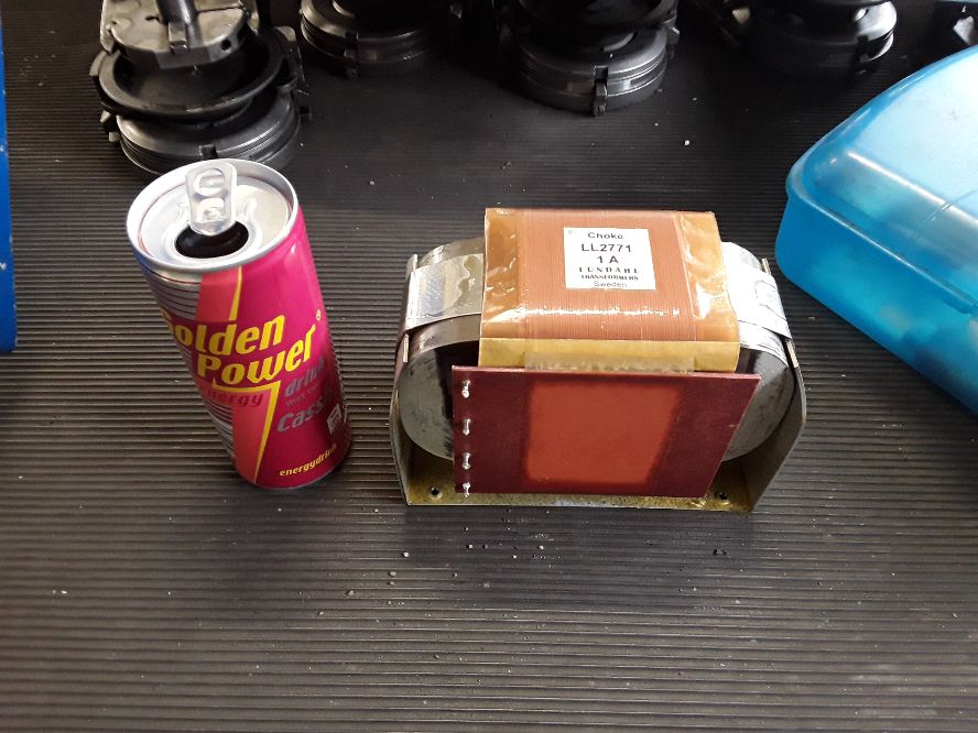

The inductance remains the same if you connect the choke in common mode connection. Lundahl told me that it should be better and some users confirmed this. It is rather easy to test it. I never tested it.
A famous audio technician in my country told me to only use this technique for the first choke. I dont remember why and i am almost sure that he never tried it actually. He can probably explain why not to do so BUT you just have to try.
With the Lundahl chokes you MUST take care how you connect them. It doesnt matter which of the two '' coils '' is on which '' side '' of the power supply.
The small one is the LL2733 and the big one is the LL2771

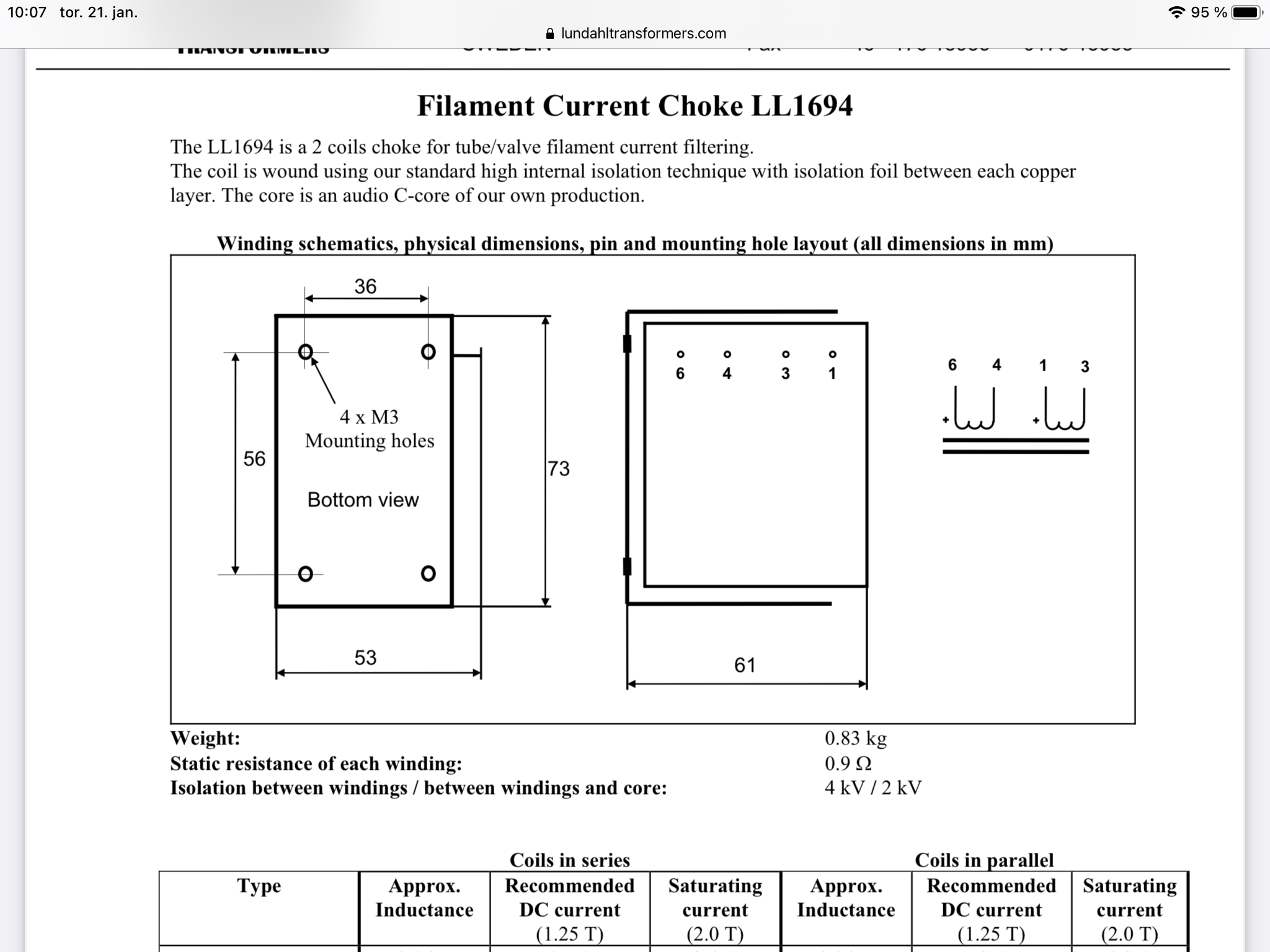

Inspired by Doede. I installed one Lundahl 1694 choke on each 5v psu’s, which is feeding two 5v Ultra capacitor boards connected in series to get 10v for dddac mainboard with 4 dac boards.
Hi smooth dancer, I'm wondering if the Lundahl choke is connected correctly. I cannot see it good on the picture, but it seems to me that you have connected the pins 3 and 4!? This should lead to a parallel connection!?? Not sure if I'm right...

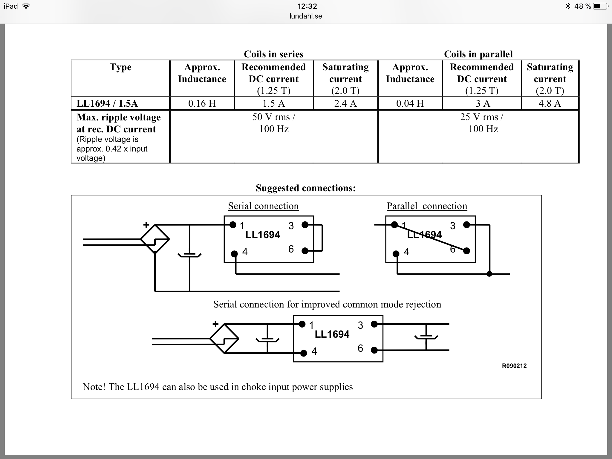

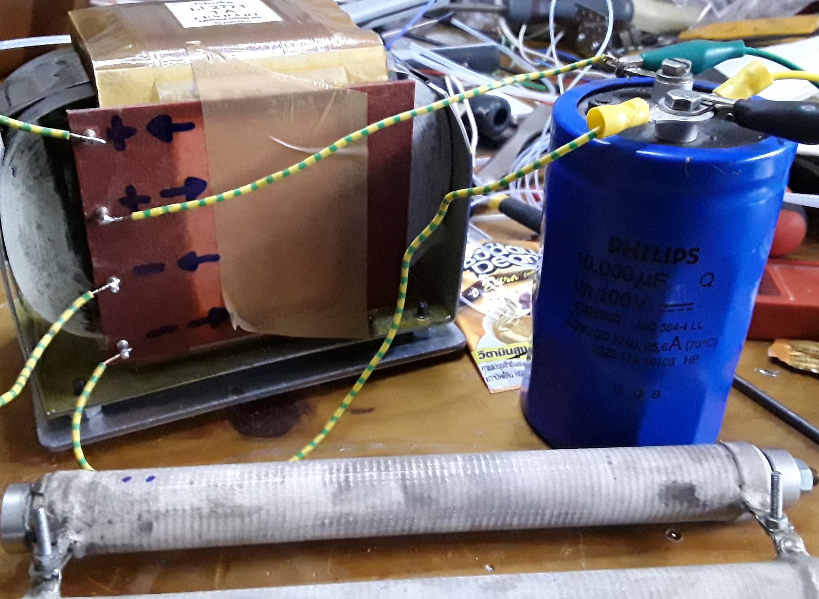

Hello,
It is not very clear but there have been more people who ended up with Lundahl chokes connected the wrong. SO they dont have a CLC but CRC supply
There is only one way to put the two '' parts ''in series.
There is only one way to put the two parts in parallel
When using the '' special series connection '', number 3 in the Lundahl PDF just take a look at my picture with the BIG power resistor a few days ago. It does not matter which part of the choke is on the + or the - side. Just take care of the arrows indicating the input wire coming from the preceding element in the filter ( in my case the diodes) and the cap after the choke.
I have connected Lundahl chokes a dozens of times really and it is easy to do it wrong both in series and in parallel connection. Usually i will just use a marker. Sometimes the numbers in the pdf are a bit confusing.
Smoothdancer picture looks like connection 3 and 4 are linked which is a good '' start '' for parallel connection. What makes it confusing is the two red wires. I think the big power resistor is the bleeder resistor needed for choke input. OR is it in series with the choke?
I would put a bleeder right at the cap after the input choke.

P.s i asked Per Lundahl himself you cannot you one '' half '' of a choke for one 5 volt supply and the the other half for another supply. BOTH halves must get the same '' input '' to make them work like a team so to say.
Hi, you are right. Parallel it is if I understand the pic from Lundahl correctly.

Lundahls in parallel is only 0.04H, in series 0.16H, so series is better for more Henry, and better filtering, I guess.
I don’t want to change the stock trafo’s for now, so It will be either choke in series, with a bleeder after the choke. If this doesn’t work, then parallel is the only way with stock transformers, to avoid the voltage dropping.

Yesterday I removed R2 from the standard PSU and replaced it with Lundahl 1694 choke in series mode. This is really a step forward. Normally I give new setups some time because I'm not always sure if my brains fools me and lets me hear what I want to hear ;-). But this time it is clear and I'm quite sure that the choke will stay in the PSU...
Maybe I'll replace the cap after the choke (C3) with a bigger C the next days to see if there is another improvement.
