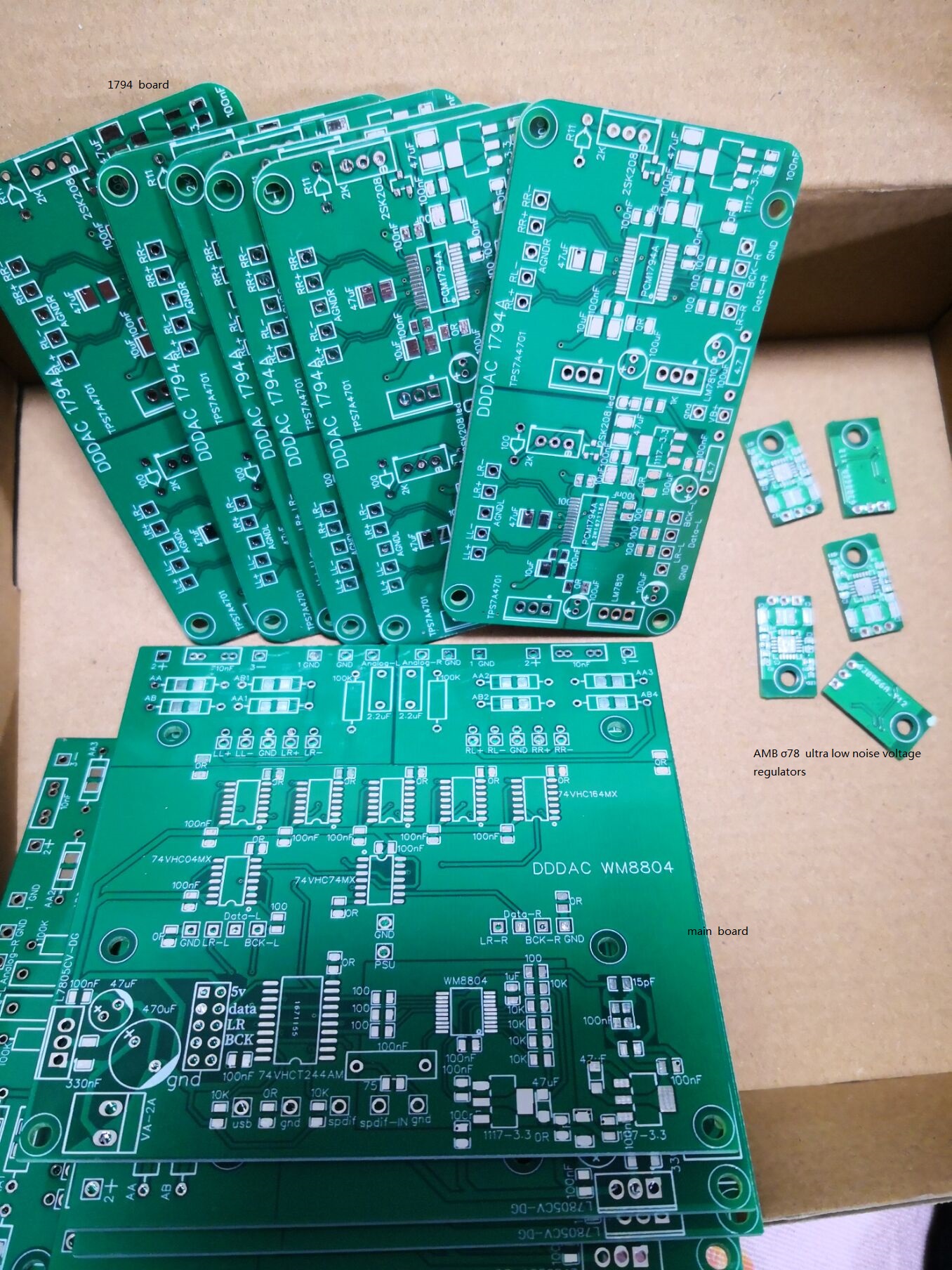

@dddac I am a middle-aged technical Chinese cabbage. Draw your own PCB according to the schematic (dddac1794pbt_nos_ver51.pdf) provided by you. As I read more, I have a question to ask the original poster. How to realize PCM1794 mono I/V conversion (without transformer version). Thank you very much! (I am not an electronic distributor, I am purely self-playing. Of course, I do not rule out selling redundant boards online. I only sell spare parts instead of finished boards. I will contact you for the sale)Thank you!
What you do privately is fine - I allow that explicitly : "For DIY only"
by selling these boards you would be infringing my IP and copyright and I WILL take appropriate action.
This is quite bold what you state (not ruling out selling the boards) also posting it on my thread....
If see you are clever enough to draw your own boards, I am sure you can read datasheets and find out for your self what the answer to your question is
I have no interest in helping people who are stabbing my back and then ask for further support?
YES this pisses me off 😡 (and that is the first time in my many years on DIY forum....)

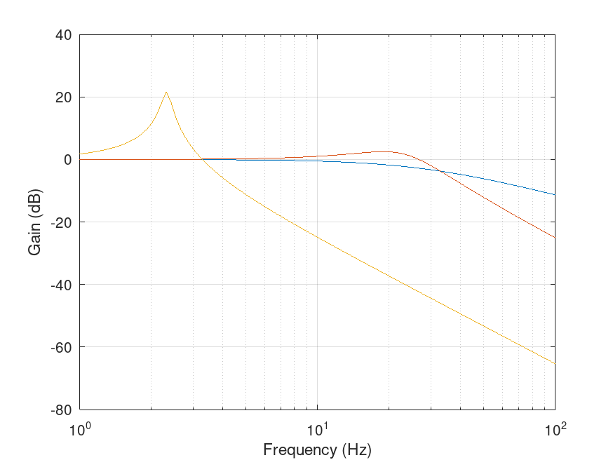

Hi Doede
Sorry, yet another question on your blog post regarding the chokes...
Looking at your TINA model plot with the filter gain functions for different choke values (10 mH, 1 H, 0 mH), both the 10 mH and 1 H curves show a little peak (ringing), and the peaks are about the same amplitude (about +2 dB). In the description of the plot you wrote that both curves were calculated using the same DC resistance, and the text does not say anything about the capacitance values, so I guess you also used the same C values. If so, the 1 H curve should have MUCH more ringing, i.e., the peak should be a lot higher (see my curves in the attachment for L = 0, 10 mH and 1 H with R = 1.2 Ohm and second C = 4700 uF). So I wonder what's actually in your plot. Can you shine some light on this?
To increase the attenuation of the filter, I believe it would be better to increase the value of the second cap rather than the choke.

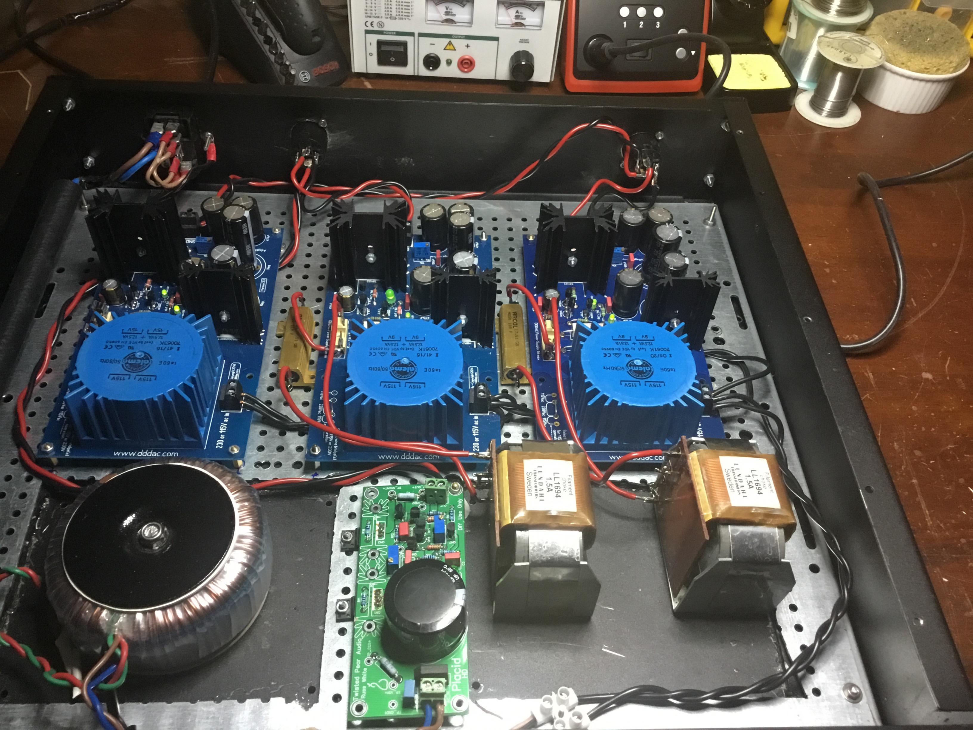

And... you can't just leave us hanging like that... 😛Inspired by Doede. I installed one Lundahl 1694 choke on each 5v psu’s, which is feeding two 5v Ultra capacitor boards connected in series to get 10v for dddac mainboard with 4 dac boards.
After the pic been taken, I replaced the two 4700uf caps with two 10000uf Mundorf Mlytic caps. I don’t have any instrument to measure the psu’s, but I like what I hear.
The Lundahl chokes have two coils and I wired them in series. Each coil have 0.9 ohm static resistance, and 0.16H (series).
