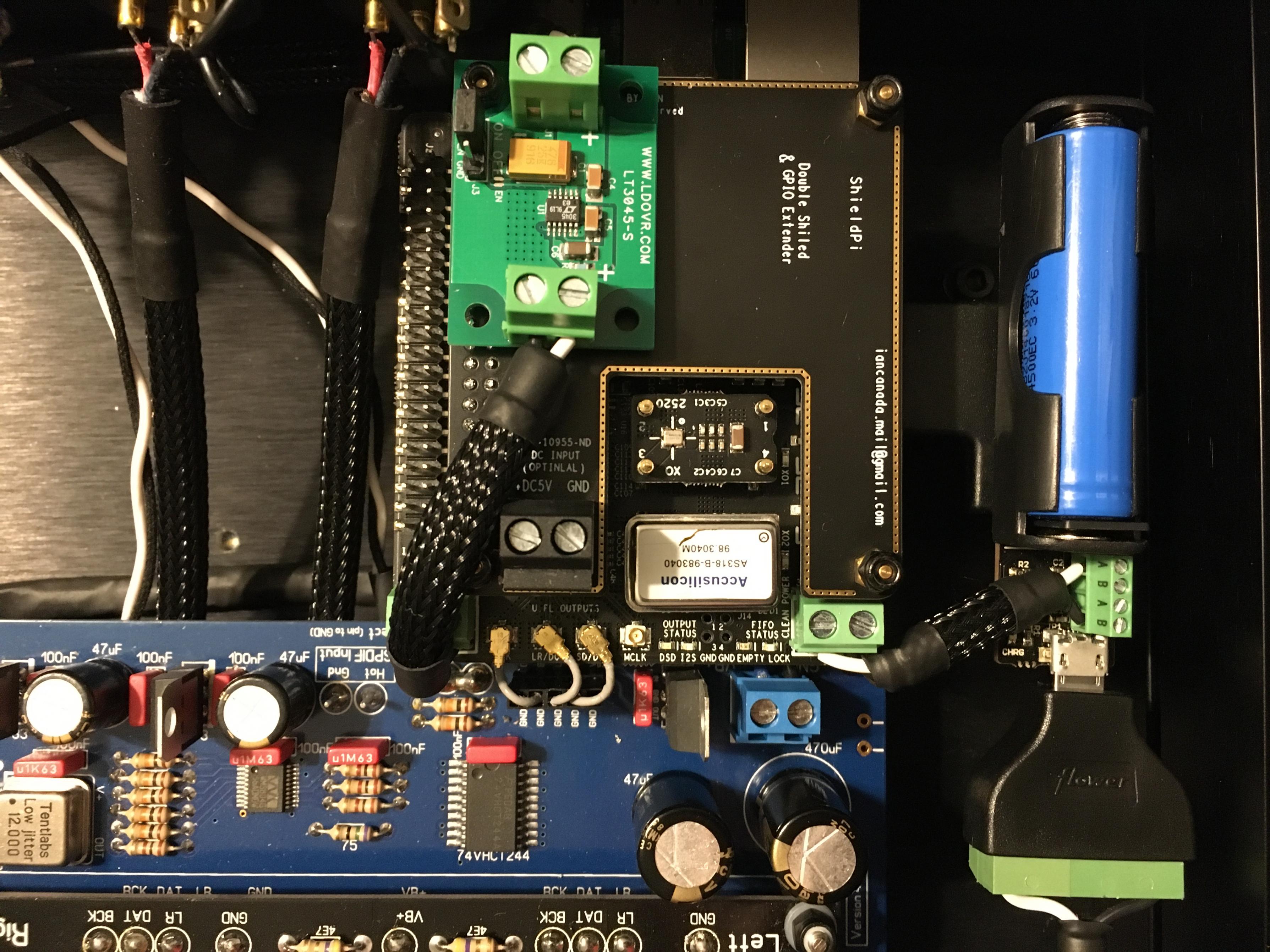

Hello all, thanks so much for all the great info on this thread, so much to learn! I recently switched from WaveIO to RPI/FiFoPi and am having a problem when I test it with my amp. The RPI/FiFoPi appears to be functioning fine (lights up properly when data stream starts) and worked without issue with a DAC hat I have. I installed with the DDDAC and when I power on I get very loud popping in the speakers to the point of sounding damaging. I’ve checked my connections (DATA>SD/DI | LRC>LR/DO | BCK>SCK) to the DDDAC and it looks fine. Any suggestions on what might be the issue? I am connecting to my amp via XLR as I was previously with the WaveIO, which worked fine. RCA is not currently connected, so am only able to test XLR right now (can hook up if need be). Thanks! -Per

Do you have a ground connection between fifo and dddac? In the picture it looks like you only connected the hot middle wire of the u.fl connector/cable (they are coaxial and also have a “signal ground”)

Thanks for the reply Hifoli. Do you mean double check that the u.fl connectors are fully seated? I did detach them last night to double check the connections from u.fl to pin connector, so will double check that they are fully seated. I made a connector based on what the AudioCreative guys are doing, so it is just u.fl to DDDAC I2S pin for the 3 connections. Oh and I do like tidy connections, thanks!!
Update - Thanks Hifoli, I believe I have soldered the connector incorrectly, so will separate out the signal ground and retest. I will report back with what I find.

no it means there need to be 4th wire going from FiFoPi to the DAC just connect both Grounds. I see all GND pins on the 10 pole connector are still free, so that is most likely the issue?

Thanks Hifoli and Doede, I had the shield connected to the pin and that caused just a terrible noise. I am remaking the connector and will report back. Sleep deprivation from a 2 year old can cause poor decisions sometimes 🙂

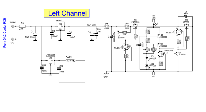

Since this is a diy community and modding is part of the spirit, would anyone be upset if I replace the Tent shunt with Salas UBiB and present my findings (V.4.4.b) once I get up and running with the unit and potentially ask for help if that is needed ?

It will be in the same position as the Tent, see image. A quick mock-up.Sure, be our guest! At which position are you putting this Salas regulator ?
I am using the Salas UBiB in other projects that I am working on, so wanted to try or use this shuntreg in the dac as well 🙂
This Salas UBiB is adapted to some BJT's I have laying around.
