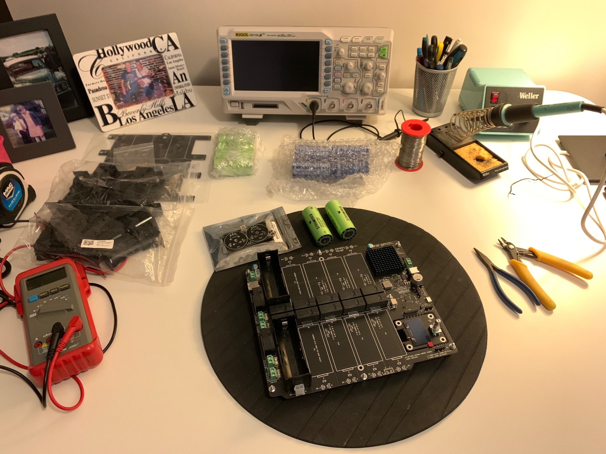

So the next phase of my DDDAC journey begins! Further PSU improvements 😀
Nice Simon, would you publish a small sketch how your going to hook up things?

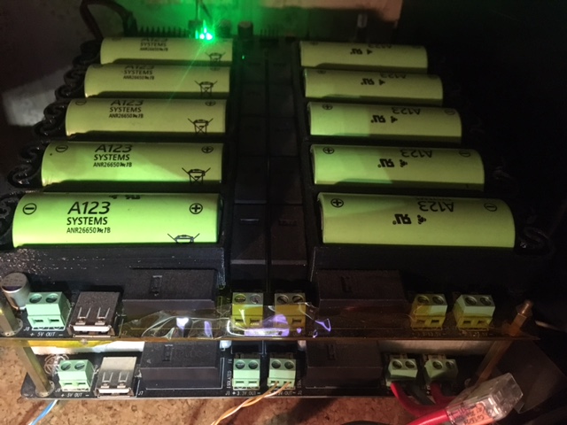

It's a very good PSU for DDDAC, especially if two rails are paralleled, but I advise to use it with caution, especially in a test environment.
If your batteries somehow discharge below their critical level, an internal short can occur. I experienced this with DDDAC and this PSU. After that, I tested two A123 batteries under controlled circumstances. They do not tend to explode, but they heat to about 220-250 degrees, also they produce smoke and hot electrolyte will leak to the board. In my point of view, several actions needed to made this configuration with DDDAC safe:
1. board is completely covered by heat-resistant varnish (did it).
2. board is completely covered by high temp polyimide foil (did it)
3. battery holders are made of high temp plastic, not ABS (I printed them on my 3D printer, filament -- PC).
4. thermal sensor is placed on the top of each battery (bought all parts, not completed yet).
5. required turn-off time is carefully measured.

Thank you for the tips.
Do you power the Dac with your psu? I won’t be doing that and plan to power only the FiFoPi and Andres clock which are all low power
I just need 3.3 and 13 for my needs which is good
Let’s see how I get on and thanks for the tips

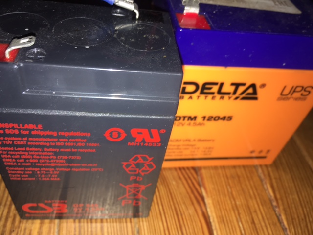

A decade ago i was using a big battery with a so called intelligent charger.
It was switched on/off from time to time. I didnt install anything to check the voltage.
(Now with the DDAC i have an old fashioned panelmeter that shows the dc voltage going towards the 12 volt input terminal on the mainboard)
I thought that the intelligent charger would automatically start charger when the voltage has gone below a certain level. After some years and not using the device being fed by the batteries i noticed a sound that was kind of mediocre. I checked the voltage on the two 12 volts batteries connected in series and it was to low. The batteries also had a kind of slightly bulging appearance.
I called the dealer and they were kind of reconditioned.
How did it go wrong?
Well. the charger i was using would only react to a to low voltage after being disconnected from the batteries for a second or so.
So for a circuit taking some current like a 4 board DDAC one will need to make it kind of foolproof.
