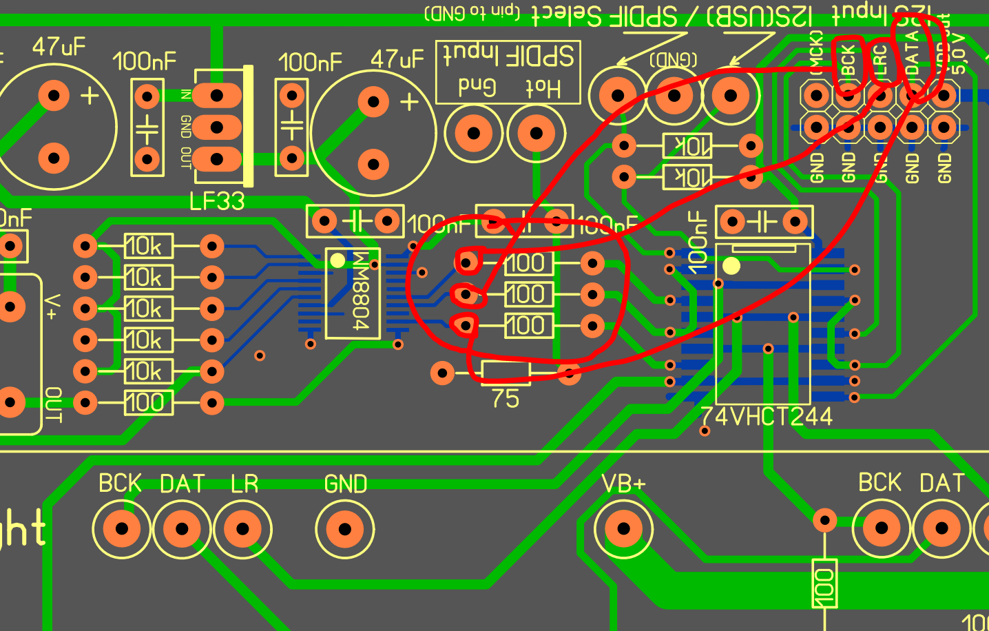

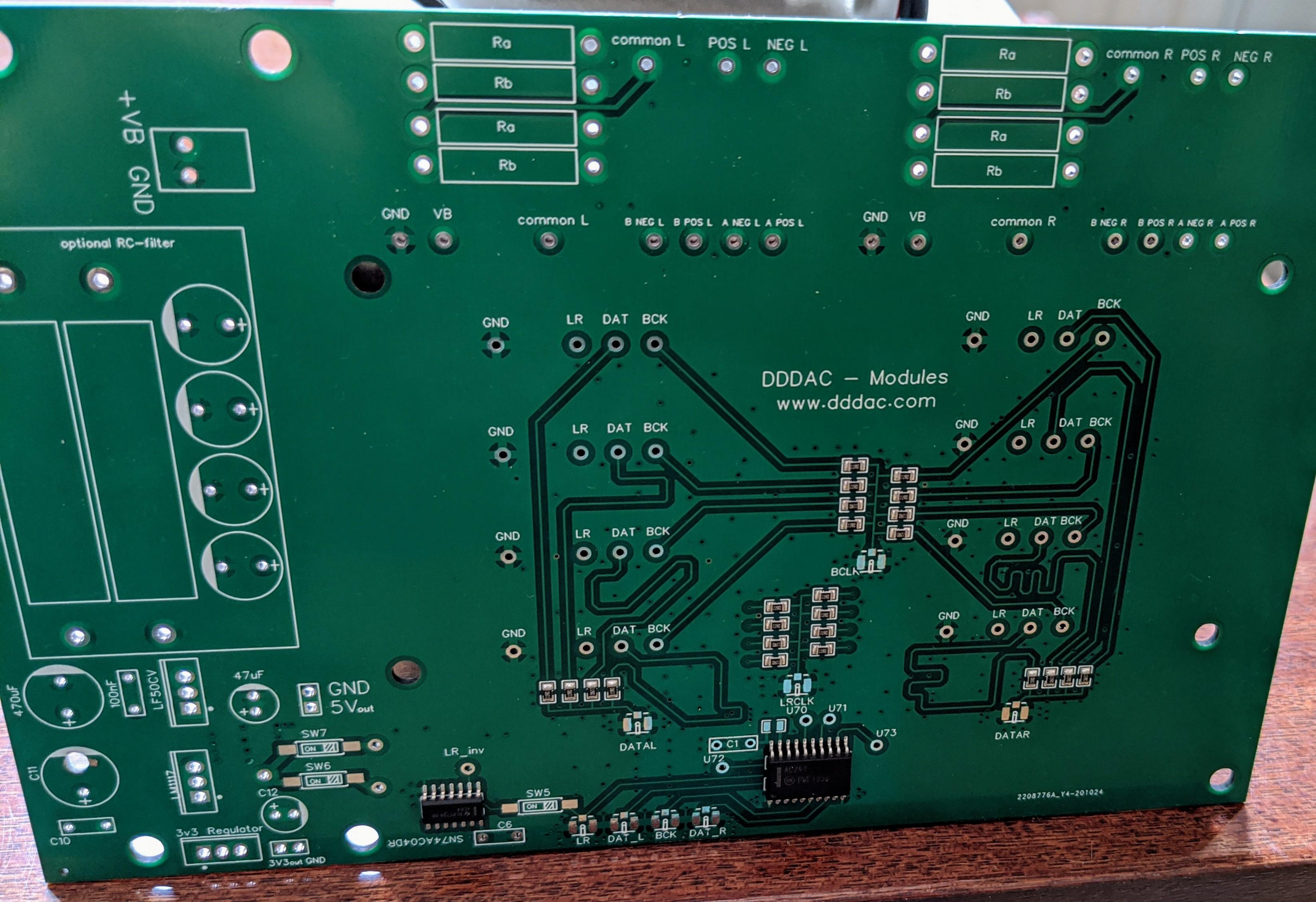

teaser
talking about upgrades, first promising tests with my new prototype mainboard are through 😉
For the interested:
I will make a complete "report" once everything is in place and I finished building the demagnetizer for my sowters ;>
Greetings oli
For the interested:
- Right justified directly from the raspberry pi
- Option to input without or with buffer (74AC244), seems to work fine without buffer with 4 boards
- "LR inverted" instead of "delayed Data" for left/right seperation
- Matched the length of the signal lines as close as possible. Idea was that the eliminating of random jitter trough parallel chip design works the best if these line lengths match. Otherwise it can happen that the following chip fires every time after the "jitter window" of his predecessor and could then have no influence on the random jitter (hope this is understandable and makes sense ;D)
Greetings oli

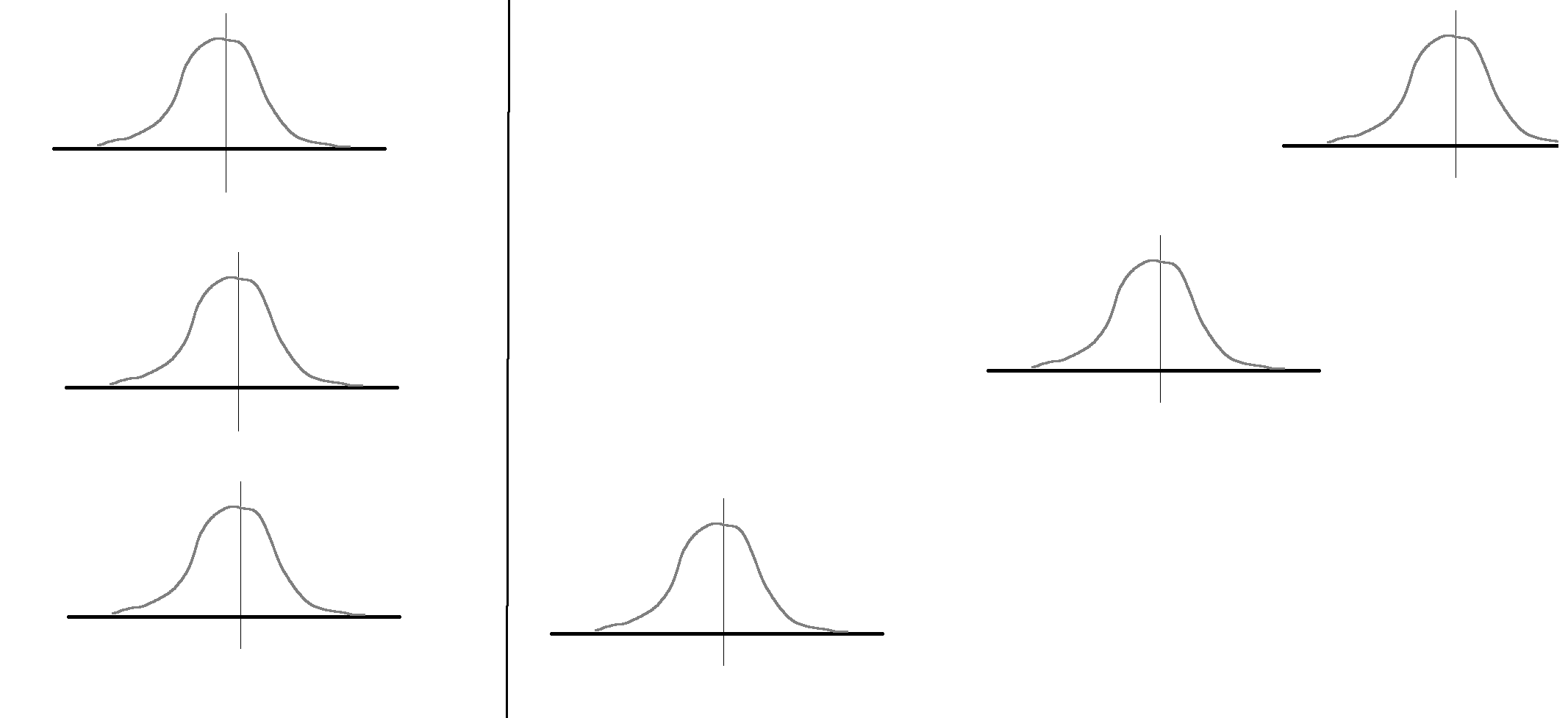

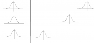

Uhm, I don't get it. Why would different lengths matter? How does this affect random phase noise (jitter)?
First off all I'm not sure if this has an effect on random jitter, perhaps we can find out here😉 The equal length was mainly for helping with signal integrity. Which is kind of important the way the signals are distributed here: without fan out or buffer chips.
Now to the idea:
If you have a look at Doedes homepage under "other" you can see a nice explanation for the idea behind paralleling DAC-Chips.
So in theory, if you want a new sequence of DAC-chips in every sample, you don't want to deliver the signal with a delay to some of them.
For better understanding and showing of my paint skills i attached a little sketch; where left is signal at every chip at the same time and the right side symbolizes unequal length/delay between chips ;D
Now to the idea:
So you are implying that the length of the traces affects the timing of the signal at the end of the trace? At what speed do electronic voltage signals travel?
depends on multiple things but it shouldl be around 15cm/ns, so if jitter is in the low ps region there is not much tolerance for line length differences
edit: the black magic bible says in PCB the delay is 140-180ps/in (picosecondes delay per inch trace length)

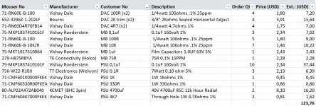

While my order from Audio Creative is on the way (PSU + mainboard + DACx2)

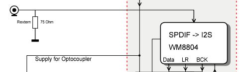

Both work, but you do not need it, as there is no logic levels in the spdif signal. I believe they put the capacitor in there to make it full event proof, as you never know what is going to get connected to the input?
