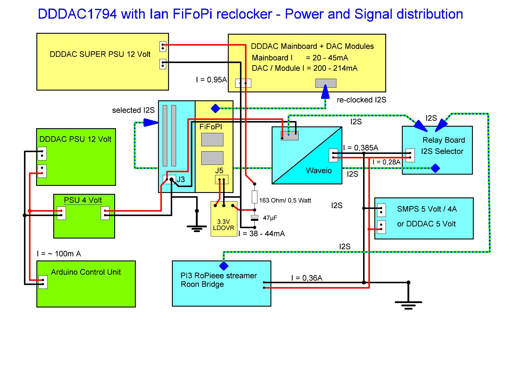

Thank you so much Simon for the confirmation and offering to help further. Considering my electronics IQ, I certainly feel I will need to reach out to you and other members for clarifications. Most of those will be silly questions I know but please bear with me. 🙂
Here is one for starters:
I am still confused about which sides of the WaveIO and Fifopi are isolated and unisolated? Could you indicate on the Fifiopi with the numbers such as J3/J5/J1... and explain the same for WaveIO too.
Thanks again
The J5 side of the FiFopi is the re-clocked signals and why isolated from the J5 side of the module, also why separate PSUs.
The waveIO outputs go the J5 side and the J3 side goes to the DDDAC inputs. I would not worry too much about the deep understanding but of course ensure you connect everything up correctly!

>>Each pack contains 5 such cables. How many packs would I be needing for the connections? I will order accordingly.
1 pack of each type will do. You need 5 wires for the WaveIO isolator (power in, BCK, LRC, data, and ground) and 3 for FiFoPi output (BCK, LRC, and data). Same three if you use U.FL instead.
Doede's image in post #7411 will guide you through the hookup.
This is already labeled on each board. Be sure read to the manuals in their entirety: If you're still finding your way through the basic setup here, however, you probably shouldn't bother trying to manufacture your own cables. I make them out of OCC silver wire and gold-plated crimp pins, and at this point I cannot tell you they are any better than mass-manufactured copper. So just get the ones from Audiophonics.
If you insist, the cheapest way is to just get a 2.54mm Dupont kit that contains both genders of crimp pins and housings. (Audiophonics does not sell these. Try https://www.amazon.com/Dupont-Connector-Kit-Connectors-Plusivo/dp/B078RRPRQZ) Search YouTube for "dupont crimping tutorial."
>> Did you mean getting these ones? Female - Female 2.54 to 2.0mm GPIO Jumper Wires 20cm (x40) - Audiophonics
I suppose theoretically you could use this for the FiFoPi to DDDAC connection. I use 2.54mm on both ends. This will not work for the WaveIO connection, which requires male pins into FiFoPi. In any case, there is really zero benefit to using a ribbon cable in your setup.
>> Which are the white jumper cable wires that DD uses? I think he supplied those with the kit too, to connect waveio and the board. Those are very sturdy.
I do not know what you are referring to...
