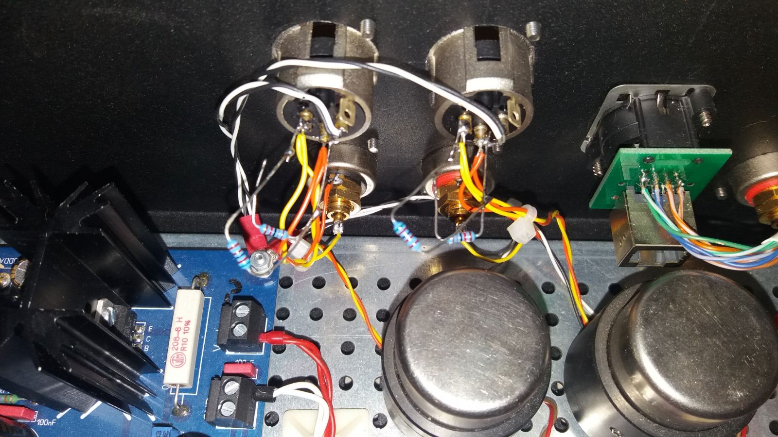

Just to be SURE: did you connect the transformer primaries from POS to NEG or from POS to ZERO (or NEG to ZERO) on the DDDAC board?
Yes, but i will try to reverse one of them to check. Primary winding connection is +out red wire and -out brown wire. On the secondary winding, yelow is +out and orange is - out. Black and white (housing and screen) are connected to the chassis. You can see it all in the picture I posted.
Ok, then run some sine waves through your DDDAC and use your scope to check what they look like at the transformer secondaries.
Obviously I have to check everything, the frequency range and polarity of the transformers. If Doede says this is a unique case, then something is definitely not right.
I would really like to keep the transformers, but also that it sounds better than capacitors.
Last night I had some time to check the phase on the transformers. Turning the phase on one of the transformers leads to complete loss of bass and stereo image. After that I reconnected the transformer properly and tried again the various resistors on the secondary, but without progress. I'll see what the measurement says, but I think this is a hopeless case as far as these Cinemag output transformers are concerned.
I see you have the XLR and RCA wired in parallel with both having resistor loading so I assume you have considered that in your resistor calculations?
The resistors are parallel to the secondary windings, one resistor to one secondary. In that picture, two resistors are connected and two are not. The RCA is connected to the XLR as recommended (+ out to central pin, - out to GND of the RCA). The RCA is isolated from the chassis. I connected the resistors to the XLR connectors because it's more convenient than to the RCA. It’s all well connected, I tried it without a resistors too. The higher the resistance connected, the sound is brighter.

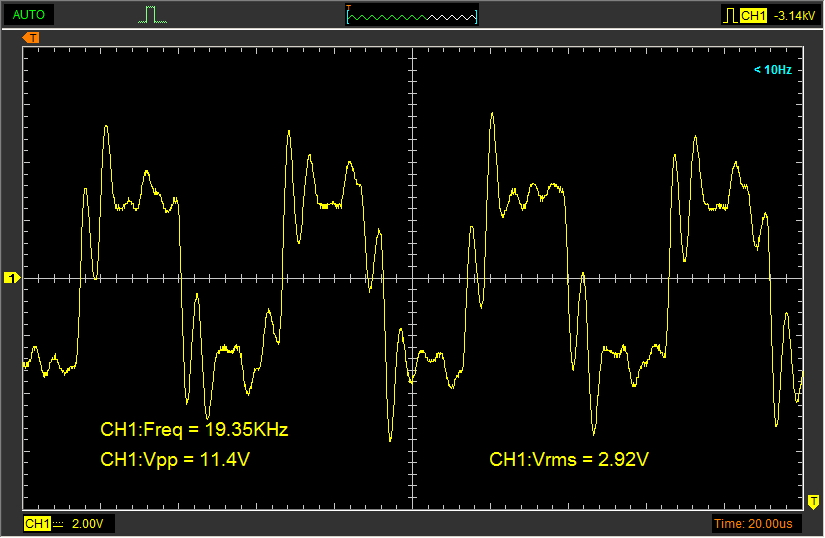

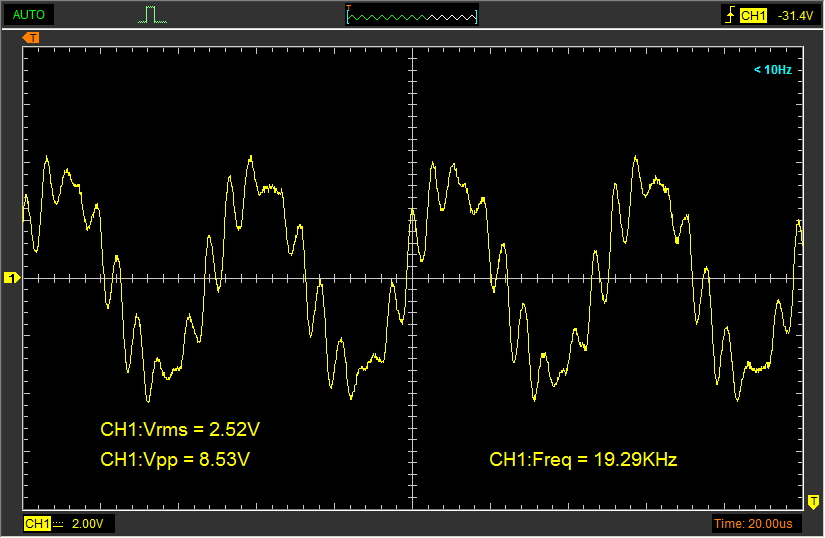

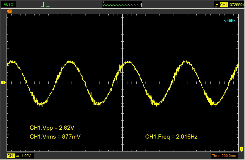

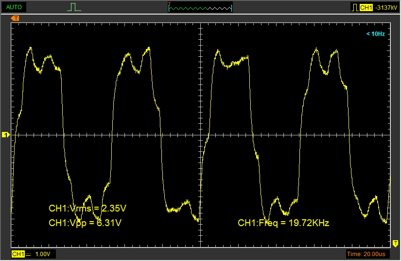

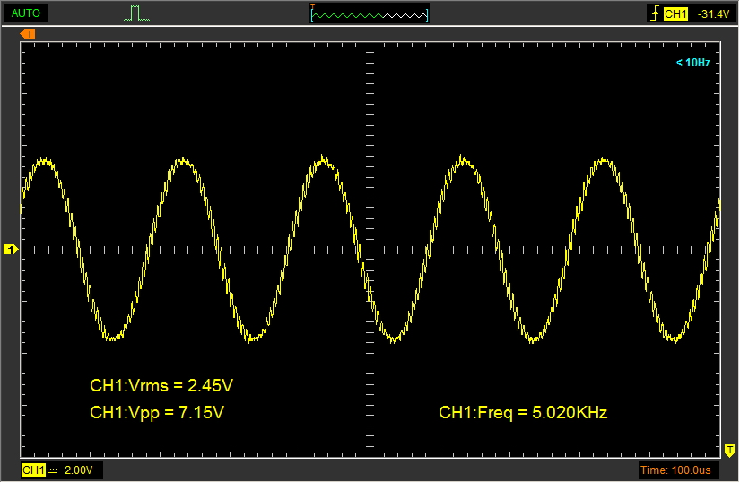

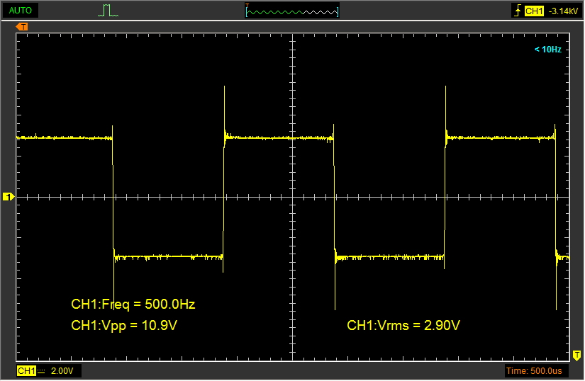

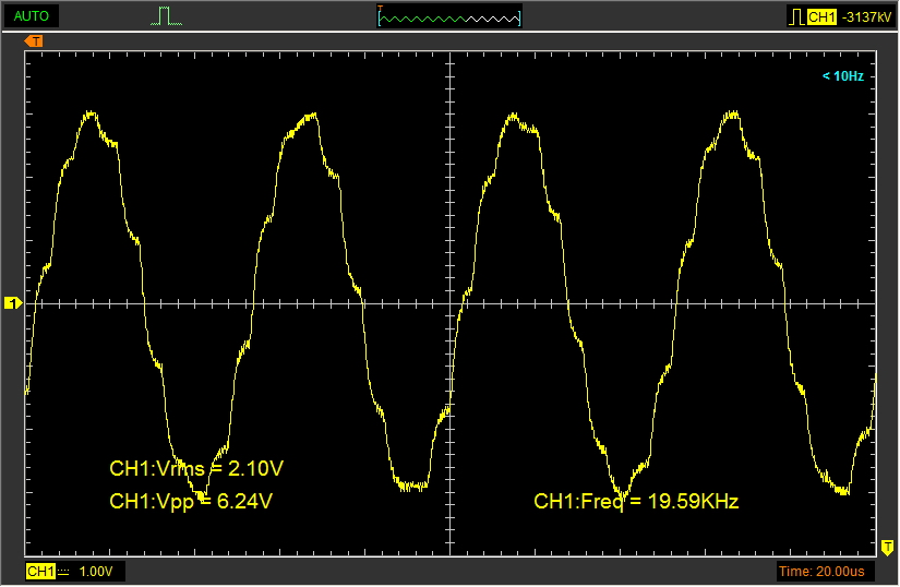

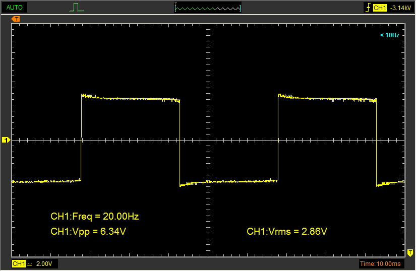

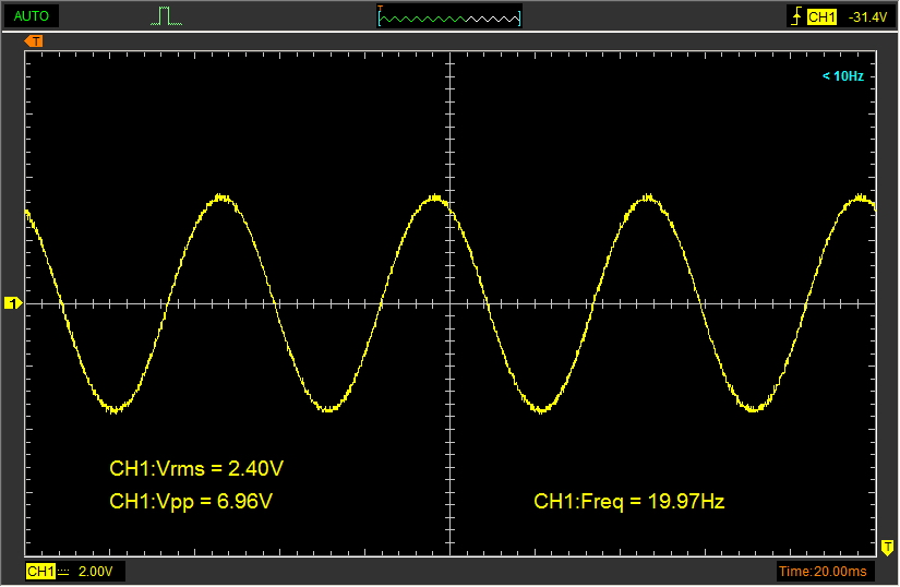

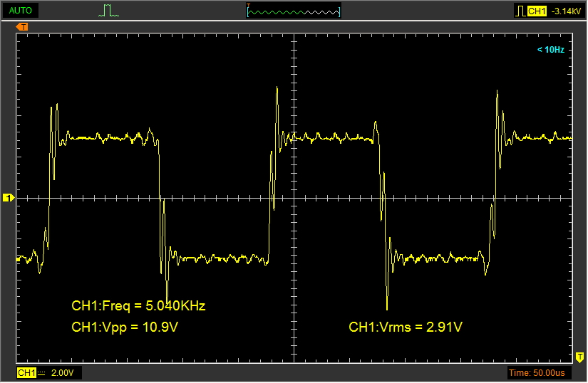

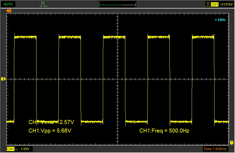

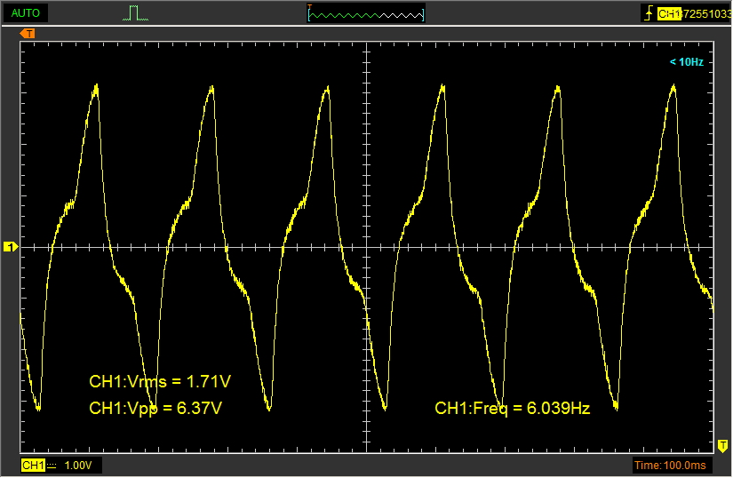

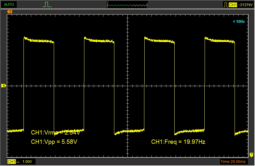

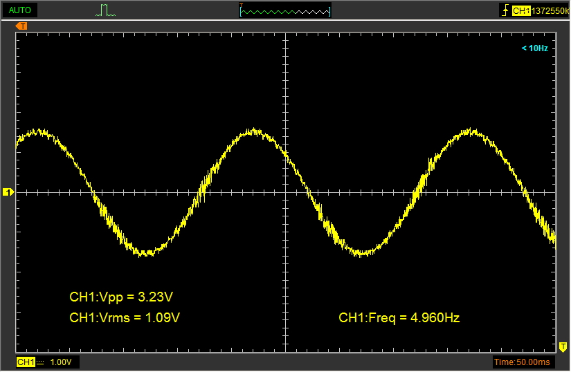

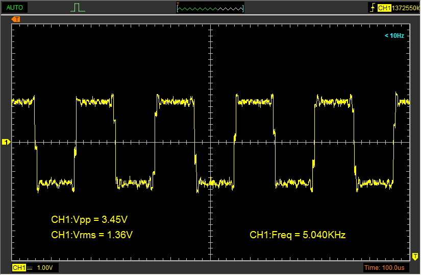

I did a few measurements over the weekend. I used an online function generator (it is limited to 20Hz-20KHz), the connection is via USB cable, resolution 24bit 192kHz, RCA outputs. USB Osciloscope: HANTEK 6254BD.
1: Friends DAC (2 boards) with Cinemag 600/600 transformers at the output, load 18k resistor at secondary.

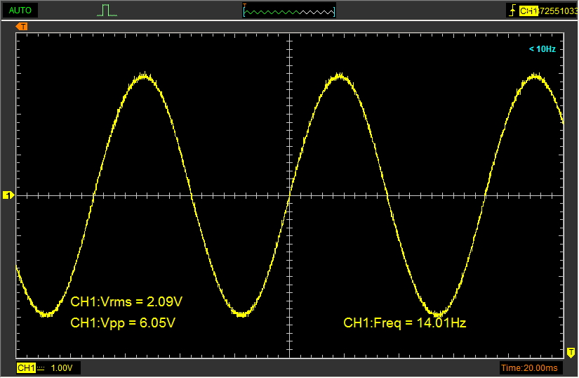

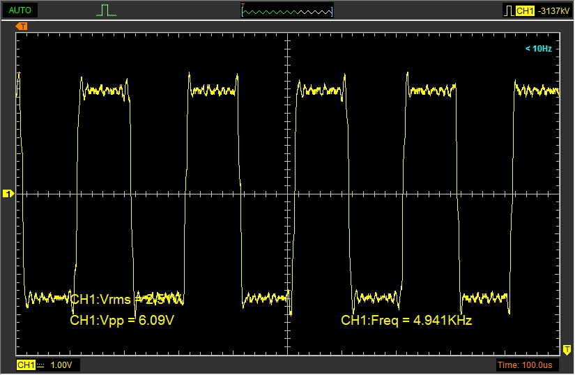

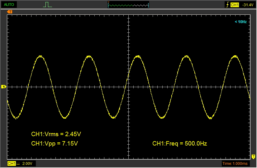

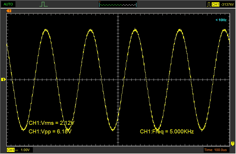

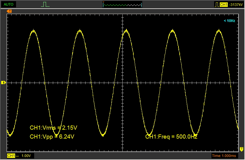

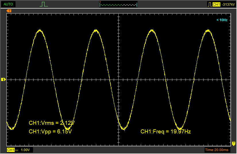

2: Friends DAC with Cinemag 600/600 transformers at the output, load 2k resistor at secondary.

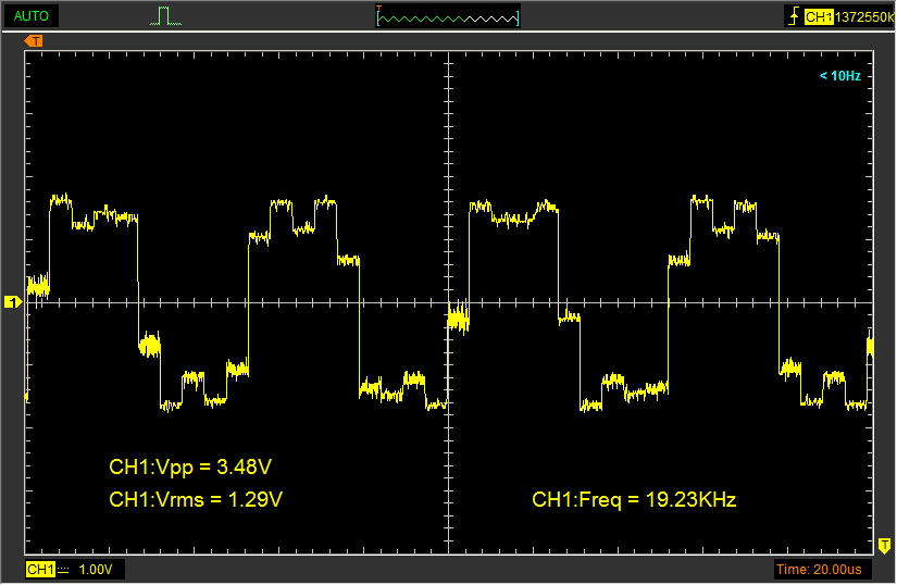

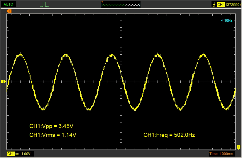

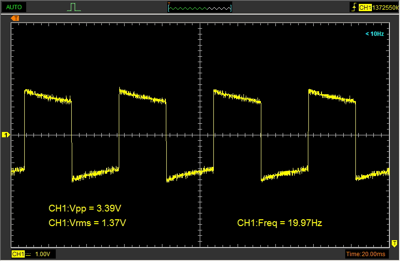

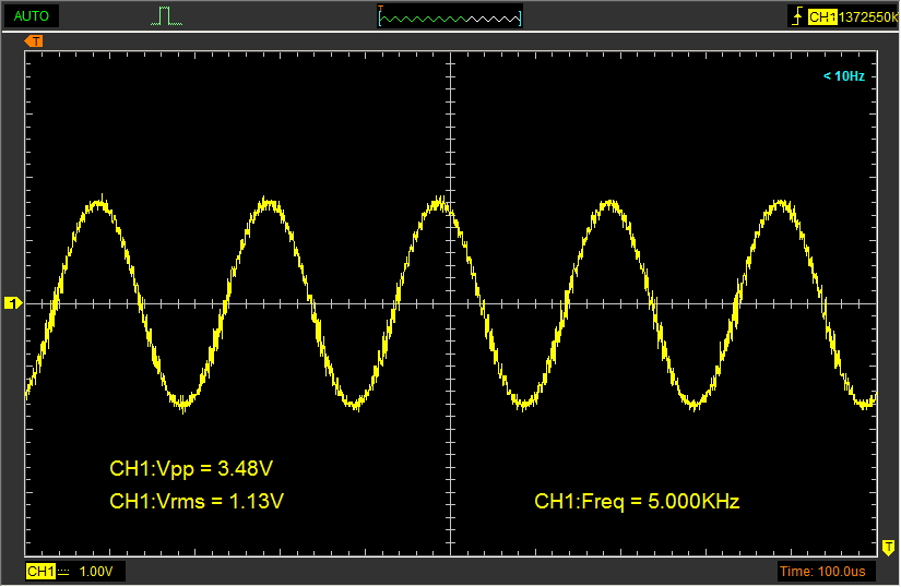

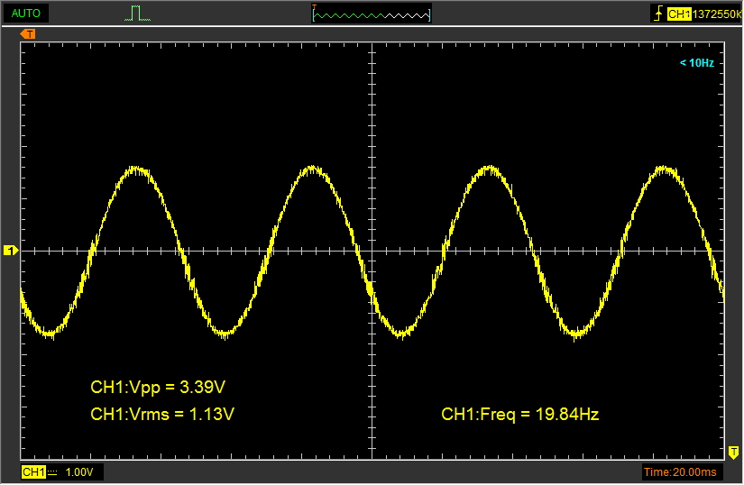

3. My DAC (4 boards) with Jantzen Silver Z 4,7uF capacitors at the output, load 18k resistor.

Listening test:
1. Cinemag with 18K load, too bright, subjectively less bass, (measurement shows some overshoot and ringing, maybe that's the reason?). The sine signal is distorted below aprox. 14Hz.
2. Cinemag with 2K load, the bass is in proportion to the rest of the spectrum, but the sound is flat and details are misssing. It is obvious from the measurement that the 2K load is suitable for this transformer, only the sound is not right.
3. Jantzen capacitors at the output sounds great, and that will be put instead of Cinemags.

The measurements show that both the Cinemag (with 2k load) and the capacitor output look about right. Response is flat from 20 Hz to 20 kHz.
How did you measure this? Was the Cinemag secondary (or the caps) connected to the (pre)amplifier or not?
I am not sure about the winding ratio of the Cinemag, but the Cinemag measurements show higher output voltage than with the caps. Did you connect the caps in balanced or single ended mode?

Cinemag was directly connected to the probe of the oscilloscope, without a preamplifier (only 2K load at secondary).
Cinemag transmission ratio is 1:1, except that Cinemag uses + and - out to RCA, and capacitors uses only + out and common (GND). That's why the output voltage is twice as high for Cinemag.

The 2k load is doing a better job of terminating the transformers. It would probably work better driven by a 4 board dac where the output Z is lower than 100ohms. 2.12volts at 20hz is pretty flat response compared to 2.15 at 500hz. No bass roll off.
