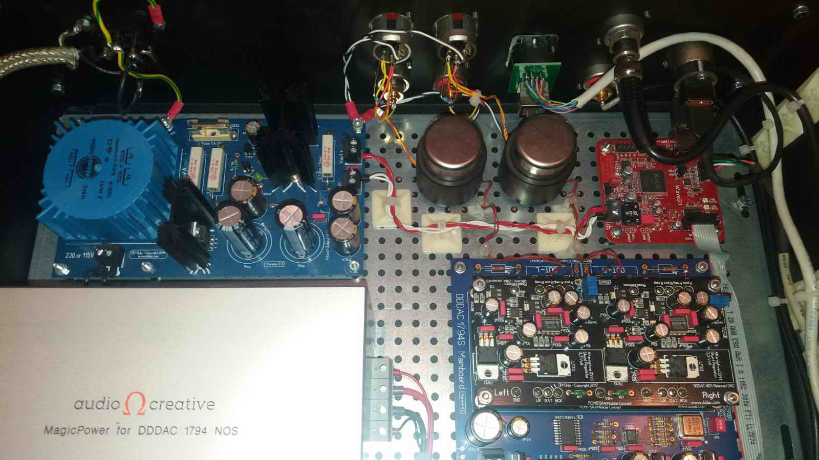

I finally connected my Sowter 9335 Transformers to the Dac in a temporary assembly with some switches so I can easily compare Sowter vs Caps. First I used some Mundorf EVO Alu Oil caps but will soon try with a pair of older Duelunds.
Sowter clearly beats the Mundorf which was hardly surprising ;-)
Just one question for you guys. I have tried to Google if some R load resistors are needed on the Secondary side of the Transformers, but I cannot find much information about the Sowters.
It seems the recommendations is 1K8 Ohm for the Cinemag 600/600 and the new Audio Creative O.P.T.
My DDDac is a Quad-Board'er and my input impedance on the Preamp is 100K.
Any suggestions here will be appreciated.

Yesterday I tried Cinemag transformers again. The preamplifier has an input impedance of 50K. I loaded the transformers on the secondary with 4K7, 10K, 18K resistors and finally no load. The sound was getting better with less load, except for the bass when there is much less than with the capacitors. Also high frequencies are too present with 50K load. Everything else is good, 3D presentation, details, etc. In the end I decided to order 4pcs. Jantzen Silver Z of 4.7uF and that is a better option for this DAC. Much fuller sound and silky highs unlike a transformer. For some reason the Cinemag transformers are not a match for a 2 board DAC. When I find the time I will try them with my 4 board DAC. I also plan to rewire everything with VDH SCS18 or similar, I have some more silver-plated wires that I use, I will replace both USB and SPDIF wires with something better. I don't like how this was done with cheap wires everywhere. This DAC deserves much more than this.
My preamp is SE, a friend has balanced inputs. I put capacitors on all 4 DAC outputs, and took it to the XLR and RCA connectors.

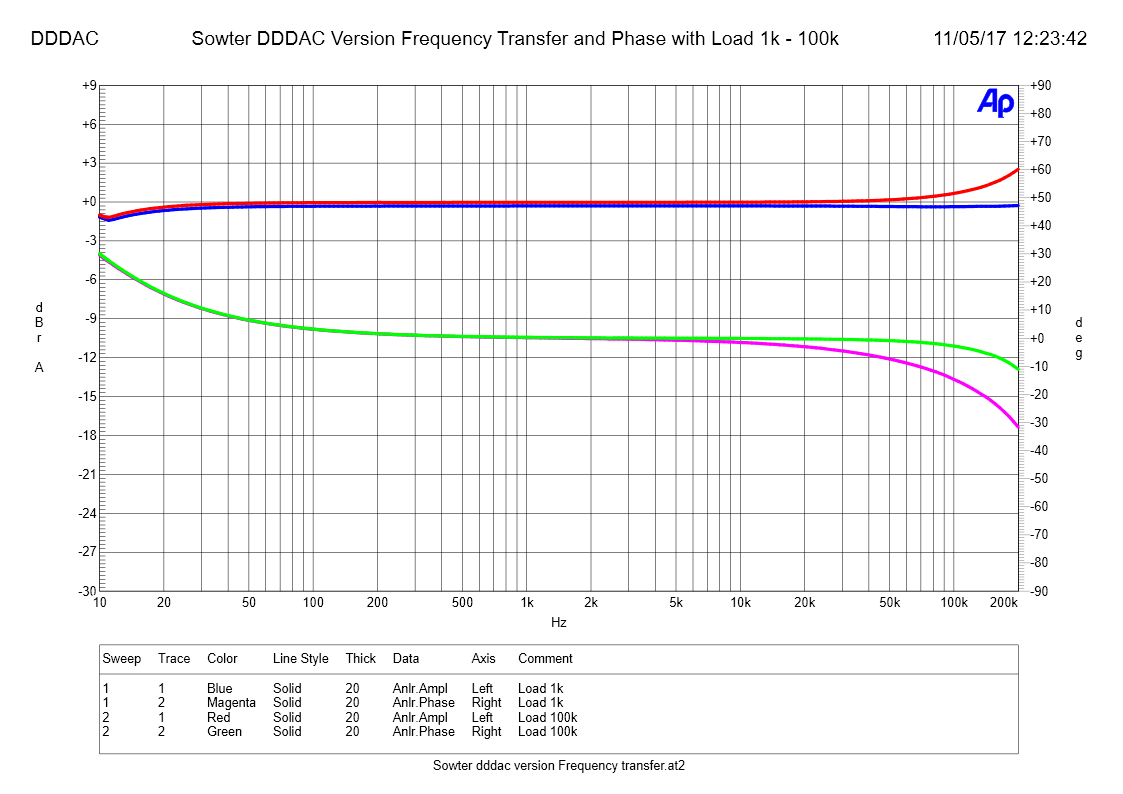

by the way, this is what happens with the dddac Sowter transformer when loaded with 100k and 1k (just for testing I did this) I load the transformer with 100k in normal operational situation (= music listening) - The source impedance for this setup was 20 Ohm

Can an increase in the frequency range curve (+10dB at 200kHz) cause any problem to the preamplifier or amplifier or speakers? One of my preamplifiers (unity gain buffer) is an Aikido cathode follower with 6N6P. The measured frequency range is 1.5Hz to 1.8MHz (-3dB). I also have one SS preamplifier, the range is 1Hz to 1.2MHz -3db. The output amplifier is LEACH LOW TIM, it also has a very wide range (I guess over 250KHz -3dB, I didn't measure it though).

Not blaming anyone, I'm just trying to solve something and understand why there is a problem with Cinemag transformers in combination with 2 decks of DDDAC. I guess someone else has that combination, to advise me what to do.

My SS preamp has an input impedance of 50k (log potentiometer), and no capacitors at the inputs or outputs (DC coupling completely), amlifier is DC coupled too, so no bass issues here. The two DDDAC decks has an output resistance of 68ohm. I don't see a mismatch here. Everything is connected properly (it is a simple thing anyway). I'm still waiting for someone to show up who has that combination.
I noticed you have an AP. so why not run (get the facts) a frequency sweep through the DAC with 1. The transformers and 2. the capacitors at the output and see if you really have less Bass ? It definitively should not be the case - very unusual and I never seen an issue like this (less bass C vs. Tr)
I'll have to do it, I have an oscilloscope and I'll find some online frequency generator to try. I will also reverse the phase on one of the transformers, it may happen that one of the transformers may have phase-wrong connections, although this is very unlikely.
