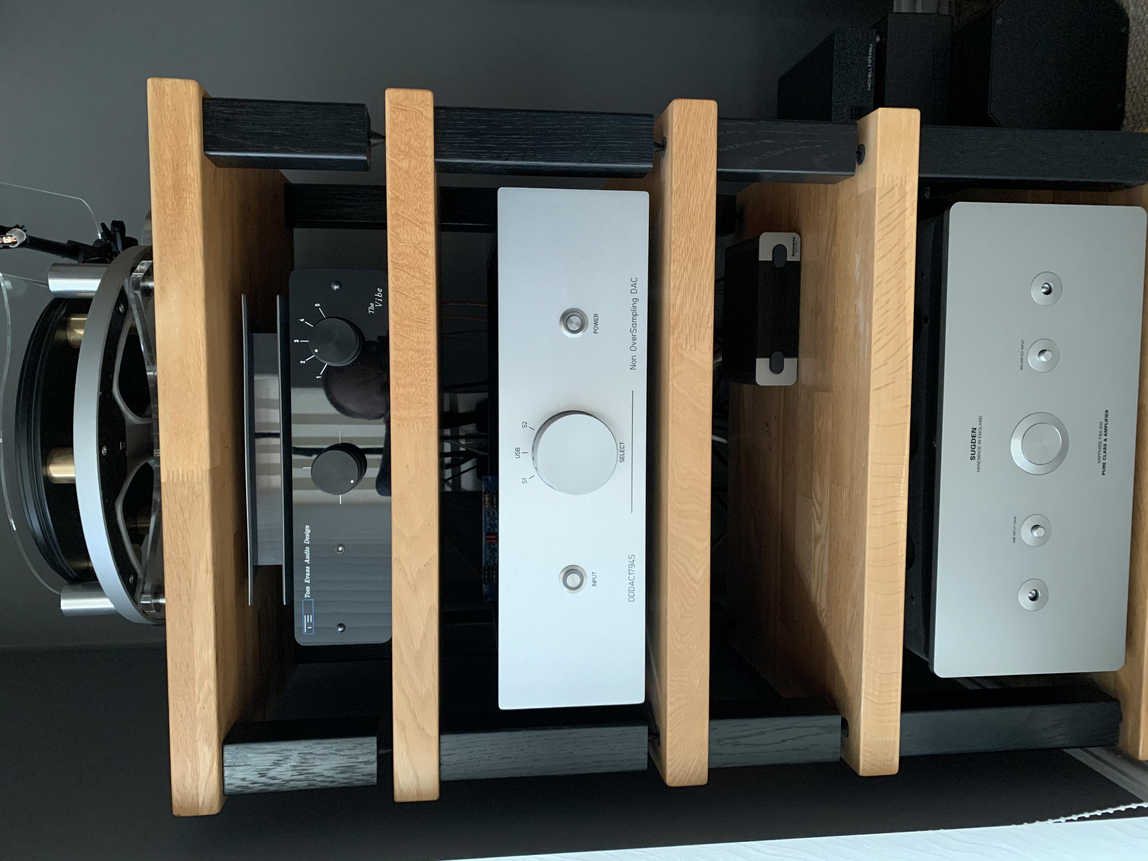

My DDDAC in the rack....
Pretty! Looks like the chassis is not tall enough to put the lid on
including the sound?
Yeap as others have also stated. Increasing the decks improves the sound
How much current is needed to power a dac with 4 of the older boards?
roughly 500mA
