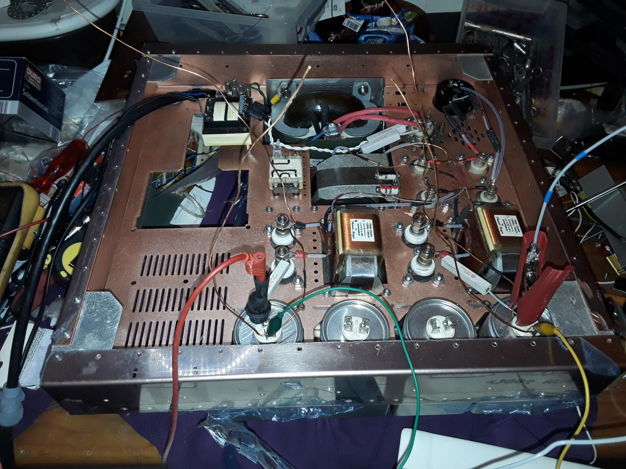

A beefy psu is gold. Overkill, but guess what, it have great authority. Compared to megabuck dac’s my dddac win everytime. Soundstage is huge. I guess my poweramps is a great part of this.
Yes, a choke input with a big choke will give a sound which sound very easily like my new power supply for a drd tube power amp. Greetings, Eduard
