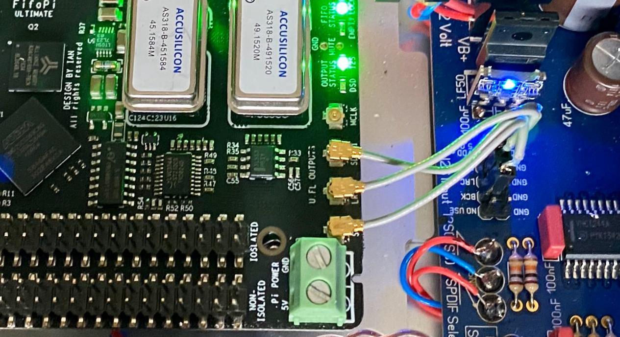

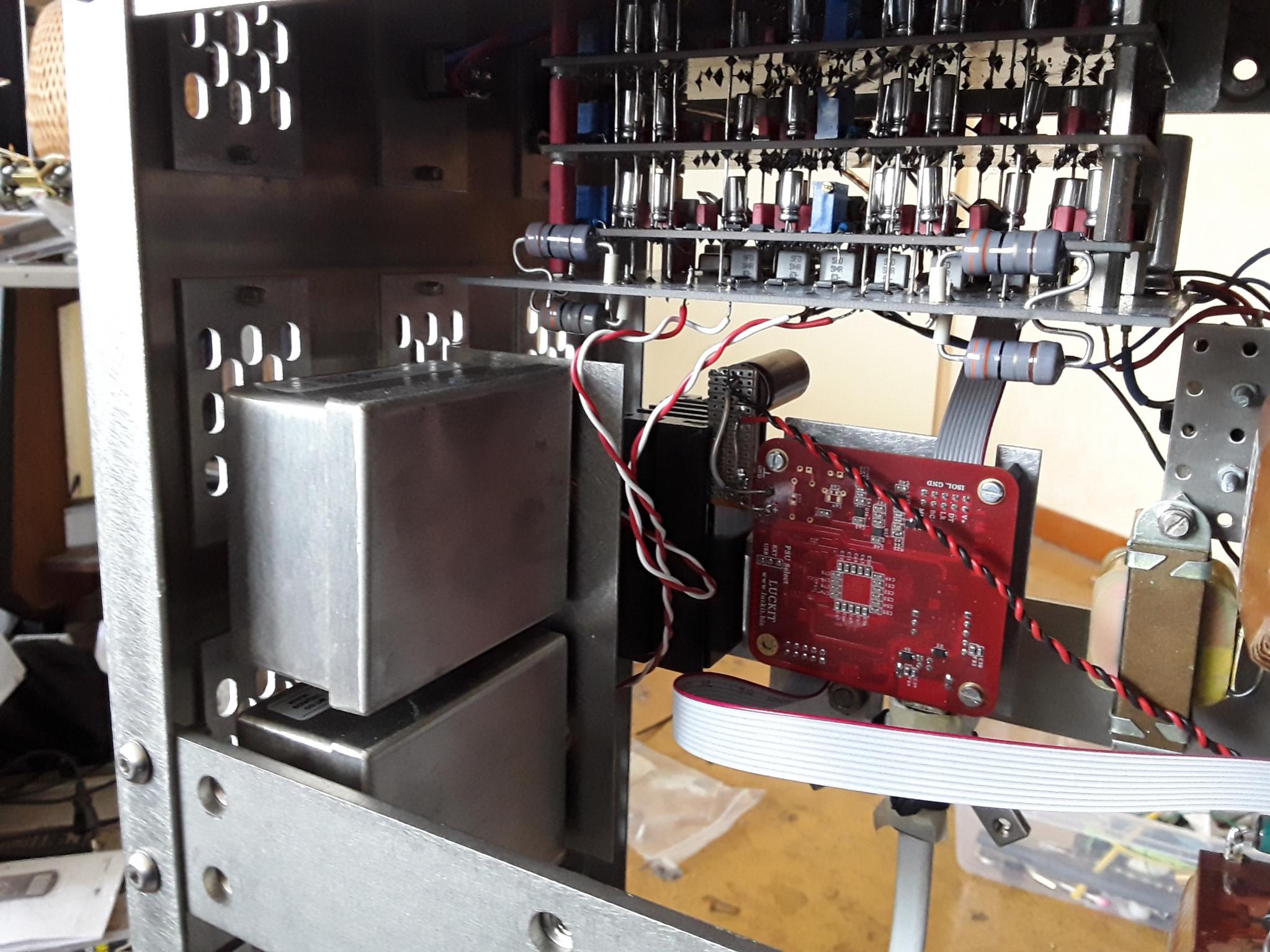

After reading Doede’s observations, I have a question. I have a simple set-up with the two standard power supplies, two decks (the Tent version) and cinemags. I use a RPI with the Allo Isolator and the DigiBerry connected to the I2S inputs (I used the instructions from the audio creative website). The RPI is powerd by the 5V power supply, the isolator by the 12V supply using a 47 Ohm resistor and an elco to get ~8V. I realy love the DDDAC! It is my first DIY project, so I am pretty proud that it works and it sounds so good (although the credits for the latter are for someone else J)
I would like to switch to the FiFoPi. I wonder what is the best way to power the FiFoPi? Doede showed his setup here:
no... I was unclear again I believe
mmm, see the image in the original post.
However, since Doede indicates that does not hear a difference on the quality of the I2S input for the FiFoPi, feeding the RPI from the 5V seems overkill? Or should I follow the scheme and use the 5V for the RPI and the 12V for both DAC and FiFoPi? Note that I do not use the waveio
And also interested in the cables that can be used to connect the FiFoPi to the DAC board.
Whatever I2S signal, regardless if coming from low end or high end source, was connected to the fifopi input did not make any difference

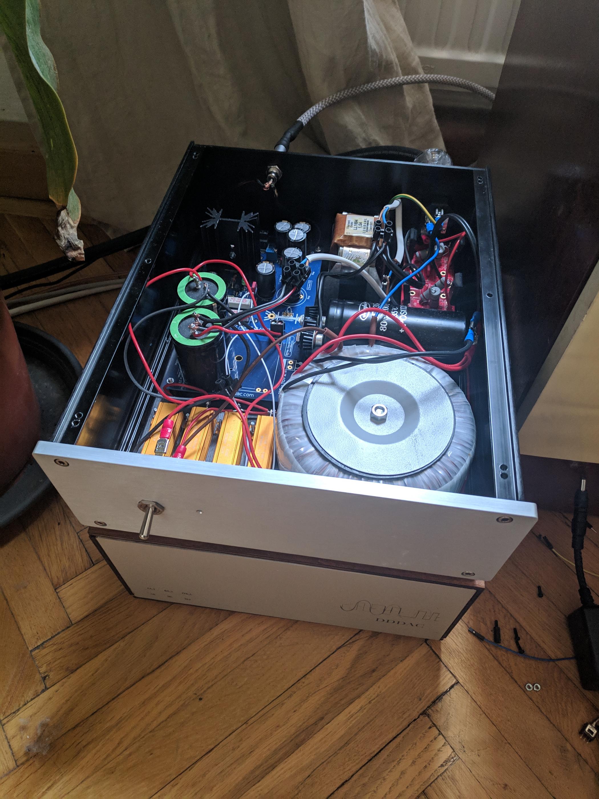

so after the build of my new PSU and the exchange of the chip i fried, I did some more testing and the sound certainly improved. I couldn't really test with and without the 74vhct244 chip as my Kali stopped working too which I didn't check first so i build everything back to standard for error checking.
With the new PSU the DDDAC has certainly gained quality. It differs from the >10k € DAC, which we used as reference while testing, more in character than in sound quality i'd guess. But I hope I can get the DDDAC to better it with better clocks in the future, as I used Ian's Fifopi with the standard clocks.
PS:
Thanks again to Doede for sending me the new chips
And thanks to smooth dancer for helping me on the PSU design
PSU:
