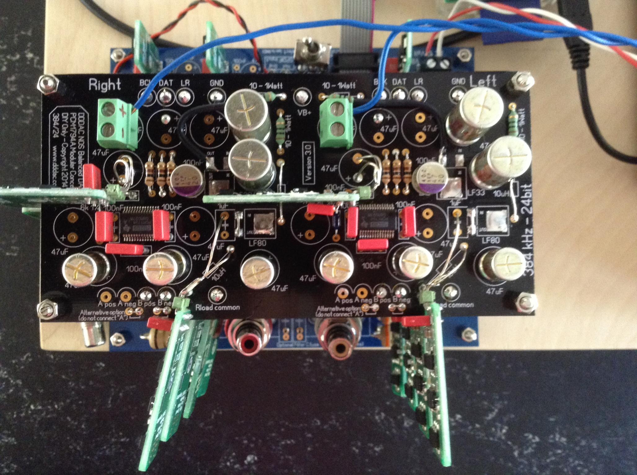

I have them in... and still impressed by the dac 😉
I know some leave them out, no problems with that. The concept of DDDAC was and is to have room for tweaking and experiments

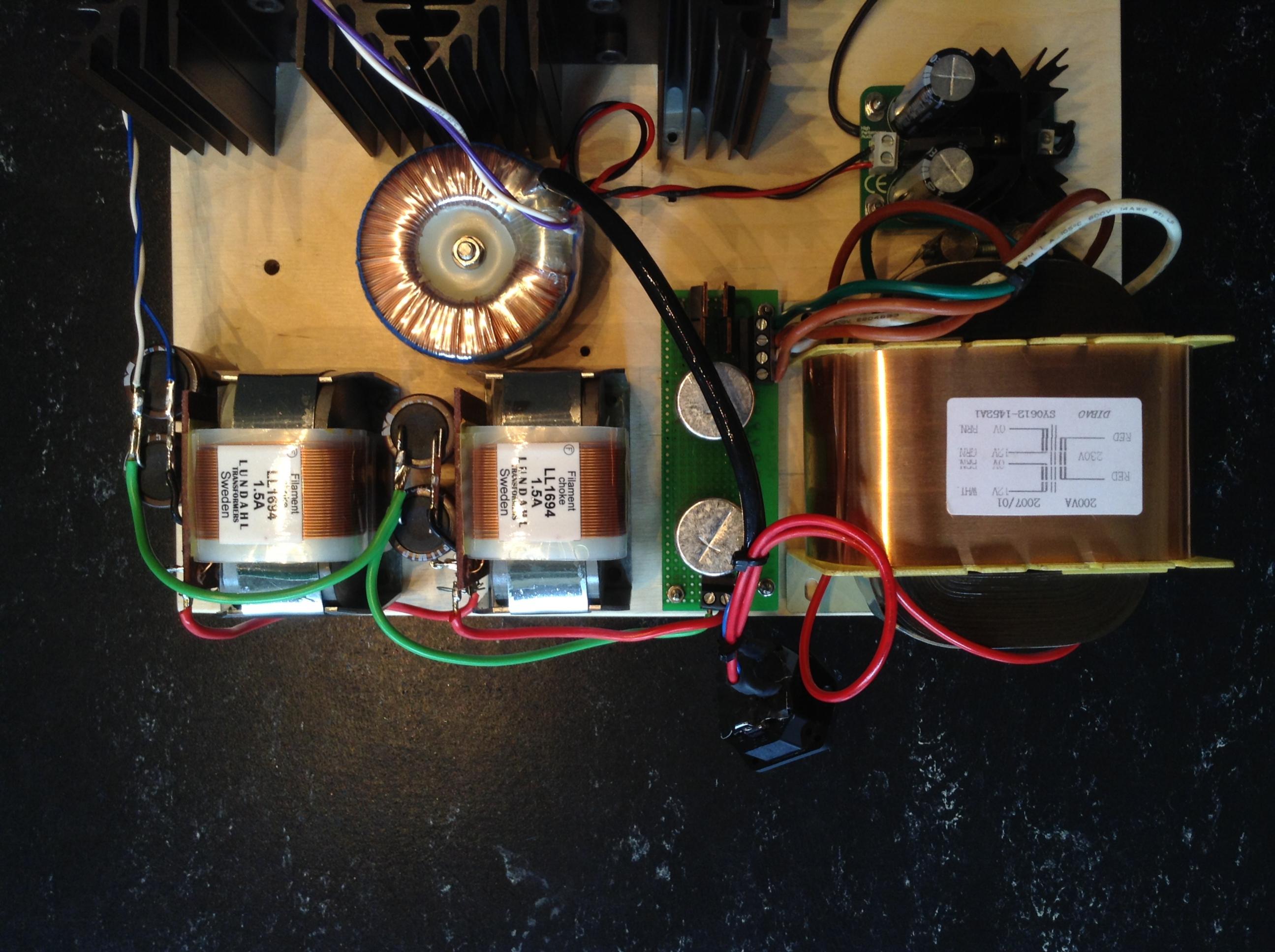

I use a clclc power supply without any regulation. I find unregulated raw power supply to sound much better than with an extra regulator.
My dac boards are fitted with Tent shunts for digital and analog, the voltage before the shunts is around 2v, higher voltage will heat up the shunts too much.
Ps. I use the old dac boards modified (this one was the prototype for the dddac shunt version)

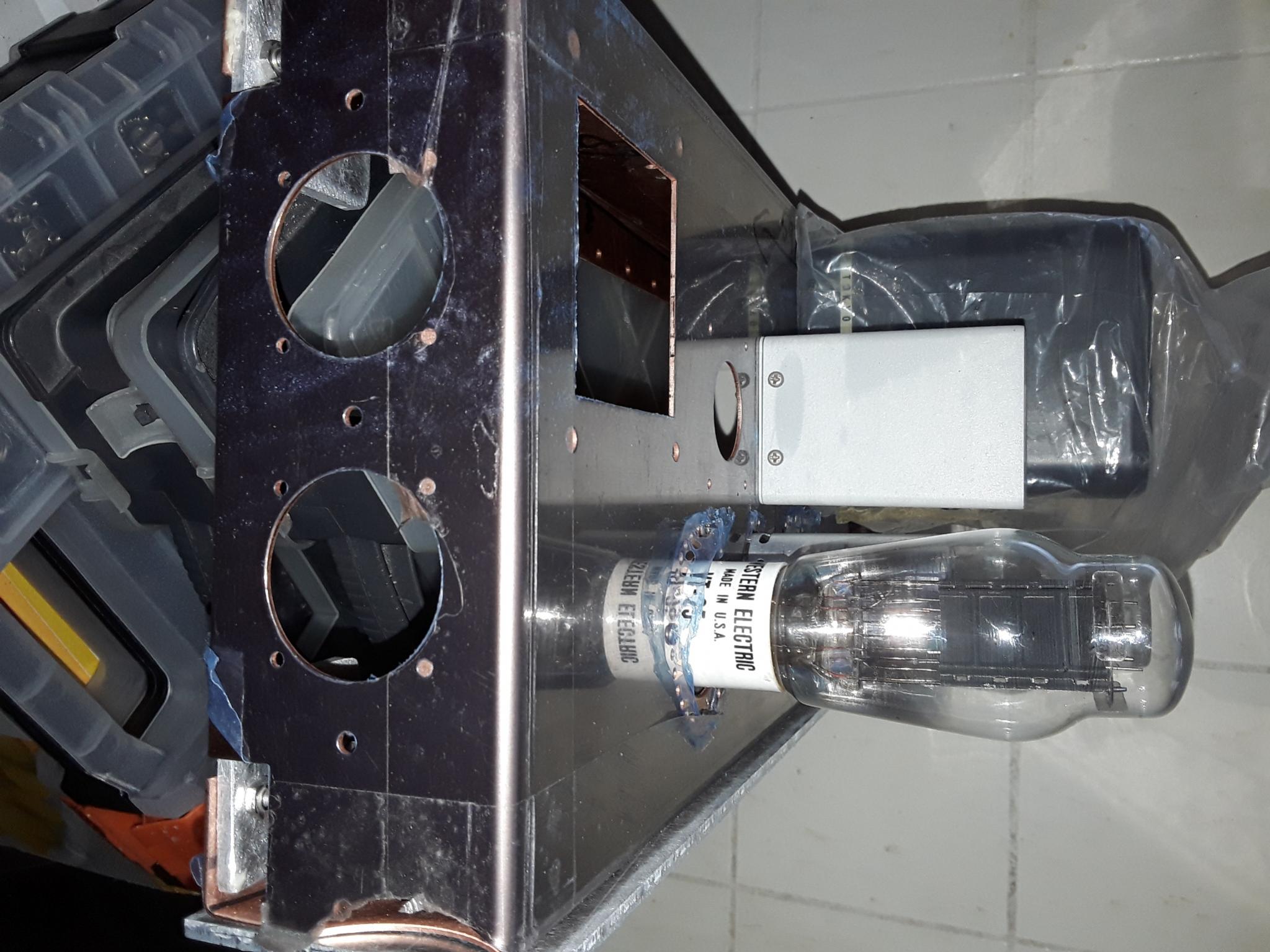

I could try when the present project is finished. When power chassis and signal chassis are mounted together it will be 40 kilograms i estimate and to big to move around all the time.greetings, Eduard
Looks good! What's the valve doing?
Hello,
It is the VT25 output tube in a DRD power amp. Right now just the parts mounted for one channel.....

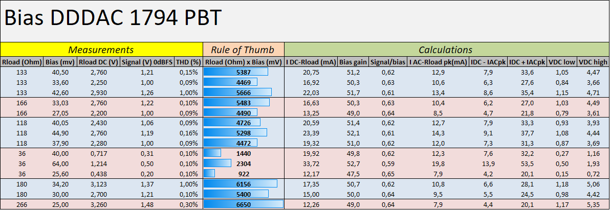

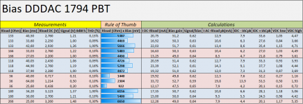

What to do if I use another Rload value?
I get sometimes questions on what to do with a different Rload (sometimes nice resistors are not available in 133, 68 or 33 Ohm 😕 )
so I did some measurements today to see if I can find a correlation between the Bias voltage at the test point (the one which "should be" 40mV) and the value of the Rload resistors. I did this for one board, but it applies for every number of boards of course with the factor n, where n = the number of boards
The background is, that if you change the bias current (measured by the 40mV point) you change the DC bias output current as well as the AC signal current gain… The Rload makes I-V conversion, so you get a DC bias and a AC signal output. The maximum voltage at the DDDAC you can do before the output starts clipping is roughly 4, 7 volt. The clipping is soft so it depends a bit at which THD% you measure this. I did 1% THD
The measurements and calculation table is below in the image- I understand this is humbug for most of you who are not in the detail of the internal functioning of the PCM1794.... So I looked for a Rule of Thumb correlation and actually found a very simple one which can be used !!
just calculate [Rload in Ohm] x [bias voltage check in mV] x [n-the number of boards]
this will give yo a numeric value and the rule is: STAY BELOW 5500....
For the standard DDDAC with for example 4 boards this is: 33x40x4 = 5280
assuming you only can get 39 Ohm resistors for the Rload and just soldered them in and kept the bias at 40mV?
now you have: 39x40x4=6240 ….. oooopsie: TOO HIGH!! this will distort like hell !!
so what you do is turning the blue trimmers till you have 35mVolt
39*35*4= 5460...… case solved !
You can use the table as well if you want a LOWER signal voltage....
The table is done with ONE BOARD ...
hope this helps…. DD

much appreciated and great help when I build up the new stack
I can have my AN 2w silver tants and be in target range
47x ? x4=5500
5500/188= 29mA
