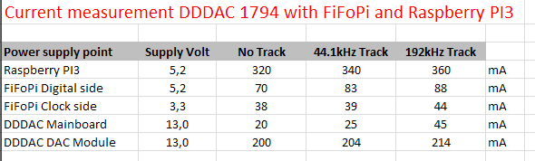

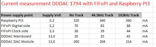

Measurement of supply currents
I am rebuilding my DAC in a new chassis so I have all boards on the bench and decided to finally do a proper supply current measurement.
Note: The clock side of the FiFoPi is with disabled on board LDO (short R58 and R59 points) and with the Accusilicon clocks
as questions on supply current always come back, I thought I should post the results here, FYI 😎
Hope it self explaining 😱
Thank you for this Doede! I have a few questions.
1) When FiFoPi is paired with the WaveIO board do you still recommend feeding 3.3v to FiFoPi digital instead of 5v?
2) I bought a Vishay thick film 1/8 watt 0 ohm SMD resistor for FiFoPi LDO bypass (as instructed in the manual). But how difficult is this soldering effort? Everything is tiny. Did you use a resistor or just wire?
I am planing to purchase Wishay/Texas Zfoil resistor for my four deck DAC.
They are rated for 0.6W and will be (if I didn't mess) running at 0.22W.
I wonder if headroom is enough to have the resitors giving soundwise the best of what they can.

sure no probs....
1) Waveio is indeed a special case, you know, may be I should try out all 4 combinations Waveio-isolated-output supply voltage versus FiFoPi-digitalside- supply-voltage.........… like 5-5 5-3.3 3.3-5 3.3-3.3 and report back what happens….
2) I just used a small wire bridge 😀
3) 4-deck, Rload = 33 (or 34) Ohm - Bias DC = ~ 2,7 volt, hence power disipation is: 2,7 x 2,7 / 33 = 0,22 Watt - Verdict: yes you are good to go 😎

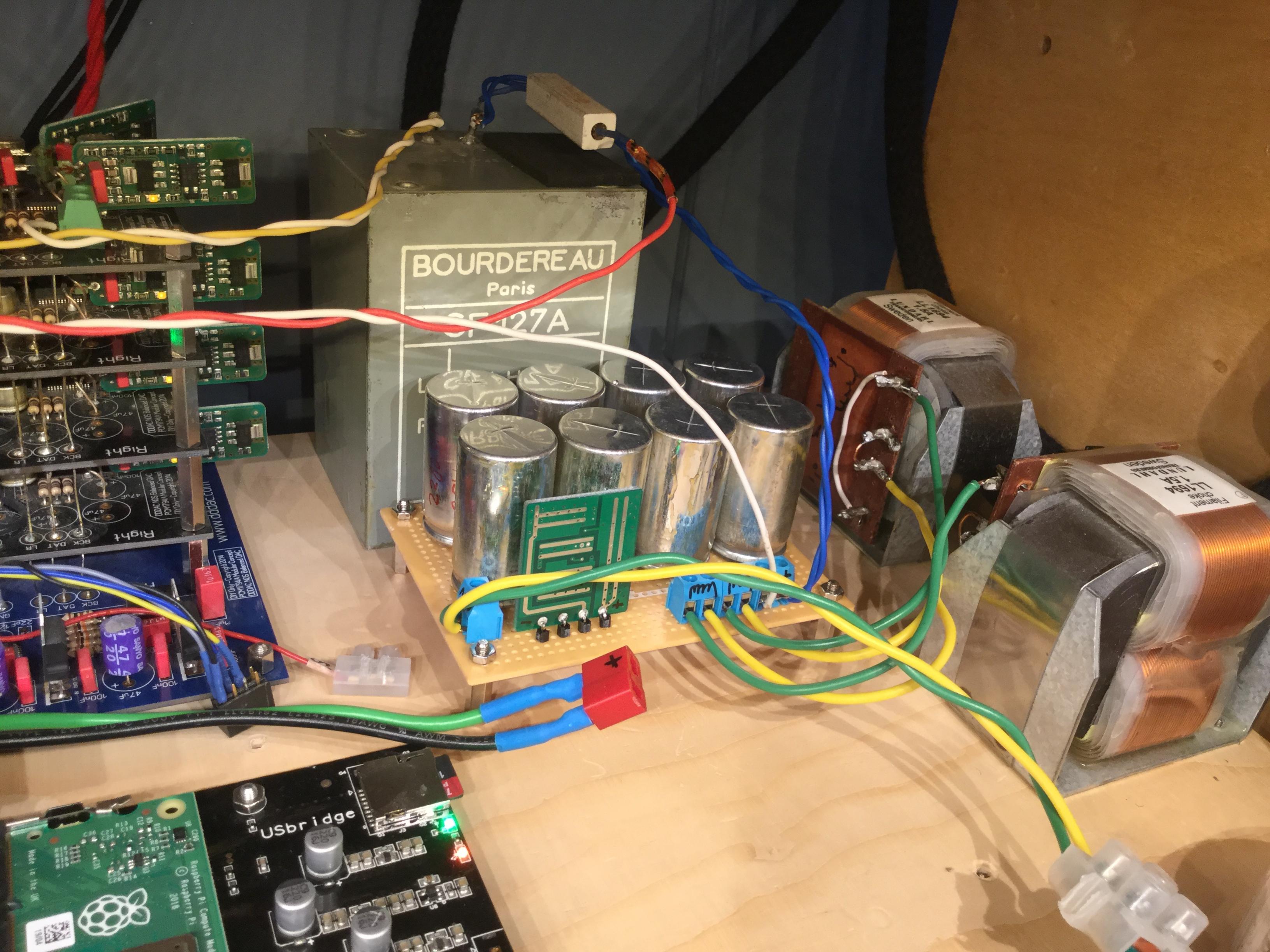

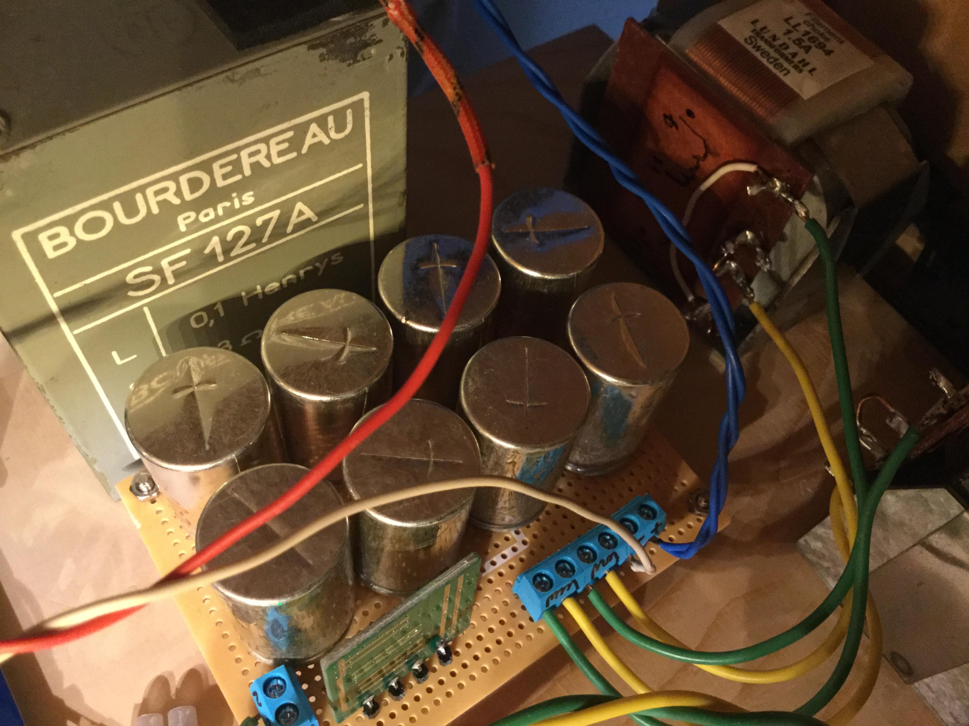

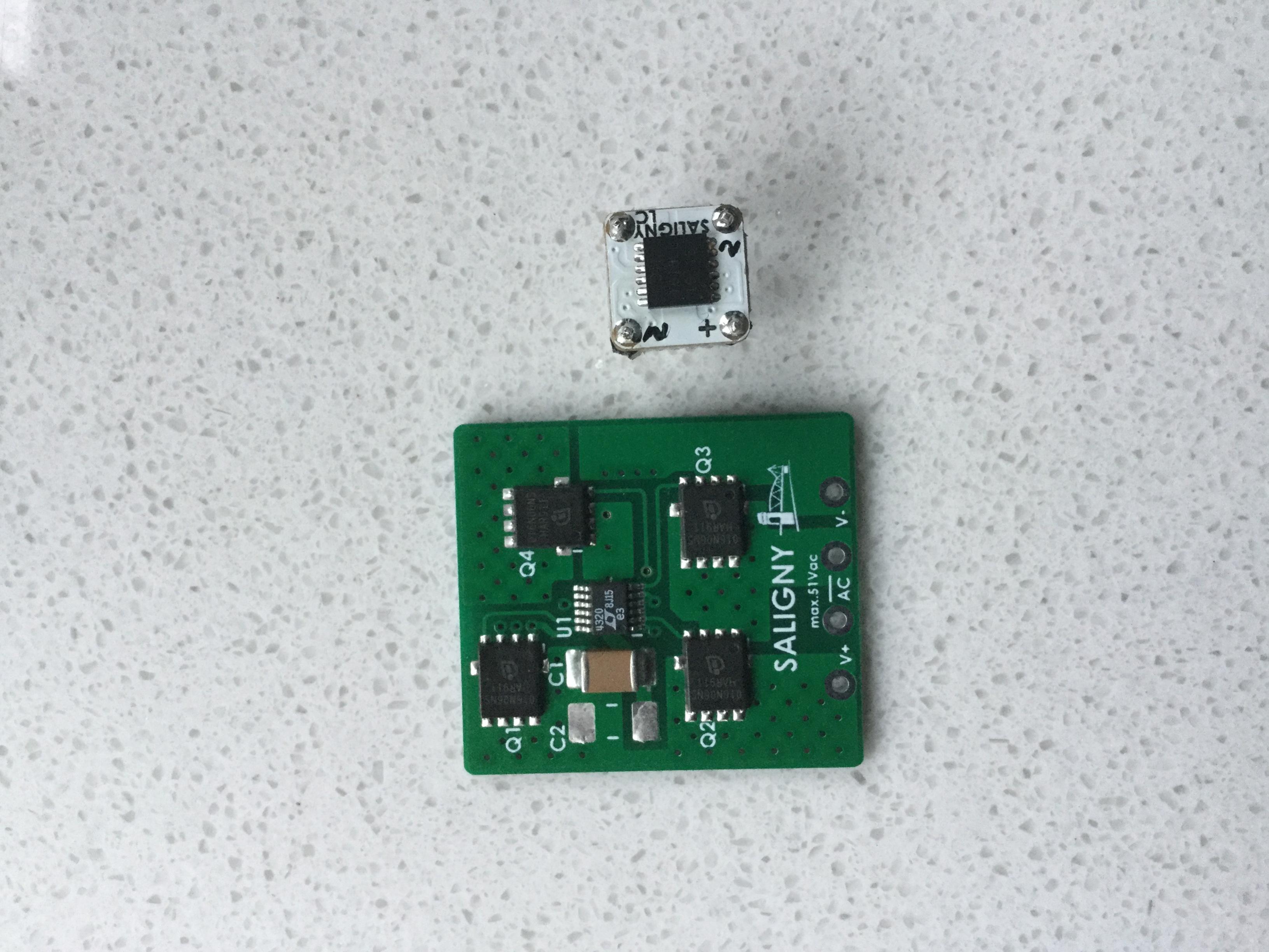

I made an upgrade on the ps on the dddac: the diode rectifiers are changed to a mosfet rectifier (no diode swich noise and lower voltage drop) and this made it possible to change to a choke input filter.
After a week running in, the sound with choke input and mosfet rectifier is a bit more relaxed and the high tones are more smooth.
@Doede: when you are at rebuilding your dac, why not change the rpi with a usbridge sig? This would be a very worthwile investment!
