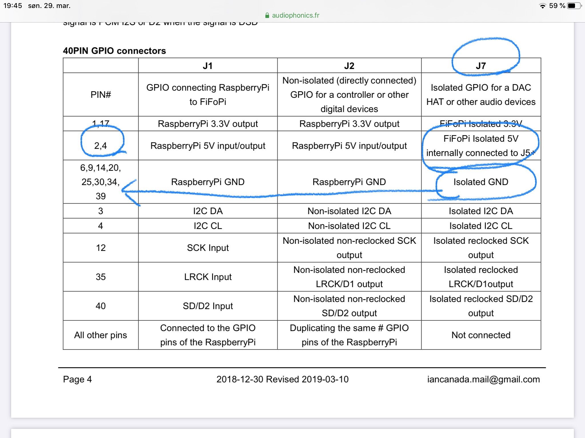

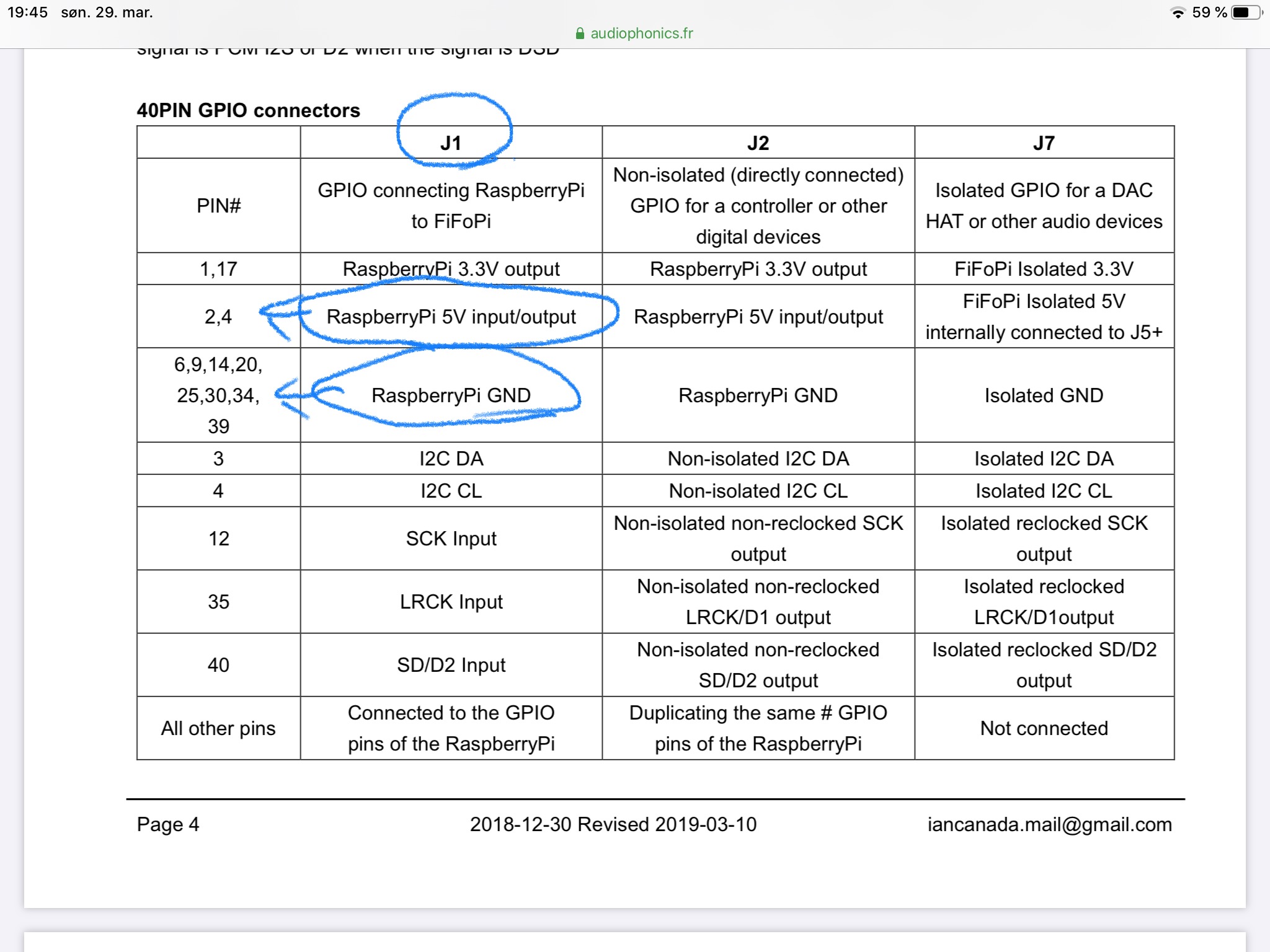

Ok, I also have a WaveIO and other adjustable PS, I can try it, but why WaveIO is connected to J3 and external PS? J3 is needed to supply the Fifopi's Input side in fact?
I just checked J3 voltage, 0V. Is it normal if nothing is connected in ?
On the Fifoip, the only led light is X02.
0v is Ov. I am not familiar with BBB, and can not recommend you what to do if something goes wrong. Maybe some others can help.
With the rasberry it’s recommended to use J3 to power it.
Yes, J3 need power. My FifoPi have no problem with 5v, but Doede recommend 4v.
WaveIo’s isolated i2s output need to be powered from another source than from WaveIo’s own 5v input.
Doedes schematic show this clearly, (J3).
Julien@
If it’s possible, connect wires from pin 2 (5v) and gnd from pin 6 on J7 to your BBB.
Hook up power 5v to J3. Forget WaveIo, I guess you want to use i2s directly from BBB to FifoPi.
Edit: not J7, BUT J1
Obs obs...I mean J1 the connector under the FifoPi. Forget J7. My bad.
Ok I try to do it tonight, Thank you very much !
Yes, I dont want to use WaveIO, I think it is useless in my case.

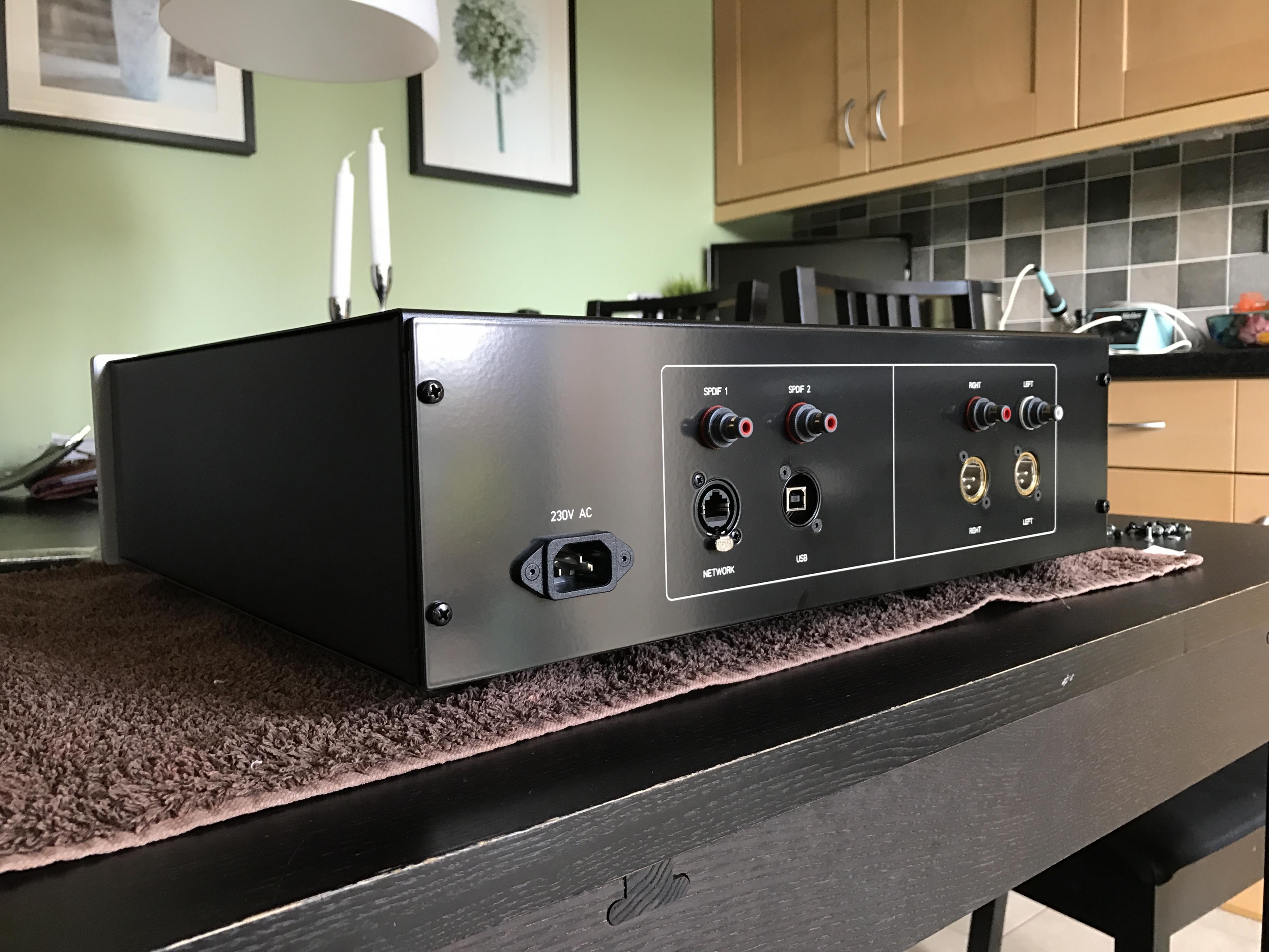

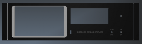

"I thought I bought a large chassis but still needed to fiddle around and puzzle to get it all in"
Haha I'm glad that I'm not the only one, had this happen 3 times now, getting better every time, but it's never as much space there as I thought it would 😀
Looking great though 🙂
Greetings oli
Greetings oli
Thanks Oli for the flowers 😛
Simon, I buy all my chassis at Modusshop in Italy, so my Rack looks consistent….
this one is the largest I could get in the series. I always buy a baseplate (the one with the holes, for easy setup of modules and I buy aluminum top and bottom plates because it looks nice....
here is my order:
Slim Line 03/350 3U 4mm BLACK
Inner baseplate for the Slim Line 280/350 series
Cover SLIM LINE 350 in aluminium
Fully vented aluminium cover for Slim Line 350 series
Precision-milled aluminium knob 39.5 mm diameter black anodized (for the volume)
Couple of Riser Panels 150x120 C-RISER-150x120 (The small extension plates)

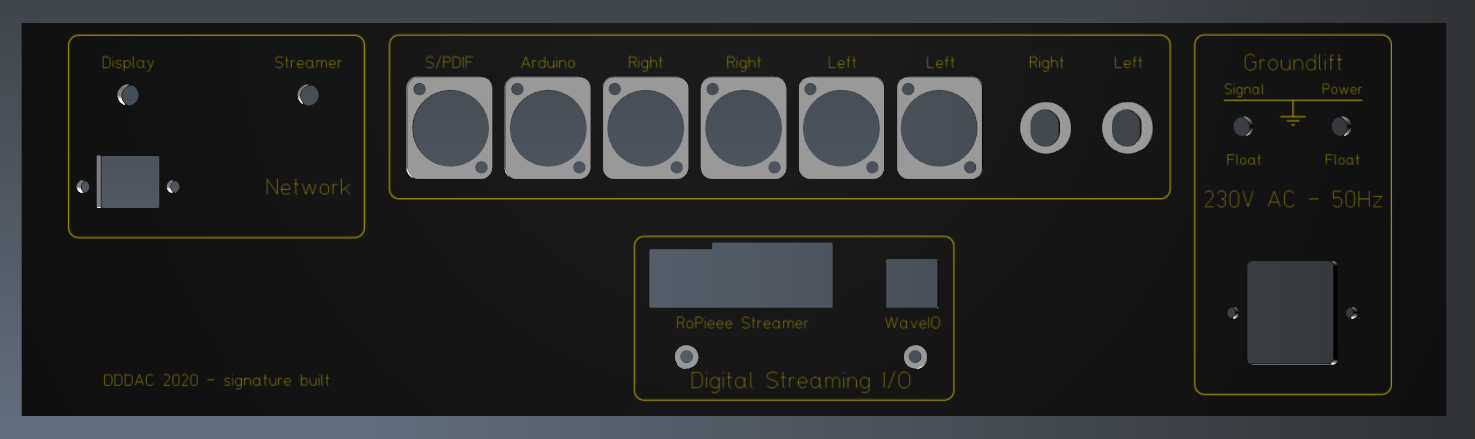

I design the fron and back with the "Frontplatten" Software from Schaeffer in Berlin

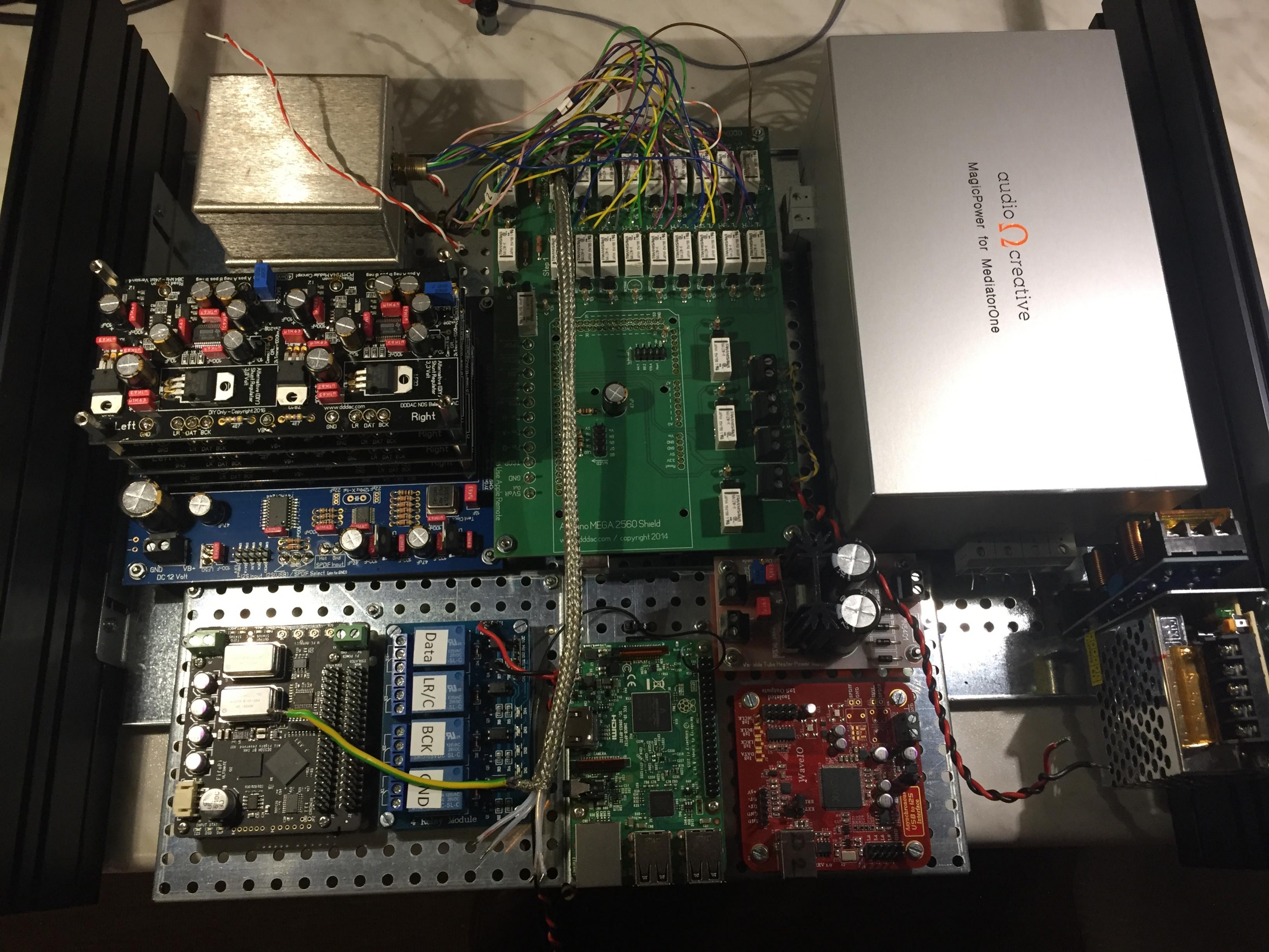

Rough layout is ready and the front and back plates are in process. I thought I bought a large chassis but still needed to fiddle around and puzzle to get it all in 🙄
That is why I keep it on a wooden board in a cabinet with doors 😀
It looks pretty crowded. Why is the fifopi not on top of the rpi?
I see a ground wire to the casing of one of the clocks, what is the purpose?
Groeten,
Groeten,
😀 The lead is just flying as nothing is connected yet... picture 2D effect.
As I have two I2S inputs from ropieee and WaveIO, is have them separated and use the little relais board for selecting the one or the other...
Ah, ok.
Would it not be more efficient to use 2 fifopo’s in order to keep the i2s lines as clean and short as possible?
