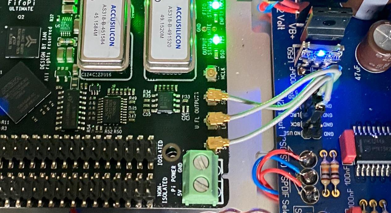

I really thought about this (I actually HAVE two FiFoPis with Accusilicon clocks) and this was my line of thought:
After the re clocking I want to keep things close and short and shielded - so the FiFoPi must be connected close to the DDDAC
I tested several sources (even not so good sources) and could not hear any (significant?) differences when I followed them with the FiFoPi connected directly to the DDDAC. For sure not the very audible differences when not re clocked or between non-re-clocked and re-clocked….
I wanted to have (my Dac is also used for testing around stuff) my DAC with both Ropieee streamer and USB Waveio input - So I needed a selector switch.
If I now do both with a FiFoPi, then I still would need a selector switch AFTER both FiFoPis going to the DDDAC... This seemed defeating the idea to keep things tidy and short after re clocking.
so after considering all of the above I decided to stick with selecting the source first, then re clock and stay short and close to the DDDAC....

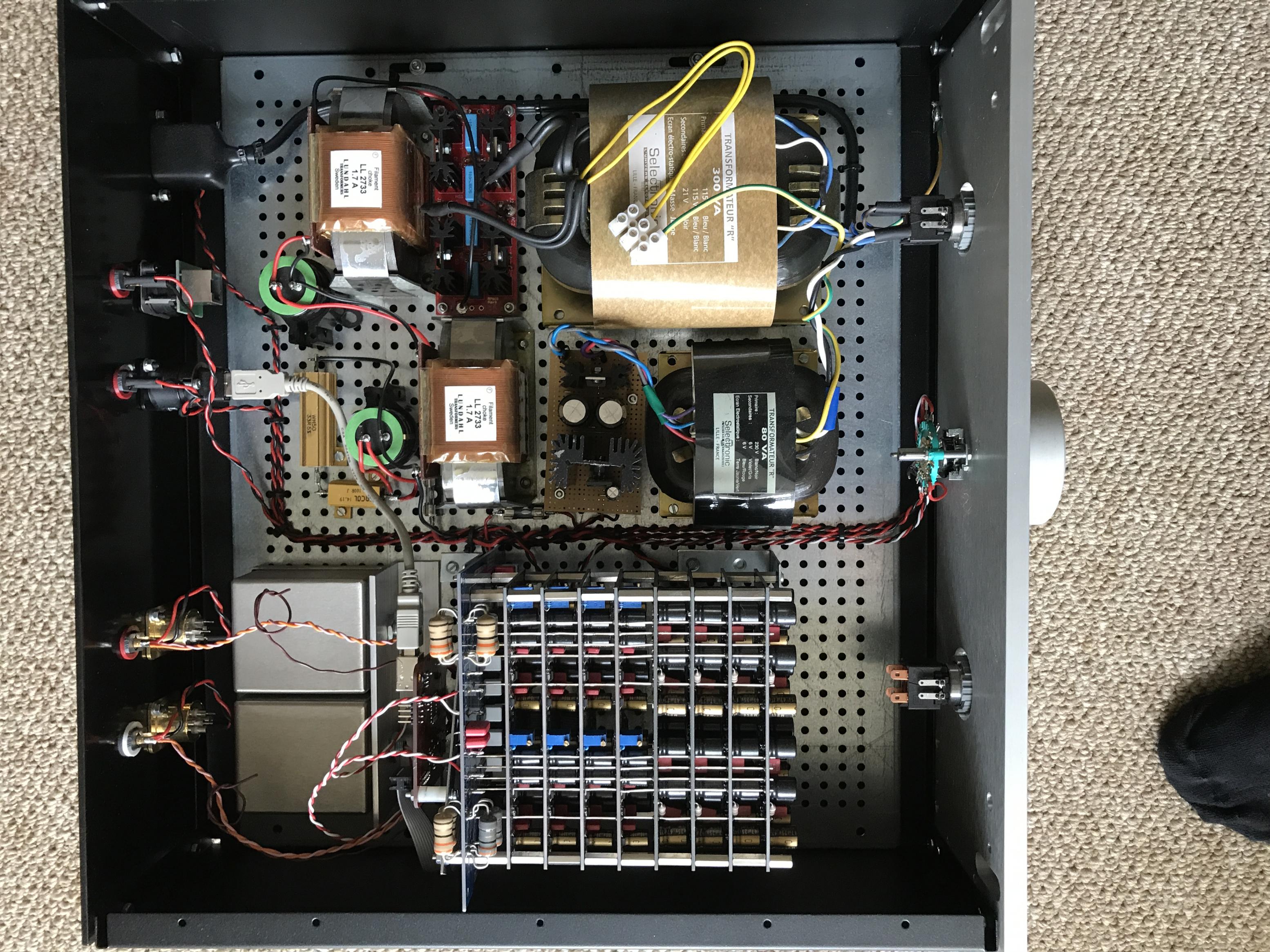

Nice setup. I really like the floating shelves that match the racks
Thanks 😛

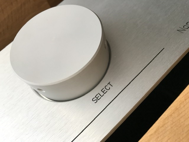

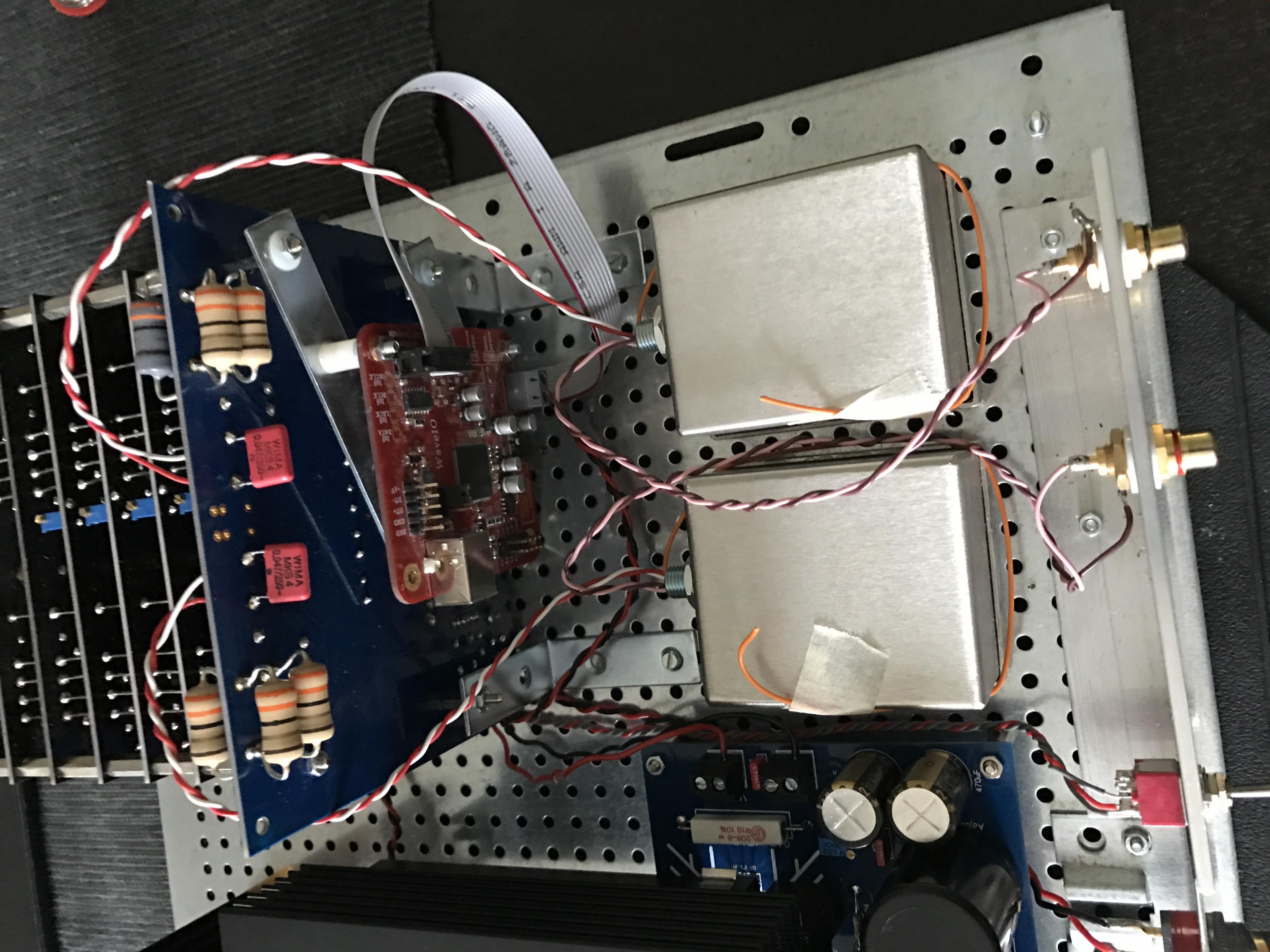

A few more pictures of my build where I had the control knob custom made in a machine shop 😀
Nice build!
I like the choke ps. Is it choke input?
Thanks!
Yes choke input
Building another DDDAC currently which is on my second system and easier to alter etc

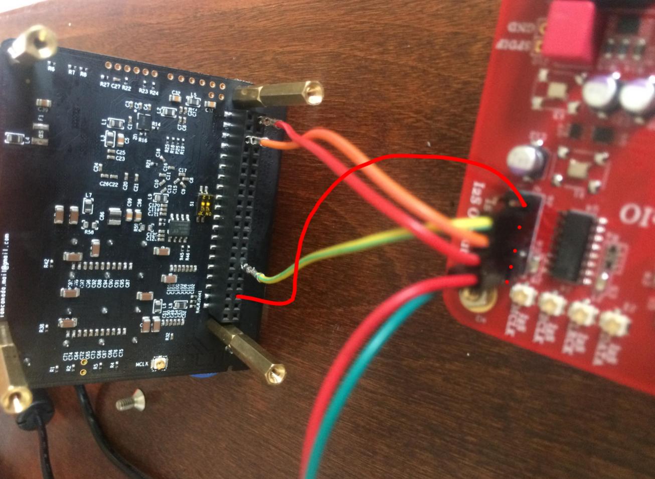

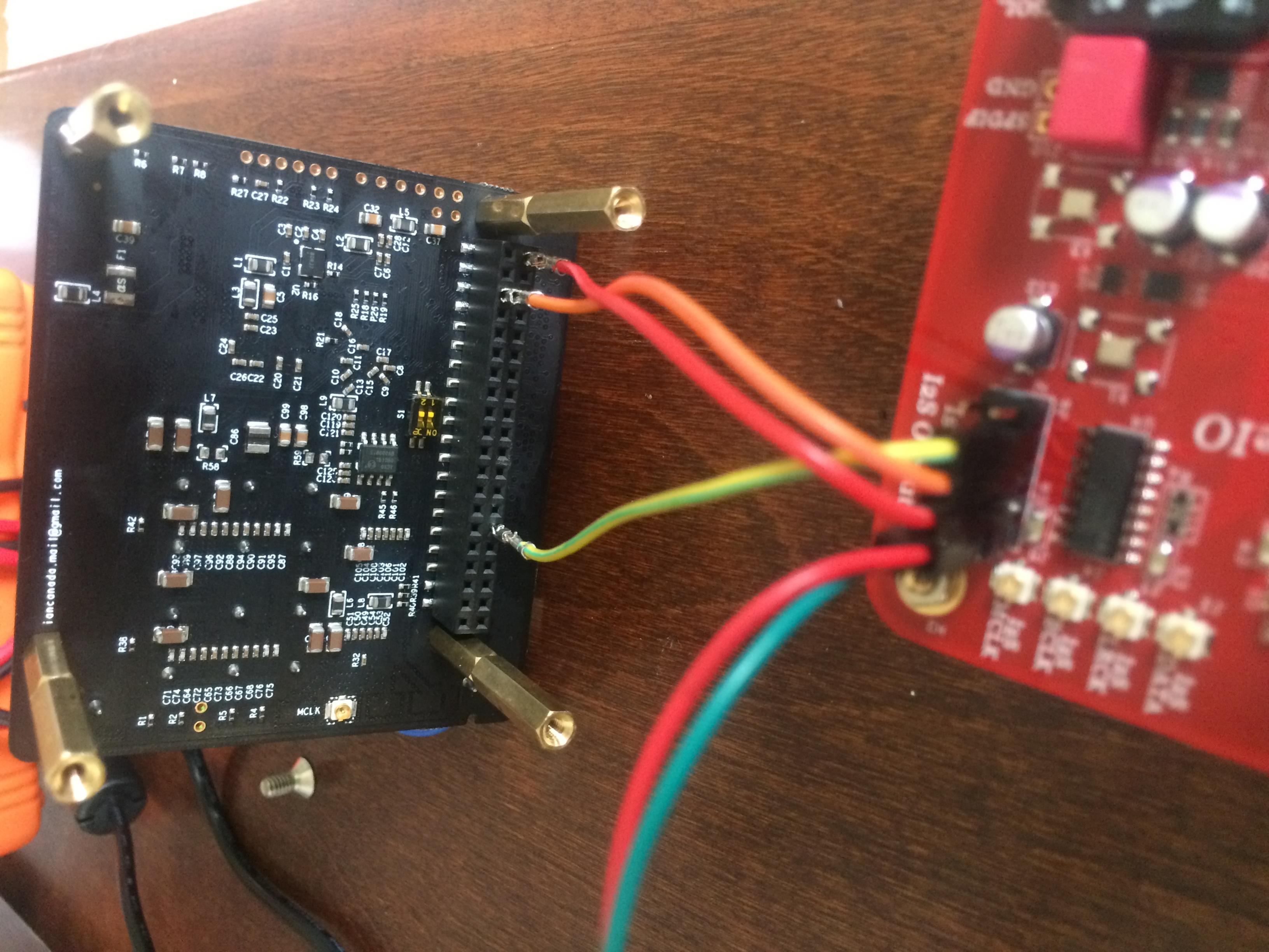

Can anyone think of why I can't get WaveIO and FiFoPi to work? I'm using:
5v --> WaveIO USB = recognized by the PC, appears to play fine
3.3v --> WaveIO isolator = good power confirmed by using a multimeter underneath the board on the V+/GND pins. FiFoPi's I2S LED lights up
3.3v --> FiFoPi digital = Empty buffer LED lights up
3.3v --> FiFoPi reclocker = Clock X01 LED lights up briefly, then switches to Clock X02
I'm using Accusilicon 45/49 clocks, installed in the correct orientation.
Everything seems to be in order but I am stuck on the Empty buffer; I cannot get FiFoPi to lock on.
Any idea what I'm missing?
Thank you!

try adding an I2S signal-ground-wire to the FiFoPi…
I had similar. Routing the signal ground through the power ground seems to add problems.
PS: the red line is painted quite badly. it is not really pointing to GND of the pin header. GND are all 5 pins closest to the edge of the board...
You are awesome. I added an I2S ground wire and got immediate signal lock. Thank you!!
You're welcome of course - enjoy 🙂

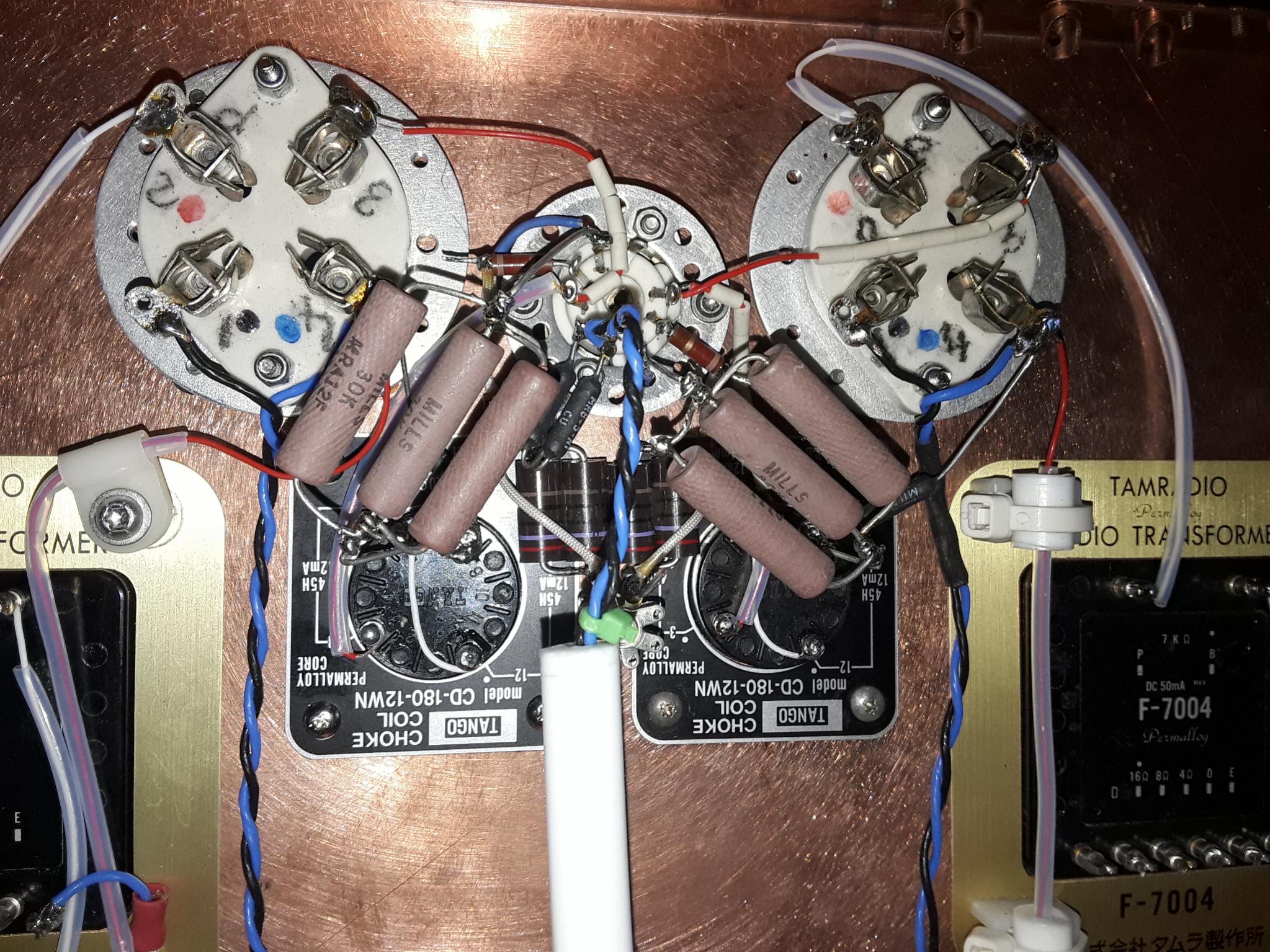

Very nice.

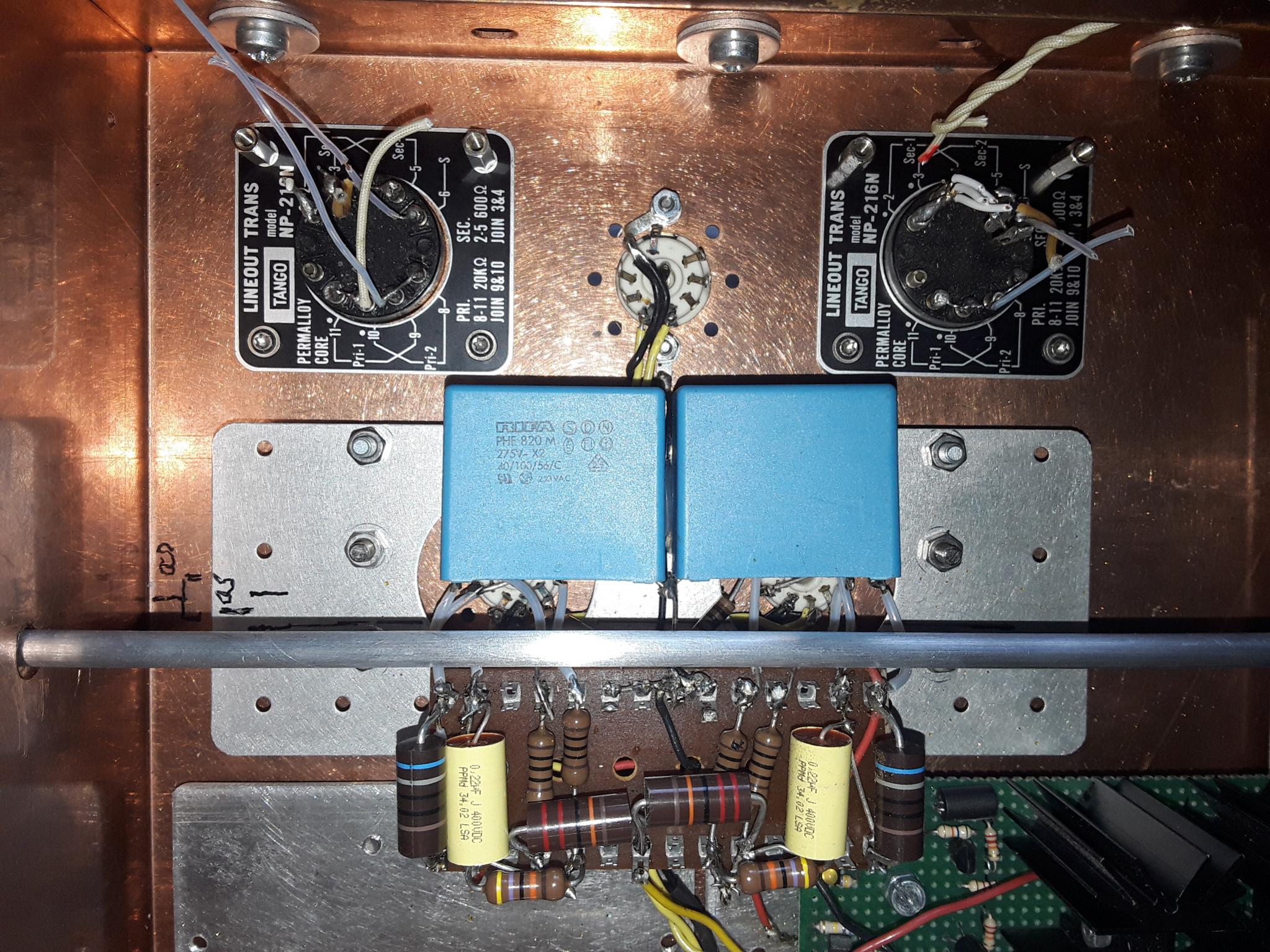

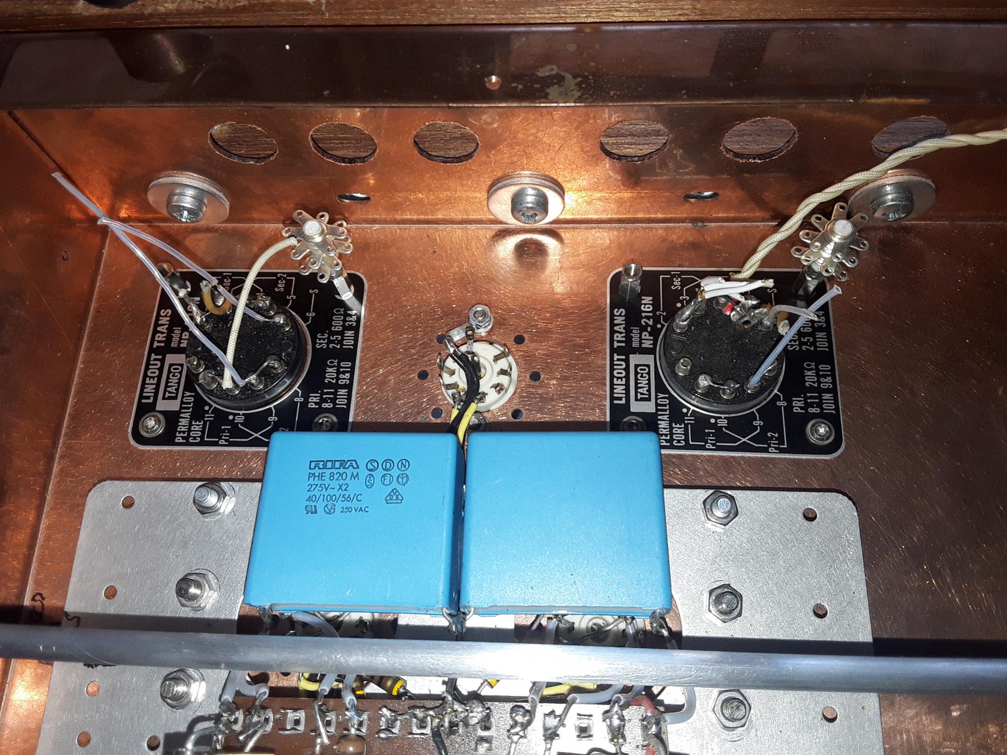

I see some very special Tamura transformers on the right
Are these the permalloy’s?
Hello Stefan Supersurfer,
Had them in the attic for 15 years or more. Bought in Japan in the good old days.
Greetings, Eduard.
P,s now line pre amp on the table ready to be finished in a few days. After a new chassis, a shunt supply with tubes ( Audiomagic) was added, now have to rewire one E80cc tube, AVC volume control, selector switch and some other stuff.

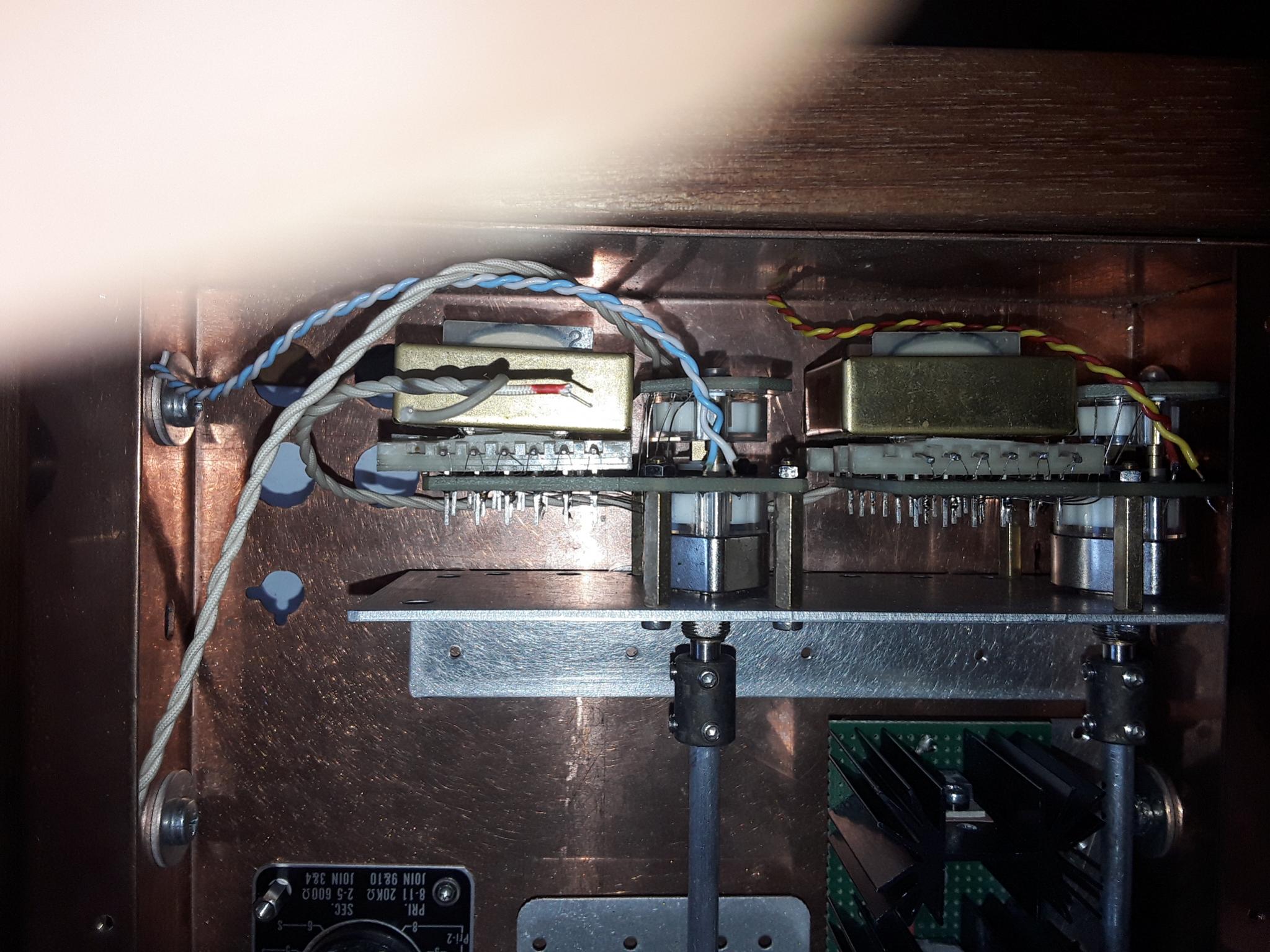

Cool! With the Tango interstages 🙂
Now back on topic fast, before Doede wakes up 😉
would these interstages be interesting as an i/v transformer on the dddac 😀😀😀
Hello,
I already have the Sowters designed by Doede.
AND audiocreative developped another one too.
I will wait for the information to sink down before doing new investment.
Greetings, eduard
