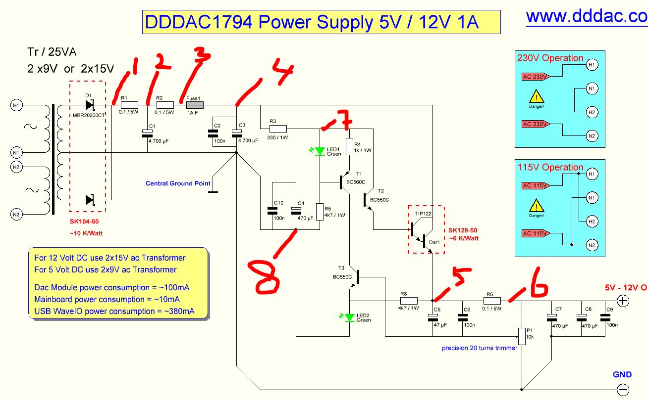

Hi Doede,
I got a 13 ohm resistor and tested under load:
No load - 5v at gnd, 12.76v at fuse
Under load - 2.9v at gnd, 9.84v at fuse
ok, there is something going very wrong after the mod here,
can you now measure on the following points with and without load and post back? (so I expect 16 values)
please measure all values against the GND output terminal

Here are my measurements, looks like the issue is around the point 7 area.
Load NoLoad
1 9.80 12.58
2 9.74 12.58
3 9.74 12.58
4 9.72 12.60
5 3.84 5.04
6 3.81 5.04
7 6.84 12.58
8 5.11 9.55

ok, let's start with this one...
still not logical...
The voltage drop suggest a very high current between point 1 and 2 there is 0.06 Volt drop with 0,1 Ohm -> 0,6 A.
Between 2 and 3 there is no voltage drop any more, so NO current.
Which does not make sense. The 0,6A must go somewhere. in C1? Pls check C1 / soldering
Point 8 should be GND, you should NOT measure anything more than (close to ) zero...
wrong measurement? or a problem with GND track?
Pls Switch OFF and measure OHM between point all points and GND terminal pls?

Hi Doede, I may have measured incorrectly, but regardless your mention of C1 caused me to look at the PCB traces and I realized that not all points on the positive side of C1 & C2 are connected. When I rotated the caps to the rear most positive hole and tested, it worked! Both PSU boards are calibrated and providing the correct voltage under load. Also added some Black Gates to the Mainboard and it sounds incredible.
