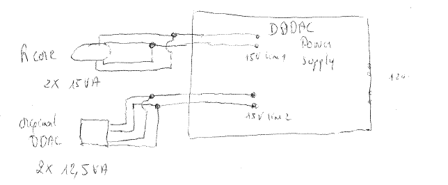

I have a dddac official power supply on which I changed the transformer to a Rcore transformer with a lillte increase in power as from the original transformer.
To what I read so far every board consume 100Mamp each so I "could" go up to 8 boards with one ddac power supply.
Since this new change I can hear a little "hum" coming from the power supply and the big heat sink has a temperature of 65 °C while running. I will check the power consumption this evening.

The new Ten decks consume around 150mA, or even more. The hum is not a good sign...
The hum is very low (only audible when I put my hear very close to the power board)
Is this possible that this sound exist becouse the is a bad solder somewhere on the two new boards I added as to my opinion if I exceed the 1 Amp limit on the DDAC power supply the fuse should blow?
The R-core transformer I am using is a 2x15v - 15va -> total of 30 VA. This should be one amp on each line.
Transformateur R-CORE 30VA 2x15V - Audiophonics

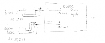

For testing purpose only would it be possible to connect the two lines of the Rcore to one power sppply line (to double availablle power) and do the same with the original toroidal transformer on the second line of the dddac power supply like on the drawing provided ?
I think new tent boards consume 200 mA each, so your total consumption now is more than 800mA - theoretically it should be ok. Check solder joints between top board and motherboard - probably bad joint somewhere. I recently added second board to my dddac with clclc psu - no problems at all.
After some tests on the power consumption 4 old Dac Board + 2 tent dac boards shows a consumption of 0.850A to 0.950A (I also see 1.147A after init)

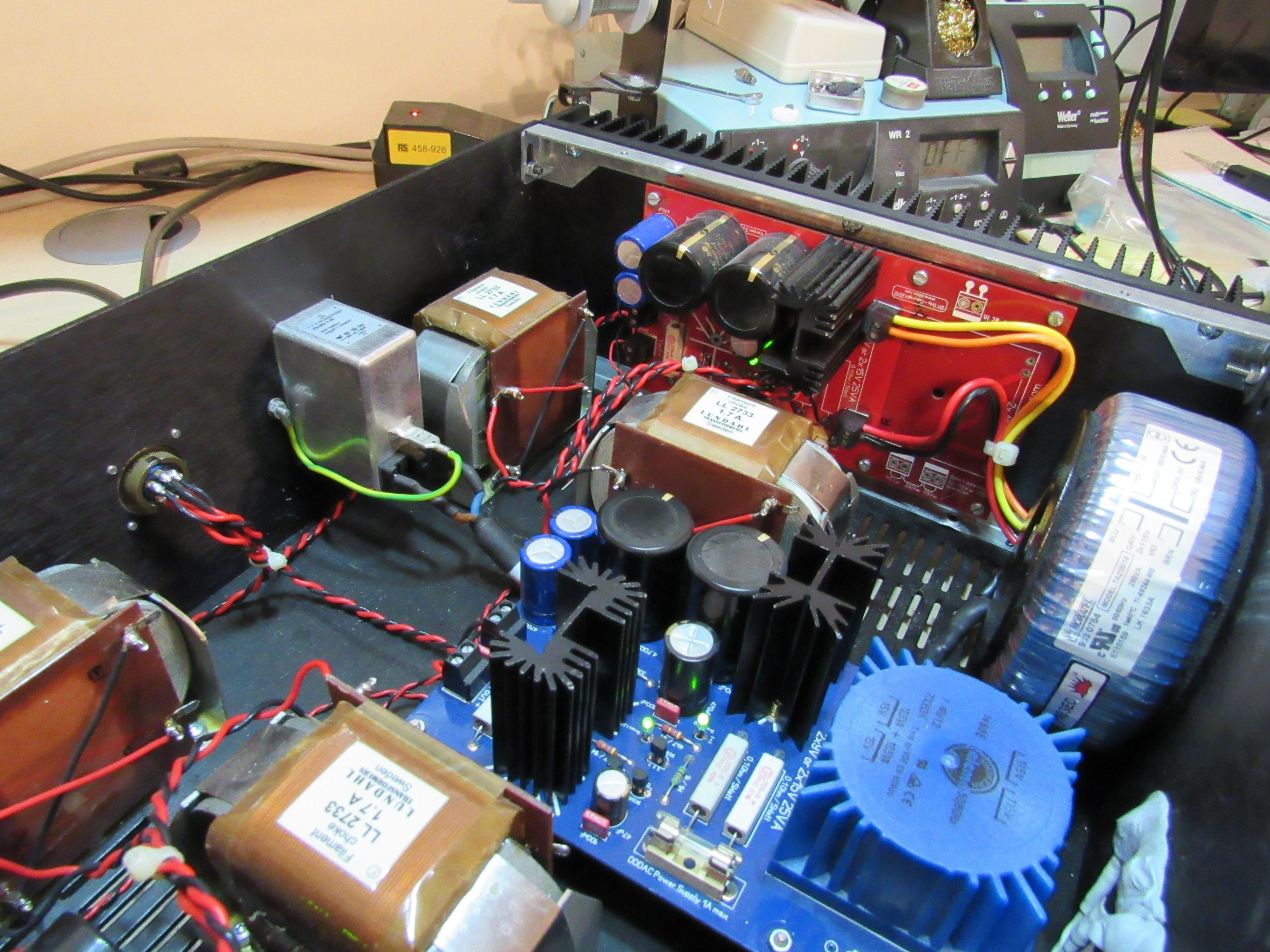

I have beefed up my power supply to power 15 Tent powered dac boards.
A pair of 250VA 2 x 18v transformers installed and I have increased the output voltage to 13.5v as I will be using 10R on the dac boards for a bit of extra smoothing
Nice work Alex ! By the way, what part is the heatsink on the blue power supply on the TIP transistor?
The heatsink is made by AAVID and part number 6399BG 50 mm height.
It still does get quite hot running the WaveIO and my I2S splitter but not too hot to touch.

There is a better one available if you don`t mind going up to 65.5 mm height which is: AAVID THERMALLOY*530002B02500G and has a thermal resistance of 2.6 CW.
I will use it because I leave the Dac on all the time and tend to go for lower temperatures if possible.
