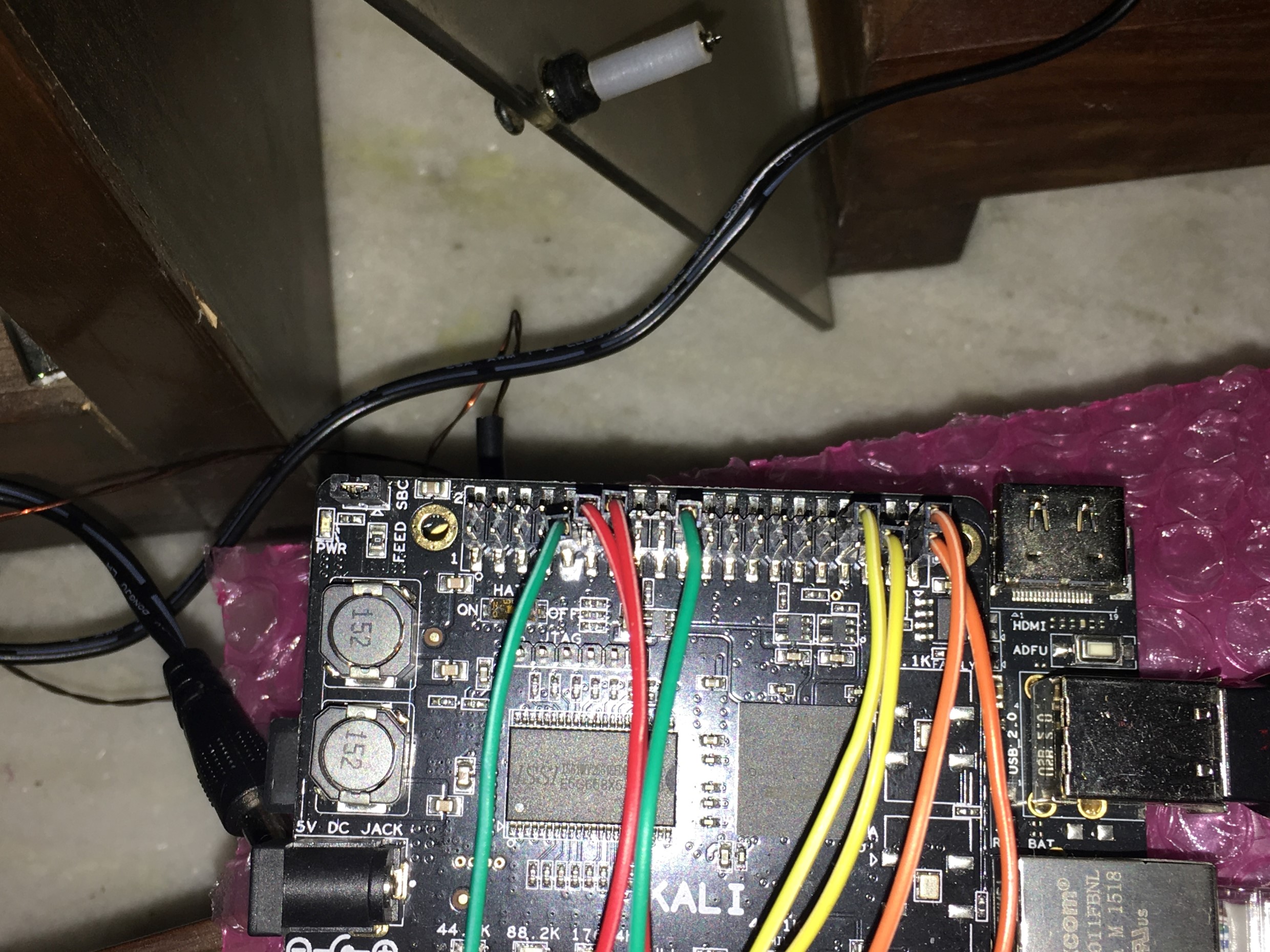

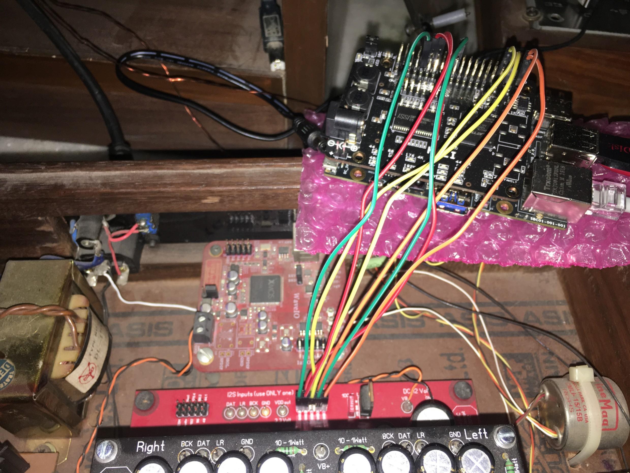

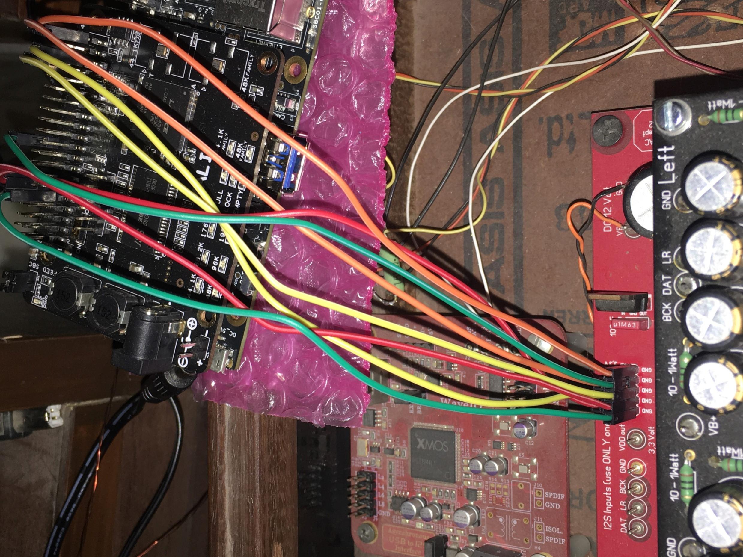

Here are the pictures.

Hi Doede and others, while trying to resolve the kali/DDDAC integration issue with Allo's technical team, I have received a revert which says:
"Your DDAC is working as right justified and our sparky/Kali are working as left justified. That is the reason for getting noise ,we cant change the settings."

Hello,
the DDDAC is internaly working as right justified, BUT the mainboard is converting left justified input to right justified.
DDDAC 1794 NOS DAC - Non Oversampling DAC with PCM1794 - no digital filter - modular design DIY DAC for high resolution audio 192/24 192kHz 24bit
So, from source side, the DDDAC uses left justified i2s signal.

In the meantime I can report that the Kali works perfectly with my DDDAC board. I haven't changed anything at all since my latest post where I wrote that the crackle / noise was "almost gone". I guess I have a bad solder joint somewhere on my DDDAC board, and warming up the electronics for a while made the issue go away. I haven't changed the WaveIO settings either. Just beautiful music out of the Kali + DDDAC combo. Highly recommended! One of my best DDDAC upgrades!
