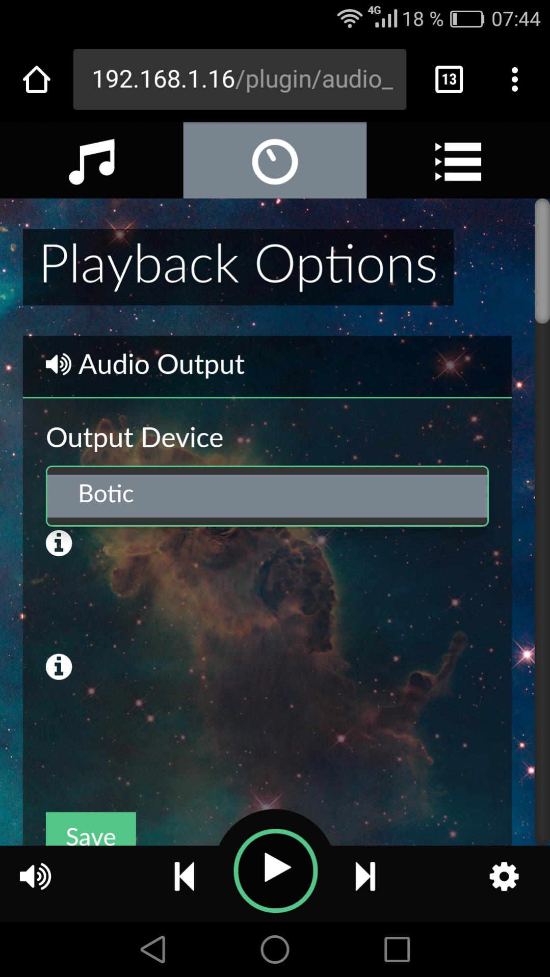

Hello guys, I need some help configuring the BBB to run directly with the DDAC without the main board.
In post 4705, user jptz explained how to do so, but I have a question: the last instruction is "In our MPD client program we have to choose "Botic-Split" as output device." - that means that in Volumio I have to change the output device? After all the modding my volumio still only show "Botic", no "Botic-split"
I am running the latest debian 8.7 and have the latest volumio 2.129.
Thank you !
Thank you !
You have to configure that with putty, it's linux command line.
Some resource here http://bbb.ieero.com
