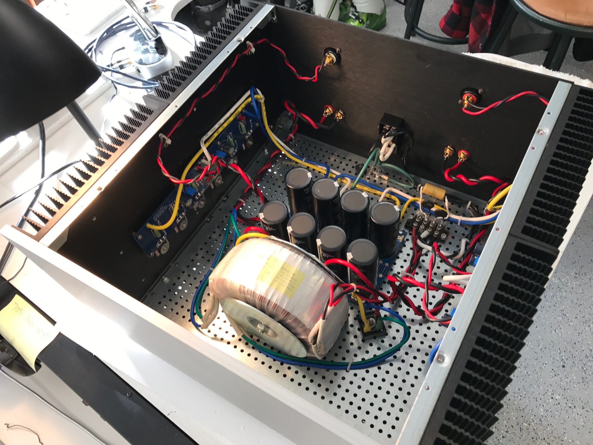

Are you measuring the bias for the f4 in the correct place? It should be around 0.2v or 200mV. At 2v you are likely to be running the thing way too hot. Probably fatally so. Check post 1 of this thread.
Are you getting 120 degrees Celsius or Fahrenheit?
125 Fahrenheit would be OK. Celcius not so much. The heat sink shouldn't get hotter than 50 or 60 degrees Celsius. You should be able to hold your hand on it for 10 seconds as a rule of thumb.
It should also take about an 30 minute to an hour to warm up. If it's getting hot in a couple of minutes I think the bias is way too hot.
I wouldn't think that the preamp gain would affect this. But it may be worth checking your preamp for dc offset at the output and that the volume control doesn't affect that. More gain from the preamp should only mean that the f4 is driven to full volume sooner on the volume dial.

If you swap the left and right channels of the preamp going into the f4 does the fade fault change to the other side?
If so that fault is in the preamp.
I'm a bit surprised that the left heatsink is so much hotter than the right. Maybe worth checking component values of one output board against the other.

well , tidy arranged , so I can't see any possible culprit
however , few questions :
- origin of input JFets ?
-mosfets properly matched ? did you checked voltage across all source resistors , to be sure in actual equality of their Iq ?
-did you checked equality of mosfet temperatures - measure of their equal torque and temp. transfer interface ?
considering that your sps are 4-ohmish , up to (say) 15W amp is in pure class A envelope and up to there , heatsinks are even cooler than in silence ; above that , there is AB (KLUNK!) transition and heatsinks are going to be warmer
again , no reason to be feared even of 60C at heatsinks , as long you're sure in your build and as long sound quality isn't worse without known reason (which could be clipping)
when you achieve proper thermal and sound quality behavior , you can always try that one amp in balanced mode , feeding just one speaker
I believ that should give enough info about difference between 50 vs. almost 200W at 4 ohms

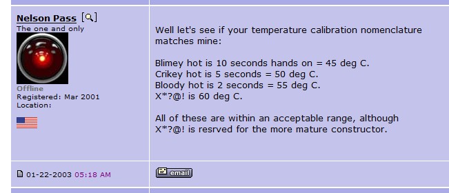

IRFP240 &9240 are rated at max 150C. To be safe Firstwatt recommends 55C as they should, a child or wimpy adult may get burned. Brave diyer's are not afraid to go higher. Consensus is the higher you go the better it will sound until it catches fire. I would assume higher temp shortens life. No big deal really for diy'er, replace a few mosfets. How far is one willing to go for best sound. As Zen stated, I am not afraid of 60C or even 65C with my BAF-1. My F4 runs 50C to 55C standard bias. Maybe someone will play with highest bias vs sound before smoke and let us know the result.
you don't need thermometer
all you need is Papa's hand ; though , it's probably cheaper buying modern laser thermometer , then lending Papa all the way from Sea Ranch
A trusted board member - Alex from Israel. Parts were confirmed by a local board member who has more tools / toys. He says they are nicely matched and measuring as BL grade Toshiba parts should test.
Ehhhh, I may have mixed "sets" - as in I ordered enough for four boards. Result is I may have the troublesome board's P channel and N channel not as precisely matched as intended. I measured a small difference across N and P channel source resistors on the same board. The N channel and P channel by themselves were consistent. I tried measuring from one side of one resistor to the other side of the other two resistors and had exact matches as far as measuring bias voltage. Didn't try measuring from N to P because it didn't feel too smart :roll eyes:
I did not use a torque wrench, but have a fairly good idea of what 11 inch pounds feels like. I had a machine shop (which primarily makes part for local semiconductor plants) drill the holes in the heatsinks, I bought the drill bits for them to drill a 65-70% fit vs the tighter 75% fit tolerance. I chose this because I've had problems with taps purchased post 2010 and wanted to make cutting threads as easy as possible, not seeing an advantage to the tolerance of the threads. Earlier in life I had training on how to tap very expensive parts. I don't think the mechanical fastening is the issue. At the same time, this does scream short! to most people that understand the electronic side.
The interface is Tgard 5000, it seems sturdy. No signs of wear. I replaced them the first time I removed the MOSFET's from the heatsinks but don't see a reason to do it again, they appear intact.
I don't see anything in there about where I came up with 11 inch pounds, maybe I'm talking out of the wrong hole.
As far as ids matching goes, third party mentioned said they were very good.
There is a little difference in temperature, but nothing more than 3 degrees f with my limited ability to measure temperature. (not going hands on to measure inside the chassis, electricity safety jokes are not a good idea so I'll drop it for now)

The F4 has been running for a few hours now, first attempt at overheating it said 119f for right, 128f for left. Left is one with differences in MOSFET P / N. - my fault, not seller.
I wrote the above over a week ago, since then I had some bad sound coming through the left tweeter, grabbed the laser thermometer and it read the opposite temperatures, lower on left channel. I increased volume more, let it continue to run then had increase on left channel. Maybe I’m being more cautious with music selection and volume. Only thing I have changed is using bare wire in the amp and speaker terminals instead of cable ends.

If temperature calibration is using hands as Papa says, I’m running a lot cooler. It’s usually like a nice warm heating pad.

regarding temperature , 55C (131F) at top of heatsink is normal temp for FW amps
