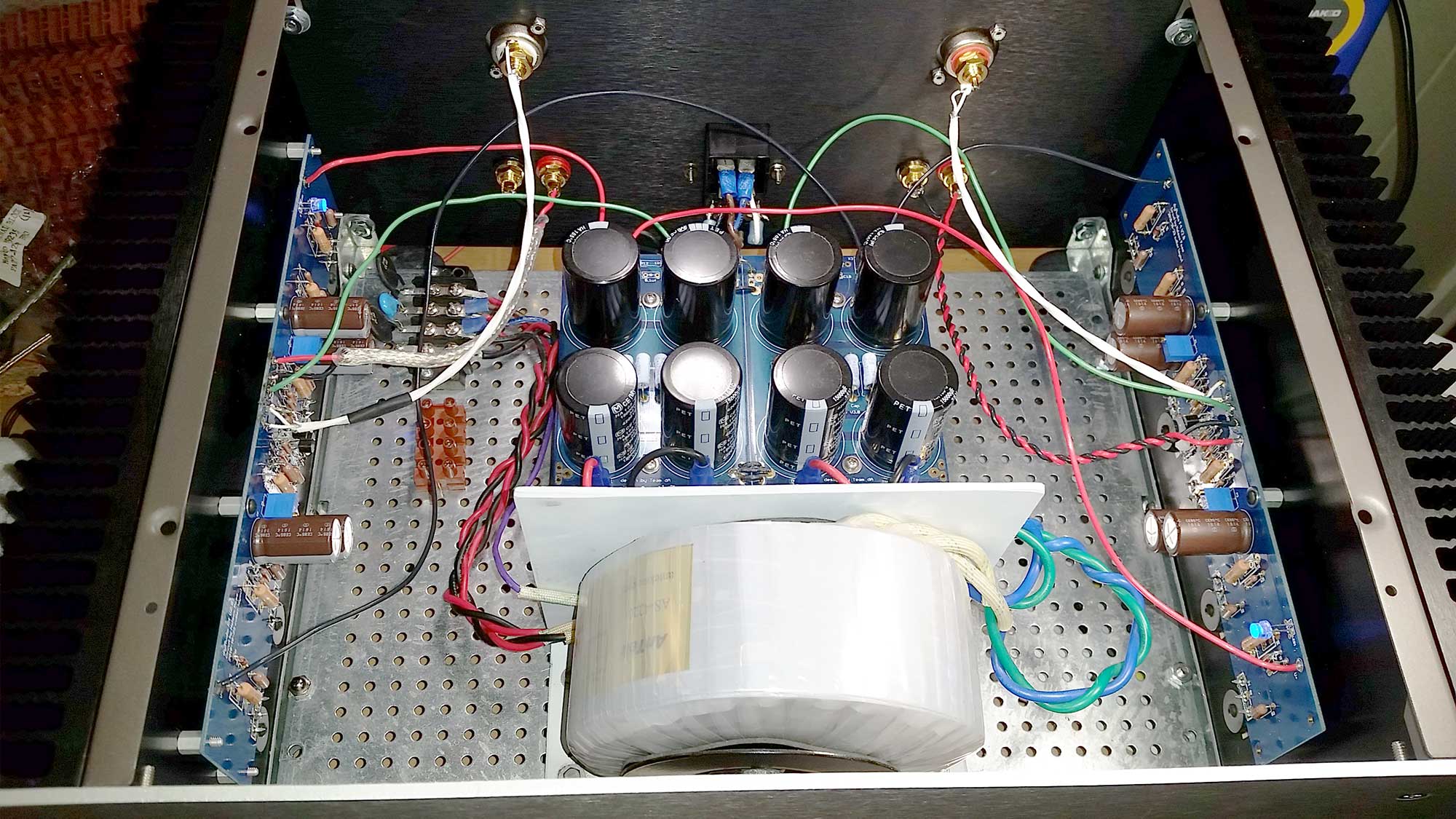

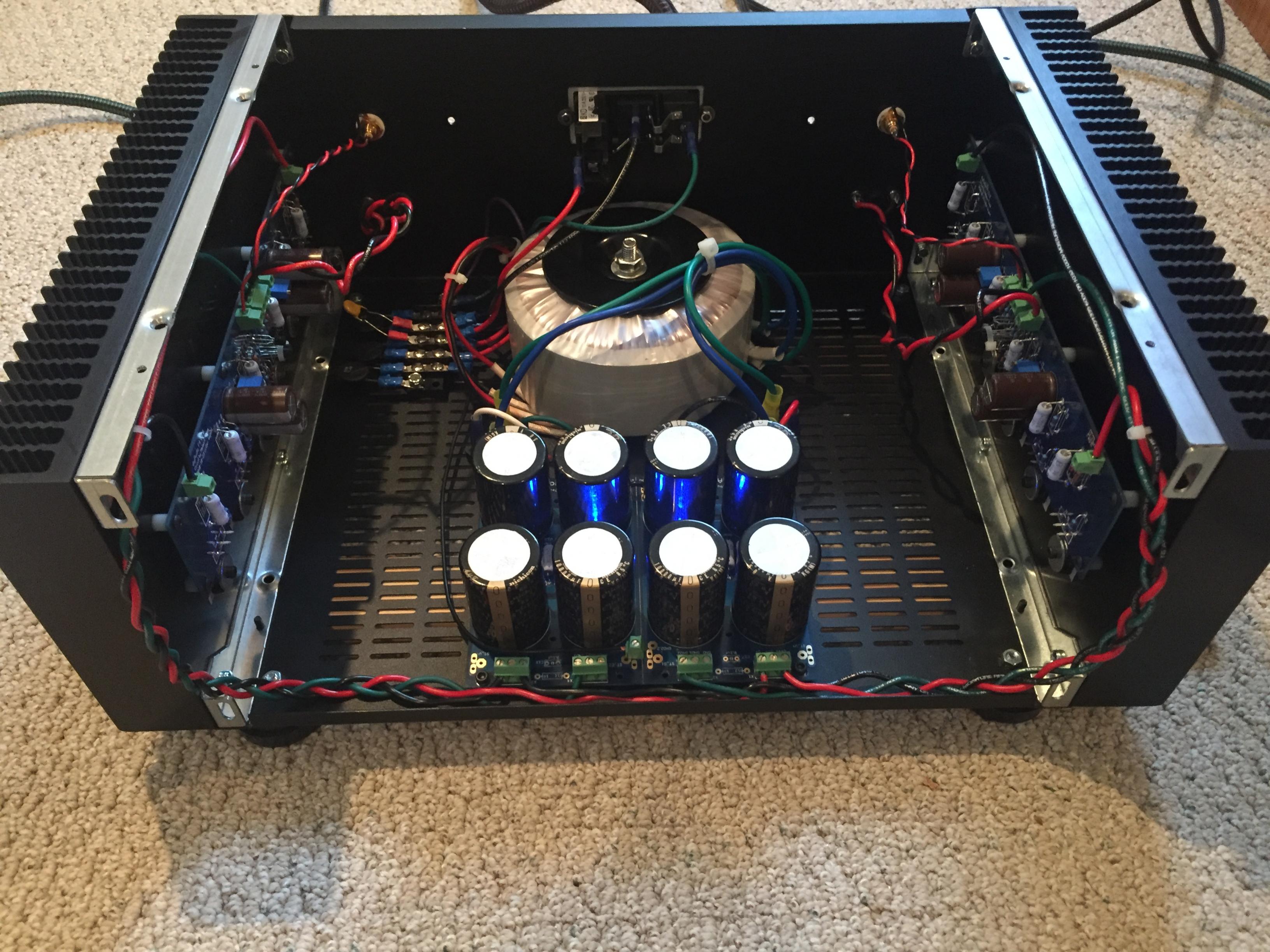

Finally finished the F4. Other than a couple bone head moves on my part while biasing, it worked right from first power-up. That's a new experience for me, usually there's trouble-shooting.
This thing sounds scary good :ghost:

I've been listening to this for about 200 hours. Sounds great as long as I'm not expecting it to recreate a live rock performance.
Using an Aikido 6SN7 preamp, playing FLAC files off a Macbook Pro, no external DAC yet.
http://www.diyaudio.com/forums/attachment.php?attachmentid=606984&stc=1&d=1490203477
About 40 hours of listening ago I put GE 6SL7GT's in V1 and V2, changed resistors as recommended in user manual and increased voltage to ~295 from ~255.
F4 bias is 2.01v average on left channel, 2.0v average on right channel
If I go for the rock album after warming it up (about 120 degrees on heatsinks), the right channel starts degrading in sound before fading in volume. I've measured as high as 145 degrees on the left heatsink. Right heatsink doesn't climb, but doesn't go down in temp either.
This morning tried swapping V1/V2, but haven't swapped V3/V4. Same results after hour plus warm up then listening to loud bass. It happens quite fast, less than two minutes - but I'm expecting it, constantly monitoring temperatures. It climbs to about 125 degrees.
Maybe it is too much gain, will try swapping V3/V4 with known good 6SL7.
Original plans to build two of these and run them bridged - I'll probably scrap because of the difficulty of getting both sides to behave exactly the same.
As visible in the picture I don't have the wiring tidy and exactly symmetrical. It was just fine with the 6SL7's and didn't want to touch a thing. There is no hiss, AC hum, etc. Silent.

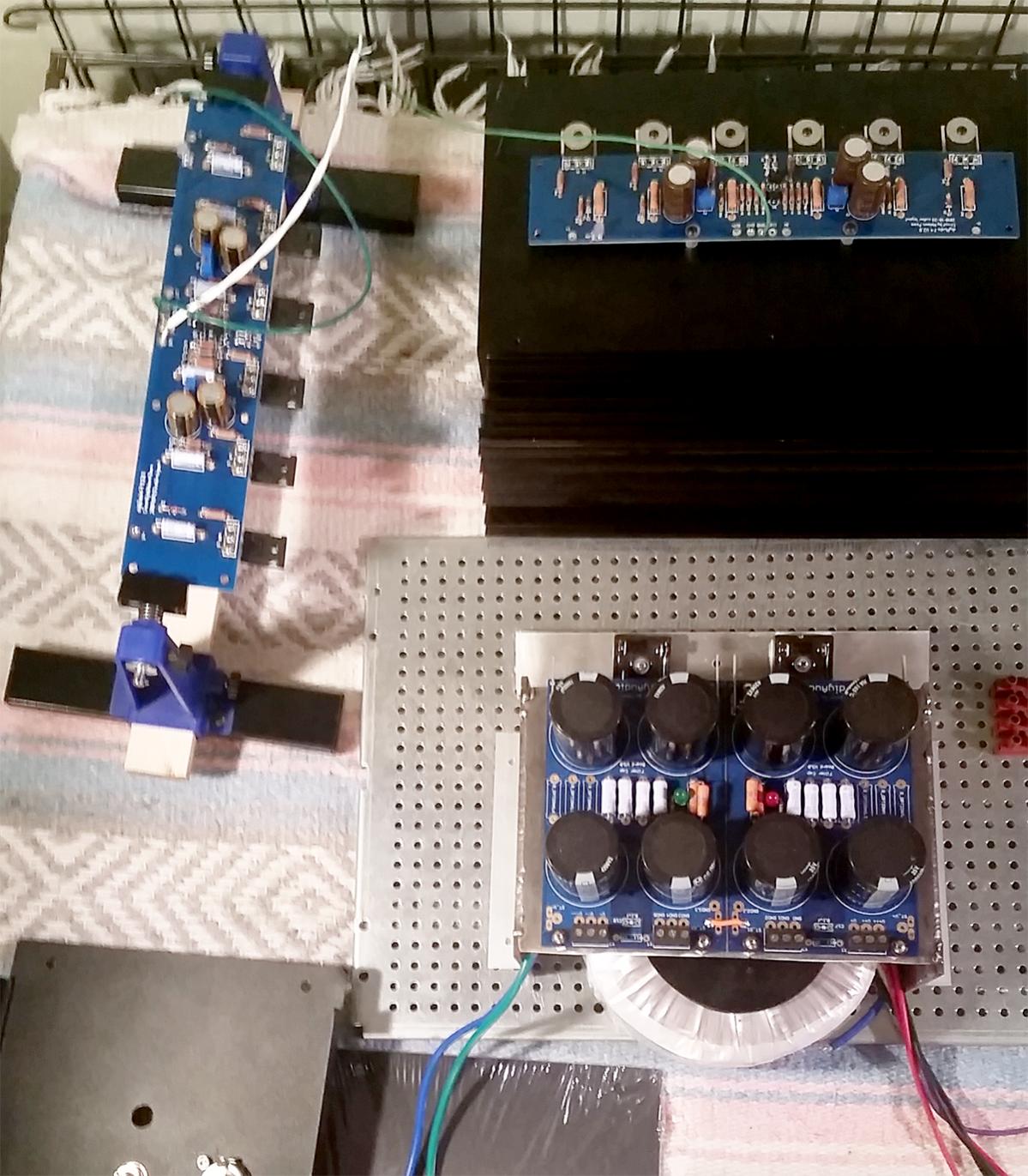

Here are a couple of boards in need of replacement MOSFET's, along with a different way to stuff the transformer / heatsink into a 300mm 4U chassis.
http://www.diyaudio.com/forums/attachment.php?attachmentid=606986&stc=1&d=1490204328
