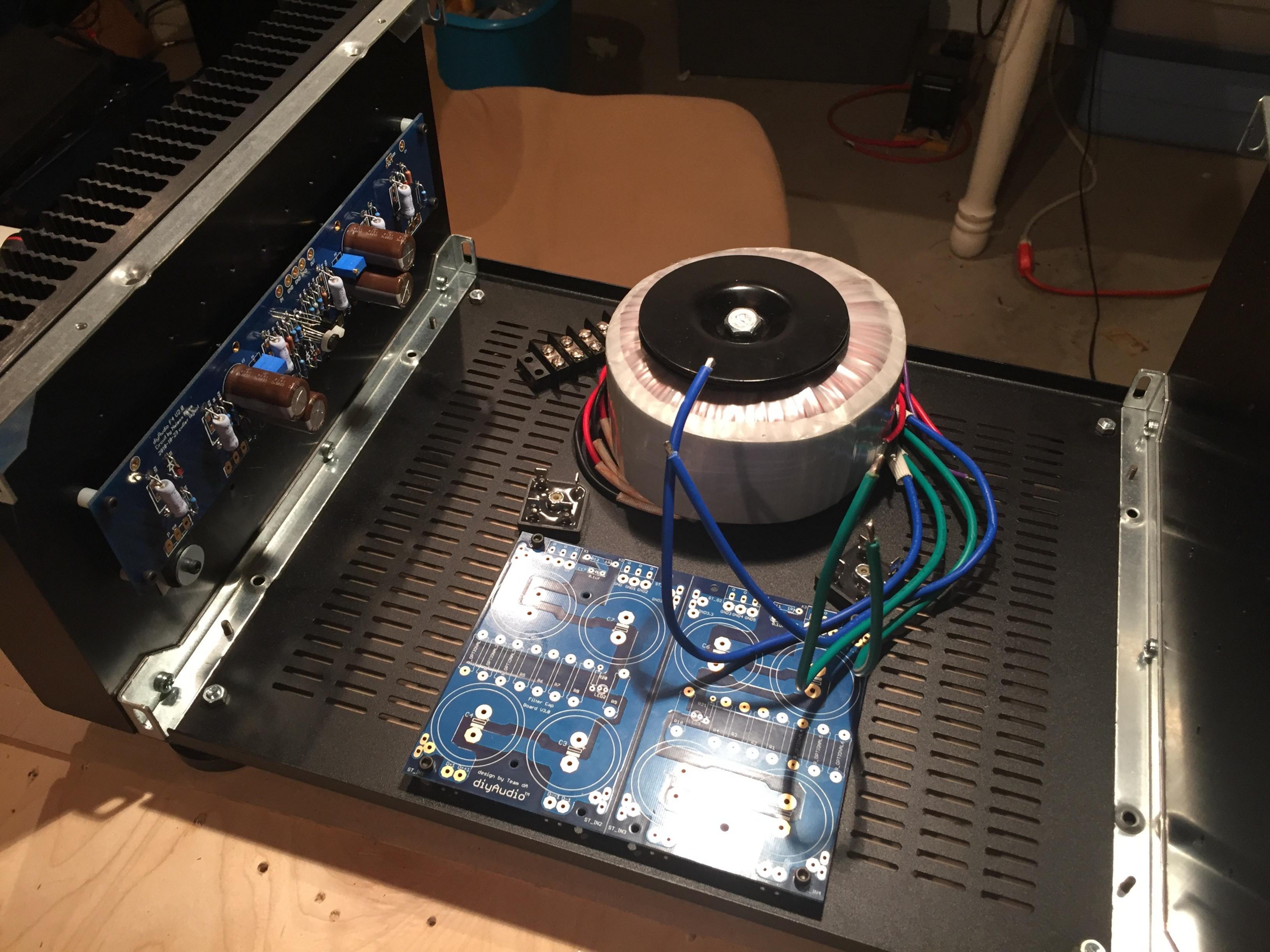

I've started building an F4. Today I've been able to stuff one channel. This represents ~2 hours of work for me. I think this is the easiest part of the project. The part I find least enjoyable is ordering parts.
I used KOA Speer MF series resistors this time. These resistors are color coded which makes them a pain if you want the bands all facing the same direction. All other parts need are in the house. Chassis will be delivered Monday and then goes to the machine shop. I hope to carve out enough time to finish this project and be listening to it in two weeks.

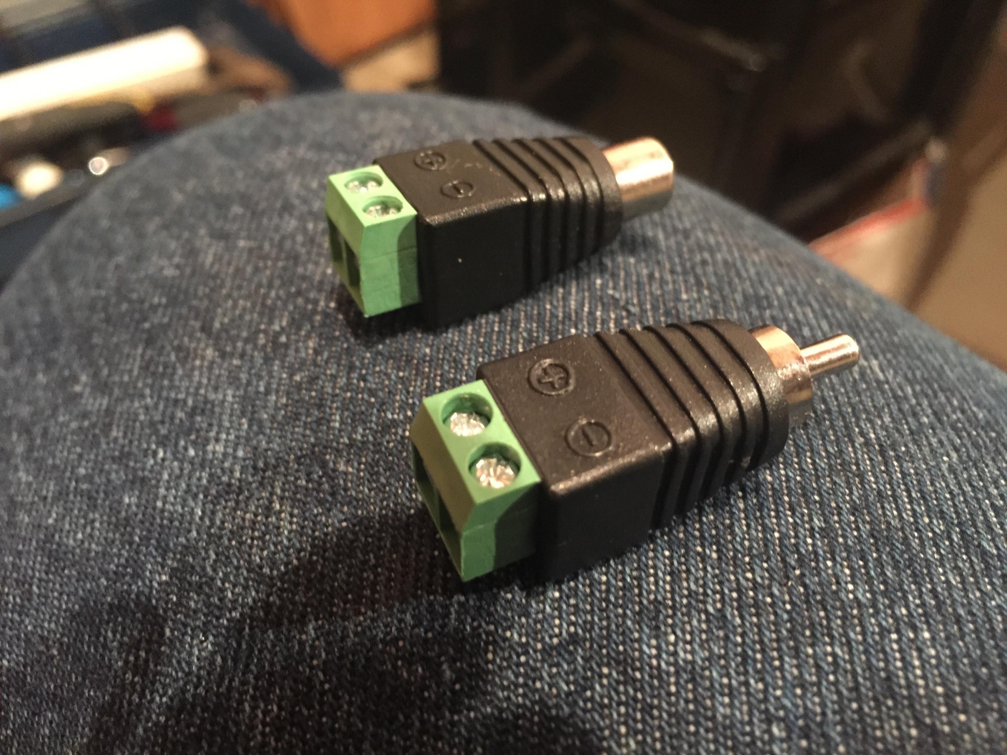

On a side note I found these at Parts Express while shopping for RCA inputs. They are very useful!
