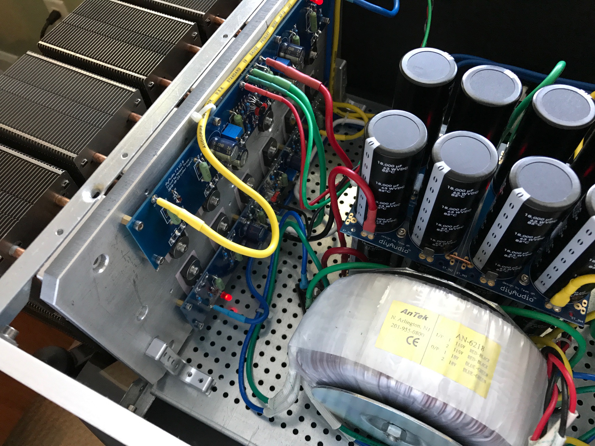

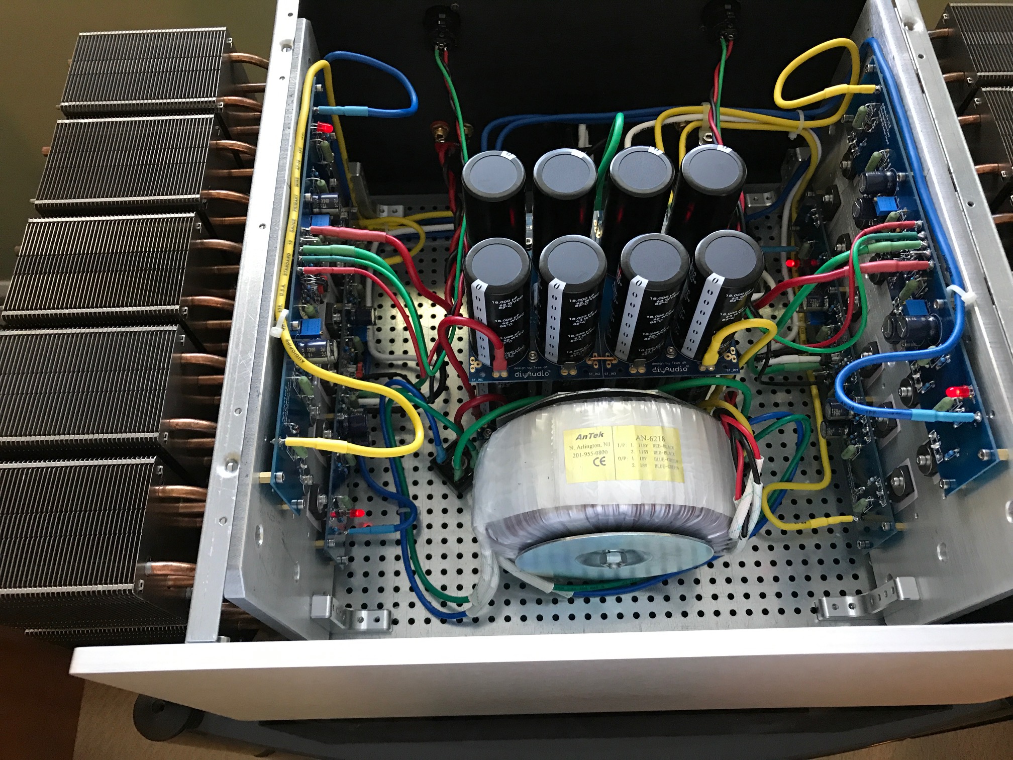

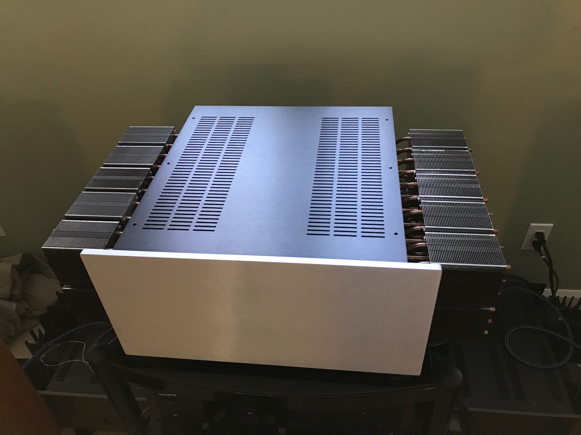

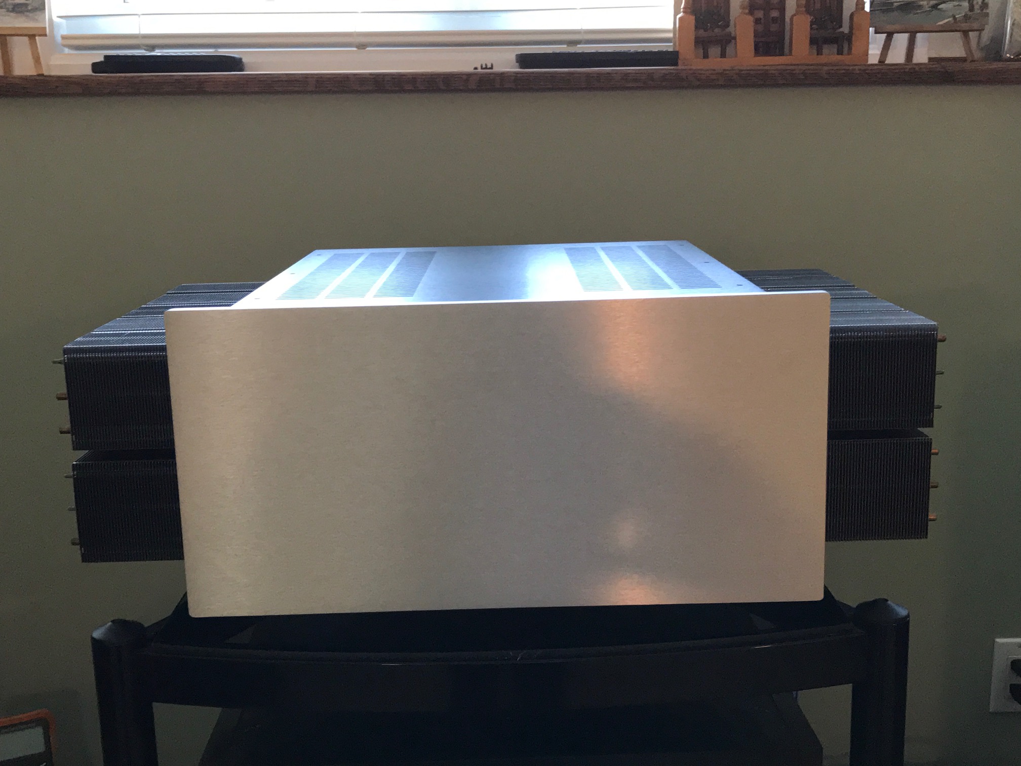

My Second Amp
Technically just my 1st amp reconfigured, as I to wanted to build a F4 Balanced amp, but in one chassis.
I hunted down a bunch of obsolete Dell heatsinks that I bought for almost scrap value. They were banged up and bent so I had to straighten them all by hand. But I liked them because they had 3 "U" shaped heat pipes with lots of .010 alu fins.
I machined up a couple of alu mounting plates to hold the F4 boards on one side and the heatsinks on the other. I also machined the heatsinks to mount them flat against these plates and put in the mounting holes.
I used 10 heatsinks per side. I liked the results. They move the heat very quickly.
I was able to bias each of the 4 boards to 250 mv. That keeps all the devices under 60C. -- 50-56C depending on inner vs outer placement. The heatsinks are tracking 2 to 3 degrees cooler.
The 600 VA trans is also at around 60C. I think it's struggling to keep up?
This thing is throwing lots of heat. That's OK with me as I'm Canadian, and "Winter is Coming"

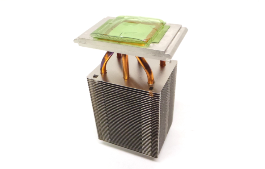

Wow 10 on each side! That's really nice.
Off topic a bit, and guessing you looked into this; at some point as the fins get closer together they restrict the airflow - do you have any idea what the trade off is?
I'm guessing these originally came with a fan?
What is the total dissipation?
That is very nice, thanks for sharing
These are heatsinks that came inside the Dell Optiplex GX280 computers, so there was a shroud and fan to maximize cooling. I looked around for something using heat pipes and a large surface area utilizing alu fins. And I didn't want to spend a lot of money on them.
For these, I couldn't find any dissipation numbers on Google, but each heatsink has 42 fins at 2.5 x 3 inches. So that's 315 sq inches x 2 sides = 630 sq inches, less the heat pipe holes etc.
The fins don't move as the alu is coated in a clad material that fuses to the heat pipes and other alu touch points as the assembly stack passes thru ovens at manufacturing. I've run the amp for several days now, and nothing has moved, it been fine.
Thanks for your interest.
