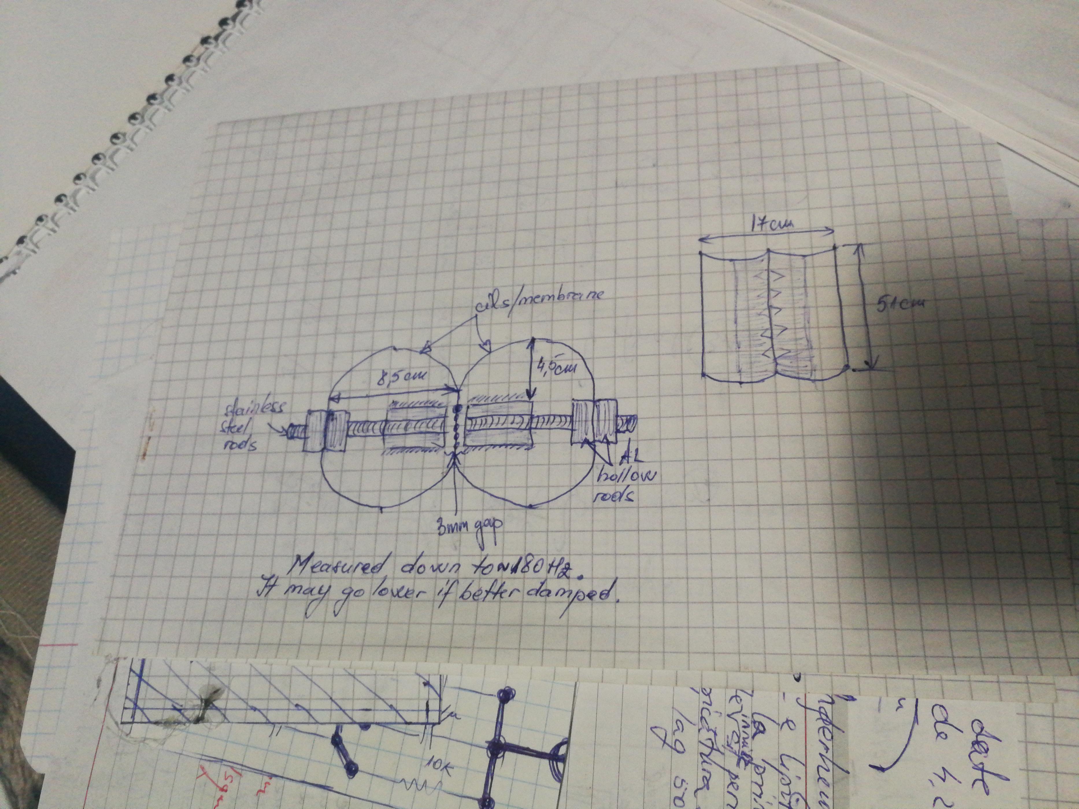

Thanks Sparrowlegs,
There is no secret, it never was. I posted everything here so that everyone could do it. Again, if someone finds out more please post. I'm looking forward for futher upgrades. Here are my actual dimensions, measured now. Pics bellow.
The cils shape is a bit of a butterfly shape, not perfectly round (abit oval to the center and round to the exterior verical Al clamping rod edges) .. It measured better and had better performance soundwise, as you have seen from my previous measurements. The verical Al rods for clamping are damped with foam at the contact with the membranes. I took a pic because i dont think i could drow so explicitly.

Looks its just a offer? Everything has a standing wave, resonance frequency etc... everything can be calculated depending on how much data can be offered hence why finite simulations exist. Mostly though you can get a ball park estimation.
Anyway I've added a video to show a basic idea, if it helps.

To counter the atenuation and proprely measure whats actually going on there i strongly sugest that measurements should be taken from a very close distance 1.5-5cm and off axis.
For a real SPL figure in dB go to or make an anechoic chamber.

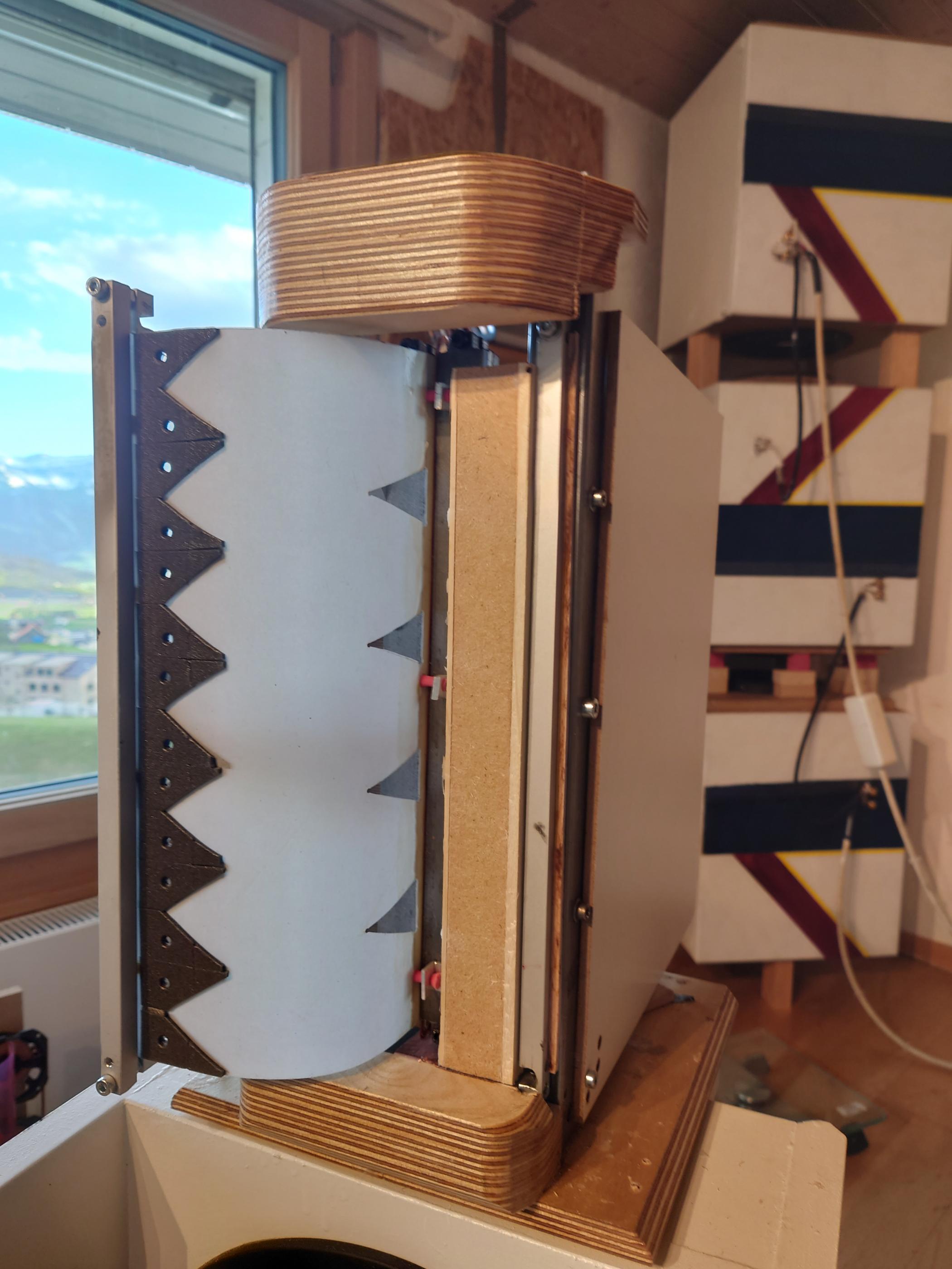

Now I've optimized the suspension. It's much softer now.
Anyone who has already built a very good ruba will only hear a small change. I think it's worth it anyway. lower frequencies in particular sound better. but also cleaner overall.

Hello sergiu
What is the best distance for you from one cut triangle to the next? I'll test the beeswax. Are there no temperature problems?
I'm now testing with only half a cylinder
regards
regards

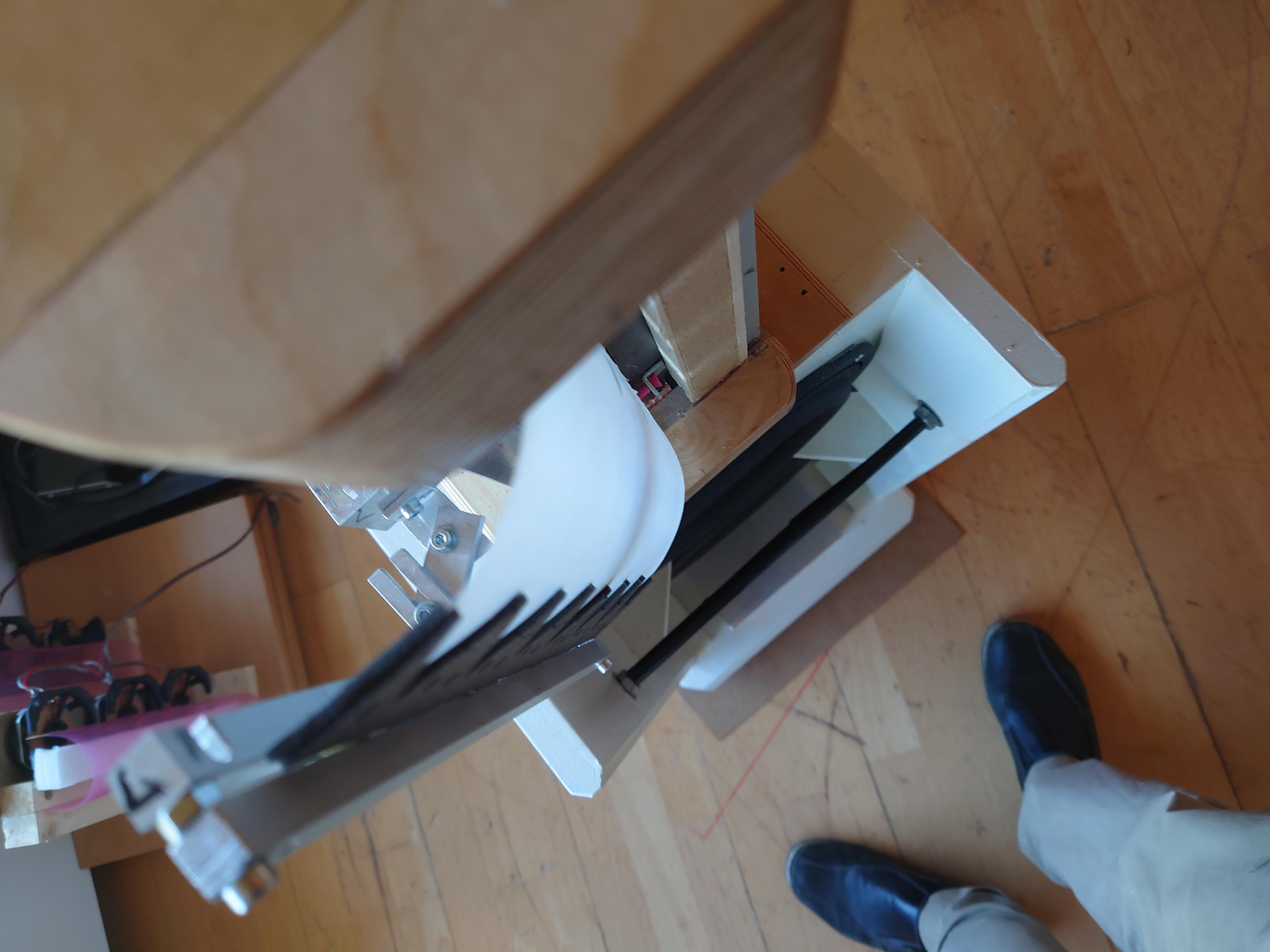

The rubanoid is dead
Half the membrane will remain. No longer a cylinder, but rather an L shape.
The outer ruba membrane has to stay, this is important because of the high frequencies. The loudspeaker should move closer together and less angled.
Sound: orchestras are shown larger. the high frequencies are much more differentiated. the sweet spot is bigger. I also don't miss any dynamism.
With that I end my contributions on the rubanoid topic.

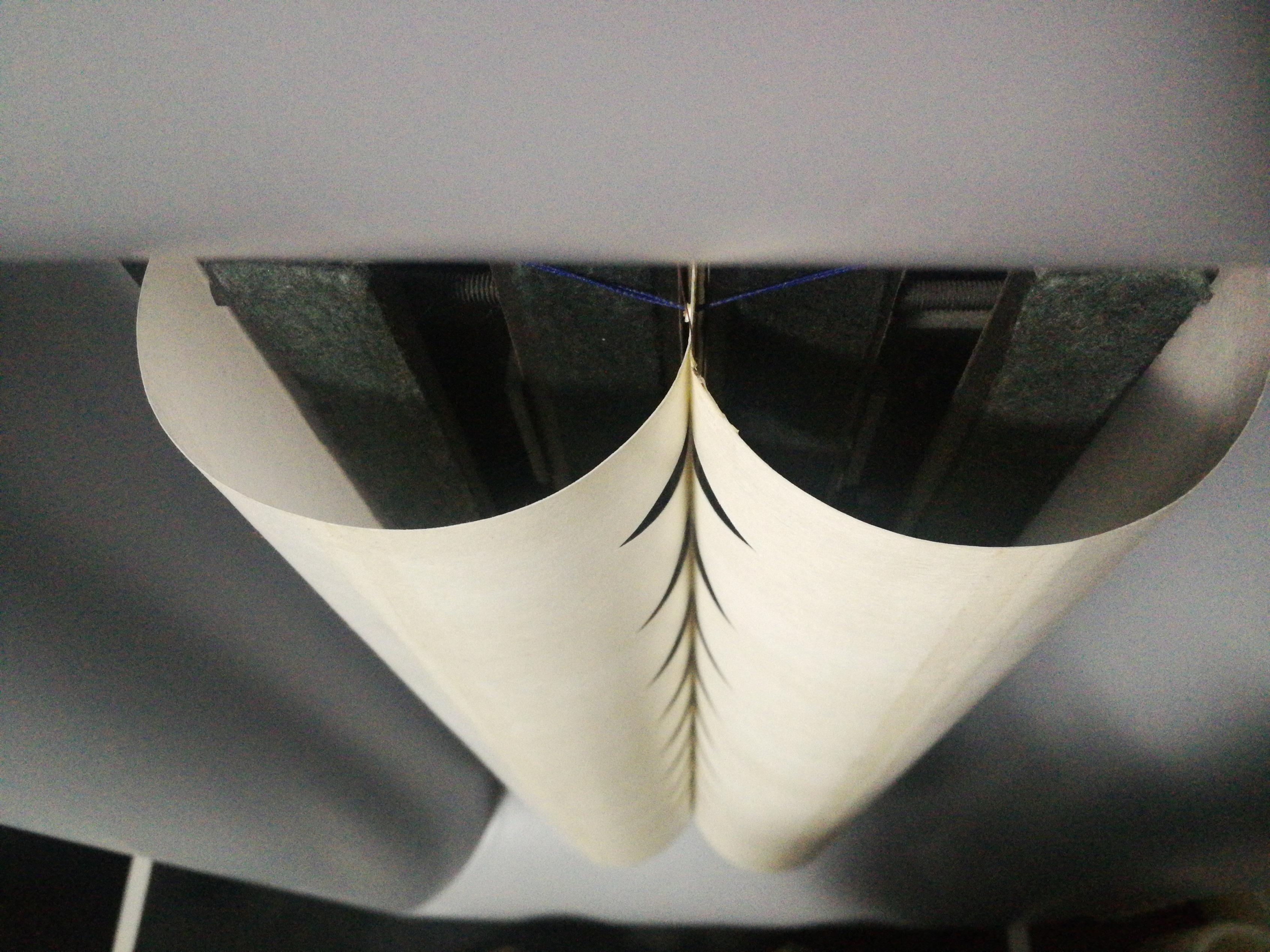

Hi peril,
The triangles have a base of 2.5cm and 3cm height with 2.5cm space between the triangles.
What problems? I left the rubas in the bathroom after a shower singing at low level for an hour with no probs whatsoever. It must be a pic somewhere in this thread with the rubas standing on the toilet closet... 😂 It was an extreme test but hey, thats me.
