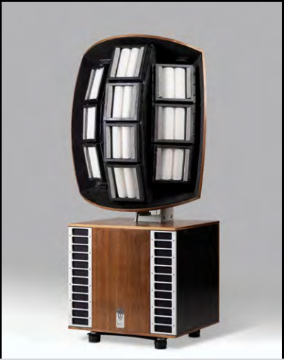

MC Audiotech Forty-10
While thumbing thru a recent Stereophile, stumbled on a blerb about the Fort-10 and thought of this thread.
A search didn't uncover any postings on it so figured I'd add one.
This is a new offering from the guy behind the Linaeum tweeters.
An array of 10 larger transducers of that type are married to a Ripole bass module with active EQ.

Nice 🙂 active eq is well needed im afraid. looks kind of cool though 🙂
i do forsee some problems in overlap. in the middle row for the top end. anyhow fun people are still experimenting

I have heard this speaker at audio show few years back. I did chat with the designer. Since I like linaeum tweeters and have used them in the past.
One thing which I did not like too much was that imaging suffered in comparison to typical speakers with just tiny tweeter. When you have highs emanating from multiple sources spaced out, imaging suffers. Just my observation.
Hi, adason...*S* Yeah, the Bose 901 approach to mid>highs. 😉
A 'line array' ought to work better, without the curvature, but...*shrug*

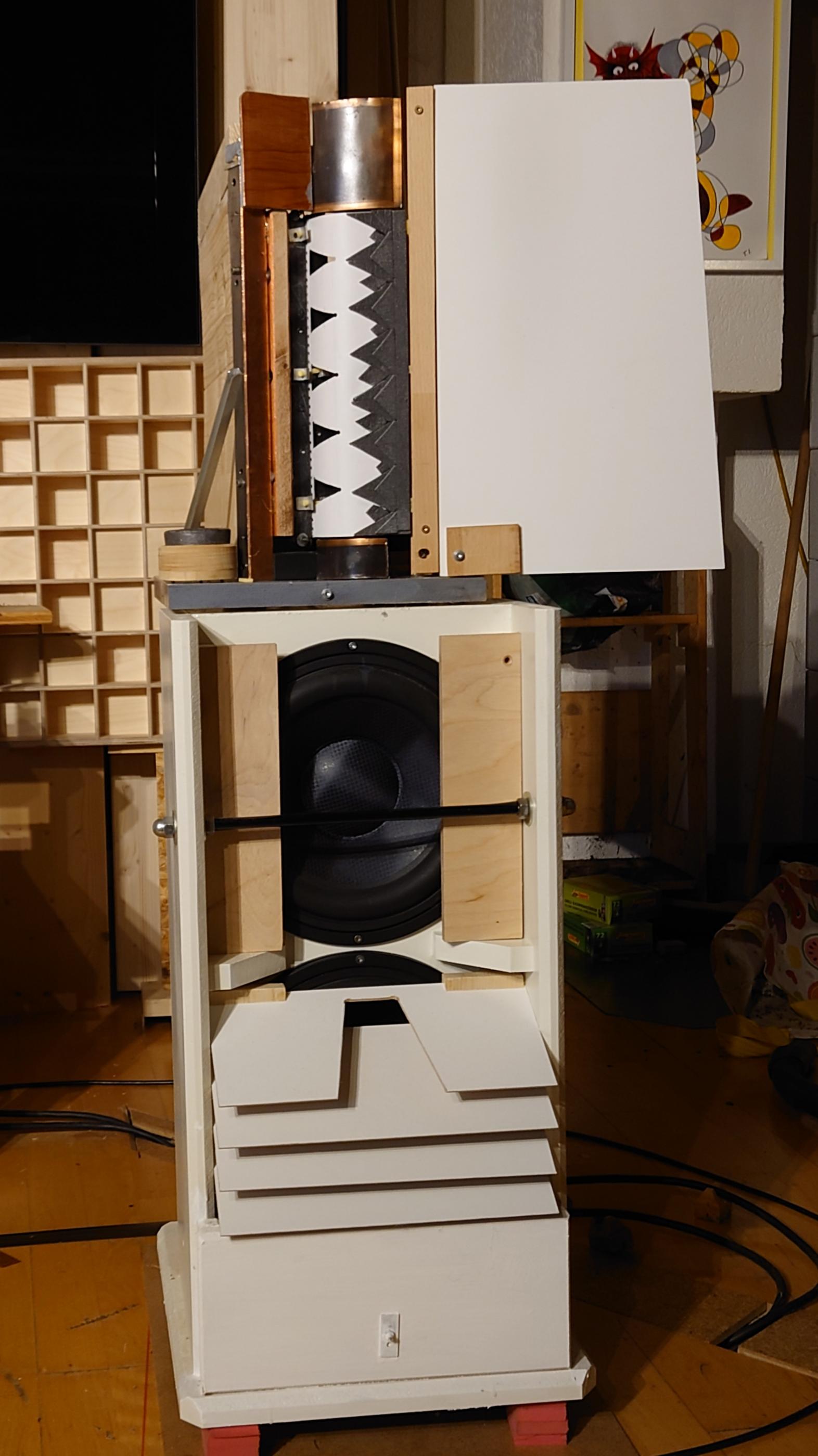

Hello
I will get back to you after all, as there has been further significant progress.
The damping of the membrane
The damping has now become thicker. On both sides, initially 4mm (2x2mm) set back a little and increased to 8mm (2x4mm)
It is even more important to make the damping irregular. The distance should vary from the beginning of the membrane to the damping!
Also front and back not at the same (time) distance.
This leads to a more even frequency response.
The membrane becomes more stable against resonances.
Unfortunately, I realized that a little late.
When I make changes to the membrane, I don't have to remove it first. That makes the whole thing look pretty improvised.
The half rubanoid has important advantages over two cylinders, with no negative consequences.
So there is a better center location and no comb filter effects!
Voices are without harshness ....
Ps: I know that my speaker is not a beauty.

nice does it still has its backside ? since that was the first i cut off. makes the freq response more even. but im not sure what happens when using one lobe only.
nice that the Fourte, now also cut there backside off 🙂 maybe they read this thread 🙂 ior came to the same conclusion
'Pretty' is not a requirement... Something to keep in mind, but not at this state.
Make it accomplish what you search for, then go for 'look'. 😉
I never built a membrane on the back. a rag alone no longer creates a comb filter problem, but of course less efficiency.
Nothing like pics 'n plots to peruse, peril. 👍😃
A single lobed Lin would seem to favor L or R, depending on it's placement....just a wild hare guess, but...🤷♂️
May be worth trying, but I'd be ready for steeled for a degree of disappointment. One might try it on an earlier version just to satisfy the curiosity of it,
Every now and then one must create a 'clunker' just to know where not to go.... 😉
