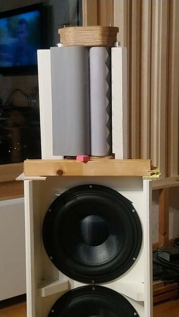

Now my speaker is ready.
There may still be little things to improve in the future.
The timbres are the same as with my Manger MSW.
The Manger MSW has a little more speed at high frequencies and is therefore a little more pleasant to listen to.
The rubanoid has a lot more power and I don't have to worry about overload. The spatial mapping is also better with the Rubanoid, as I built it, with only two semicircles.
I am mentioning the side damping again. (Monacor MDM 20) This is necessary because otherwise the structure-borne sound is reflected back and forth on the membrane. Although this results in more decibels, the sound is fuzzy.
With Audio nec and the Swiss Rubanoid, I can't see exactly whether they are damping. If not, the stuff is no good either. Audio nec can be heard on YouTube. Very treble-heavy and the voices are too transparent. Voices should have a full sound if the recording allows it, of course. I am aware that youtube recordings do not allow any real judgment.
I briefly summarize the data, my construction.
Membrane made of 120 grams / sqm with painting. First page: varnish layer with a lot of varnish to soak the whole paper. Second side with little paint and then again the first side with paint spray, so only very little paint. Always wait for the drying time for the next layers.
Test results after 4 days at the earliest.
Dimension: 28cm x 15cm, 3cm of which is glued for the voice coil holder.
Two coils with 16 turns each with enamelled copper wire 0.2mm diameter.
Slight overhang
Underhang
Underhang
Slight overhang
See photo
Theoretically about 22 to 24 Tesla meters
For me the easiest way to make it with 2K glue, with 90 minutes slowly solid. Very hard.
First apply the glue, then wrap the turns around the fiberglass reinforcement, which is used as the core. Time required: 15 minutes to apply the glue and 30 minutes to wrap. Wait until the glue is a little stronger, then you can push something. Not an easy job.
Magnets 5 x 20mm x 20mm. Iron 28cm x 20mm x 6mm.
Gap about 2.6mm. Of which 0.2mm copper foil to better reach the high frequencies.
In my opinion it is very difficult to get a good result if you don't know the bending wave speakers very well. They all have the same timbres, like göbel and manger msw ......
Kind regards

nice good job ! any measurements ?
Hello
Unfortunately I have to use a three way system. I would prefer a 2 away.
Why it is like that. My listening room is very unusual, even with a very short reverberation time. Approximately 0.32 seconds, with 94 cubic meters of room volume.
A woofer with a diameter of 30 cm already reaches its limits at 76 dB.
I separate the Ruba at 340 Hz, Linkwitz 4 order and the bass-midrange at 97 Hz, Linkwitz 8 order. Right all the time, as best as possible. (delay)
For measured values I only have a handheld measuring device and CD test tones (HIFISH)
It does not seem to reach 20 kHz.
The Manger MSW runs up to 30 kHz, but even this does not reach 20 kHz on my measuring device. Anyone who is familiar with measurements should also know that such measurements can only be carried out under certain conditions. Even if a gating measurement process takes place.
Something else about the frequency response. Why is it worth striving for 20 kHz that most people don't hear?
Quite simply, there are also the difference tones. This means that if a 20 kHz tone sounds at the same time as a 10 kHz tone, this results in a 15 kHz tone.
Then there are also noises in addition to the tones .........
regards

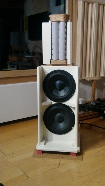

Kammfilter effekt
The Rubanoid is now on an open baffle. Unfortunately, the Rubanoid has a fundamental problem and that is the comb filter effect. The two diaphragm semicircles are like two tweeters next to each other. This leads to problems in the treble, this can be shown with the program Edge, baffle step. The frequency response drops early, unless the microphone is exactly in the middle of the membrane
When listening to music, female voices produce sound artifacts from both sides of the speakers. That doesn't sound clean, but a bit harsh.
Now I've started an experiment. As you can see on the photo, a membrane is now covered and the sound is directed to the side. You have to get used to it because the music sounds a bit unspectacular, but a lot cleaner. I am not yet able to make a final judgment. The cover must be positioned very precisely. Interesting that measured 20kHz is a few dB louder!
The tweeters from Audio Nec and the Swiss Rubanoid, in my opinion, are used because of the comb filter effect and not because the Rubanoid could not reach 20 kHz.
regards
regards

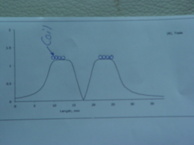

Please correct me if I am wrong, but is everyone using an etched aluminium or copper as their voice coils? I presume this is the case as there doesn’t seem to be a easy way of winding “say” 0.1mm enamelled wire into a flat slot shape.
Joppe - I know you etch, but have you ever used wire?
I used wire in my attempts:
Eight turns of 0.1 mm enamelled wire resulted in 8.3 ohm.
The finished coil was 0.15 mm thick and weight was 0.65 grams.
Dimensions were 15 mm times 200 mm.
Here I glue it to the membrane:
In the motor:
First tests, a little problem with the wires touching the motor:
Solhaga?s first attempt to bend waves. - YouTube
I later gave up due to problems with the membrane's fastening at the ends.
Or maybe not... - YouTube
