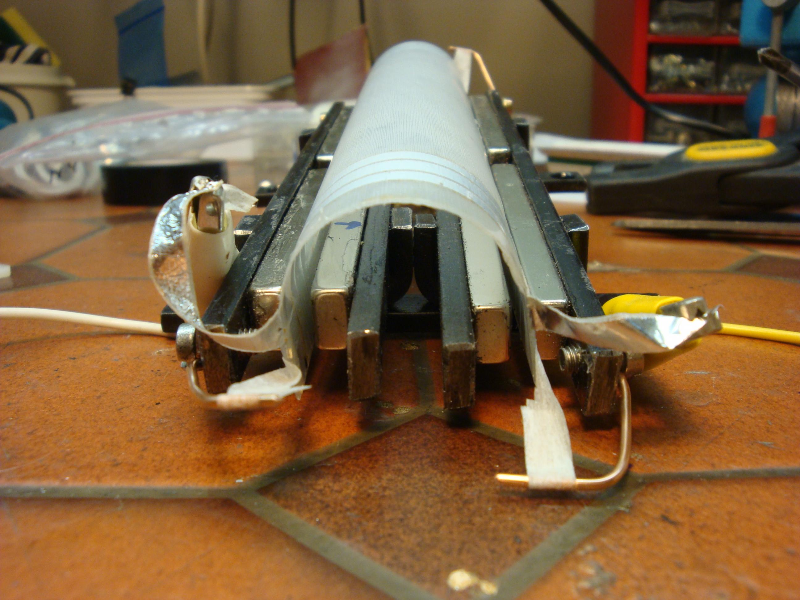

Hello Rubanoid friends, thanks again for your posts.
I have now built a prototype and have been listening to it for a few days. So only 1 piece.
My centering spider, which I did not find in the forum, seems important to me. At first it was a bit too rigid, but then it was good to cut it open. With this type of spider, the voice coil can be centered and stabilized very precisely. It consists of a shrink tube and a black foam, which is used for speaker chassis.
Shared album - Albert Schweitzer - Google Photos
The sound was good at first, but not as fantastic as described here. So don't talk about magic. But at least with high efficiency. So what did I have to improve?
I take the Manger MSW construction as a role model, since I have heard it for almost 30 years. Since he was often broken due to overload, I broke up with him.
I listen to conventional speakers for 6 months, but not with great satisfaction.
Now I come to the most important update.
First I glued the monacor MDM-20 unr on the long sides, back and front. The black peaks (triangles).
And now I have to have a big mouth.
It is hard to believe, after I had attached the Monacor MDM-20 up and down, almost half the length of the membrane, the sound became much better !!!!!!!!
In the same way as the Manger sound !!!!
So forget the paper experiments, that doesn't help, only the attenuation of reflections really makes sense!
The sound is fantastic. If you do not use damping on the outskirts, you only hear with half the quality.

Hello to most ruba developers.
Now I am writing arrogantly and plainly.
What I have built is only similar to a ruba, but better in either case.
Building the Ruba like a leaf spring and beending wave is unnecessarily complicated and, as I read, many years have passed in this treath and various membrane materials are still being considered. you are no longer open to simple new ideas. too bad, but blame yourself.
Now to my prototype: its tonality already sounds exactly the same as my manger msw. just not at the same speed, but it's easy to improve. The spatial representation is different, but I can only test this with two chassis. The volume or the resilience is higher with the prototype. Crossover frequency is ideal at 420 Hz with left. 4 order. membrane size 28x21 cm.
So after 4 weeks I am already there. I don't have to test materials.
From 3mm distance of the magnets, I go to 2mm, so 1.3 Tesla. The voice coil former becomes smaller and thinner and runs in the lower curtain at 6 ohms.

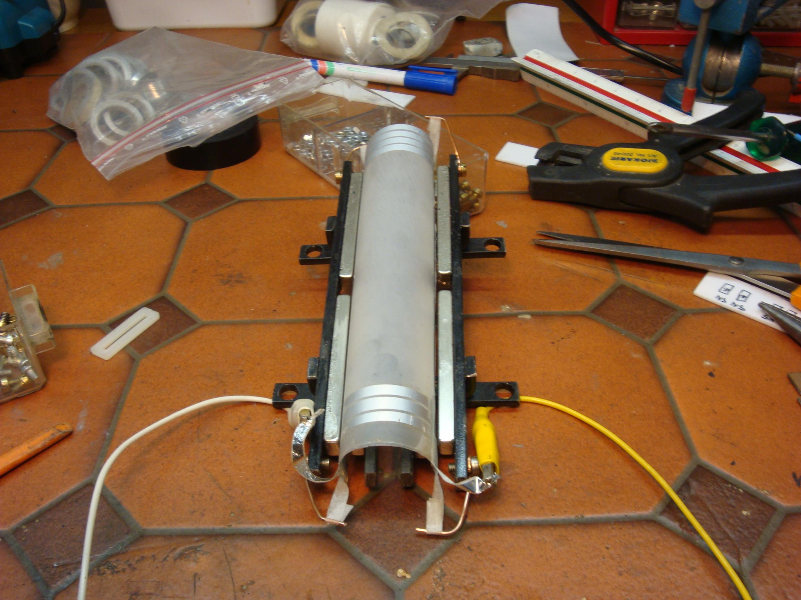

Half Ruba
Hello
Half circle rubanoid
I'm just trying to write important information.
So far I have striven for the lightest possible engine. This was a mistake.
Motor and diaphragm should have the same weight! That's why I tested the engine with additional weight. The high frequencies became louder and the midrange benefited a little.
In my opinion, half circles of the membrane are better than whole circles.
Why?
Half circles also emit bipolar. Not like normal full range speaker chassis that emit dipolar.
That is why there is no need for a baffle as there are no extinguishments.
I can only imagine the advantages of the whole group in the low tone, i.e. where there is no bending wave.
Half circles are much easier to build.
Lateral damping of the membrane is a must! It should also be wide enough. So with a circle diameter of 8 cm, 4 cm damping material. At 5 cm diameter, 3 cm damping material. Don't let anything else talk you into it. Structure-borne noise must be dampened so that it is not reflected.

So the following. The voice coil, voice coil former and centering spider should have the same weight as the membrane.
You see how I made a centering spider, it doesn't have to go the entire length? The yellow parts.
I only attached the brackets for testing, as an additional weight:
