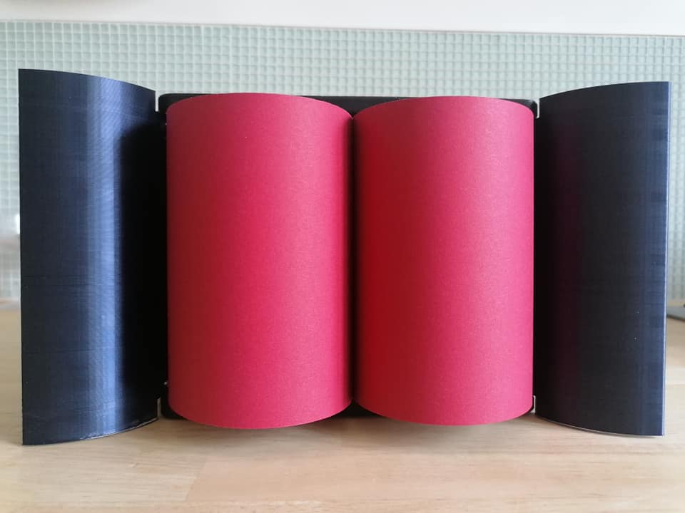

My Rubanoid should only work around 300-400Hz. I'm only interested in the bending waves. Bending shafts have their advantages in the mid-high range.
If the images are visible, this was just a quick, quick experiment with a glued broadband chassis.

According to the theory of bending wave propagation, a tough elastic material is ideal.
On the drawing you can see an experiment that everyone can do with a sheet of paper. The semicircular membrane makes a lateral movement at the end of the membrane.
The membrane attached to the center towards the end makes no visible lateral movement. I think this is advantageous.
Maybe someone disagrees?
