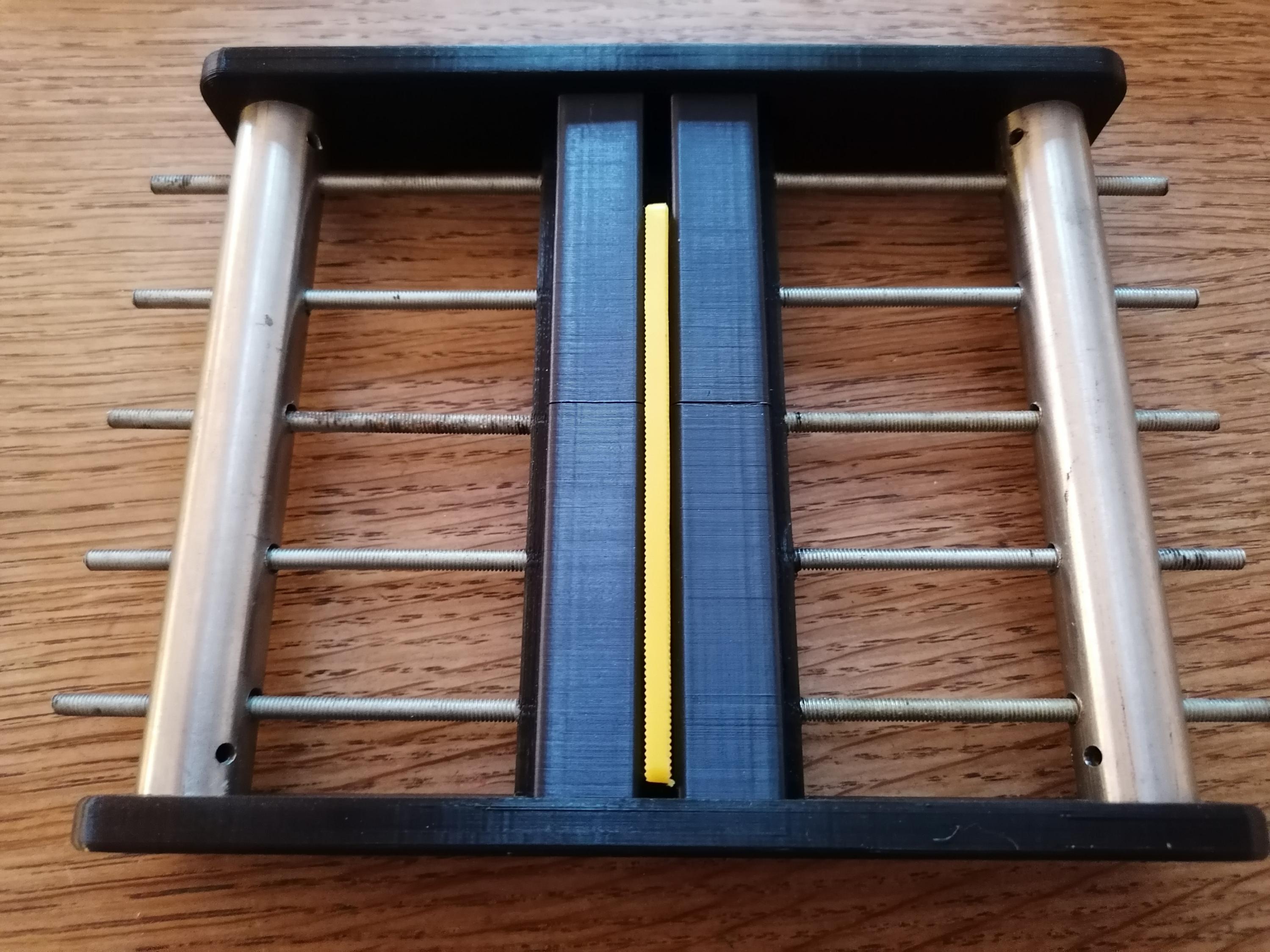

Hello Rubanoid friends, thanks again for your posts.
I have now built a prototype and have been listening to it for a few days. So only 1 piece.
My centering spider, which I did not find in the forum, seems important to me. At first it was a bit too rigid, but then it was good to cut it open. With this type of spider, the voice coil can be centered and stabilized very precisely. It consists of a shrink tube and a black foam, which is used for speaker chassis.
Shared album - Albert Schweitzer - Google Photos
The sound was good at first, but not as fantastic as described here. So don't talk about magic. But at least with high efficiency. So what did I have to improve?
I take the Manger MSW construction as a role model, since I have heard it for almost 30 years. Since he was often broken due to overload, I broke up with him.
I listen to conventional speakers for 6 months, but not with great satisfaction.
Now I come to the most important update.
First I glued the monacor MDM-20 unr on the long sides, back and front. The black peaks (triangles).
And now I have to have a big mouth.
It is hard to believe, after I had attached the Monacor MDM-20 up and down, almost half the length of the membrane, the sound became much better !!!!!!!!
In the same way as the Manger sound !!!!
So forget the paper experiments, that doesn't help, only the attenuation of reflections really makes sense!
The sound is fantastic. If you do not use damping on the outskirts, you only hear with half the quality.
If a do-it-yourself builder would like to check this, I would be very happy to get an answer here in the forum.

Nothing like a 'breakthrough' to make ones' spirits rise, isn't there?
Wonderful! If you could post a vid w/sound, it'd be great to hear what you're hearing.
Anytime one makes a significant improvement on DIY'ing a project, 'all and everyones' boats rise' to borrow the phrase....
Way cool, Al. ����
A thought:
When you decide to move on and build a 2nd unit, keep the angled ends of the Monacor tape on the 'outside edges' of the diaphragms. I'm wondering IF the angled pattern of the tape may be 'breaking up' any IM distortion of the reflected waveforms on the 'phrgams.
This is an issue with the Walsh cones; when the descending waveforms 'hit' the bottom of the cone, they 'bounce back' up the cone, causing IM. This is a factor noted in the original patent, and was discussed as to how it may be dealt with.
(One was a form of 'liquid damping' which could be tad difficult to do....*L*)
BTW....My posts 4/28 @ 5:28 & 6:23 AM also applied to you...if you'd like to try 'something exotic' other than paper....
It's free...only some trust. *S*
You might try Mylar, in the meanwhile...1~2 mil thickness...black, clear....drafting film....
I think your shrink tube+foam+DS tape is a neat 'centering' trick is Brilliant. *G* And you can't beat the price....

Hello Jerry
It is important to use the Monacor tape. Not over the entire membrane above and below. At first I only made it halfway and then over the entire length, horizontally. There was distortion. Now I had to laboriously remove them. It's clear on the page ends, but very important above and below. Only then does the whole sound like bending waves. Just like my manager MSW. What I want to improve is an even lighter voice coil body, for even more attack. Now there is a glass fiber fabric of 0.5mm. Then 0.3mm.
A video only makes sense if two games are the same, otherwise there will be a mix of different speakers.
If I then build two new ones, I will come back to your offer to test other materials.

Hello Jerry
Unfortunately I don't know anything about your activities.
So you've already built rubanoid?
Have you tested the way I experiment with cushioning myself? Monacor tape?
I use varnished paper, in the last third a second layer. The membrane is more than just semicircular. The ends are bent inwards!
Now my latest findings: I have built the vertical damping a little more inside, about 6mm more. the result is more high-frequency energy (also measured), no distortion. drums have more attacks, female voices have become brighter, with significantly more details, no distortion. What do you think about? But please no theoretical information, like the choice of speakers, but tested own experiences with rubanoids.

Hi
is my first coil. I hope you can interpret the pictures.
The aluminum part is the winding device. I have to improve it, with a rubber pad, so that the tension in the coil is maintained. after wrapping, glue it with, for example, glass fiber plate.
my english is weak so i can't read your documents. Too bad
regards

Hi
regards
