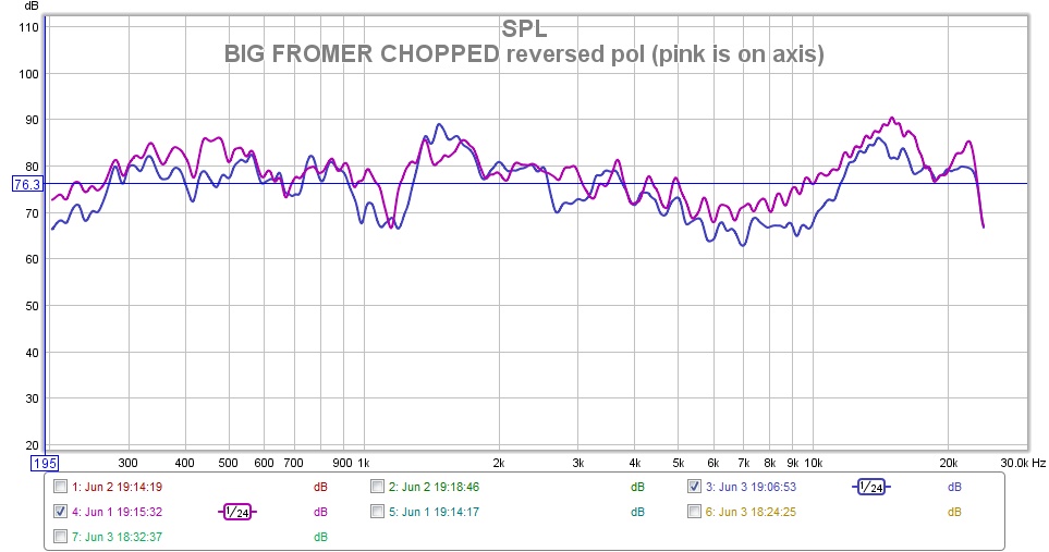

A DIY Ribbon Speaker of a different Kind

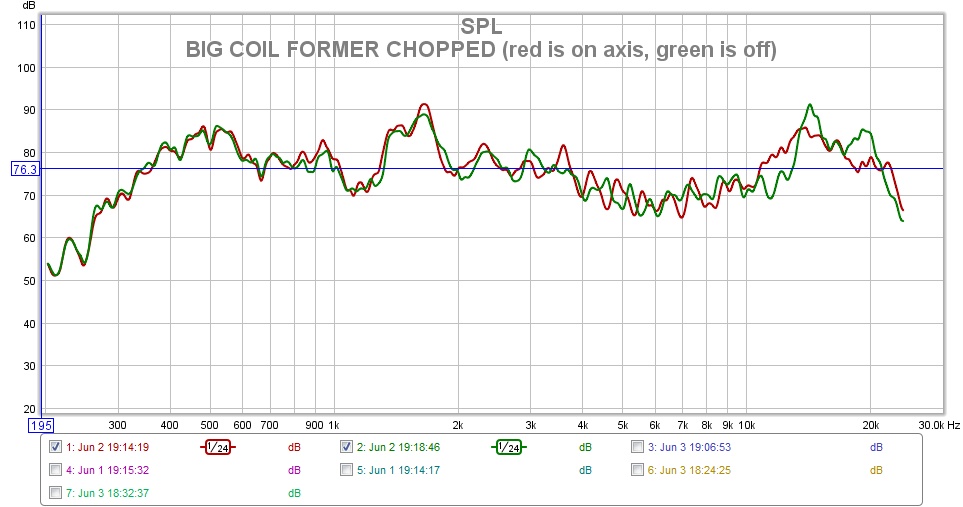

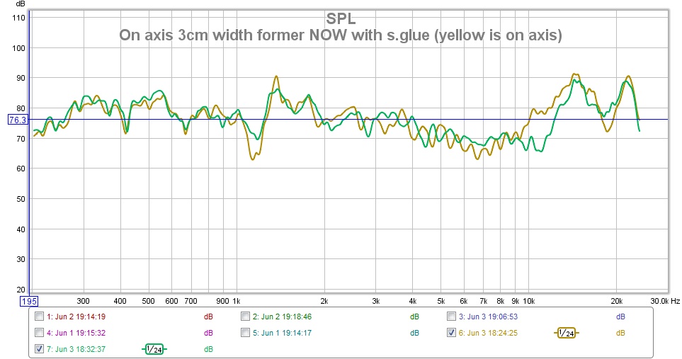

Now as you can see, i chopped the big former and what do you know: very good results resulted, in measurements and listening sessions.
So it seems that a double syded coil with a bigger former, (BUT NOT SO BIG) is the key and a good combo. Another thing is that now, for this version, the coil has 5mm on each syde glue, so that its not sticked strictly onto the 3cm area of the coil, now its bonded on 4cm area with the 3cm coil in the center and the former extend outsyde of the bonded region for only 3 mm, so it has a total of 4.3cm bonded. It sounds incredible now. Its like its projecting the singer insyde you house in your face. Its just incredible.
I tryed to stick the cilinders 4.3cm as in the BIG FORMER version in my FIRST version (the one with double adhesive tape) (the s.glue version) with super glue, but without succes, as you can see in my above measurements. You will see in my vid the explanations.
Cheers
Sergiu

Ho serg, i usually remove the phone from its holster when recording. since it might block the mic.
Btw can you add the distortion graph as well? since it will tell us more whats going on.

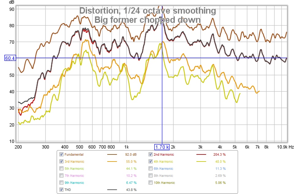

You will laught till you hickup. Its obviously that the coil its rubbing, but i cannot see where because i dont have cuts in the membrane.. Or it might sum the dist from both cils. I never measred more than 10% when rubbing with single coils...
look ::🙂))) 🙂)) 🙂))

nice!! thx for the video´s!
the rubbing is indeed very present on piano´s usually when i want to test for distortion or resonances i use piano you will hear them very easy with that. ofc measuring is part 2
Hope you come up with your final version so you can actually enjoy them !

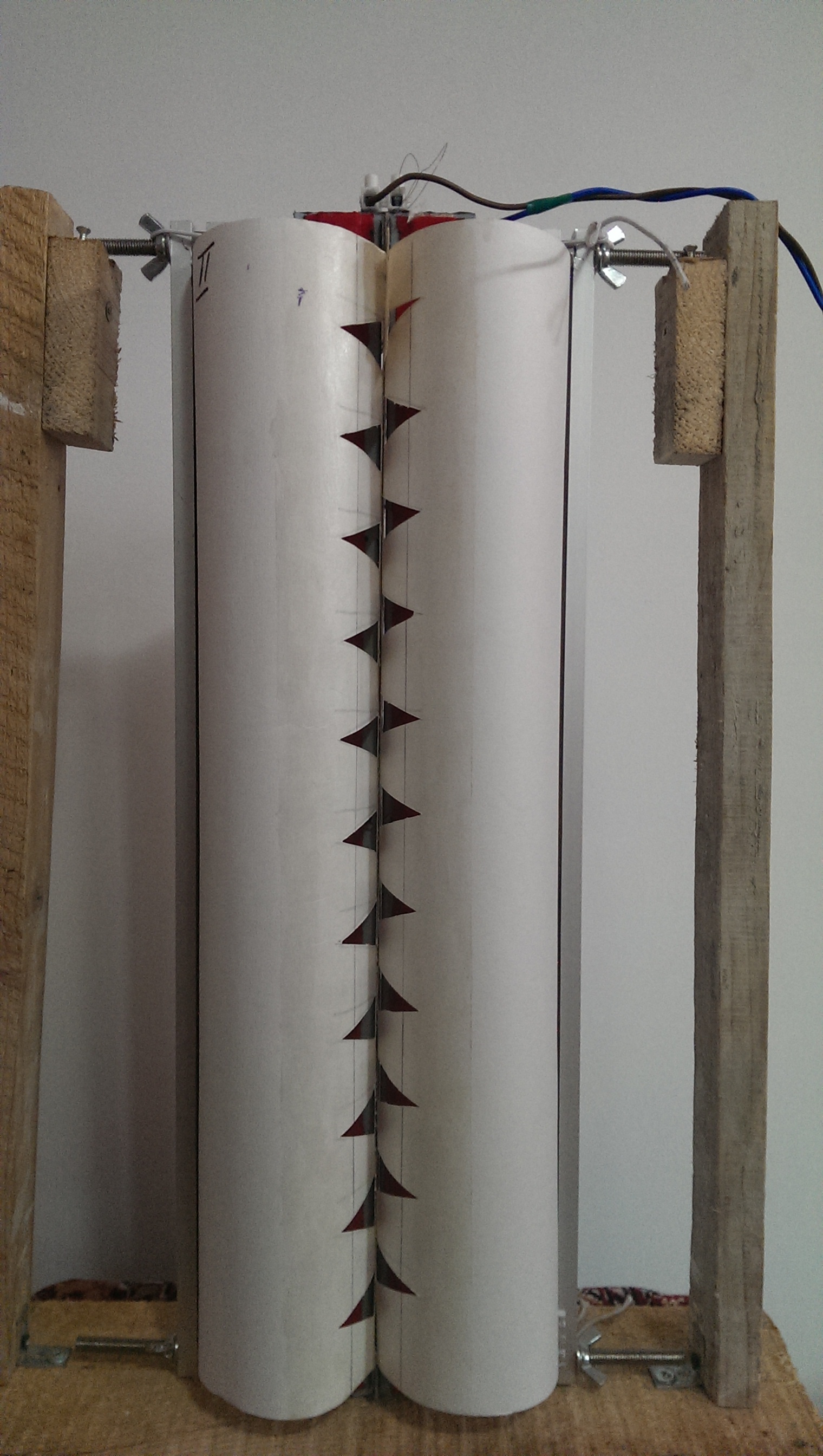

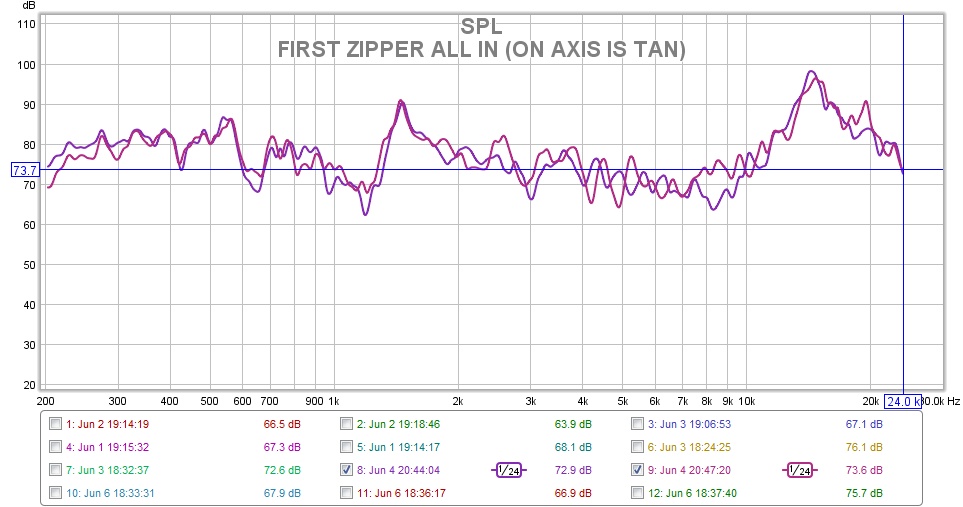

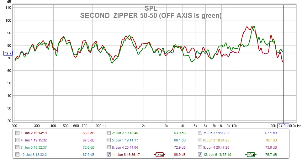

Hello my friend,
Today i tried two different types of zipper design. Of axis seems to be good but on axis it its a no go.
My conclusion, is that all of these measuring tools like REV, or HOLM dont know c..p about measuring this speaker (as seen in my earlyer THD post with 206% THD..🙂)))) ) and this is not the speaker's fault. They just show you if you are in the correct frecv, but if you really want to see them you have to do this off axis with the mic at 45 degr pointed very close to the center of the speaker.. I will make my final ruban for dayli after the off axis frecv response of the speaker as i think this is what the speaker really sings. You cannot hear those huuuge peaks even if you are with the ear in the center of the speaker.😎
Anyway these are the plots with the zipper cuts. The FIRST one is ALL IN type, wich means that the sound comming from the active region of one cil pases insyde the other and vice-versa. From measurements is crap, and subjectivelly speaking, the singer is like outsyde you yard singing with a fence in front of him... 🙂
The SECOND (II from the pic) has 50-50 zipper style, 50% from one cil pases through the other and the other 50% goes in front. AS seen in measurements it has those nasty peaks on axis and off axis so its not so good but subjectivelly it plays pretty well, the voice doesnt have that coloration on the mids perceived as a strong voice (just like the voice is comming from a 15" bass speaker if you know what i mean) instead is just like the real thing. The disatvantage of this kind of zipper design is that is like somehow the projection now its like 50% dissapeared and the dispersion is like atenuated abit compared to the "no cuts" version and i believe that this is because only a small portion of sound from the active region if reflected.
So subjectivelly speaking the cuts are good for making the voice thinner as desired, but if they are too big and paralleled you gained a small sweet spot and if done improprelly they ruine the sweet projection of the speaker and affects the dispersion.
Now i will make the coils for those 4kv, 250gr/sqm folium sheets that i have buyed a month ago.
Cheers
Sergiu

Hello my friend,
Cheers
Sergiu
well GJ dude. to bad it did not deliver🙁
But one thing i think must be clear its not holm or rew that cant measure it. its just the ruba that has this response nothing else. and the 200% distortion, is either the ruba or something in between the mic and the program. its not fair to say it does not work. since it does work. And get pretty consequent results. be it shark teeth usually on axis. but i don't have shark teeth on my quads or other designs so. its all in the ruba and or preamp/mic/amplifier
that said , ofc you can be fine with the peaks, especially if you cant hear them. and just build some speakers and enjoy them !! hope to see them soon! 🙂

Hello my friend,
I supose you are right, it may bee something from the chain, but somthings fishy because off axis i have less dist.. I told you on skype that in the worst case scenario, when membrane rubbing, i had at worst only at peaks 10%.. Now i'm thinking maibe its because of the double coils, who knows. One thing its for shure, that the mic is conected to line in and amp to line out, so as i've seen on the cal files, now i have fewer dist and noise compared to the time when i had my single coil on ruban. Maybe its only a consequence of two coils emiting both on the same surface at the same time. I will see this soon because i still have a single coil ruban vers to compare somewere on the shelf.
Anyway on thing its for shure, that you can only see the frecv resp of this speaker off axis. And i can barelly wait to see the results of that folium.
Cheers my friend
Sergiu

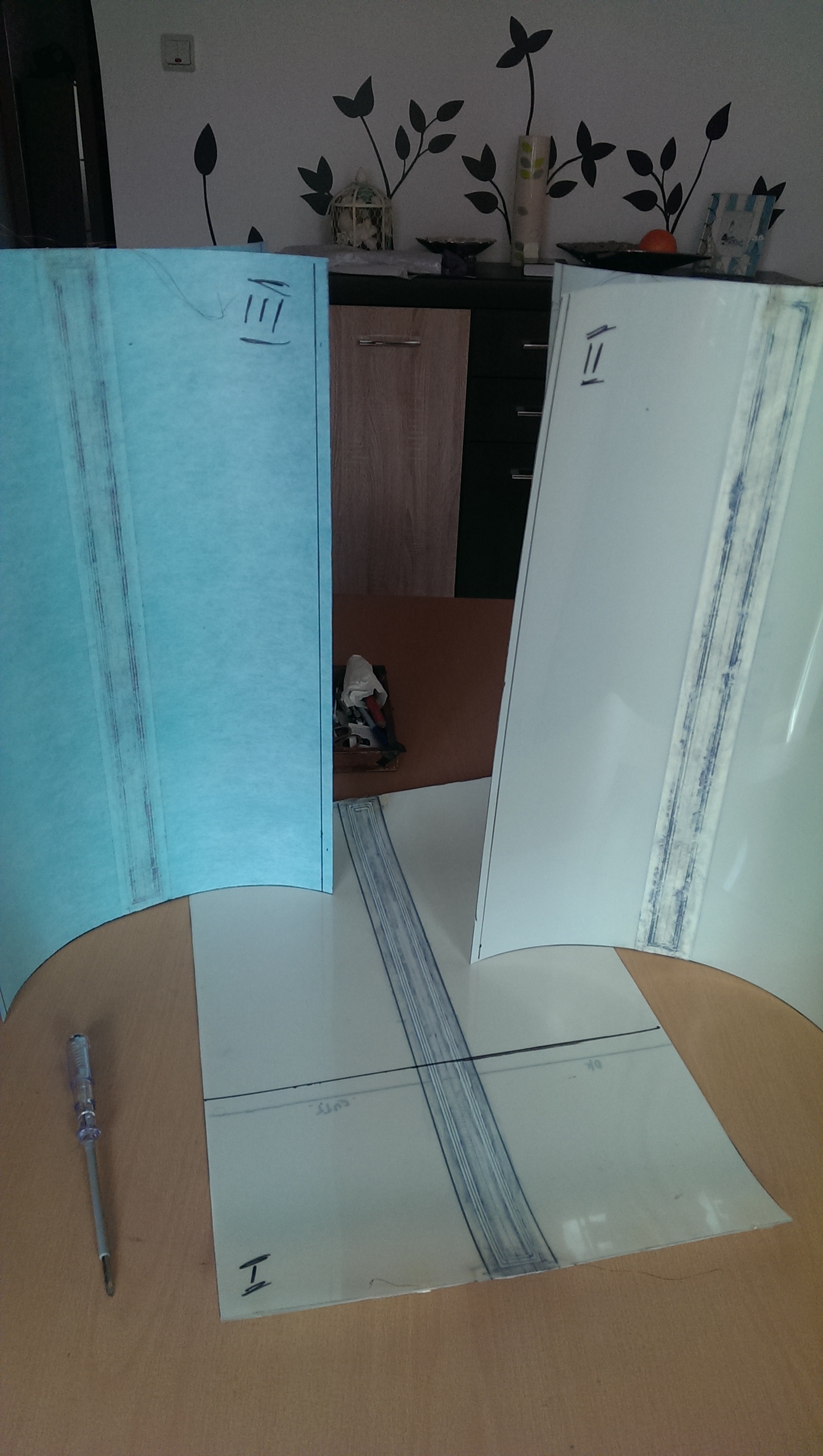

At last the glue has dryied. So here we are. Today i will test 1,2 and 3 roman(all of them has a coil with 3 turns and 7 ohms, underhung):
*1 :250gr/ sqm membr, coils are bonded straight on the cilinders, and has double adhesive tape, so an overall lighter coil;
*2:same membr as 1, has coil sticked to a canson paper former, so a heavy coil;
*3: a 225gr/sqm, the foil membrane is now sandwiched between two sheets of paper,coil sticked the same as 2;
All of these foils are usually used as insulators for trafos and have 4kv insulation streght.
The cils are now bonded on 4 cm area instead of directly to the 3 cm coil till now, because this gives better results subjectivelly and in measurements.
Will measure when i get home today.
Cheers
Sergiu

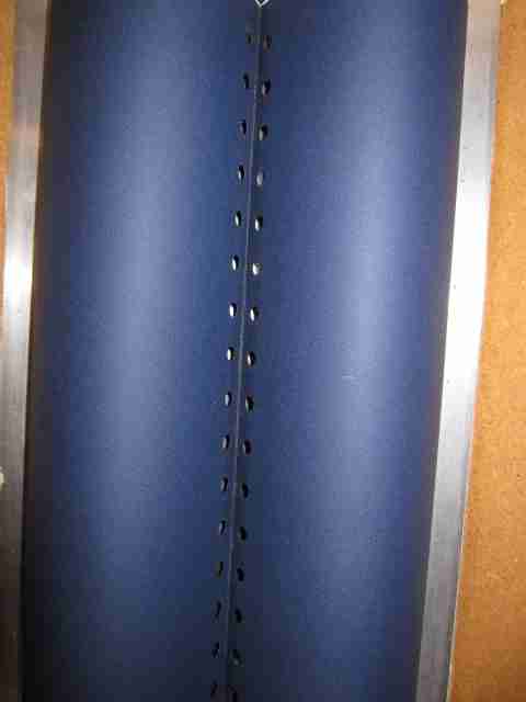

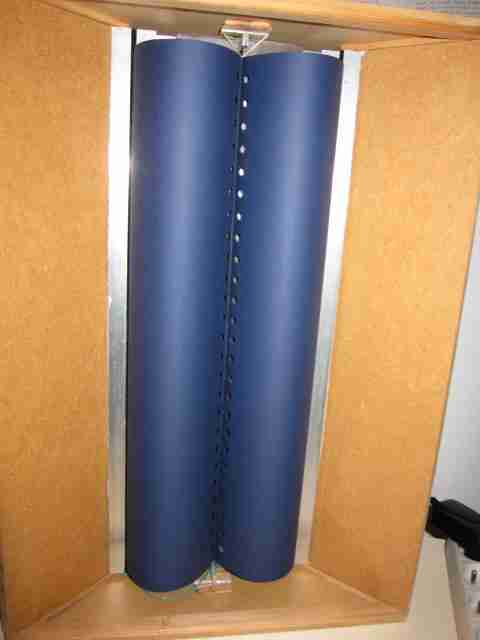

Hi Sergiu and Wrine , i keep on reading your posts and thank you for sharing your experiences.
i just come to read the whole linaeum Patent and specially the paragraphs about the cutings in the wings and the coil thanks for speaking of that Sergiu .
So i cut 15X 8mm holes in the center of the coil and 25X6mm holes on each wing close to the coil ( 30%) I don't have any measurements but subjectively the lack of highs has disappeared and there is no more need for an extra supertweeter i would even say that it seems to be more efficient !
I will work about how to measure all this soon .
each wing is CANSON PAPER 160g/m2 47X16 CM
the coil is Double side coper printed board 10turnsX2 = 9 ohms serial /weight 17g
total weight of the 4wings +coil = 60 g
i use elastic suspension with some bracelet wire i don't know what material it is white, thin and strong ... ( silicon? )
