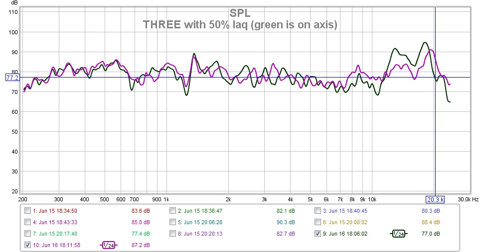

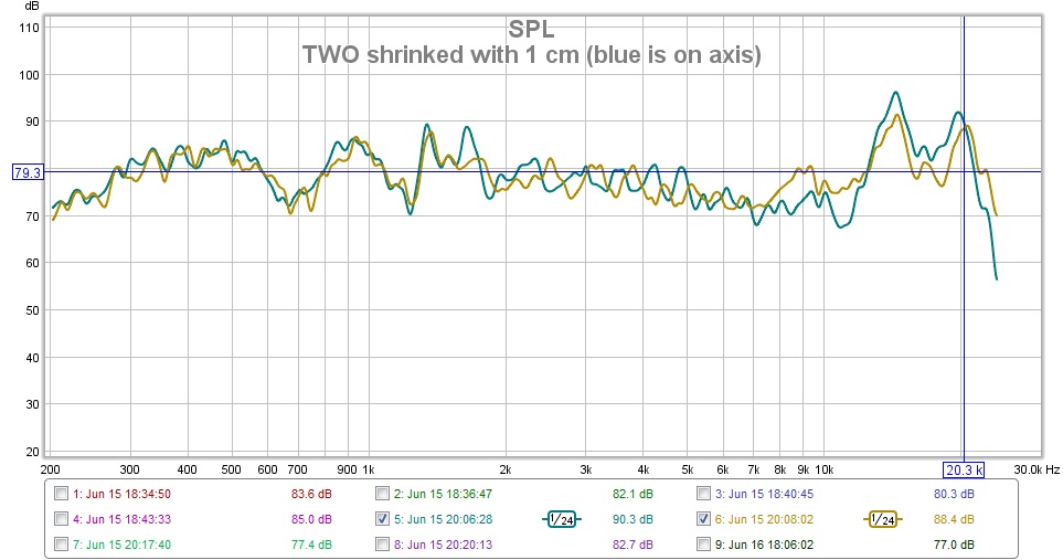

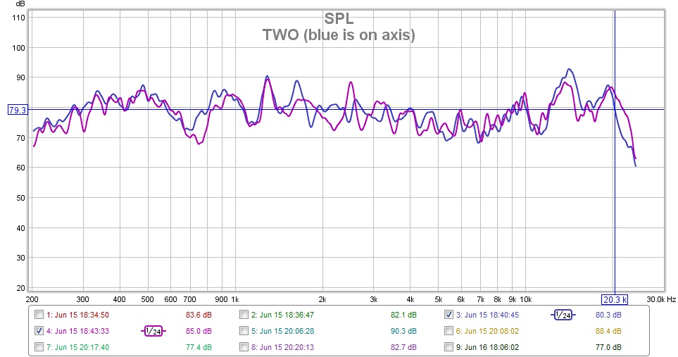

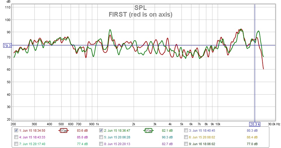

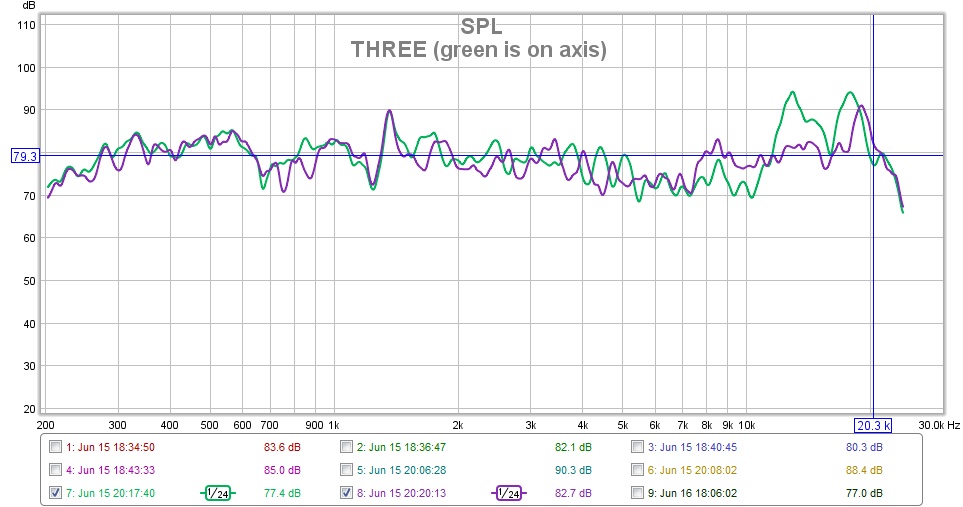

Well, after yesterdays experience i can say that ruban 1 is too rigid becuase the double adhesive tape has a glue on it wich is like rubber when combined with laq and makes the sound is abit restrained, and the sound isnt opened any more. It measures pretty well but i can really sense that it has fewer dB..
Ruban 2, with 250gr membr with paper former is better in any aspects compared to 1, wich confirms again the aspect that the adhesive doesnt have to bee too hard or in excess. The sound has now the feeling of airy and its spacious, but its buzzing abit, wich means that using copper wire insyde the bonding area is a ni go..
Ruban 3, the blue one, with paper bonded to the folium, is faster than the others and seems to reveal more details than the others, wich i think its because of the 225gr membr wich, if you remove the paper you will have a 180 gr pure folium membr.
This 3rd edition is lacking hights and if i added 50% laq i made the voices more round and more pronounced. Strange thing. Another aspect is that this vers has more dB than the other two.
Also this folium has poorer dispersion than the other two vers.
With these foliums i made the best centering till now. The coil is very rigid and doesnt bend anymore, not even 1 mm..
My conclusions are:
*dont use membrane heavyer than 180gr for the former(folium or not);
*use a rigid folium or material only for the former and NEVER use double adhesive tape because of the adhesive on it;
*you can use folium with paper on it, but only on one syde , and let the paper syde on the insyde of the cils and the folium syde on exterior;
Cheers
Sergiu

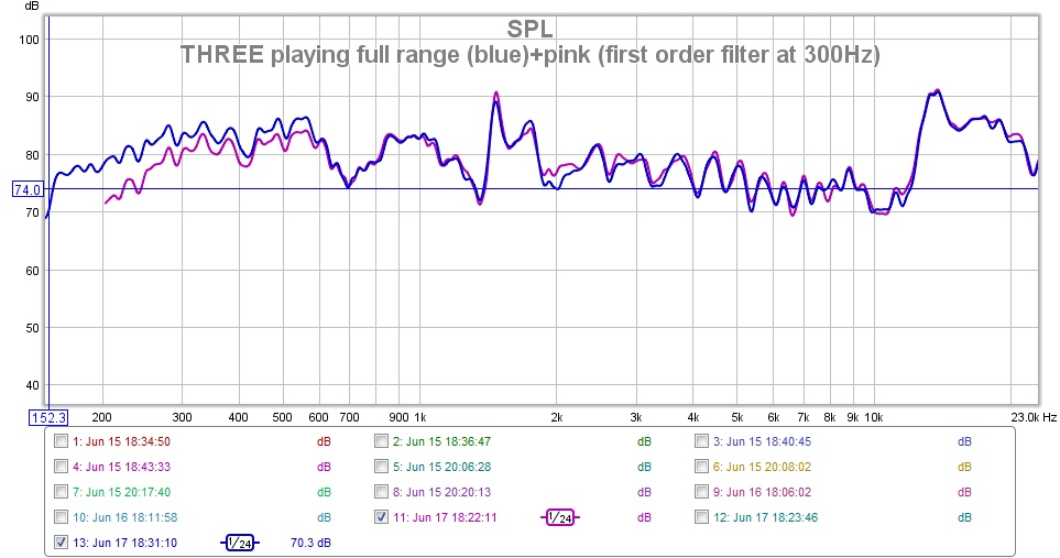

I found something more interesting. The folium with paper ( Three) let me shrink the cilinders even more without bendings or crippling (i shrinked them at 3 cm per half@from plate to center of one cil). The measurements are astonishing at last (+-5dB in all the band when goying full range). I measured it 4 times just to be shure and all the results where the same.
Wrine, my friend, look at the measurements bellow (i aded a full range chart vs first order filter and the first order filtered ruban on axis and off axis measurements). What do you say?
As you can see now with the folium, the ruban goes down to 150hz and up to 24khz and who knows actually how high it goes because i have limited hardware on my integrated audio soundcard in the pc.
In the first order filter aded (first chart fron left to right) pink is on axis and green on axis, and on the rights chart (full range vs filtered) bothe measurements are on axis.

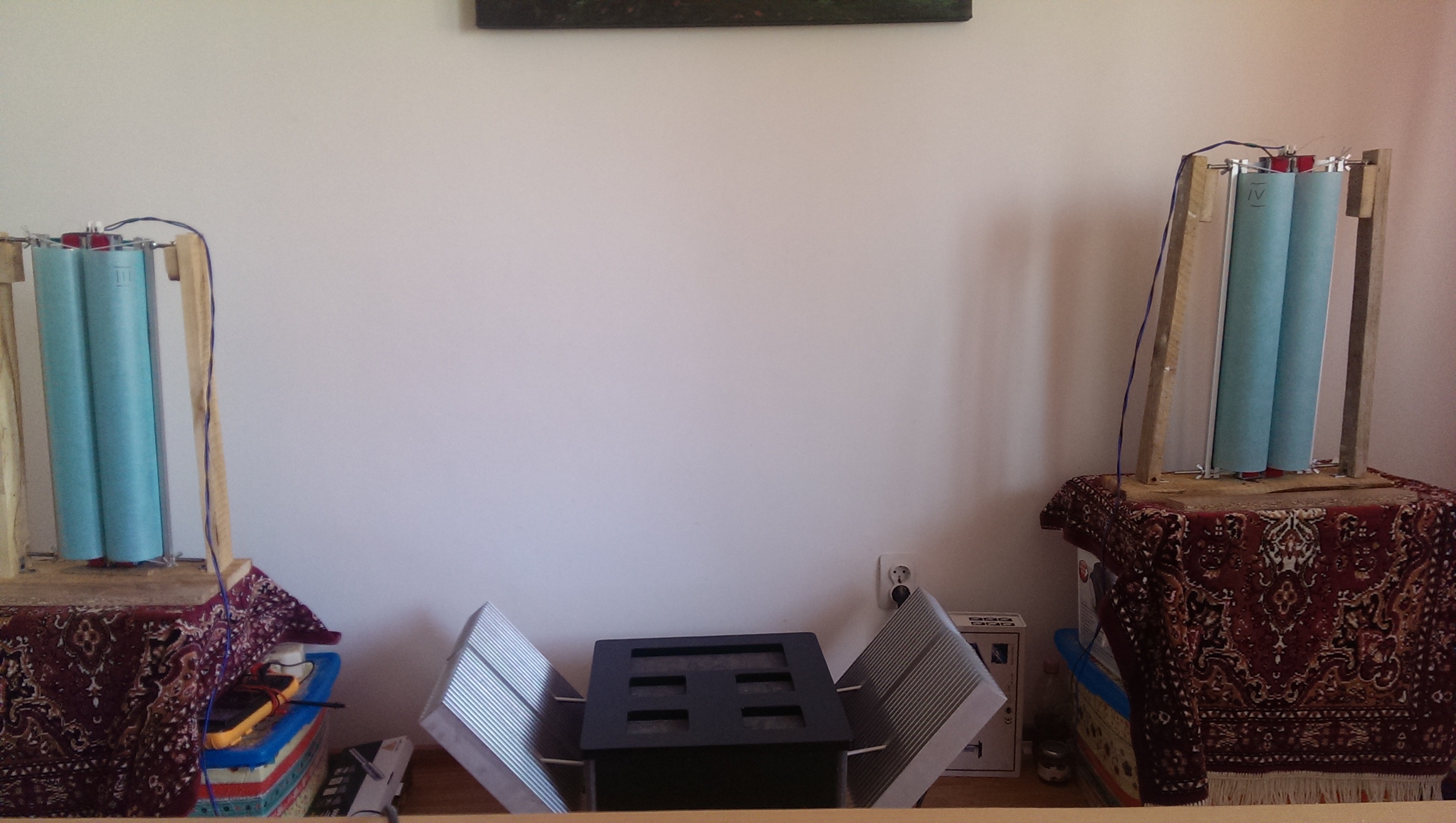

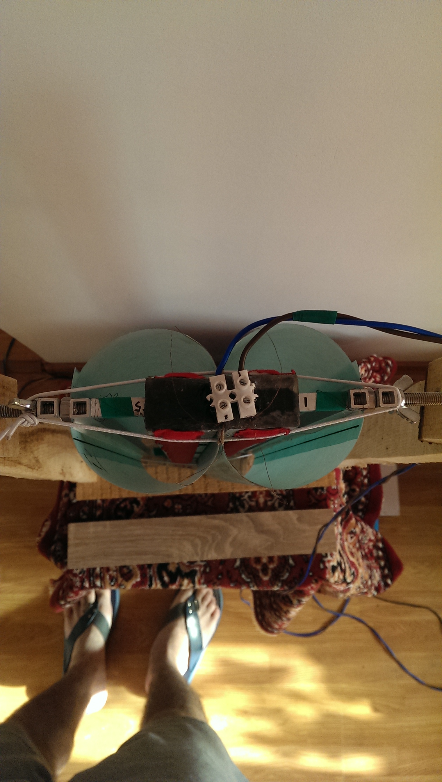

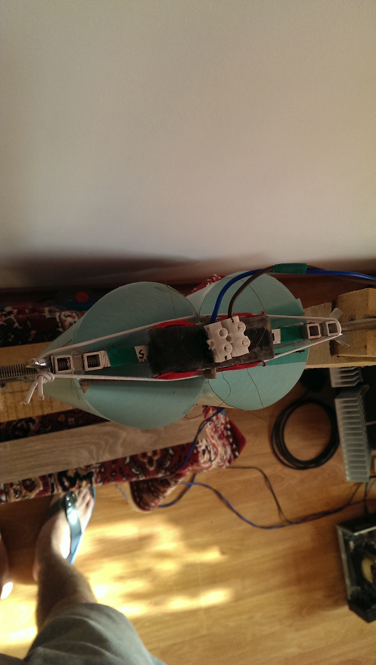

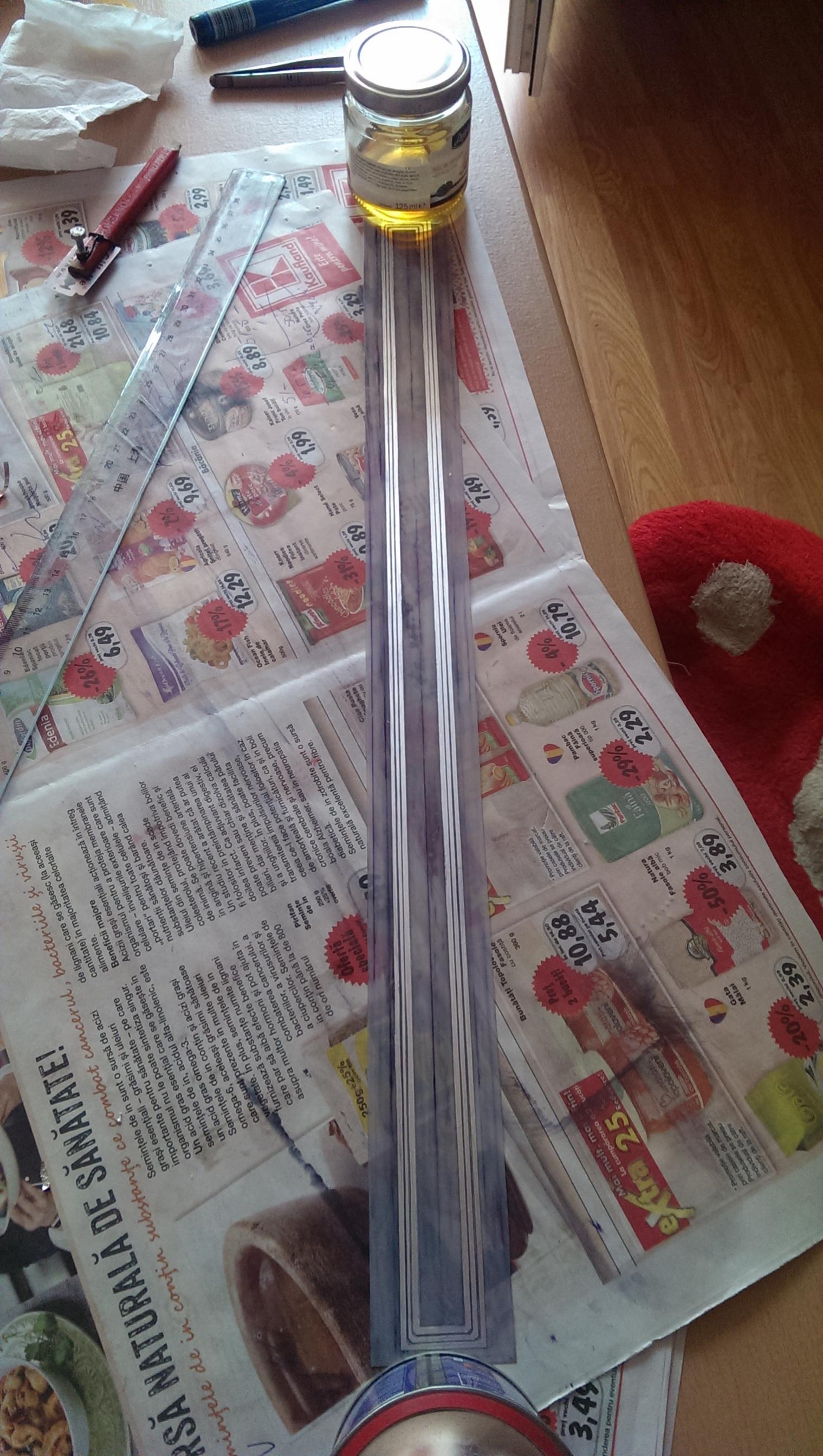

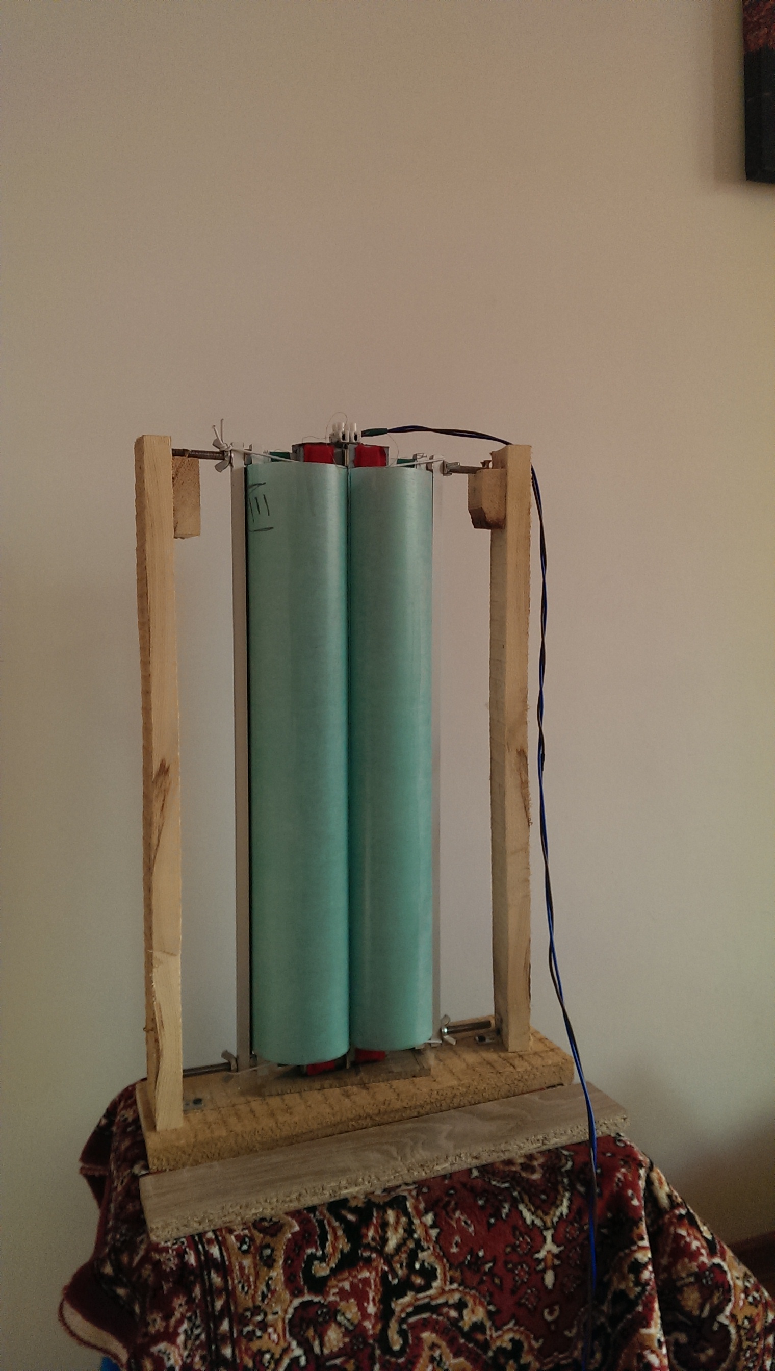

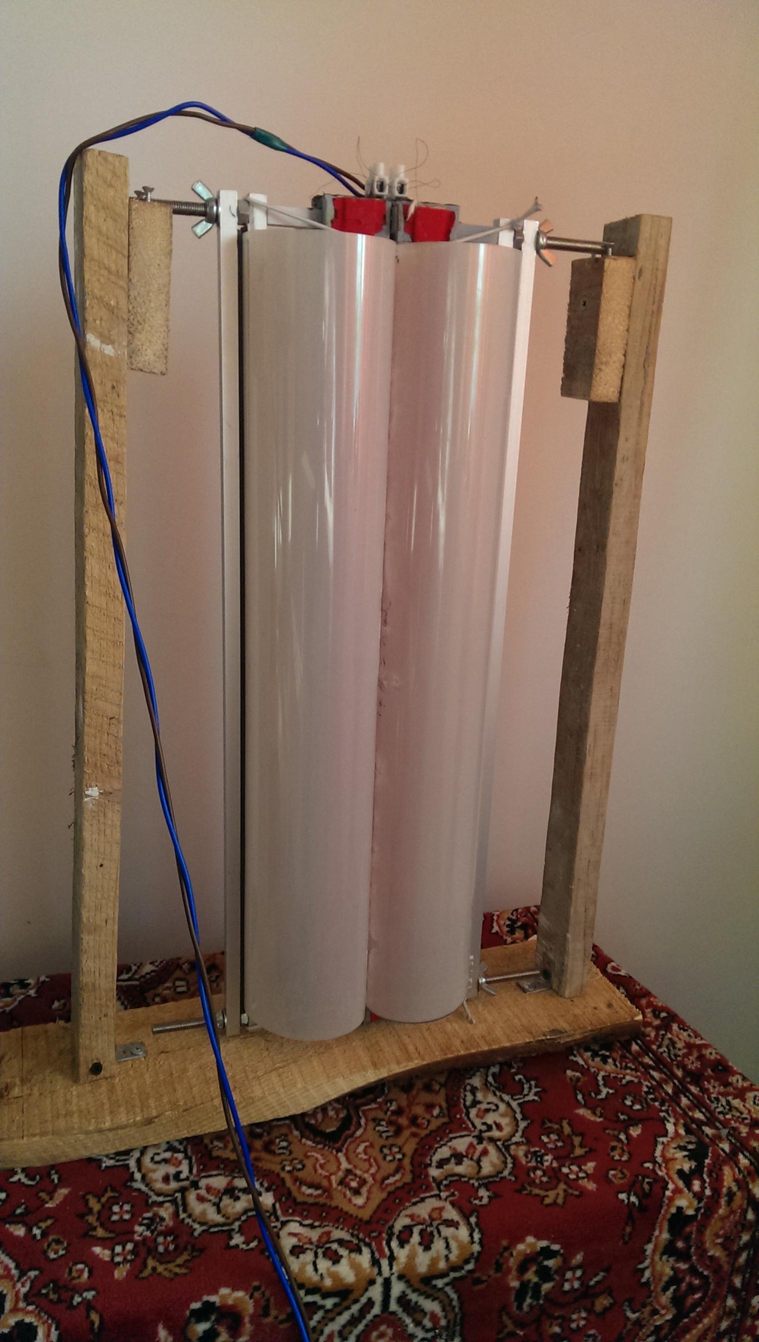

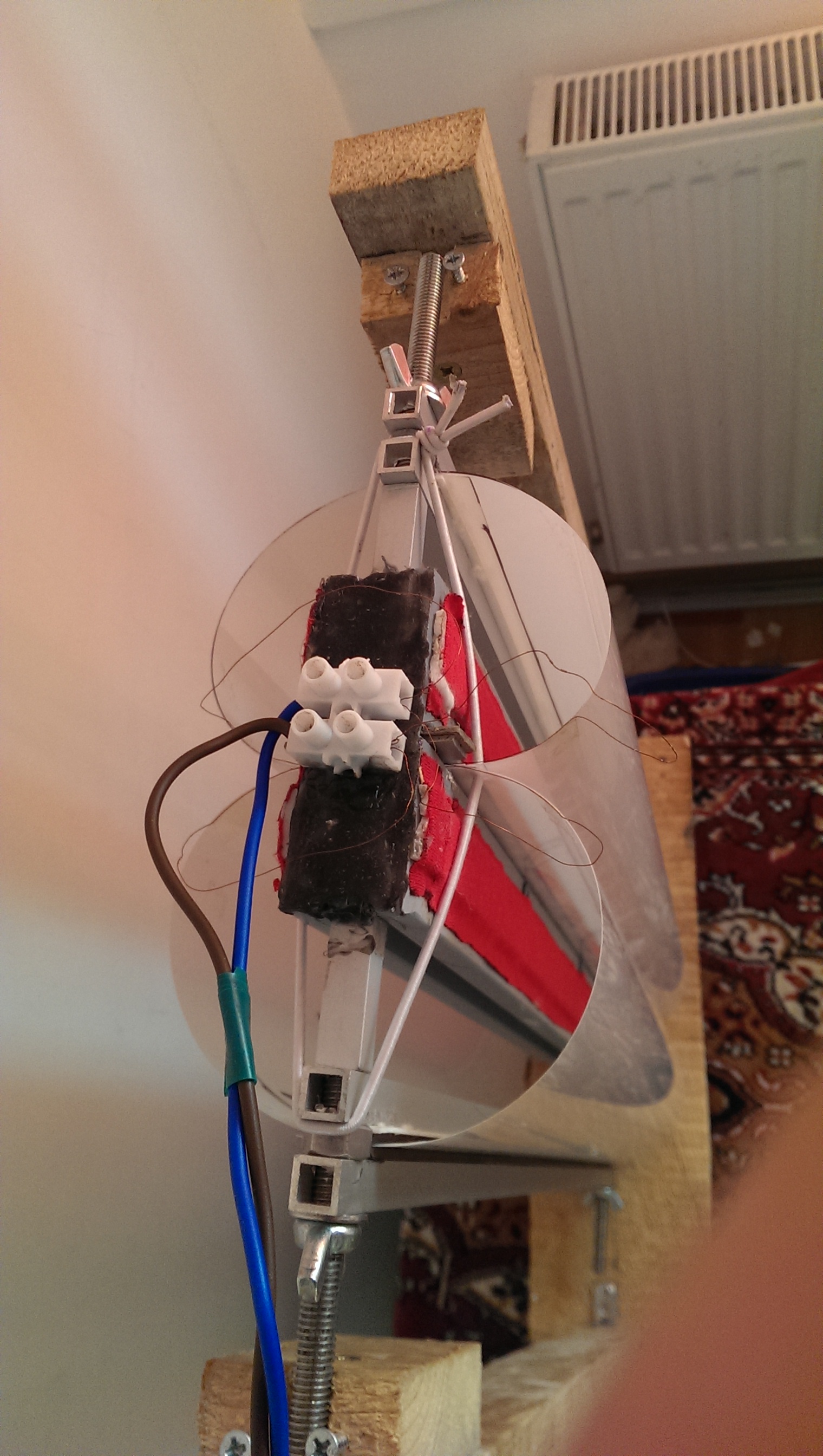

Here they are. The vers 3 (blue membr) and 2 (transparent thick white membr). The first was dissasembled because of the poor listening impressions it left.. 🙁

Well after playing abit with the 3 version (elastics, laq, and other stuff) and listening to it with cilinders shrinked down i can say that i like this version.
I have to increase abit the hights (subjectivelly, because in measurements all its ok) BUT this problem will be solved when i will add the cuts. The mids are now perfect, this variat its a combination between sound projector (when the singer its singing is in your face) and the "feeling like your there" feeling (when you have the impression that you are sitting near the singer and/or the instruments, feeling that others call it "live concert" or sitting in the first line at the concert). The voice is there when it is recorded like it, and laid back whe its recorded like this. The voice its no more like a sound projector Wrine, like in the old variants, i can say now that the voice, details, hights, depth and dinamics are like the real deal. This variant also shows the singer when its breathing or the sound that you hear when the singers lips makes a click noise when its mouth its dry (you know what i mean😉 ) ..
I wanted to try different materials just to find a proper solution for the temporary bending of the membrane right in the middle of the membrane when excessive humidity was in the house and found it. It seems that in the end this is the best sollution.
The usage of folium seems a good solution but only a thick folium because a thinner folium used without dampening (fabric paper aded on it or other solutions) will resonate easyer than paper in the mids frecv.
When using paper the adenum of 2 to 3 coats of laq on the insyde of the cilinder (in the coil area +3cm near it) is a MUST because at high humidity ambiance like i have it bends in a 3mm gap. The aded mass can easily be compensated with the cuts and 50% laq on the exterior.
For me going back to 4 mm gap its not a solution because i want higher dB.
The folium is a elegant solution in wich you dont have to scratch your head with how much coats of laq you have to add, where to add, or when its dry or how to compensate the adenum of mass...
I will test some more things tomorrow like the position of elastics and report back.

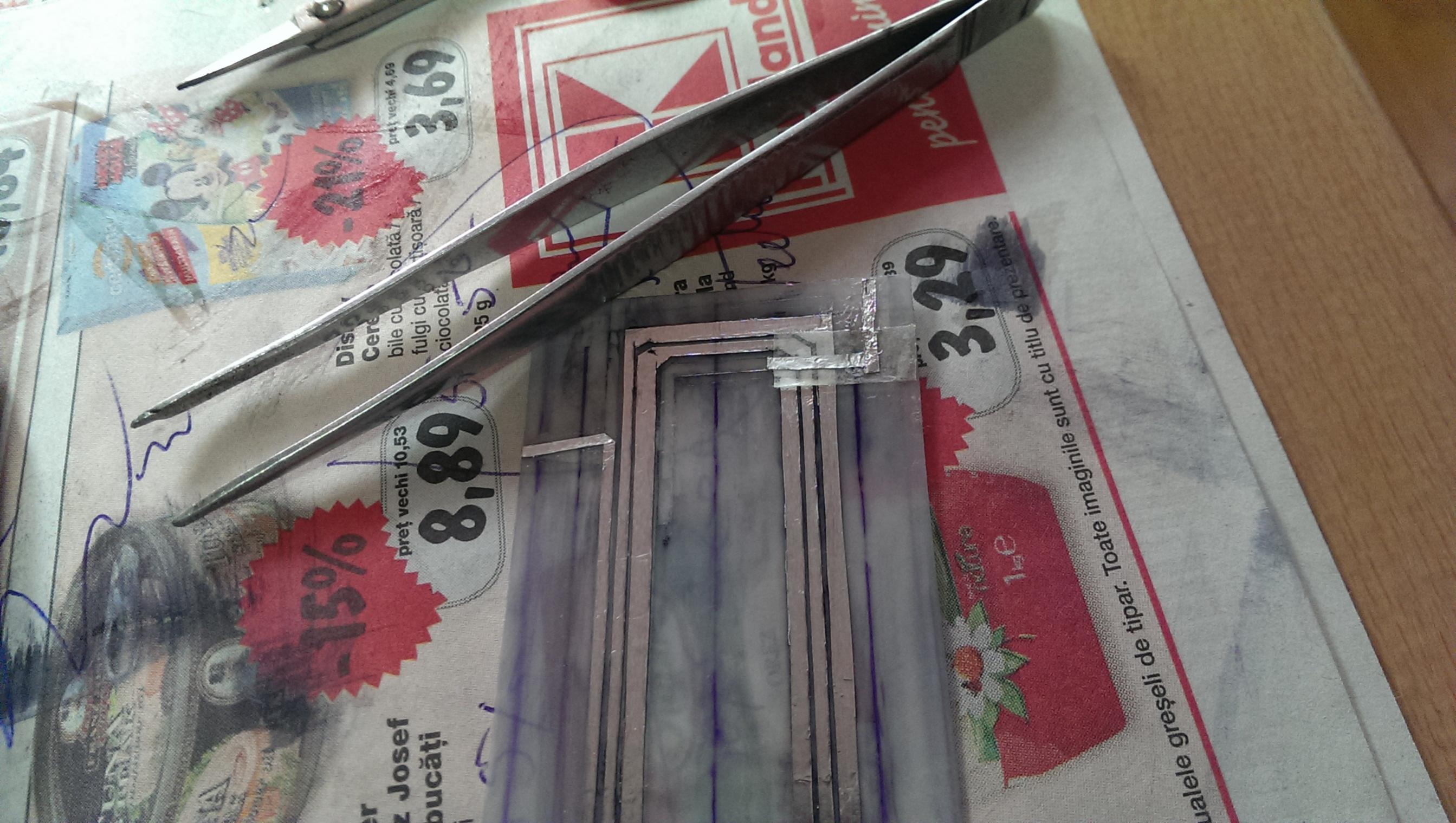

Another aspect is that i made another former, this time its made from 250gr/smq folium with hard laq on it (will not use double adhesive tape never) and more atention to details like the connection with copper wires as you can see in the pics bellow (they are now extended outsyde with Al foil). I will use this former with the blue membranes that i cuted.
Another aspect that i have to test again is the inversed polarity...
Anyway, will see tomorrow how it will go.
Cheers
Sergiu

No probs my friend. I just assembled the 4 variant (the one with folium variant@former without glue on it like the double ashesive tape case). Now we are comparing apples with apples as seen in the pics bellow except the former density and material.
The folium that i use for the 4 variant is the same as the one used on the very heavy ruban membranes (with poor dB) @250gr/sqm, and guess what, it seems that the density of the material heavily influences the mids and hights region as i listen to both of them (subjectivelly). The 4 version, is now without the 50% aded laq on the membrane and beats the c**p out of 3rd in terms of clarity and extended hight frecv. All other caracteristics remains the same.

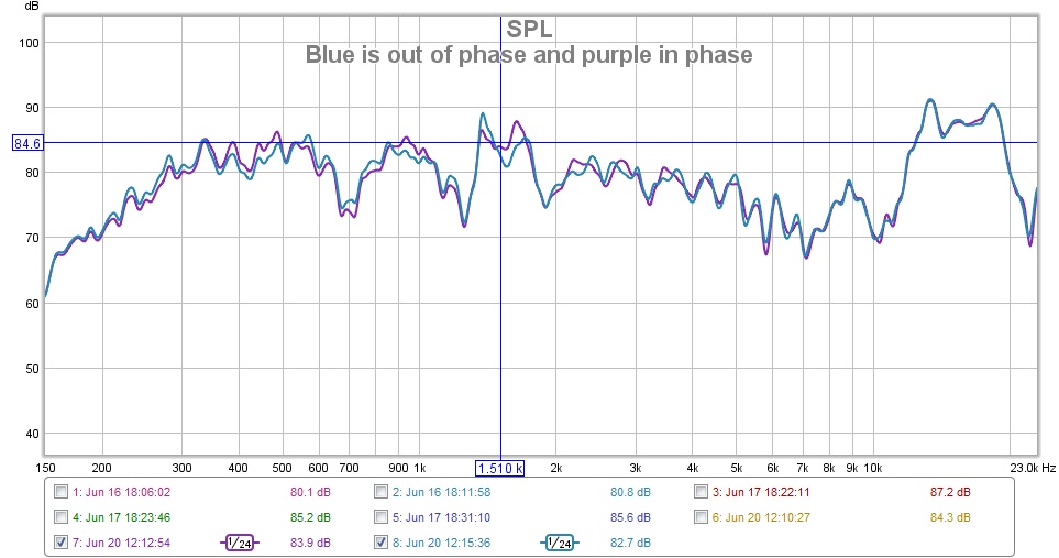

Wrine, here they are: the reverse pol vs corect polarity results. They are on axis measurements of the 3 version. I made the cilinders back to 4 cm hight per half. Blue is reverse pol (i wrote out of phase) . As you can see i pointed out with the program cursor the zone where it has been afected most.
As you can see the polarity does influence the measurements of this speaker. I'm keeping it out of phase (reverse polarity)...
Cheers
Sergiu

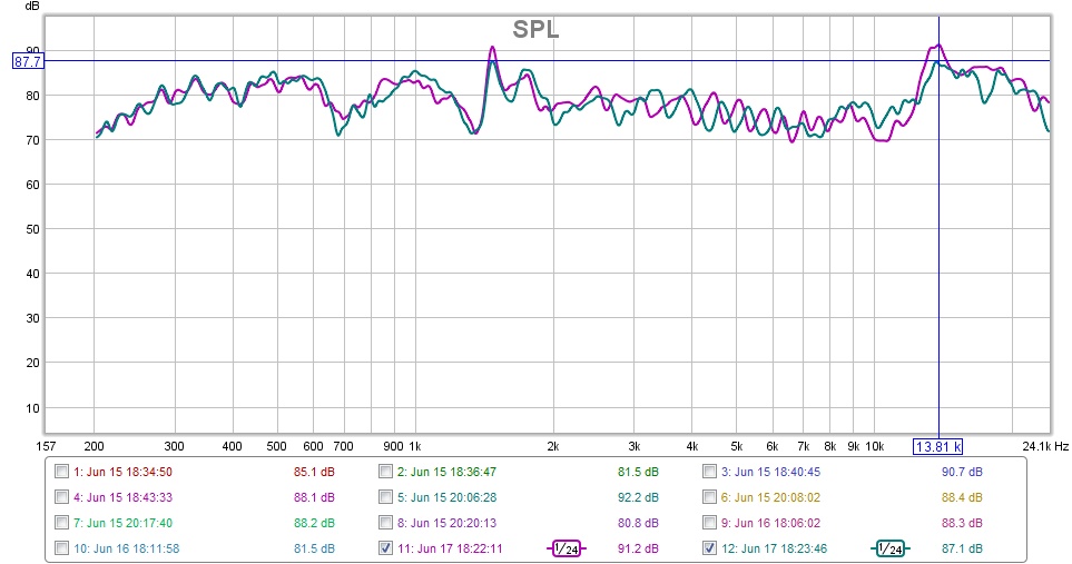

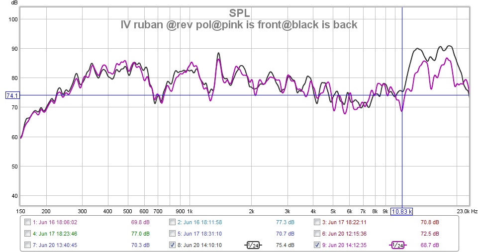

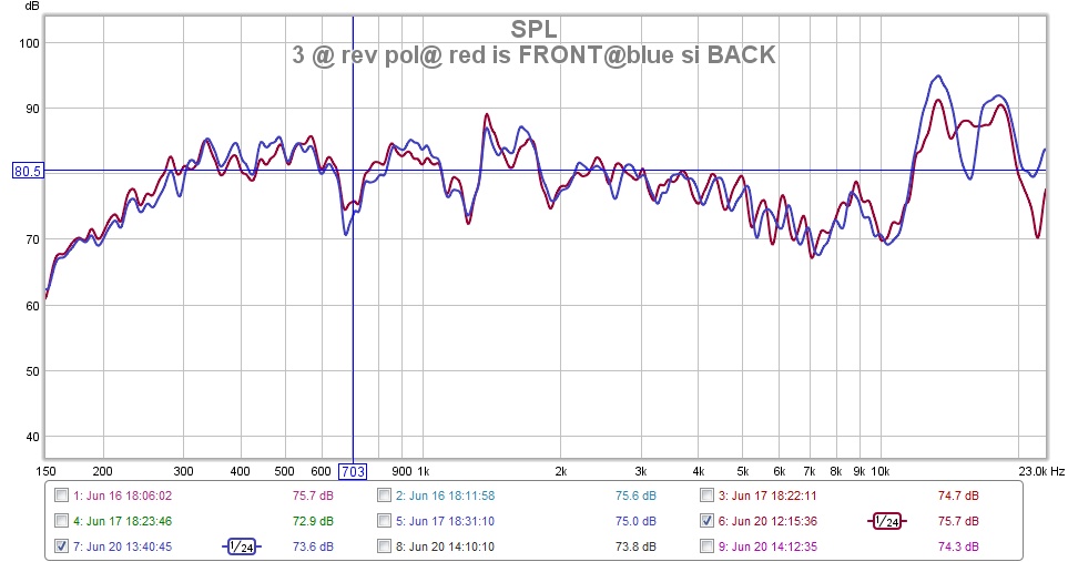

Impressive findings keep comming. Here we are Wrine as you sugested: reversed polarity front measured vs back measured on 3 (III) and 4 (IV) versions. Measures are taken 4 times on each speaker at 5 mins differences (because i couldnt believe it!!!). Checked twice the bondings between the membranes, the coils, the centering. I used the same distance for measuring, and the same dB when checked dB SPL (around -22.5dB each time) so each time i have the same conditions.
The strangest conclusion till now is that the speaker polarity influences the overall frecv response on each syde front and back.... 🙁🙁😕😕😕 :mummy: :redhot: :xfingers: :bomb:
Look at the graphs bellow, normally it shouldnt be like this......
PLease measure too and report back.

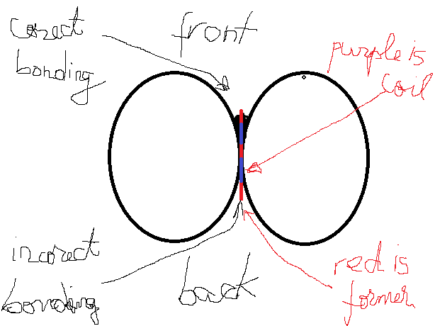

Well i found the problem on IV version: it seems that the front is bonded corectly and the back , well, the back is NOT.
The conclusion is that PEOPLE BE CAREFULL AT GLUING THE FORMER TO THE CILINDERS. If its not bonded proprely you have peaks and resonances. You can easily check this with a mic, and if the back measurement differs too much from the front then you have a bonding issue.
To continue with my measurements i will use the front wich has lower resonances and has lower peaks and dips.
Look at the pic that i draw bellow and you will see what i meant. As you can see in the back, the glue has drained down leaving too much of the former exposed, but in the front, because i have seen the laq and the super glue from the back draining down i applyied the gue when the ruban was laying horizontally (its the best way to rectify the membrane if it doesnt bond from the start).. I draw it because you couldnt see it in the pic..
