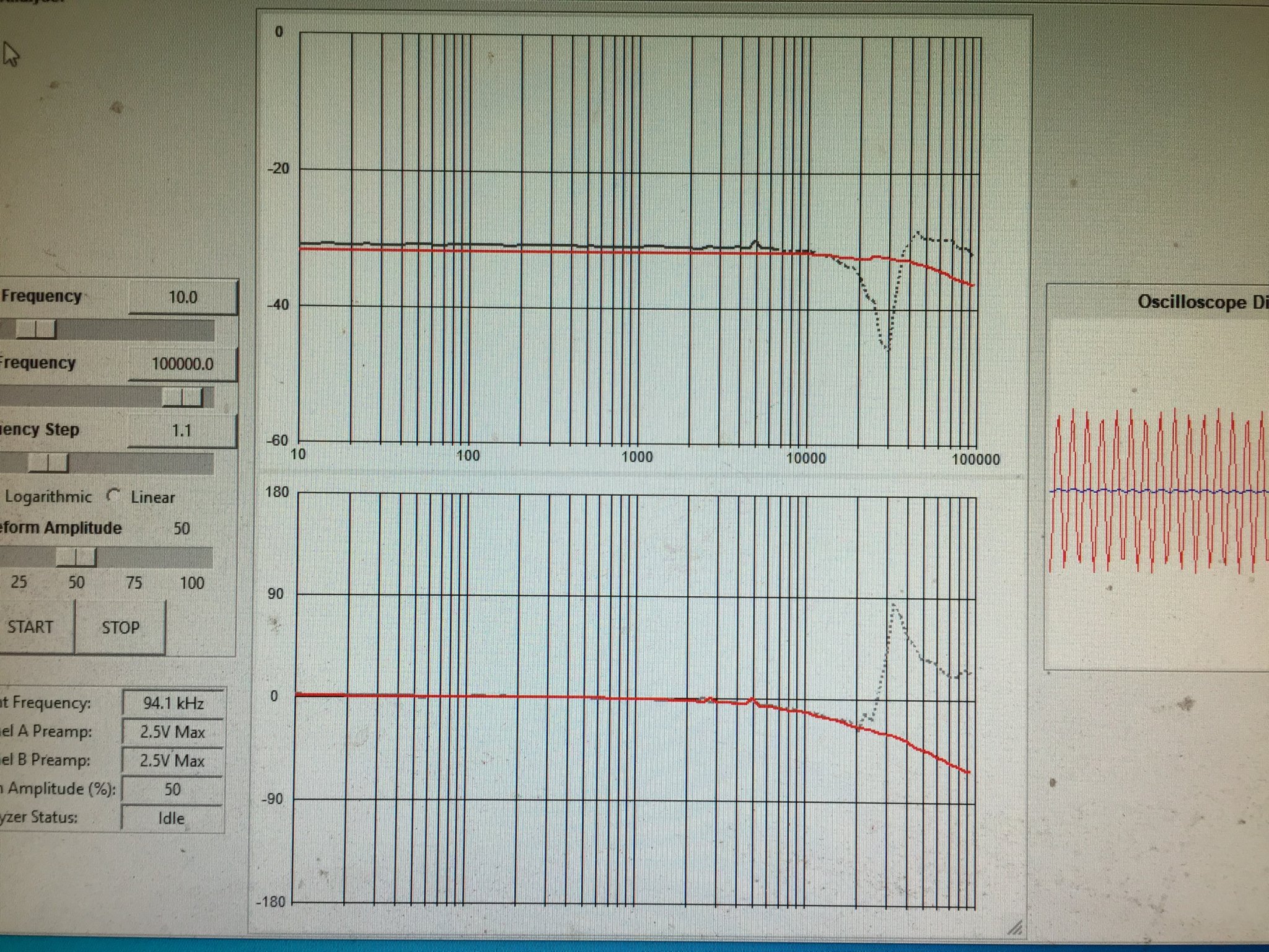

Here are the plots of the a antek 5000k:8R 15 watt purpose wound output transformer. 16r load on 8ohm transformer tap. Will do again tomorrow with appropriate load resistors
Comparison of the two lines on the upper chart is amplitude vs frequency with 56k and 10k in series with the generator that is built into the syscomp circuit gear mini USB scope. The 10k line is the flatter of the two.
So if what I’m understanding from you is correct, 10k is more than adequate to use in measuring the worst case response curve, if the reflected load would be 5k from a speaker, regardless of whether pentode or triode driving the transformer? If that is the case, using the 56k load is just making things look needlessly bad, and maybe the mains toroids won’t perform so badly after all? They looked not too much worse than the purpose wound output transformer at 56k source impedance.

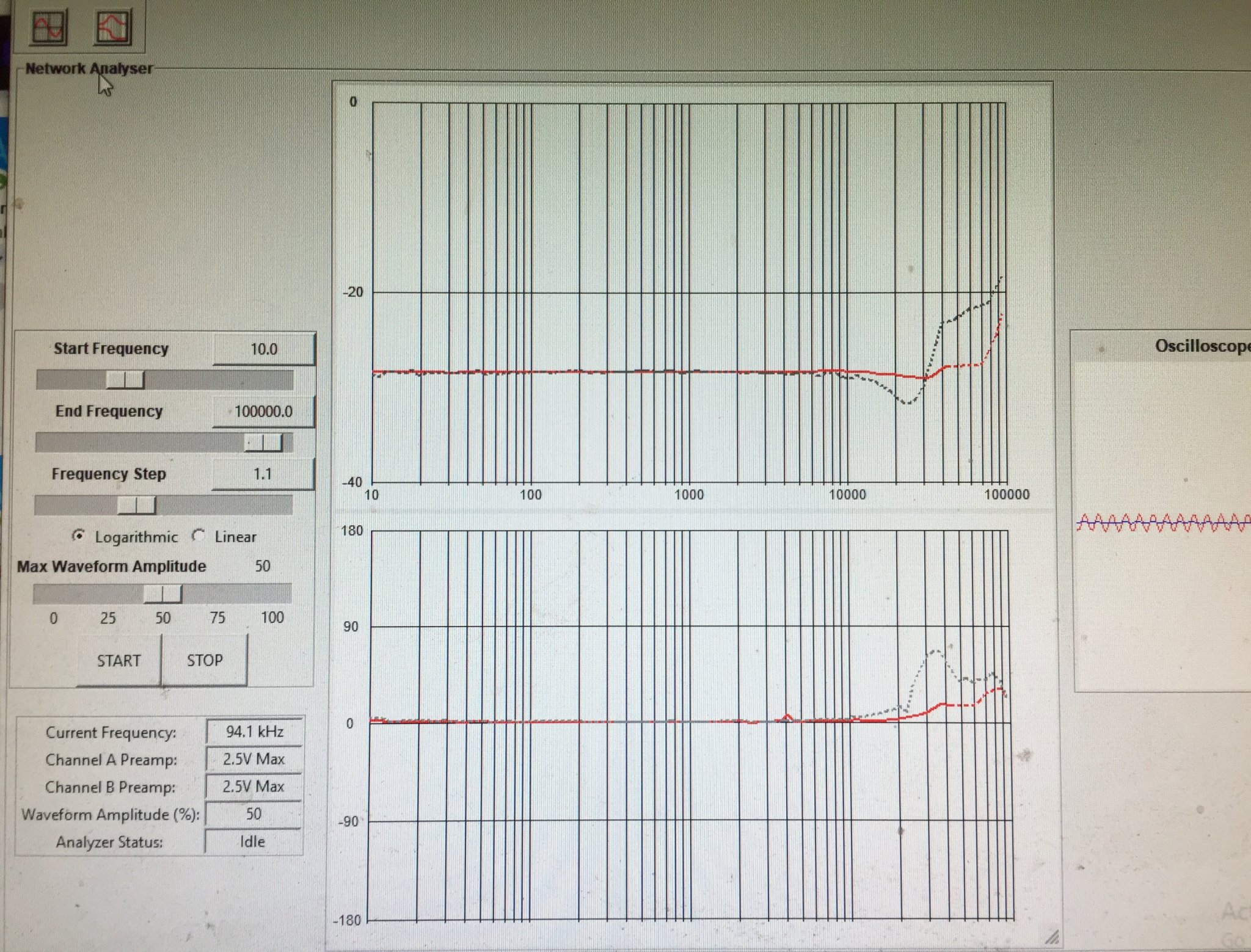

Gray plot is the MP-15W50, red is a single AN-0215 transformer with primaries in series, and secondaries paralleled into 16R. The dip at 24khz is about 2.4dB.
These are both with source impedance of ~10k
I’ll do tomorrow with 4R load for the AN-0215, along with the interleaved primary windings and two transformers as used by @kodabmx, and see what it looks like, and of course proper 8R load for the MP-15W50.

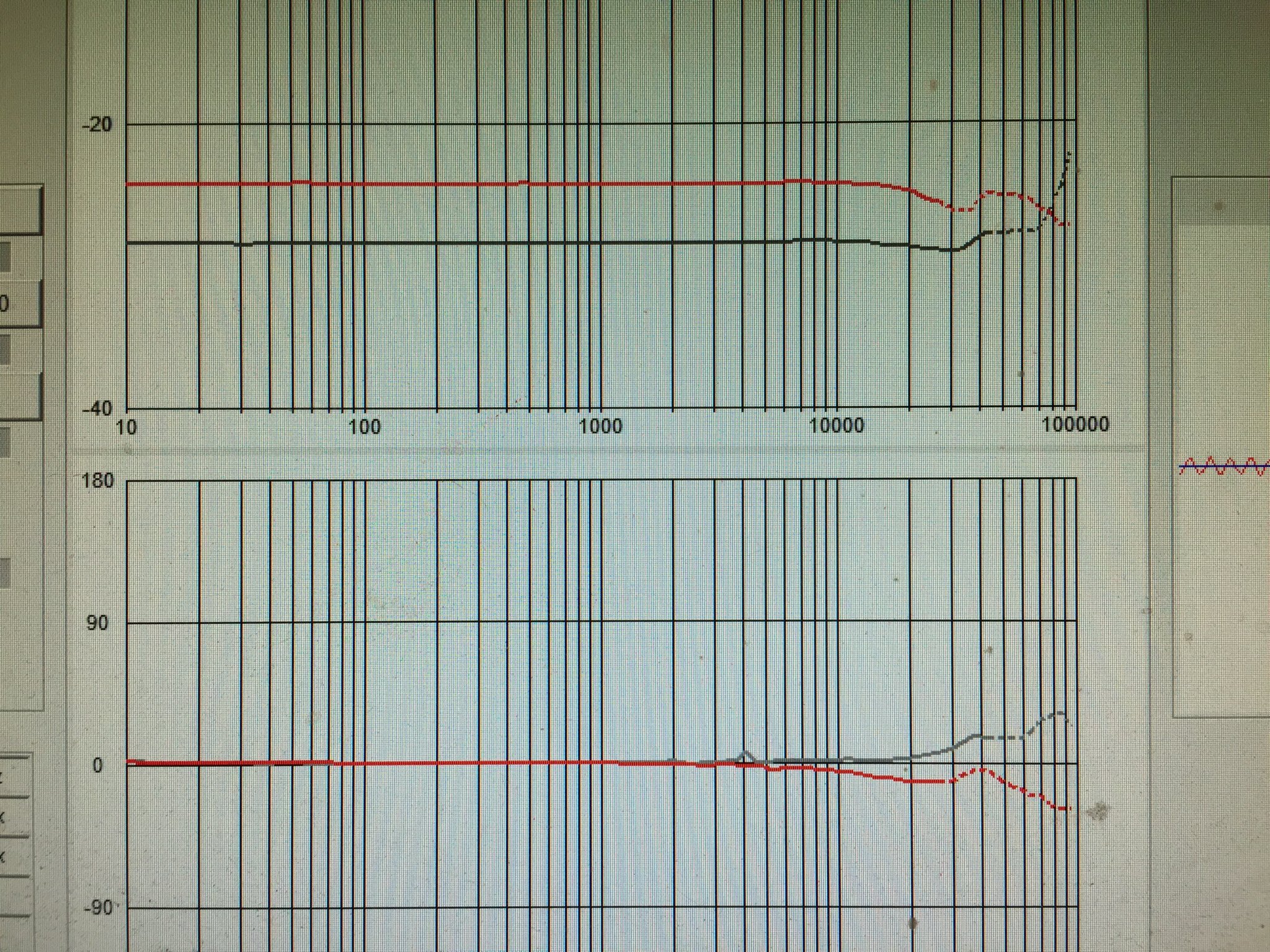

Here are frequency response plots for the stack-o-donuts. I interleaved the primaries from the two transformers all in series, with the secondaries all paralleled. This is the 25va antek toroid. Gray plot is with 10k source load, red with the 150 ohm source impedance of the generator. Both plots into 4 ohms.
I measured on one of the 50VA transformers, and found that the turns per Volt on the secondary is about 8, with 115v on one of the primaries. I may need to take off the belly band in order to wind on extra secondaries so as to be able to get 4 ohm and 8 ohms on the outputs. Did not get a chance to measure turns per volt on the 25va models.
