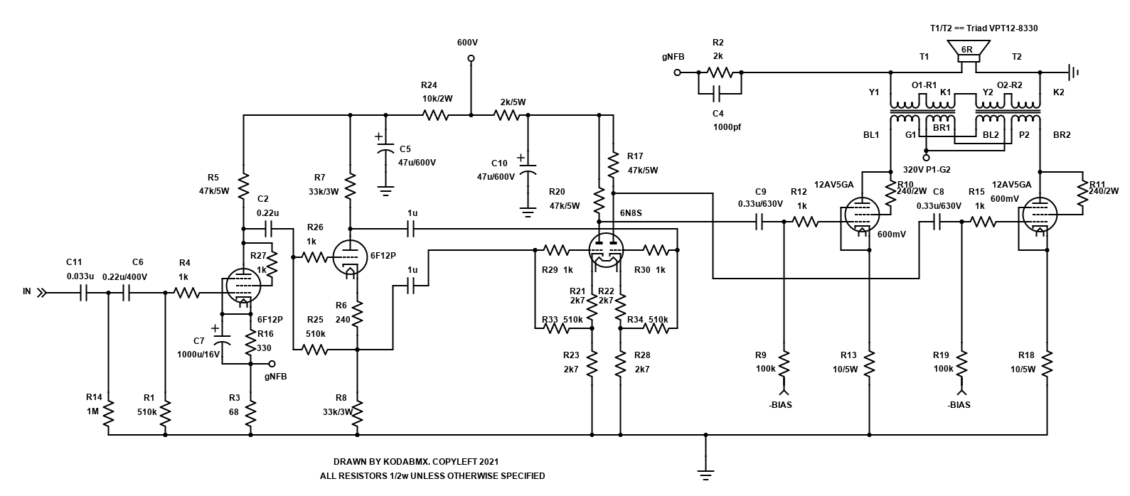

I don't see any problem with transformer current, it's standard push pull 🤔. The driver currents still balance out. You still need to drop the input stage and phase splitter supply voltages, you don't have 450V anymore. Something like the attached, which also shows how to connect the feedback with an led (or bypassed resistor in its place).

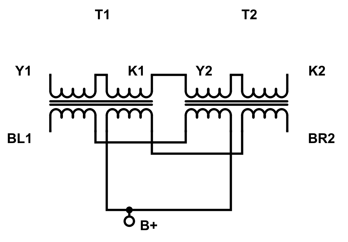

See #2. He's been clearly speaking of and showing in his schematics four individual mains transformers as a replacement of a PP output tranny.

I’m looking at trying a pair of mains toroids with the all four primaries in series, but pretty sure I’ll be using proper output transformers in the end. The more I play with this, the more I am reminded there is no free lunch 🙂

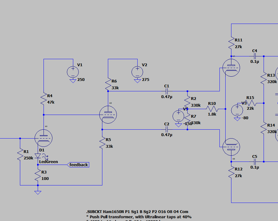

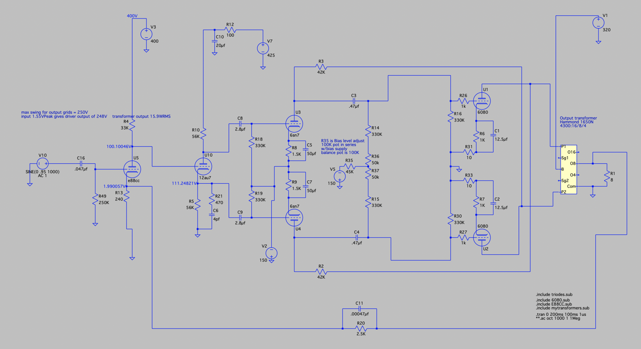

Getting closer! Thanks to a question from Ketje, I decided to try with the extra bootstrapping that comes from connecting to the plate windings directly instead of just at the UL tap. This achieved positive results in terms of being easier to drive, and showed an improvement of distortion numbers. Most of the distortion at higher output levels seemed to be coming from clipping of input stages or the driver, and easing the driver’s job only seems to help in this regard.
the only way I could get enough difference between the input tube and the phase inverter and achieve direct coupling and headroom to spare, was with a 6dj8/ecc88. I did some iterations with the bootstrapping coming direct from the plate windings and found it to be superior in terms of being yet easier to drive the 6089/6as7 fully so that it would clip before anything else in the circuit. I am still learning, so if having the output tube clip first is poor practice, I’m open to suggestion. This version and the parallel output version of the same have sensitivity to 1.55v for drive to the output tubes that will be hitting the limits of the grids being driven to zero.
Today I dug around in my small pile of 6080 and 6as7 tubes and checked three of each on a tube tester for balance. Some were terrible with one Section at 66 and the other 78 or so. Some other tubes were much better matched at 77/78. I will have to check at actual circuit voltages and currents to see if this holds up, or if it’s just at the tube tester‘s operating point. I only have a few new in the box tubes of these varieties, unfortunately, but every used one that I have tested has had plenty of life in it still. I considered for PPP design, that one could use an unbalanced tube with a similarly unbalanced tube, and get relatively good output. For proof of concept, I will make a simple output stage with one tube per channel, rather than parallel push pull.
I was hoping to make a pair of mono amps, but since I can’t find any tube better than 6dj8/ecc88 for the input stage, I may just have to build in stereo. I’m not at all worried about the drivers and outputs needing 320V, while the voltage amplifier and phase inverters need 400/425V. a second supply that is only feeding the 10ma or so to those two tubes (or one tube if I find something suitable) shouldn’t be too much extra work.

John Stewart, if you’re still watching this thread, I’m curious why you decided to use the UL taps for the bootstrapping rather than directly from the plate windings as in the circuit I posted above. Is there some disadvantage that I’m not seeing that will come from this extra positive feedback?
regarding the partial fixed bias, I read somewhere today that there is a datasheet out there for the 6080 or 6as7 where they mentin partial fixed bias is ok so long as 1/3 of the bias is from a cathode resistor, so it looks like I’m close, but may need to tweak things a bit. My plan to test this is to build That part of the circuit and run it from a regulated power supply, and vary the plate voltage plus or minus some 10-20% to simulate a load on the amp’s supply and see if the bias stays regulated enough. I’m not sure how to make even a crude bias servo yet, but was looking at differential amps using 6j6 tubes of which I have many. They only need a 1/4 watt or so of heater power, so would be much more efficient to run than pure cathode bias if I could get them to do anything useful to help keep the 6080 tubes from thermal runaway.

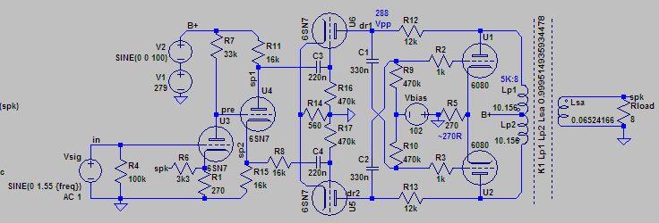

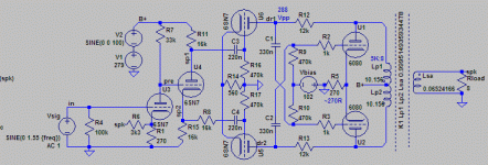

Still not sure why you need the high voltage for the input and PI stage, the voltage swings are only modest as all the hard work is done by the drivers. Post #41 used 6SN7s and there was plenty of headroom. Do you minding sharing your .asc file and the models you are using?
The RCA datasheet for the 6080 says for combined bias, the cathode bias part should have a minimum of 7.5V DC. You are well above that so I guess it should be fine.

This iteration of the circuit shewed up on the iNet about 2 yrs ago.John Stewart, if you’re still watching this thread, I’m curious why you decided to use the UL taps for the bootstrapping rather than directly from the plate windings as in the circuit I posted above. Is there some disadvantage that I’m not seeing that will come from this extra positive feedback?

I found initially that I needed close to 12 volts of swing on the driver grids at maximum output, to make close to 250v pp to fully drive the grids of the 6080 tubes, which are biased at -125v. I may have reduced that need a bit by bootstrapping direct from the plate leads on the output transformer. I will check again working backwards from the driver stage to see what voltages are needed. I wanted some headroom to account for variances in tolerance in tubes and other components, and I may have been too generous in that regard with the tolerances. I’ll try to post the actual files today or tomorrow.Still not sure why you need the high voltage for the input and PI stage, the voltage swings are only modest as all the hard work is done by the drivers. Post #41 used 6SN7s and there was plenty of headroom. Do you minding sharing your .asc file and the models you are using?
