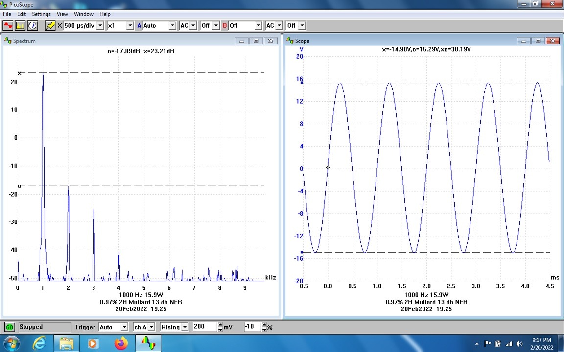

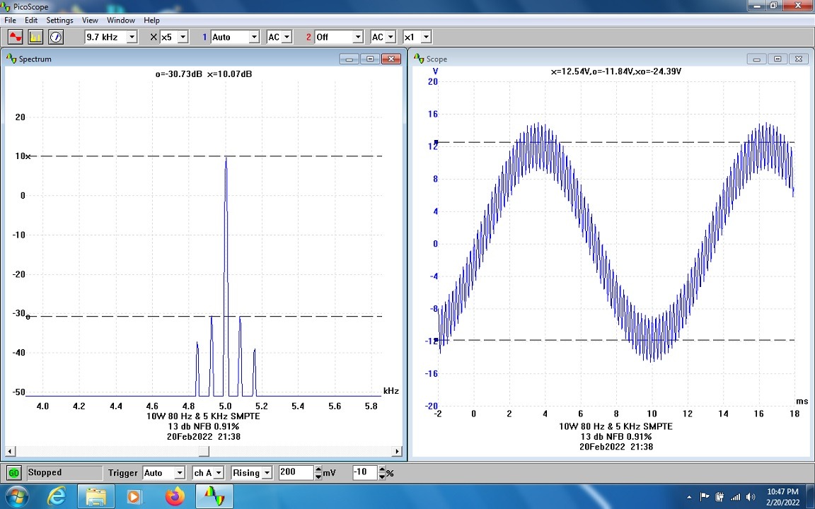

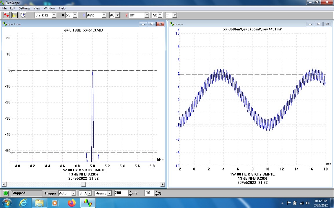

Here are some actual test results from today on this experimental PPP 6080 Bootstrapped Amp. Still looks good running with Mullard tubes.
But an AC Balance control would help a lot, looks like the 6080s are not well matched at all.
How does this compare with the favorite toob amp of others?

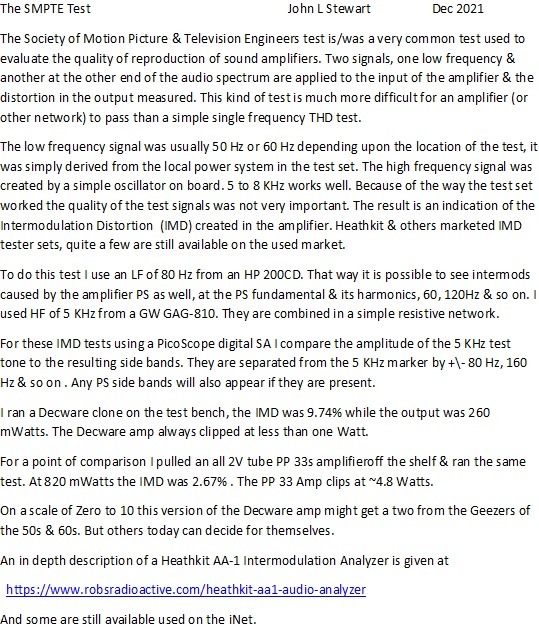

For those not familiar with the SMPTE test method a description is included.
SMPTE is more difficult for an amp to pass. But common in some fields, like Motion Pictures.

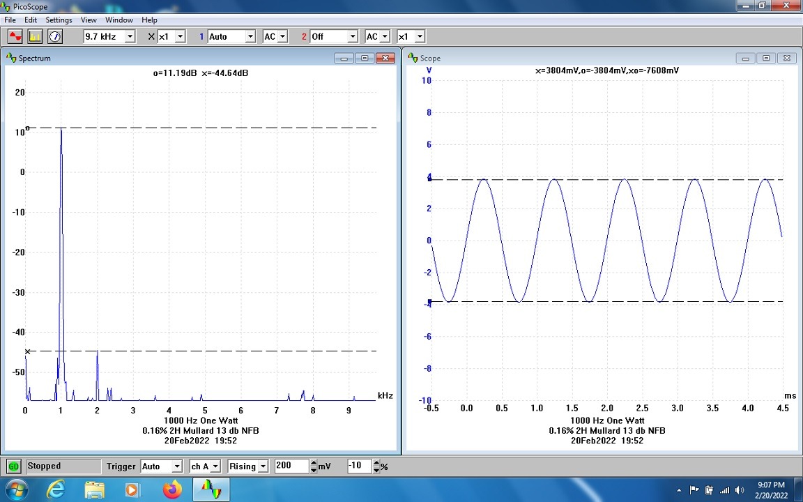

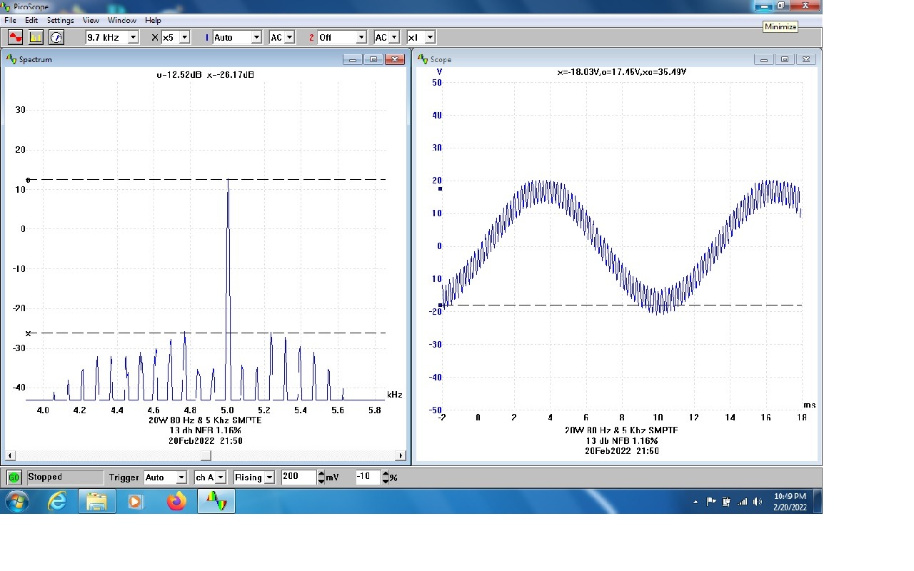

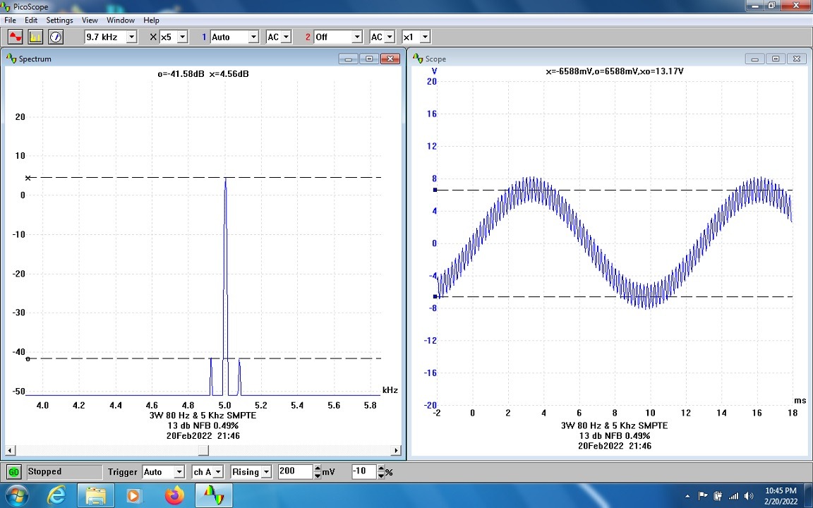

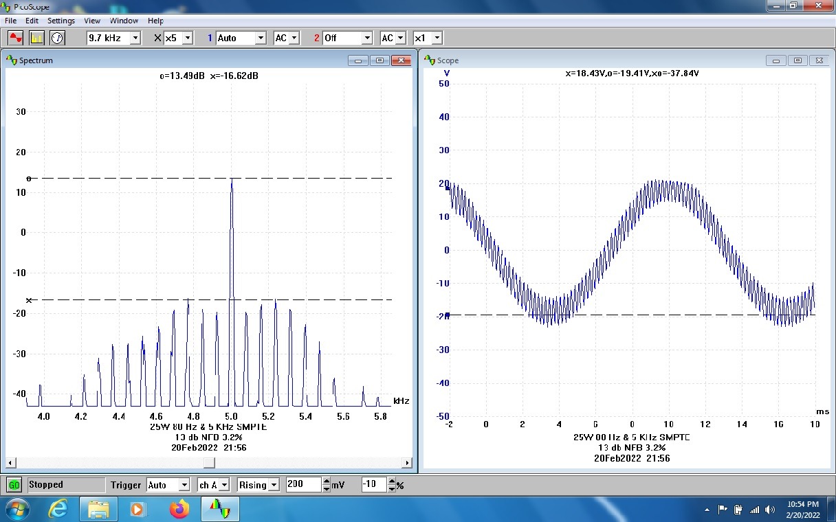

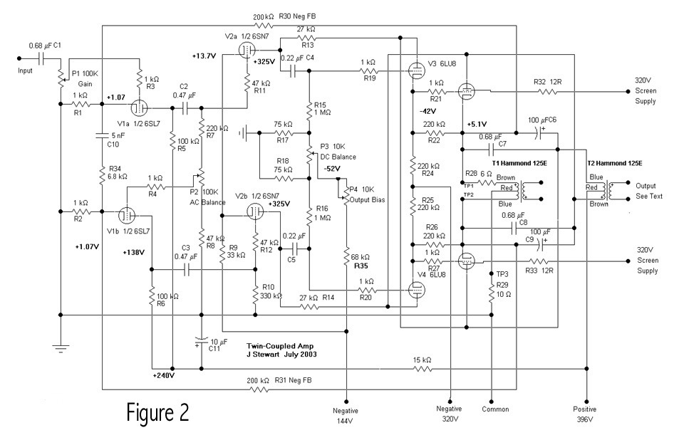

I’ve got a 200AB in pretty fine fettle (though could probably use better matched output tubes). I just got a 200CD for cheap from the auction site, that I’ll need to go over before using. Thanks for posting these test results, and explaining how it’s done.
John, where would you put an AC balance control in your original design? And with the push-pull driver, obviously that tube would do better if it is matched also. Would one put a control in to adjust the balance of the driver stage, and use that to also balance the output tubes, or would it be superior to have a way to balance both the driver and the outputs separately from one another?
I didn't put any AC or DC balance or other adjustment into the Diff Triode Amp.
It was strictly an experimental brain storm. All it was meant to do was prove the idea was viable & worked.
The attached is an example of what I've used in other amps. P3 near the center of the schema works very well.
And would be a good addition to the Diff Triode Amp.
I've been pondering another AC Balance control for a while, something that avoids current passing thru the wiper
in a pot. I'll put that on DIY soon.
The scheme in the linked article looks interesting. Some have tried with varying success.
