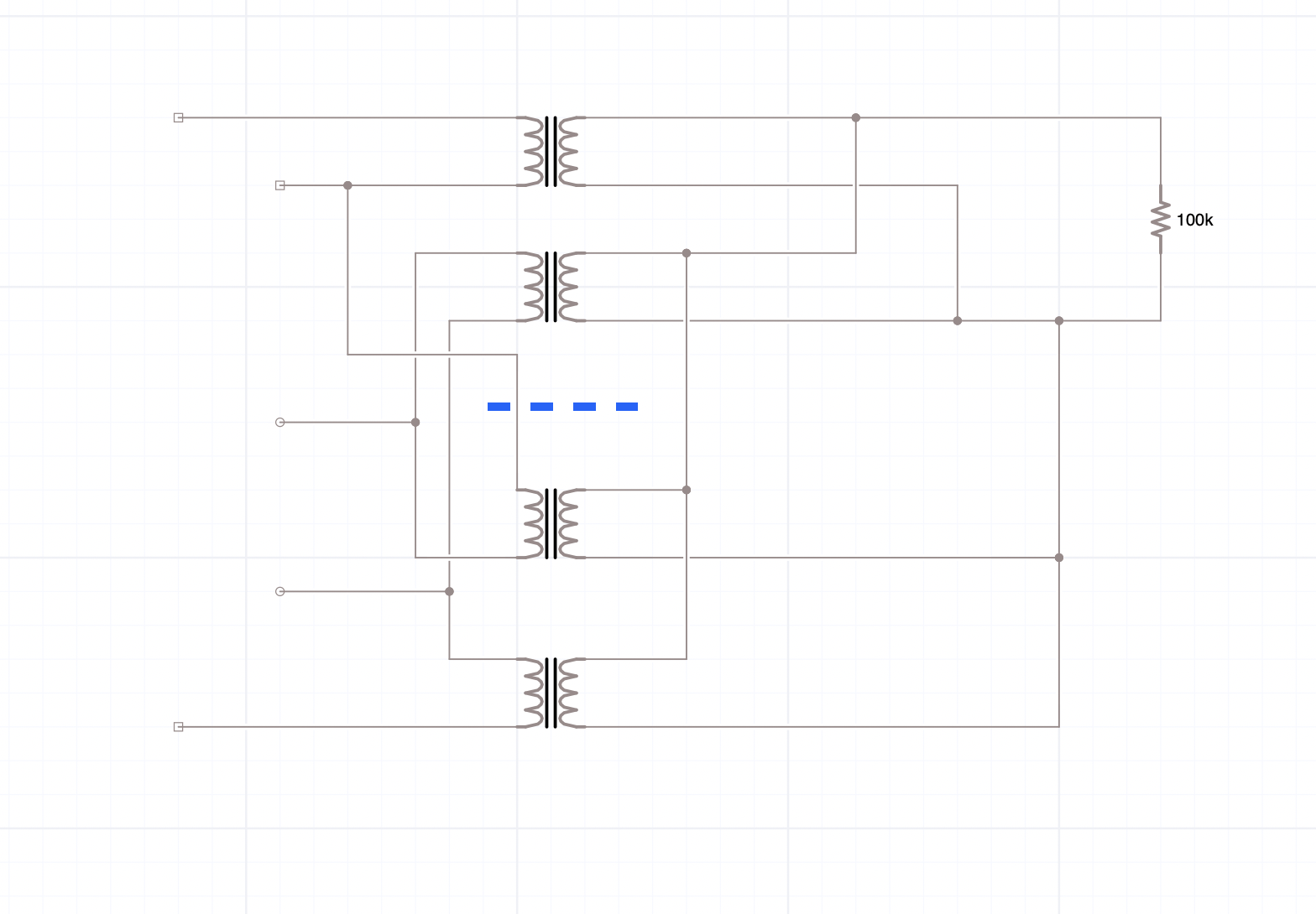

I’ll do tomorrow with 4R load for the AN-0215, along with the interleaved primary windings and two transformers as used by @kodabmx, and see what it looks like, and of course proper 8R load for the MP-15W50.

Here are frequency response plots for the stack-o-donuts. I interleaved the primaries from the two transformers all in series, with the secondaries all paralleled. This is the 25va antek toroid. Gray plot is with 10k source load, red with the 150 ohm source impedance of the generator. Both plots into 4 ohms.
