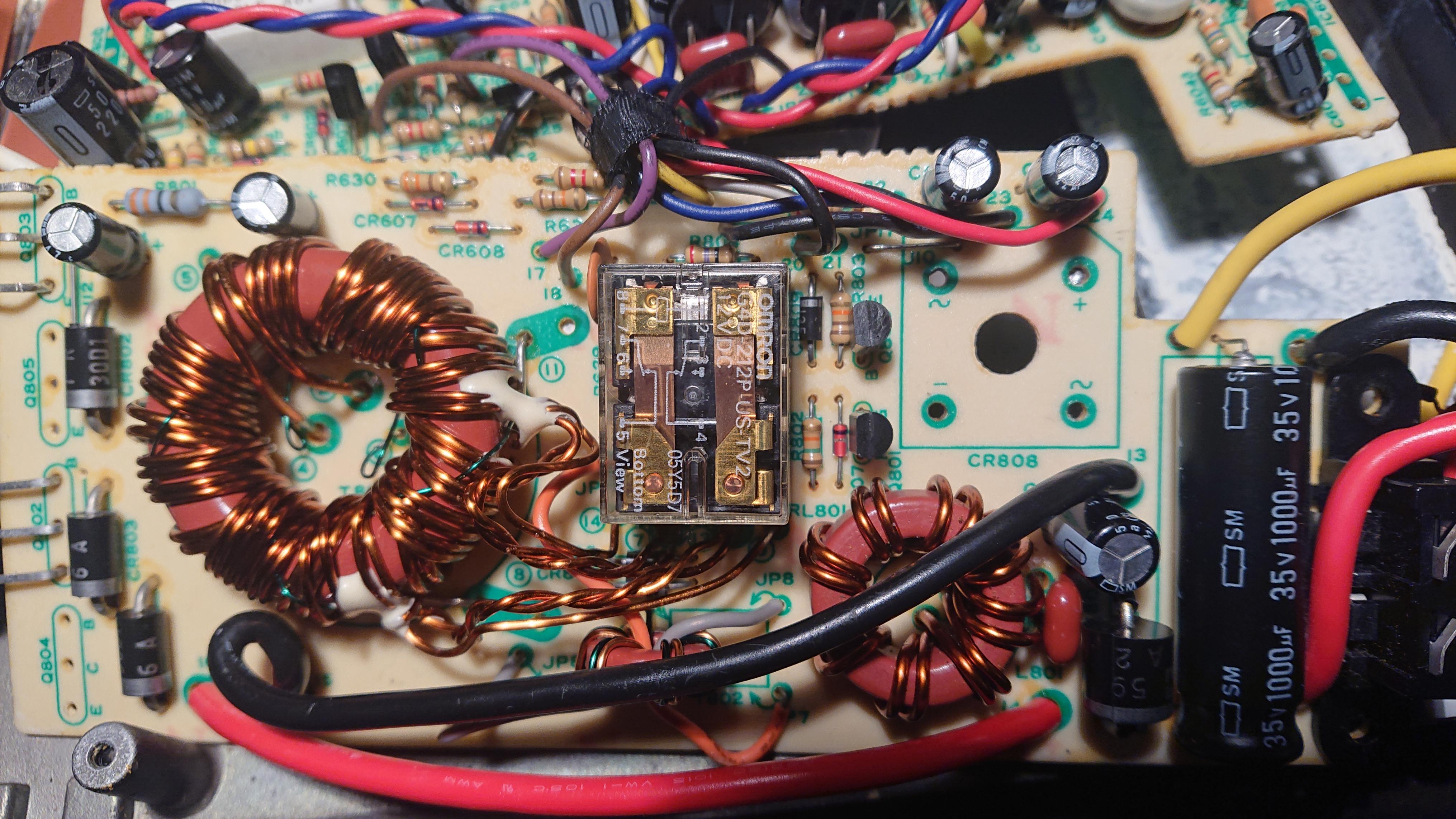

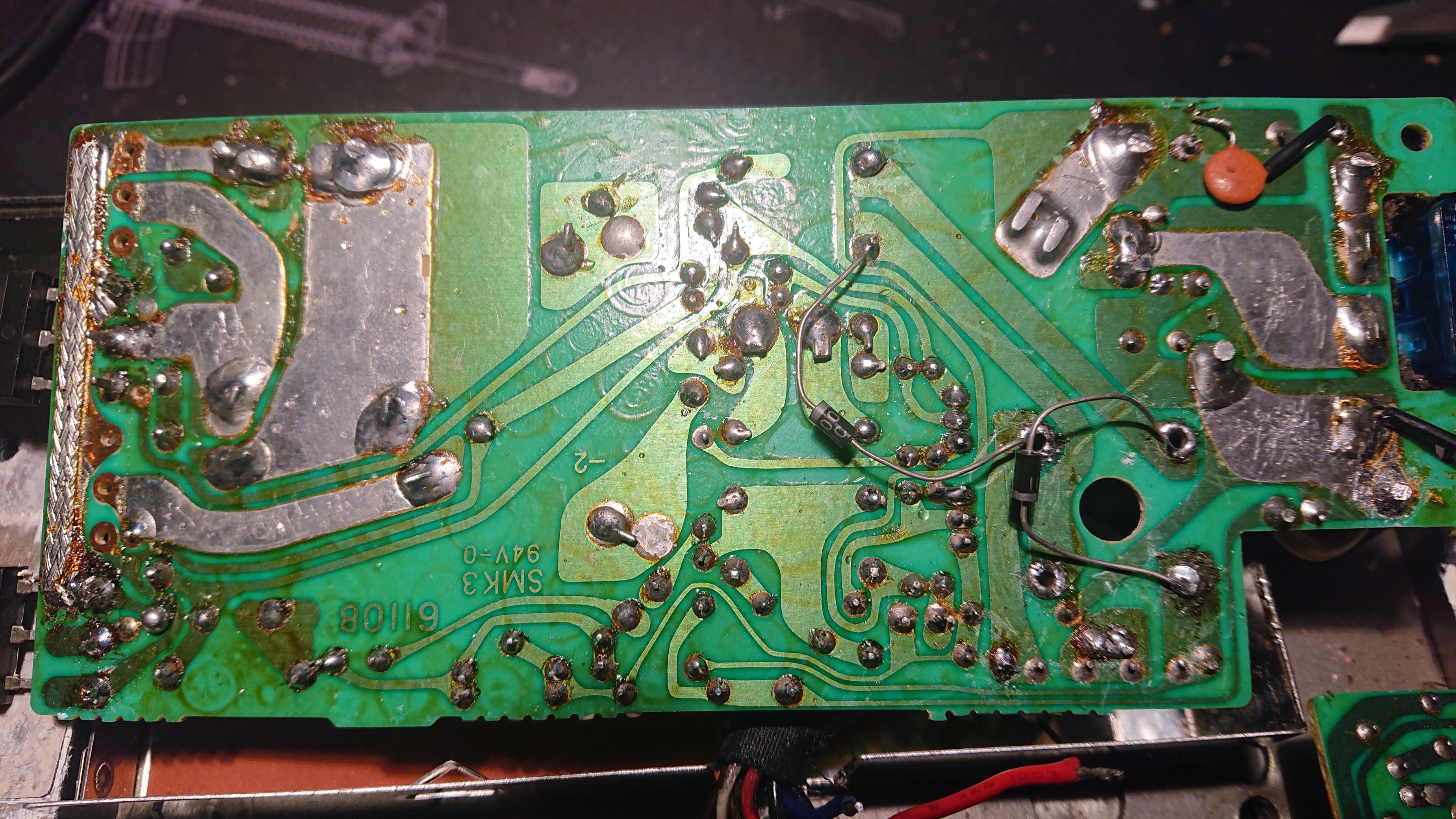

catching back up. Found that with all the working on this and flipping the boards over that a wire had become detached between the PS board and the audio board. I admit I was a bit frustrated that I felt I was going backwards, so I stepped away and did some caps on another amp. After that fixed the other amp, I felt renewed in my confidence and went back to this. We are back to pos rail not working. Everything else is the same as it was prior to me losing PS supply. In the diagram that I made, only pulling Q2 (for lack of better labeling) seems to get rid of the issue. Q2 collector is on the ground for both rails. So, I am not testing each component and eliminating them systematically until I can track down the one that is the issue.

It's possible that the problem is being caused by a component that's being switched on by another component.
Installing the lamp in the line between the boards for the positive rail will allow the amp to remain on. A competing heating up (allowed by using the limiter) may help.
You test zeners like other diodes. You don't generally test for breakdown voltage. That will show up in the circuit when the amp is powered up.

I made another mistake in my post. q2 (fictional transistor regarding the deviant schematic we have been using, but relevant to my simple one) has its EMITTER, not collector to ground for both rails. The PCB is printed this way. Im sorry for the mistake.

manually tested a lot of things on the audio board, everything i tested seems ok. I dont have a capacitor tester, so, not sure how to go about that.
I put the light bulb in series between the pos rail wire that goes to the audio board from PS rectifier and the moment it is connected, voltage drops to 2vac. Disconnect it quickly, and it return back to 33v. Hold it for 5 seconds and it does not recover for a while. Even after power cycling. Maybe 45 seconds for it to recover. even with the power off.
During this testing when you say it didn't recover, were you continuously monitoring the oscillation on PS transistors?
Did this oscillation stop when there was no recovery?
2V AC? Where were you measuring AC voltage?
continuously monitoring. Essentially, connected scopemeter, left pos rail disconnected, waited for it to power up, observed 33v square wave, touched wires together, observed voltage loss, immediately released and observed recovery.
scopemeter connected throughout the entire test. 2vac, as measured at the same test point of the pos rail. scopemeter connected to the same point at all times. This is pos side of probe to pos rail, and neg side of probe to the shared neg between the two rails where we have been focusing.
squarewave disappeared when voltage dropped out.
If you use the lamp to bridge the positive rail to the audio board, does the oscillation on the collectors stop?
You mean on the B829s? If so, I am pretty sure it goes away there too. Im at work now so cant check my notes.
Well, I guess technically, but it was at the input to the two diodes that we temp installed in place of the rectifier. Input side of those diodes. Not directly connected to the collector pins at the B829s. Can verify in a few hours.
