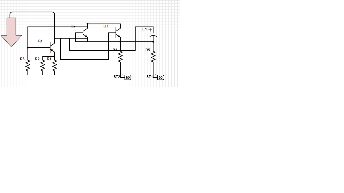

It is not. A couple pages back I posted a diagram of three transistors that are on this board and their configuration. I have since removed all three and bench tested them and they all test fine. The schematic I drew and posted is as close to the diagram as it gets.
If you're referring to post 175, that's insufficient. It shows no connections to anything, no resistors/resistor values, essentially nothing.
Agreed that wasnt probably the most useful schematic. I mostly drew it to show the arrangement of the transistors in the circuit. I will hand draw one this week to cover that area. Not sure if it matters, but I have removed and bench tested every transistor on the audio board and they all test ok. Thanks again for your patience with me.
Ok, this took a bit. Not sure how far out in which direction I should go here. Is this helpful? the big arrow is ground for both rails (the one with the filter caps on it we have been using as reference when checking square wave)

Why didn't you use the right designations on the diagram?
mF should be uF unless it's a huge capacitor.
That circuit appears to be the DC offset protection. You could remove those transistors and the amp would work normally. Try reconnecting the SCR gate and removing these one at a time, starting with Q1 to see if the amp shuts down.

I didnt know how to make the special character for "micro", so i thought "m" would suffice. sorry, Im glad you understood it though.
I reconnected the gate leg of the SCR and removed Q1. Problem is no longer present and it maintains square wave signal.

OK. Do you read any DC voltage across the two terminals for any channel?
Try with the switch in both positions.
If meter probes are polarity matched to the speaker outputs, both channels have +2.1vdc. Switch position makes no change in readings.
Short each pair of terminals with a wire. Power the amp up. Is there any significant current draw (more than what it previously drew)?
Well, I dont have my 87 meter here so I cant check current. I did check voltage and it is the same at 33.4vac with terminals shorted. Did this with both channels and nothing that indicates to me any big jump in current draw. Then again, I dont have an ammeter on it.
Q1 reinstalled, jumpers left in place. No rail voltage on either side.
Incidentally, prior to reinstalling the gate leg on the SCR, I did verify rail voltage. Then installed the gate leg and verified no rail voltage. Then after removing Q1, verified rail voltage.
Seems like the same result with jumpers in or not in when Q1 is installed.
