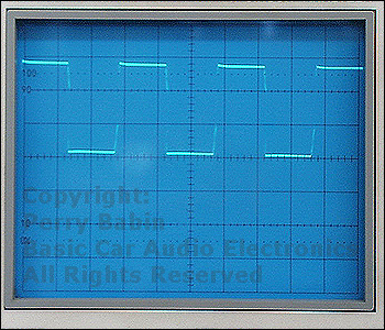

You need to leave the scope constantly connected to the collectors. The supply could be shutting down intermittently and you wouldn't know if you don't leave the scope on the collectors.

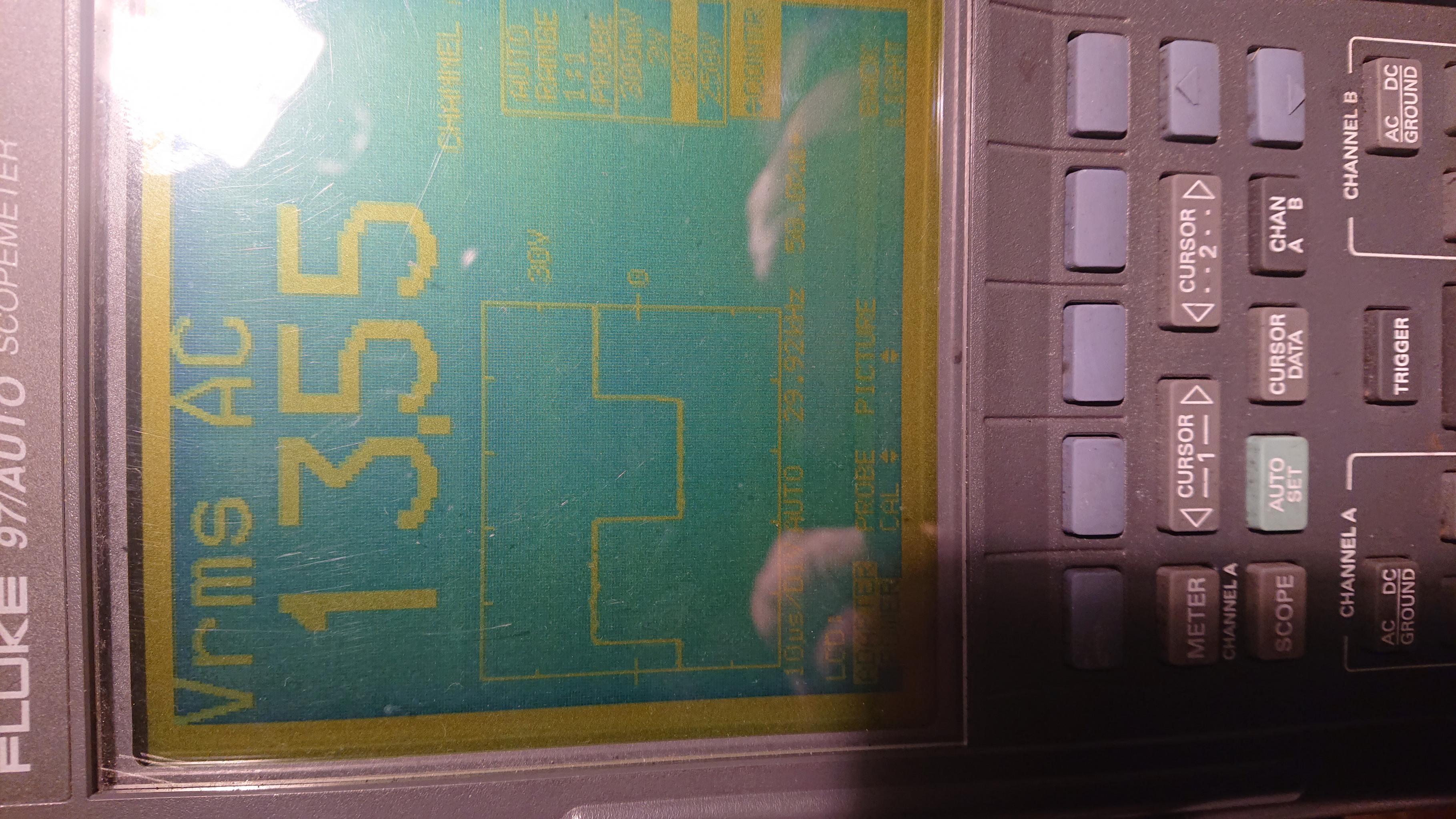

ok, since scope is only single channel, I could only keep it connected to one side. powered amp up, verified both pos and neg rail. voltage at collectors is 13.4vac with good sine wave. Keeping scope connected to one collector, then touched pos rail wire to audio board. sine wave turns really really noisy and voltage goes to 55vac. took lead off of one collector and tested the other collector with the same readings.

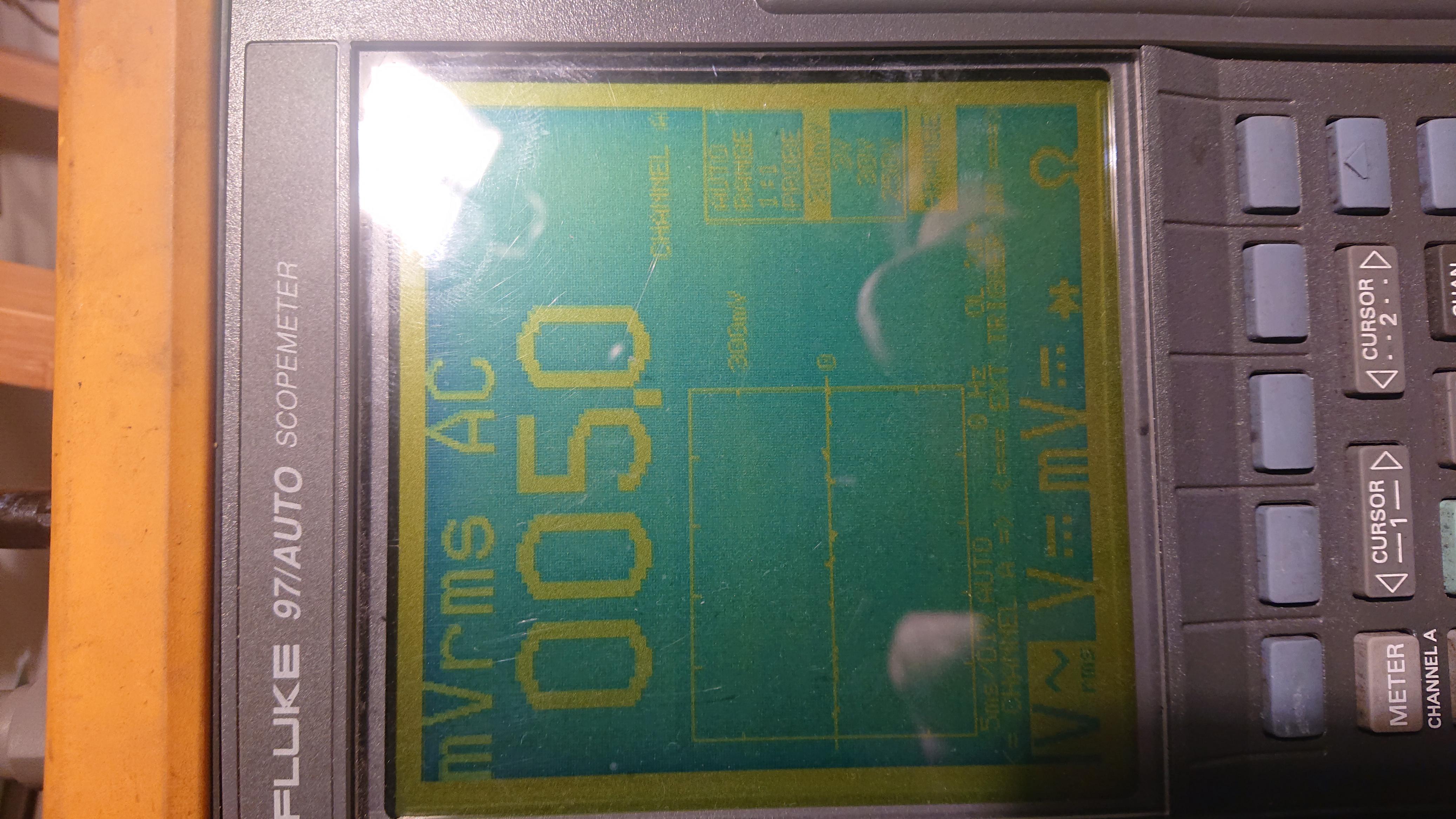

Before or after I connect the pos rail wire to the audio board? I get a really clean sinewave before. After that, I get almost nothing. Meter must have autoranged regarding my previous as I just went to grab some pics of what I am seeing and im getting 5vac and noise after I connect it. First pic is with rail wire not connected, second pic is with it connected. It will recover if the wire isnt left on too long. If its left on longer than say 20 seconds, it doesnt go back to a sinewave or 13vac. REmove power for ten seconds and reconnect and it wont recover to a proper waveform. Waited about a 35 seconds and reconnected and everything looks good again
What I was initially referring to as a noisy since wave did look like what is in the left picture. This is also when I swear the meter was reading 55v. I attempted to replicate this to take pictures after I posted and after three repetitions, I concluded the meter had automatically changed its range. I could not replicated this after doing the same test three times.

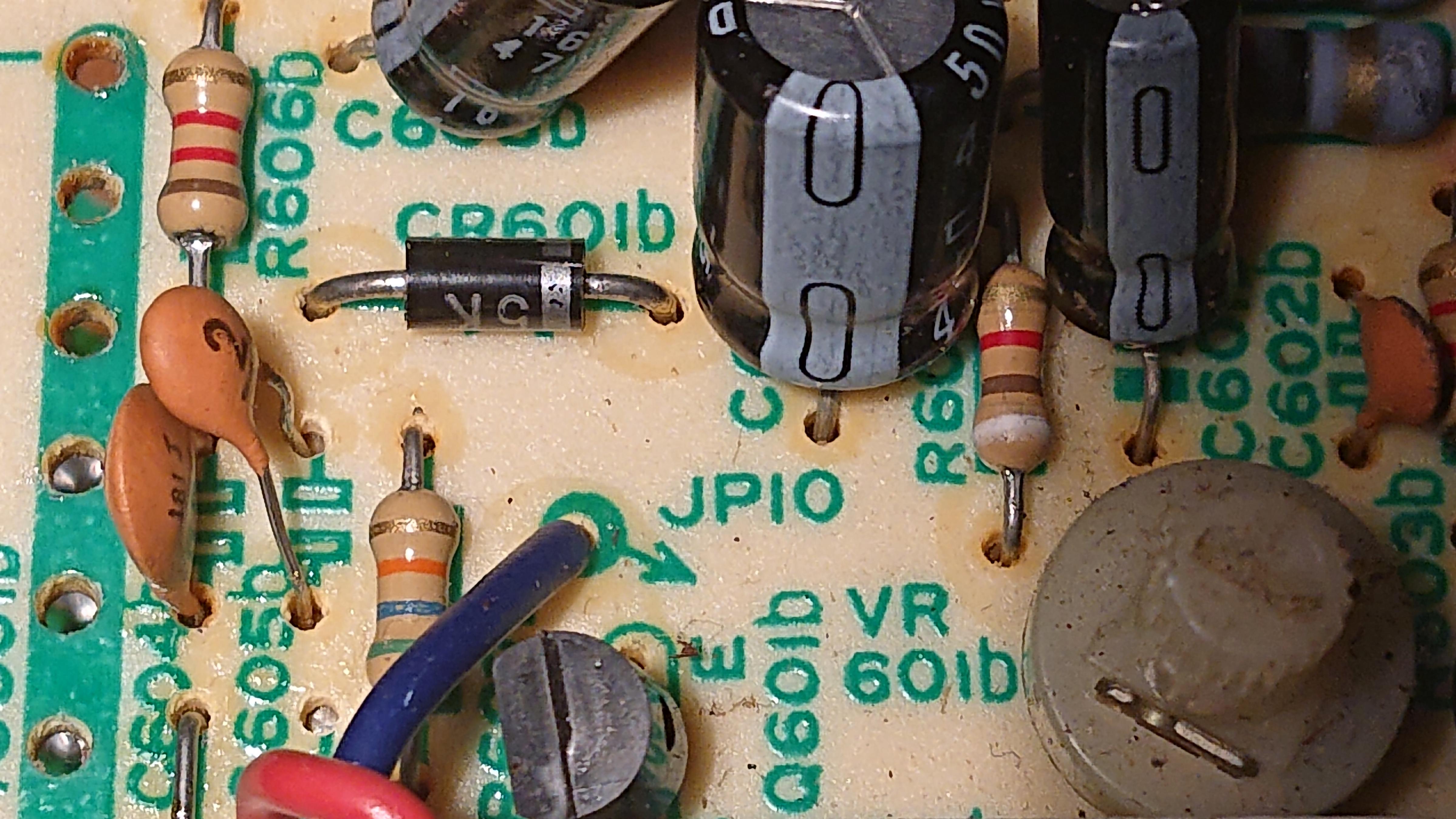

regarding leaky caps, there is a little bit of residue on the board. Im not familiar enough with leaky caps to know that might be solder rosin if thats a thing, or electrolyte on the board. I have included a pic to try and get you an idea of what I see. It may be nothing, or it may be something. None of the caps look suspect though. You can see at the leads for CR601b little halos where they pass through the board. Most of the components on this board have this along with some othe random spots. Not sure if thats a concern or not.
All of the components have that. It's likely flux that came through from the bottom.

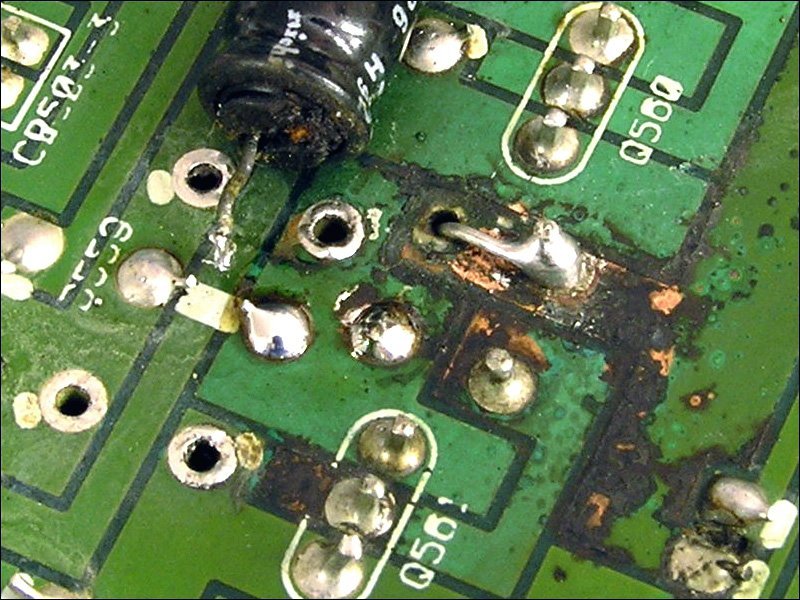

When electrolytic caps leak, it's generally obvious. The electrolyte is both corrosive and conductive. The image below shows where the board was damaged from a leaking cap.
