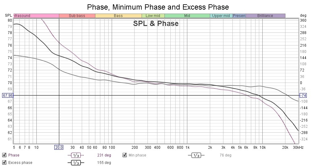

How does one reconcile the output of DRC/DRCDesigner with REW with respect to Phase, Minimum Phase and Excess Phase ?

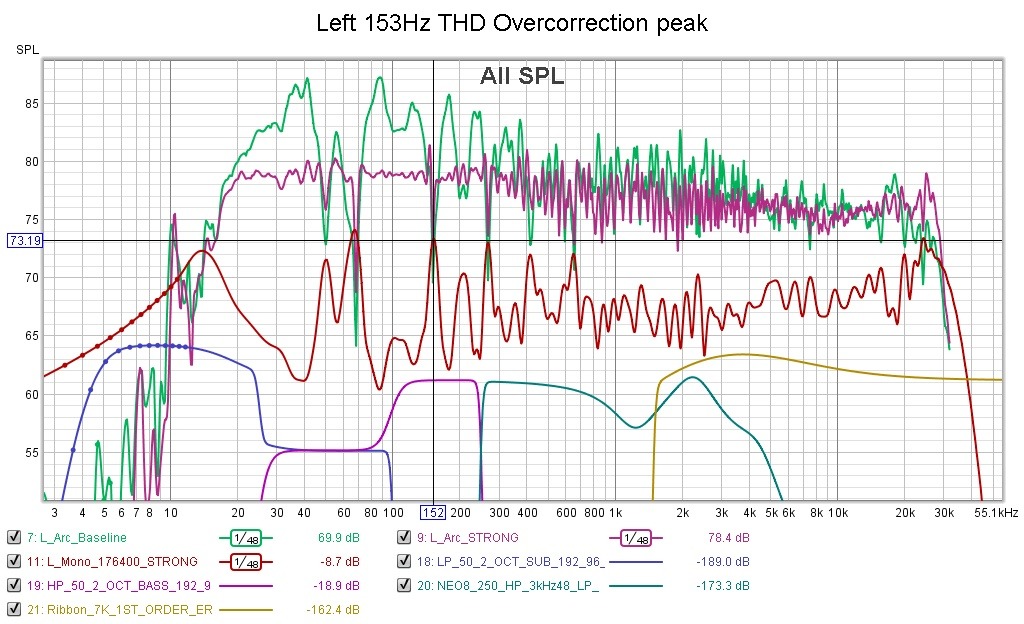

The following plot is the result of a STRONG full-range DRCDesigner filter applied to OB/Dipole stereo subs and 3-way line arrays. The XO's are linear phase made in RePhase and the full range DRC is done in DRC. Should the result be minimum phase or something else ? Should the minimum phase plot match the actual phase plot ?

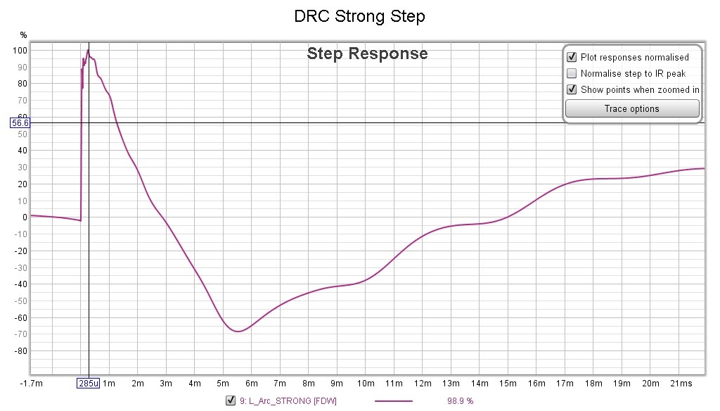

The second question is about interpreting the step response. I see many step responses with a graceful arc at the bottom after the initial peak. This one has more of an angle @ 5.ms versus an arc. What does this sharper angle indicate ? Both channel plots track each other.

The minimum phase response from REW represents the minimum phase version of the frequency response in the measurement. The REW excess phase response is the difference between the measured phase response and minimum phase response.How does one reconcile the output of DRC/DRCDesigner with REW with respect to Phase, Minimum Phase and Excess Phase ?
DRC can output minimum phase filters, linear phase or mixed phase filters depending on the settings used. DRC Designer may not give you access to these options.
If you asked for a minimum phase filter it should match the minimum phase response, if you asked for something else then there will be excess phase.
Sometimes there can be some overall delay in the measurement which will affect the HF phase response, you can realign the impulse if there is by offsetting the T=0 time and see the effect.
The step response does look as if it has some linear phase response before the peak and doesn't follow the minimum phase response entirely why is why there is that kink in the step.

The first set of filters caused 2 over-correction distortions on 1 channel and 3 in the other between [100-200]Hz. I redid my crossovers around that region and was able to reduce the over-corrections from 5 to 2 and minimized the severity of the remaining 2 but did not eliminate them entirely. Still have those 2 to fix. Drc.exe is trying to correct 2 deep narrow nulls that the bass driver doesn't like.

Look at the Dip Limiting settings DL and the peak limiting settings PL. If there is a lot of correction it can work better to apply a basic PEQ precorrection to get the response within a smaller window to make DRC's job easier and allow for lower gain settings.Drc.exe is trying to correct 2 deep narrow nulls that the bass driver doesn't like.

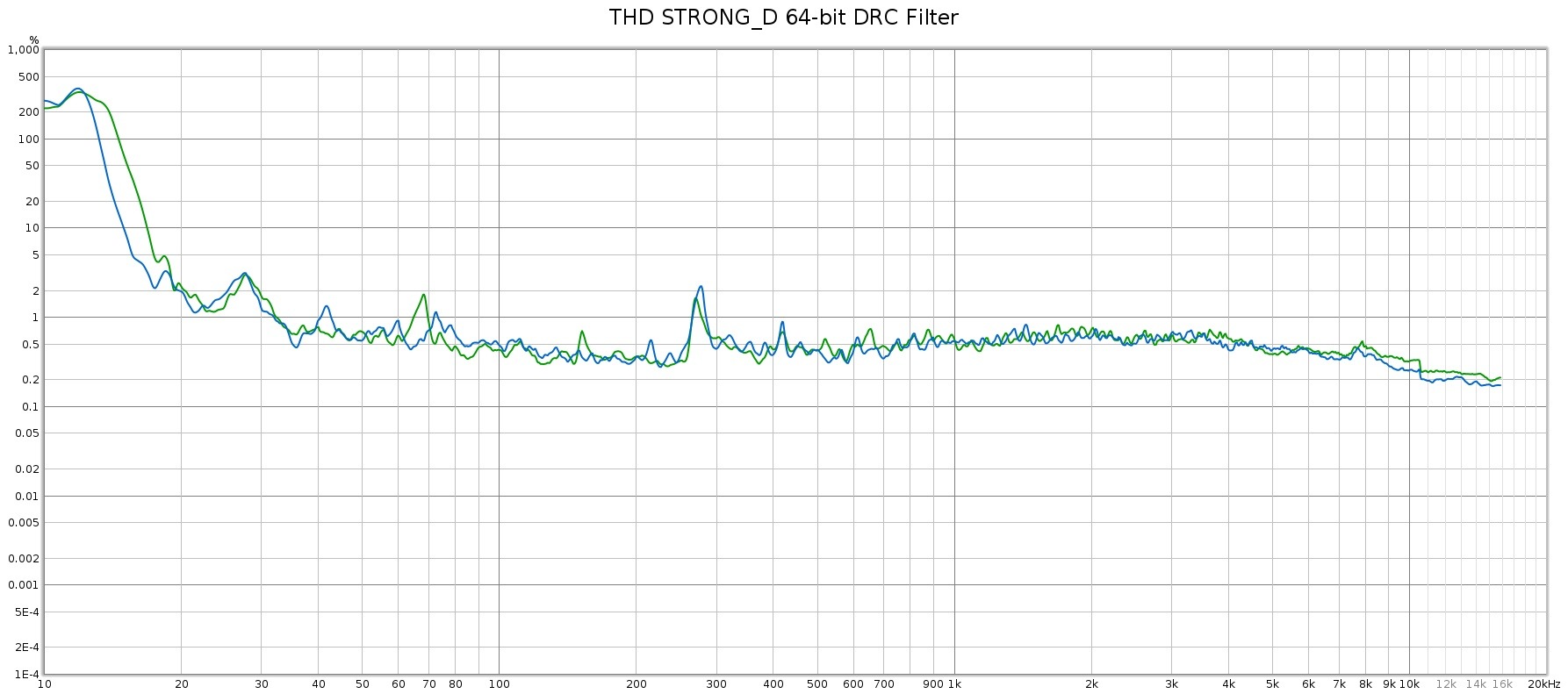

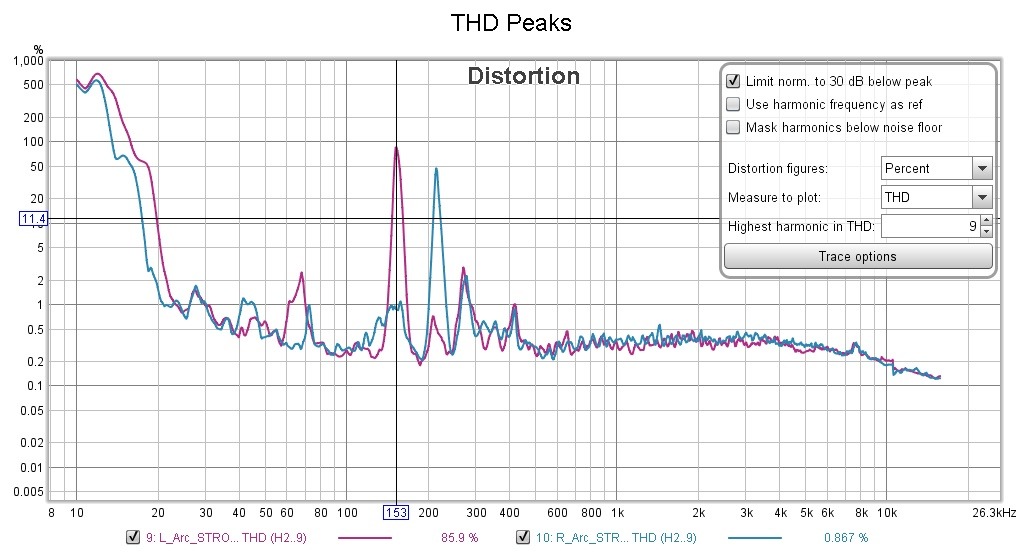

My 2 remaining problem over-correction dips are [left=154 and right=216]Hz causing the playback THD at those frequencies (different frequencies most likely due to the asymmetric room). Steep crossover is at 250Hz so both are happening with the bass drivers.

Where you have a problem is still relatively high in frequency, yet you might get away with a few additional tweaks.
Where DRC is trying to over-correct, you could add a manual EQ tweak to get rid of that correction and even a bit more.
Next, add some extra (EQ) in the other channel so the sum of both channels remains flat.
Do the same on the other channel so the extra (over-correction) energy is gone, and the distortion is reduced significantly as measured in the sum of both channels.
I think it is just low enough in frequency (if it's a high enough Q peak/dip) to get away with that while still getting a very good balance overall.
One channel covering for the other and vice versa. Below about 250 Hz it shouldn't be a big draw-back.
I did it with my system in one channel (left) at ~70 Hz and another "problem" at ~30 Hz in the right. Nowadays I have subs that help me correct it per channel.
It has never been a problem though with this simple trick, but as said, your problem area's are a bit higher. I still believe this might work well enough in practice.

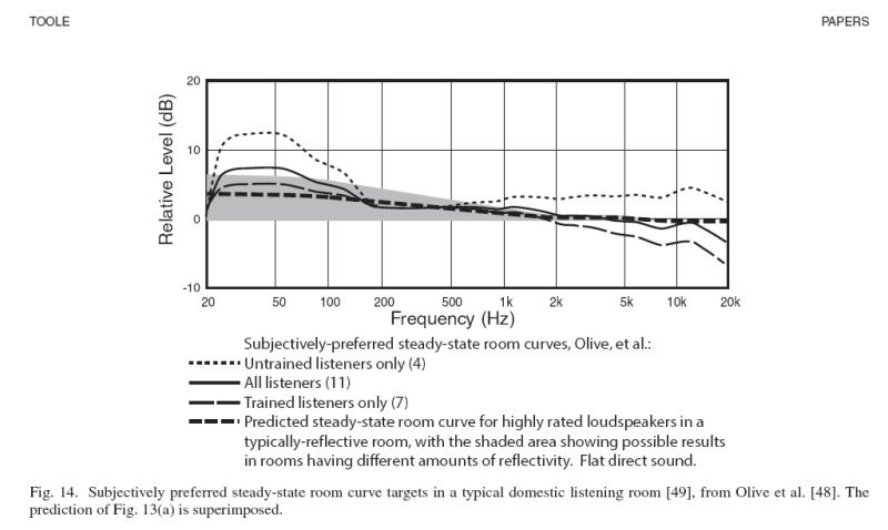

Just as a bit of information, in-room curves and their preferences as presented by Toole:
My personal preference was very close to the preferred curve of "Trained listeners only". So much that it has become my

Can you post a shot of the measurement and the filter created along with the settings that caused it? DRC should not be trying to correct something to the point of causing clipping.
I don't know if it is "clipping", but it is doing something the bass panel doesn't like. You can hear it in the 4M sweeps.
I am still in the stage of wrapping my head around the drc.exe toolset. I measure @ 176.4kHz because I can not get the mic-preamp to slave clock sync lock to the DAC at 192kHz, so I measure and create my filters @ 176.4kHz and then convert them to 192kHz for normal playback. I updated the rate-changer driver (Alsa_cdsp) code so I can quickly change between sample-rate and house-curve filter sets to swtich between recording and playback rates.
It looks like Drc.exe scripts are only setup for up to 96kHz, so my scripts resample back and forth between 176.4 and 96. With enough time, I will probably try to mod the Drc.exe 88.2kHz scripts into 176.4 so I will no longer need the intermediate pre-processing scripts, just the post-processing to derive 192kHz filters. After looking at the existing deltas between the *.drc rate files, most of the parameters are just doubled with frequency doubling (44.1 to 88.2 and 48 to 96).
That being said, I need to consider how Drc.exe will handle the extra frequency extension beyond 20Hz to 30kHz (and below 20Hz). The ribbons are supposed to produce up to 45kHz, not that I can actually hear anywhere near that (or my mic calibration file is up to the task, but the math should be able to function accordingly).
Here are the left=153Hz and right=215 THD distortion peaks caused by the applied STRONG filter. There was 5 and they were higher before I re-positioned the speakers and adjusted the XOs.
Here is the left original (green), corrected (purple) and filter (red default values in strong96000.drc). The target is a flat line and MaxGain wasn't changed from default (2.0 or 6dB).
I intentionally left the gains higher on the sub and bass where most of the "cuts" corrections would be needed assuming less correction as frequency increases. I wanted the algorithm to favor cuts over gains.
The curious thing is it is causing a THD spike at 153Hz and not the other deep narrow nulls. The right=215Hz deep narrow dip looks similar to the left.
The linear phase RePhase XO's are at the bottom (blue, purple, teal, gold).
I am already using some "tricks" to address room modes by overlapping the sub and bass panel centered @ 50Hz. RePhase has a linear phase XO with a 1 octave overlap that I am experimenting with. I am trying to emulate a 4-sub swarm between the bass and subs by averaging 4 room node locations across the "psuedo-swarm". It seems to do a good job so far considering I also get dipole cancellations from the front wall reflections.
The sub XO has OB/dipole rolloff compensation built in.
The NEO8 line array XO has a peak/dip correction built in.
The Ribbon line array XO has a "minimum-phase-1st-XO-erasure" filter built it to remove the phase change introduced by the Ribbon's protection capacitor. None of the other drivers have caps inline so this filter restores the ribbon's phase for easier integration.
Right now I am focusing on flat curves until I get a grasp on the tool set.Where you have a problem is still relatively high in frequency, yet you might get away with a few additional tweaks.
standard go-to curve for a quick first target and I adjust a few little things from there on.

Interesting. I just created a 176.4kHz strong.drc file from the 88.2kHz file and gave it a go.
The resulting filter does 1-2dB less correction on the 3 strongest peaks so there maybe some resolution issues going on using SoX to resample from 176.4kHz down to 96kHz and back again.
While doing this from scripts I see that the software could be upgraded to create multiple channels in parallel if the intermediate files have unique names (i.e. add a unique prefix or suffix the the intermediate names).
That is not a correction I would want, too much dip filling and your results demonstrate why it is not a good idea, 50 to 80% distortion.
I would measure and make filters at one specific sample rate and then resample the filters to the other rates later. The less resampling there is the better.
Cut vs boost is pretty irrelevant in a floating point DSP process as it is only the gain at the end that matters. As the correction is an inversion cut and boost doesn't seem the right way to look at it to me.

From the Strong DRC template I get: (544 ms at 20 Hz, 108 ms at 100 Hz, 10.8 ms at 1 kHz, 0.54 ms at 20 kHz)
Let's see, 20 Hz takes 50 ms, so 544 ms is more than 10 (almost 11) cycles at 20 Hz. With a window of this length you're pretty sure to bring in a lot of the "room" into your correction. Even though the RC in DRC stands for Room Correction, you'd be better off using it as sort of a speaker correction at mid and higher frequencies.
The plus side is you're correcting line arrays, but it would still react with the room, making the correction very (measurement) point specific.
What is your goal here? Is it to have the best looking graph or the best sounding filter 🙂. No doubt the "strong" filter would present the best looking graphs. But I highly doubt it's ability to produce a nice sounding filter, as you're introducing way to much (single measurement) point specific info into your window of correction.
Even though a line array averages out a lot of reflections from perpendicular planes, it will still have placement specific reflections from more parallel surfaces. Unless you're able to avoid all of those, but then a short window correction would have a huge likeness to a longer window anyway.
I'd advise to keep the window way shorter, like below 5 cycles. That way you still correct the room where it counts (at bass frequencies, where wave lengths are long) but leave out the (measurement) point specific room info in mid and high frequencies.
Take this as friendly advise, not gospel. 😉
In the end, you decide what's best for you.
My goal here is to initially understand the tool, it's limits and how to effectively wield it. I just took the DRCDesigner training wheels off, got rid of the THD spikes, tweaked the scripts to work at 176.4/64-bit (native measuring and CamillaDSP processing values) and am now trying to understand what the individual knobs do. In the end, I would like to have an intelligent library of clean house curves/filters to compare and choose from.
You just pointed out the comment in the strong*.drc file "(544 ms at 20 Hz, 108 ms at 100 Hz, 10.8 ms at 1 kHz, 0.54 ms at 20 kHz)" relating it to FDWing and made it click. I think I know how to control different FDW's at different frequency ranges with this tool. I noticed those values when making the 176400.drc file and their application relevance didn't sink in until now. I know Audiolense allows 2 (and an optional 3rd) zone of windowing (below and above Schrödinger's cat =), but don't know how many cycles each of those zones should ideally be other than more at lower frequencies and much less after the specific room's transition point. With REW, I would use a FDW of 6 cycles (right or wrong) for LF correction.
Good to know. The sound is a step in the right direction, but its an iterative learning cycle. What I learn from experimentation, I then try to physically incorporate back into the room to eliminate the cause and then back out the electronic correction. I doubt I can do much physically about the room's asymmetry issues other than get a symmetric room or rely on DRC.
The bass array is 67", mid array is 72", and the tweeter array is 60" with a 96" ceiling height, so it is pretty close to a real line array. I notice from the measurements that there is an arrival time delta between the middle and top/bottom of the array reaching the mic. I also notice that drc.exe is trying to correct those latent arrival times. Most of the room has been treated except for the ceiling and I still have an issue with the sidewalls to correct. The front wall has corner bass taps, broadband absorbers with diffusion panels and RPG diffractal diffuser clones. The asymmetric back of the room brings in most of my issues.
Thanks. I think I now know how to cascade down the window sizes in drc.exe as per your opening comment. Do you have a rule-of-thumb recommendations for the other 2 window sizes in cycles ?

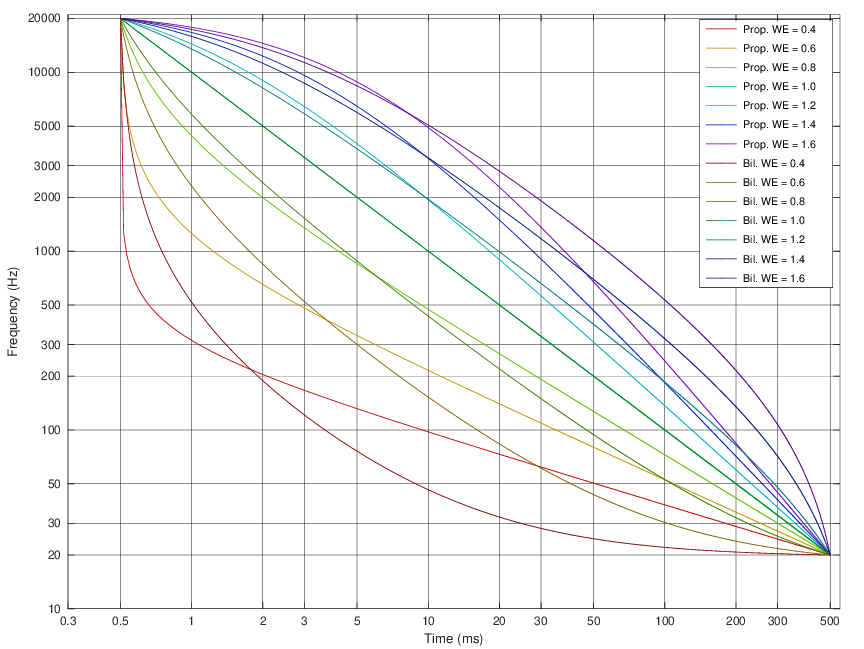

DRC-FIR is smartly written with a lot of freedom for the end user. The windowing can be tailored to your own needs or liking. There are a couple of worthy variables to take note of. There is a window for frequency correction and a separate window for phase correction. Further you can use a WindowExponent in both of those windows to further shape the windowing.
The function or result of using the Window Exponent is shown in the DRC documentation:
One of the many images showing possible windowing curves. I use this feature to get a long enough window at bass frequencies,
a pretty short window at mid frequencies and a bit longer again on the top end. I've played with the windowing length in DRC-Designer
extensively, and listened to overdone lengthy windows up to very short windows and everything in between. From that I got a feel for
what worked for me. For instance, I use a Window Exponent of 0.93 to shape the length of my windowing to achieve the lengths I
thought worked best for me. As short as I dared to go while still reaching my goals. I am using about ~4 cycles at mid frequencies.
