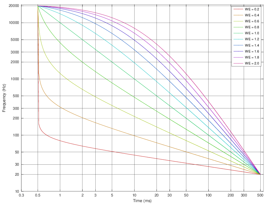

In case it isn't clear the value used in the drc file is the number of samples the window will be but it is also on both sides of the impulse centre so the value is double what the corresponding window length will be. So 24000 / 1/44100 =0.544 S. For the 48000 value used in the strong file.You just pointed out the comment in the strong*.drc file "(544 ms at 20 Hz, 108 ms at 100 Hz, 10.8 ms at 1 kHz, 0.54 ms at 20 kHz)" relating it to FDWing and made it click. I think I know how to control different FDW's at different frequency ranges with this tool. I noticed those values when making the 176400.drc file and their application relevance didn't sink in until now.
When the sample rate changes the values need to be scaled up or down to keep the relative window lengths the same.
I am using 26460 at 44100 which works out to be 0.3 S at 20Hz.
Thanks gents. So it is:
I have been playing with the test convolutions and am noticing the trends generated by varying the XXWindowExponent.
Code:

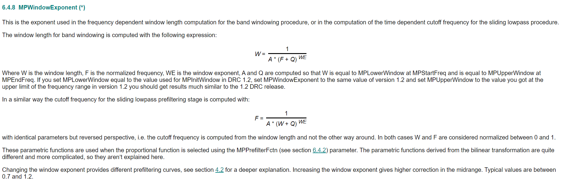

(XXLowerWindow/2) * (1/BCSampleRate) = xx.xx seconds @ XXStartFreq
(XXUpperWindow/2) * (1/BCSampleRate) = xx.xx seconds @ XXEndFreq
with XXWindowExponent defining the integral curve between the 2
The attached snip from the manual explains it
All of the window lengths are printed to the screen as the program runs. You can have these remain on screen by putting a pause command into the script or you can redirect the whole lot to a text file. Much easier than running a lot of calculations.
Basically exponents under 1.0 push the mid band down in window time and those over 1.0 push it up but a 0.1 change in exponent is quite a lot.
An example of my window at 44100:
Slightly different from a standard template as I let it run up to 22500 Hz in the top end.

Cool, I may try to tweak the output to additionally display ms and cycles. Using the normalized cycles unit would be more intuitive (at least to me) across different sampling rates.An example of my window at 44100:
Here is mine using the same normalized values, but not immediately obvious without displaying cycles.

My sweep is from [10-24k]Hz @ 176.4kHz using 1/6th octave bands versus the default 1/3rd octave bands.
Added the ms and cycles to the log output. The print changes were pretty simple.
I was surprised to see the cycles decrease and then increase.
Have to investigate what settings is causing this.

Well, that would be the desired effect of something like MPWindowExponent being smaller than one. 🙂

See the green line with the WindowExponent being 1, if the top and bottom settings have an equal number of cycles, they will hold that
number of cycles throughout every frequency. Just set MPLowerWindow and MPUpperWindow to achieve the desired number of cycles.
If you'd take that as the base settings, and add a MPWindowExponent argument and make it less than 1, it would taper at mid frequencies.
Just like the graphs predicted. Should you want something different (I really don't with a template for an array) you would need
to set the MPUpperWindow to the desired number you want for the cycles of correction you want to end at. Then you can make
it taper down to that value like you mentioned (with the right WindowExponent).

Just a note, if you set MPPrefilterType to "S", a sliding window is used and you're not really using 1/3th or 1/6th octave bands but a stepless way of going through the octaves.My sweep is from [10-24k]Hz @ 176.4kHz using 1/6th octave bands versus the default 1/3rd octave bands.
See:
6.4.11 MPBandSplit
Fractional octave splitting of band windowing. Band windowing is performed in 1 / MPBandSplit of octave bands. Usual values are between 2 and 6. The higher this value the higher should be MPFilterLen. Values greater than 6 usually give no improvements.
For the sliding lowpass prefiltering this just gives the rate at which log messages are reported during the prefiltering procedure and has no effect on the prefiltering procedure itself, which is always stepless.

Just to add something to the above, the parameters are interactive and in your example you have increased the frequency extension at either end which is causing the parameters to react differently.I was surprised to see the cycles decrease and then increase.
By using 10Hz at the bottom an octave higher at 20Hz the window has dropped to 128ms. If you set the window to 20Hz and used the same sample value you would get 300ms at 20Hz. You will likely need quite different sample and exponent values to get something similar to the values wesayso showed.
