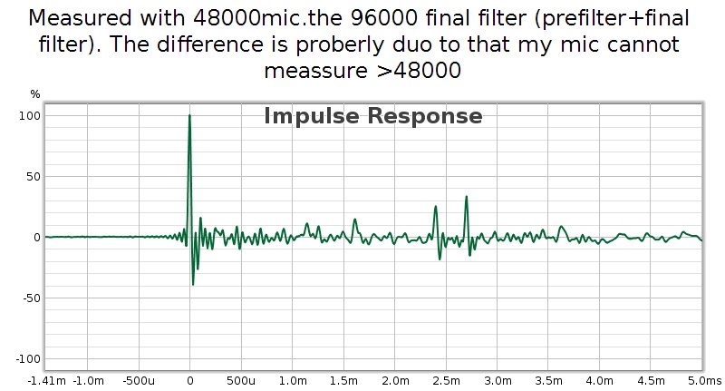

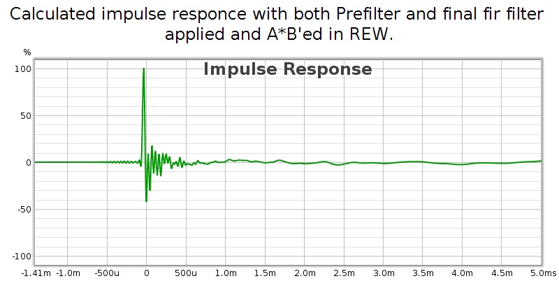

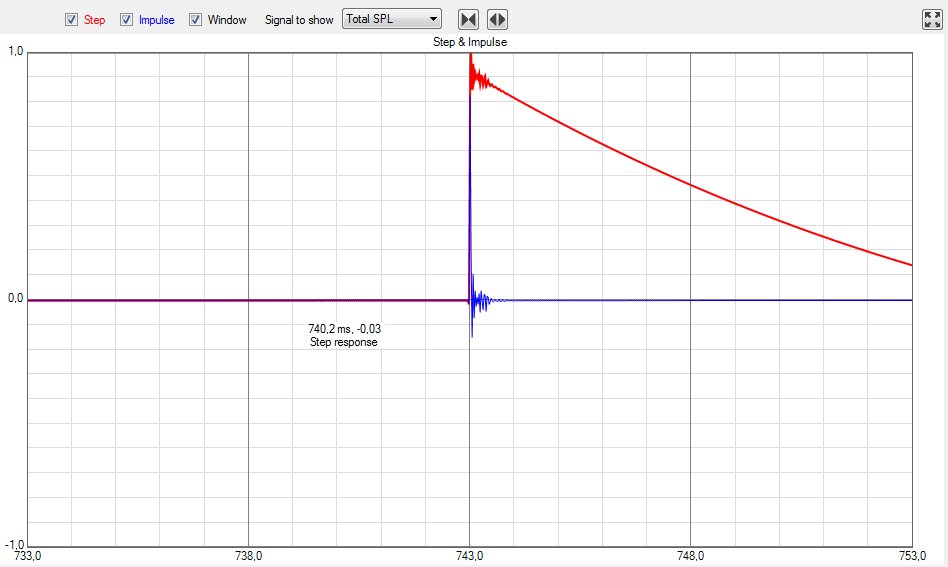

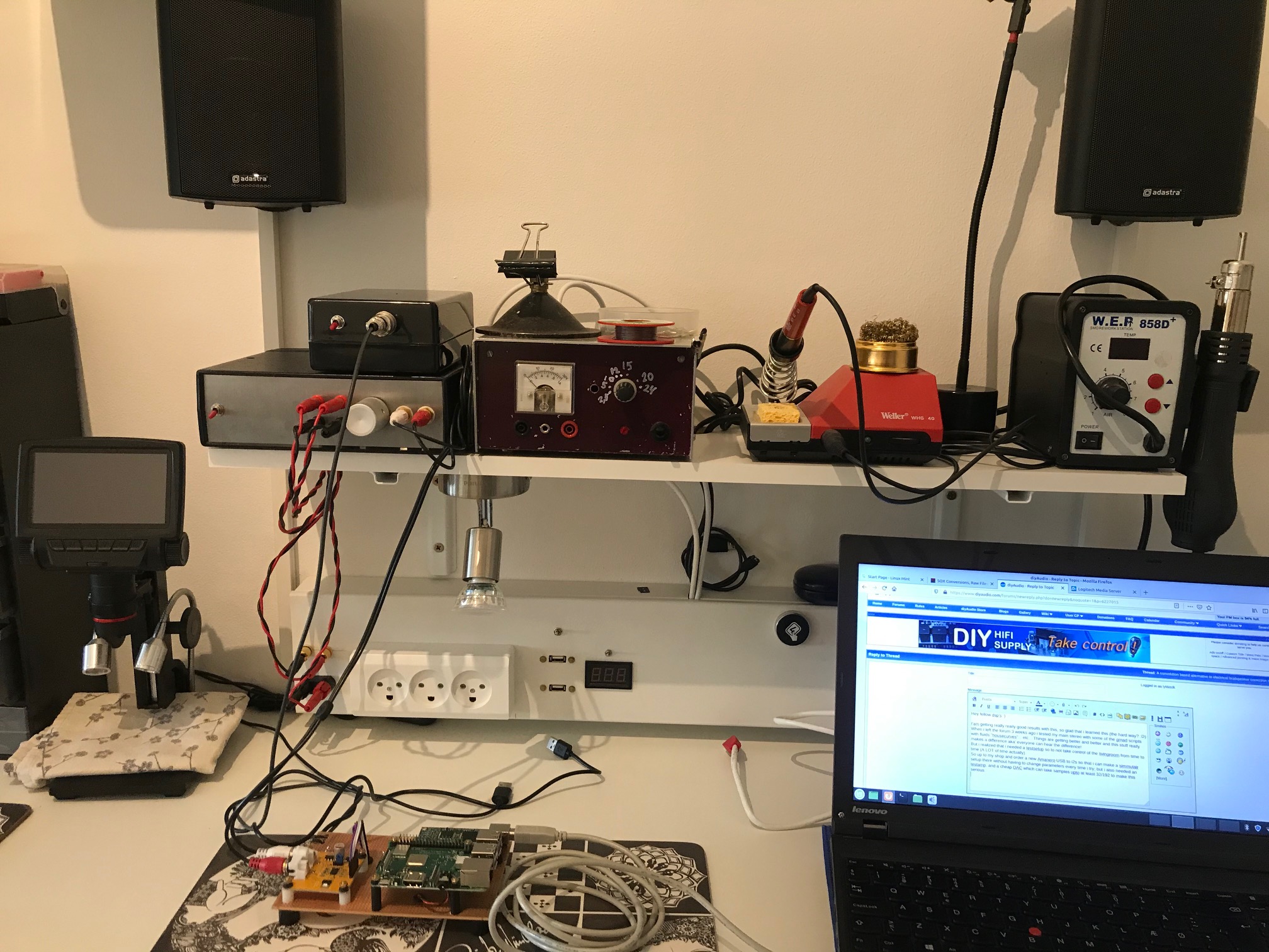

Hey fellow dsp's 🙂
I'am getting really really good results with this, so glad that i learned this (the hard way? 😀)
When i left the forum 3 weeks ago i tested my main stereo with some of the gmad scripts with fluids "housecurves"... etc... in 44100. Things are getting better and better and this stuff really makes a difference aka' everyone can hear the difference!

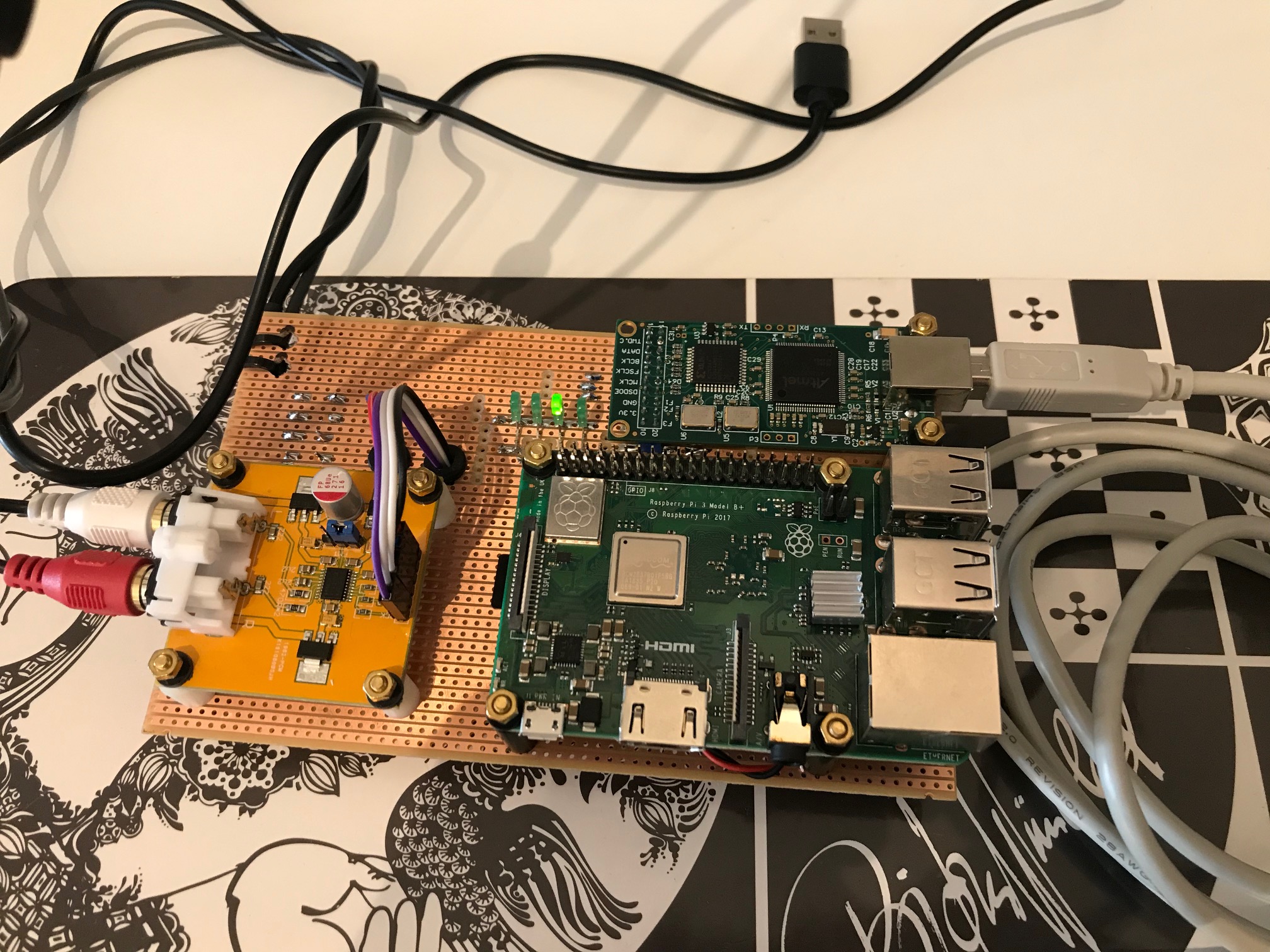

But i realized that i needed a testsetup so to not take control of the livingroom from time to time (A LOT of time actually).
So up to my shop and order a new Amanero USB to i2s so that i can make a simmulair setup there without having to change parameters every time i try; but i also needed an testamp. and a cheap DAC which can take samples upto at least 32/192 to make this serious. I ended up with an LM4780 poweramp, which i had a pcb for, some boxes and a potentiometer to get it all going. (See the two pictures)
I was really challenged because there was a fault on my new Amanero board, but thoose guy's in Italy are really great, telling me that i will still remain warrenty even if i tried to repair the board myself. So lucky me it was a bad solder underneth one of the oscillators.
Reflowed and fixed, everything is working 🙂
So i started to dig deep into the sample rate conversion and figured out howto do it the right way.
I measure everything in both 44100 and 48000 now, because SRconversion is better off with "paired" samplerates aka'
Family 1 is 44100, 88200, 176400
Family 2 is 48000, 96000, 192000
I will not clutter this thread with all my notes now, but just tell that i am capable of doing it now as i wanted from the start. I have created some tests comparing the simulated impulses vs. the measured impulses and they look right to me.
I created the filters i use now except for the 44100's in DRC Designer, next thing i will try to make work is to rewrite the Gmad's script to accept other than 44100 🙂
Just a quick follow up guy's... Thanks 1000X again for helping me all the way to here.

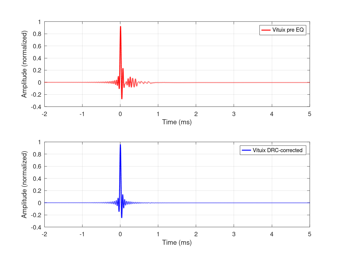

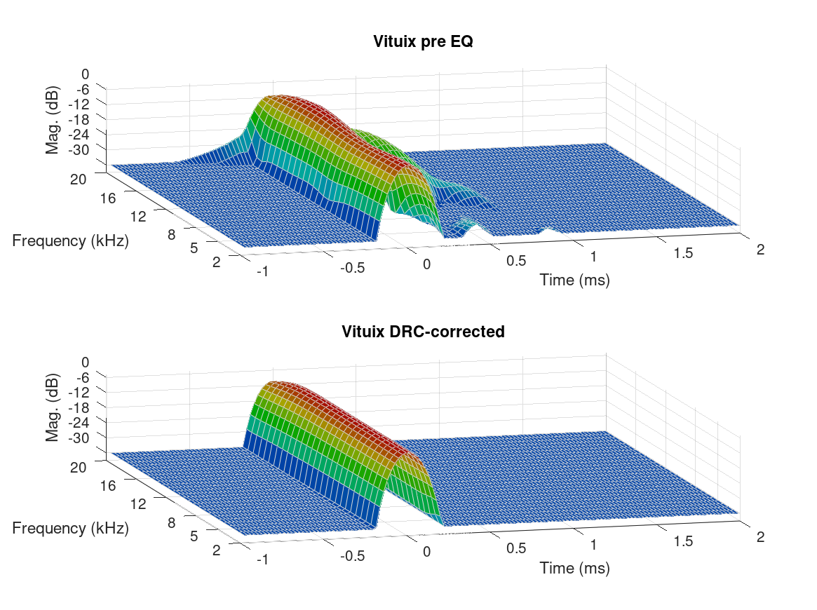

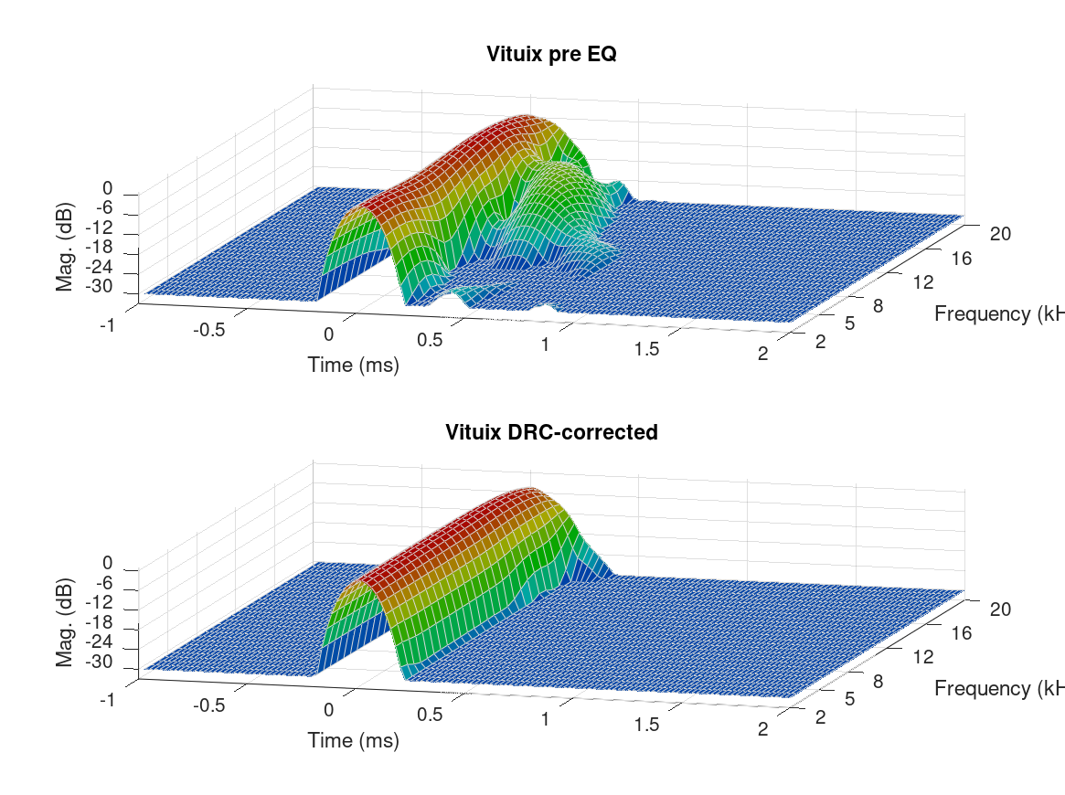

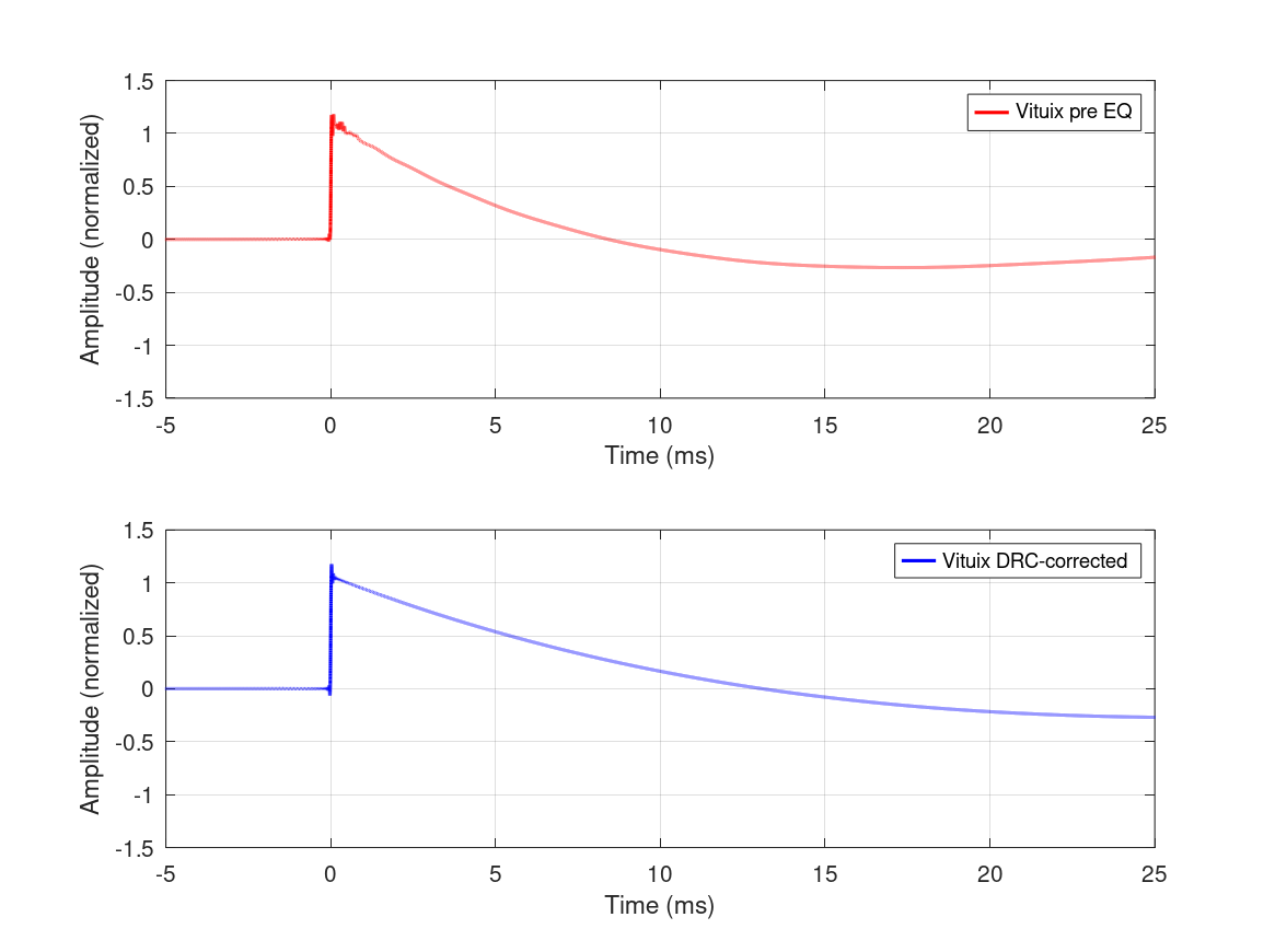

Out of curiosity I ran the script comparing the sim data I used in Vituixcad to get a comparison between my pré-EQ stage and after running DRC-FIR.
attachment.php
attachment.php
For this to work I did have to jump trough various edits, probably because of short files used etc, as they are not representing measured data but are limited length files I used to sim my arrays.
But my newly created template for these sims seems to work quite well.
attachment.php
attachment.php
Thanks for the inspiration @emailtim 🙂
(this is a pure minimum phase correction, on a simmed line array, which is why it looks this clean)

I'm only correcting half of it (s instead of S within DRC), it most probably was present in the input (at a very high frequency). Although I wouldn't know why its there.
Using either a lowercase b or s for the MPPrefilterType parameters enable the single side version of the prefiltering procedures

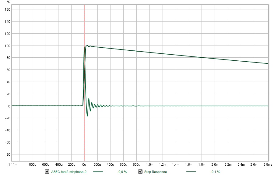

Or... the procedure of generating these graphs isn't minimum phase, as the same IR in Vituixcad looks like this:
attachment.php
and in REW it looks like this:
attachment.php
Each program renders it in its own way. But there's a lot of manipulating before plotting graphs, so I bet that's the reason.
Plus the waterfall only shows results down to -30 dB.
REW shows me, with some IR filtering, there's still some energy before the peak at < -65 dB, except for a
really narrow peak (artifact) at 22kHz which is -20 dB down
It's odd because it looks like a linear phase DAC anti alias filter which is no problem to be concerned with but in the waterfall it flips from pre to post ringing and in the impulse view it stays in both.
REW has the expected result which makes the other graphs suspect.
As said, the rendering of an IR often is different between different programs.
There's definitely some energy before the peak though (at about 22 KHz), it was there in the sim from Vituixcad before running DRC-FIR and I did not intend to remove it, just correct the frequency/phase of the simulation as cleanly as I could get it.
I do think that Octave plot is off.
There's no DAC involved, as it is all sims. ABEC plots used in an array sim, minimum phase EQ done in REW and run trough DRC-FIR. The DRC-FIR template is from 20 Hz up to 22050 Hz, not the usual 20-20000.

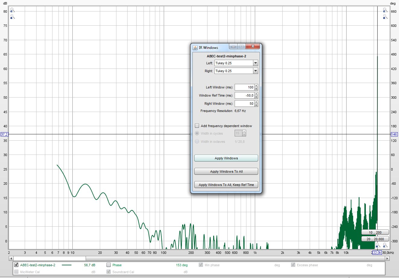

Some clever filtering in REW gets you this:
attachment.php
On a true Dirac pulse you get nothing with the same filtering... a neat method to see the pré-pulse energy.
