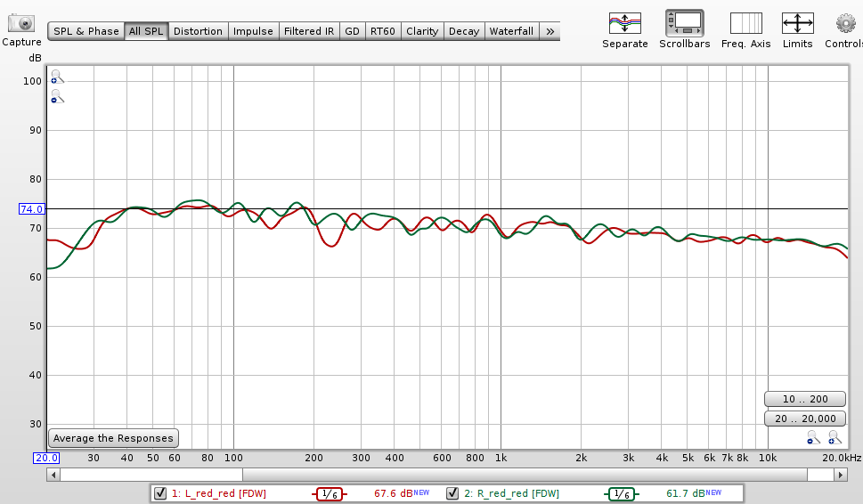

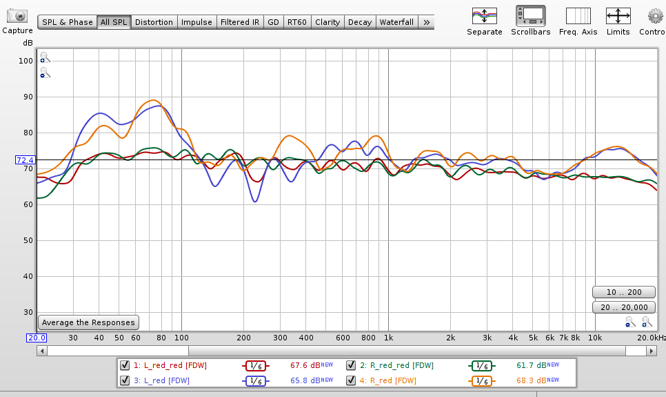

When i load the L_red_red file + the R_red_red one i measured after the prefilter my SPL looks "pretty" good (See attached picture After prefilter.png)...
I also attached a picture (Aftervsbefore.png) which shows the measurement both before and after i applied the prefilter.
I was thinking it was looking good, but i can ofcause be wrong.

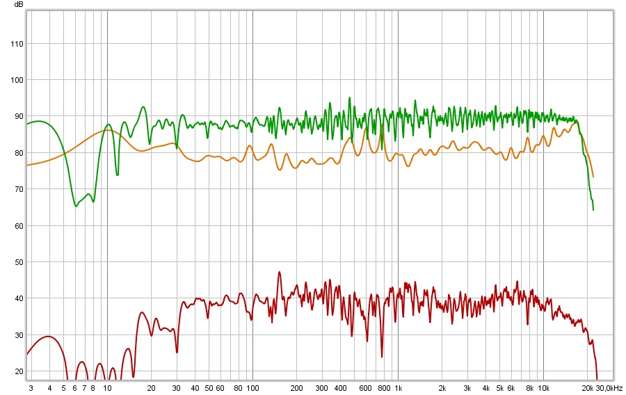

Well, the other template did the correction without any trouble. It is setup not to correct phase, just frequency while the first template I tried does both.
Green: correction prediction, Orange: Correction FIR file, Red: Original input (quite low in SPL)
So the only thing going wrong in the above graph is that it used my mic correction, but it all worked for the rest of the process.

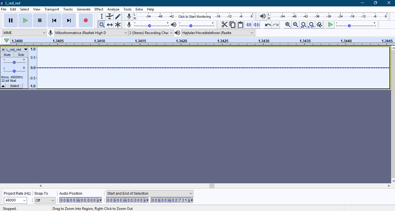

OK, read through all the pages of this thread and am now making some serious progress using Greg's batch files. Won't bore you with all the details, but experiment #1 using the Normal filter produced a seriously improved impulse response - see below (original and with filter). Haven't listened to it much, was too excited to post my impulse response improvement. Seems most of this thread is people talking about tweaking various parameters for best sound, and I guess now that I have the tool working I will be entering that phase of my life. 🙂 Thanks for the help!
I think that when i export my IR's to .wav from REW there is something wrong?
The files i link to is the same as the .mdat rew native ones wesayso downloaded before 🙂
Just exported to .wav ofcause...
I see nothing when i import them into Audacity?
Jesper.

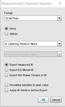

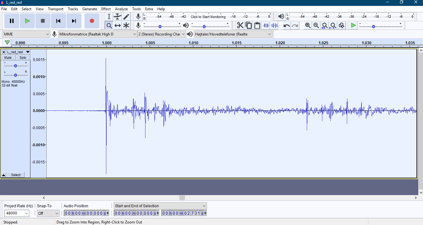

DRC needs the measurement to be in raw 32 bit float format with a .pcm extension
In REW I export impulse as wav and choose 32 bit float, then I import the file into Audacity and export it as a raw file 32 bit float then change the extension from .raw to .pcm
Is that what you are doing or are you using signed pcm directly?
If the output is not normalised on the measurement you will have to zoom in a long way in Audacity to see anything at all but it will be there.
Hey ... 🙂
I think i do it right, in REW i export as 32 bit float.
The ones i link to is exported this way.
Yes, i am trying, but when i open them i Audacity i still see nothing?
I tried zooming and etc... even on two different pc's 😱
My next step is to use the Gmad's script, but i really need to solve this first.

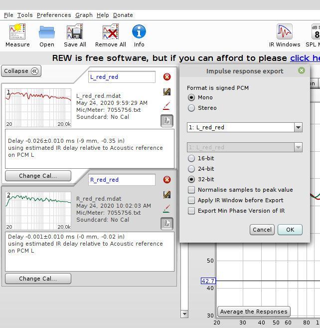

... When i export it say's PCM. - I assume it's correct?Is that what you are doing or are you using signed pcm directly?
LR_red_red_wav
from the REW HelpYes, i am trying, but when i open them i Audacity i still see nothing?

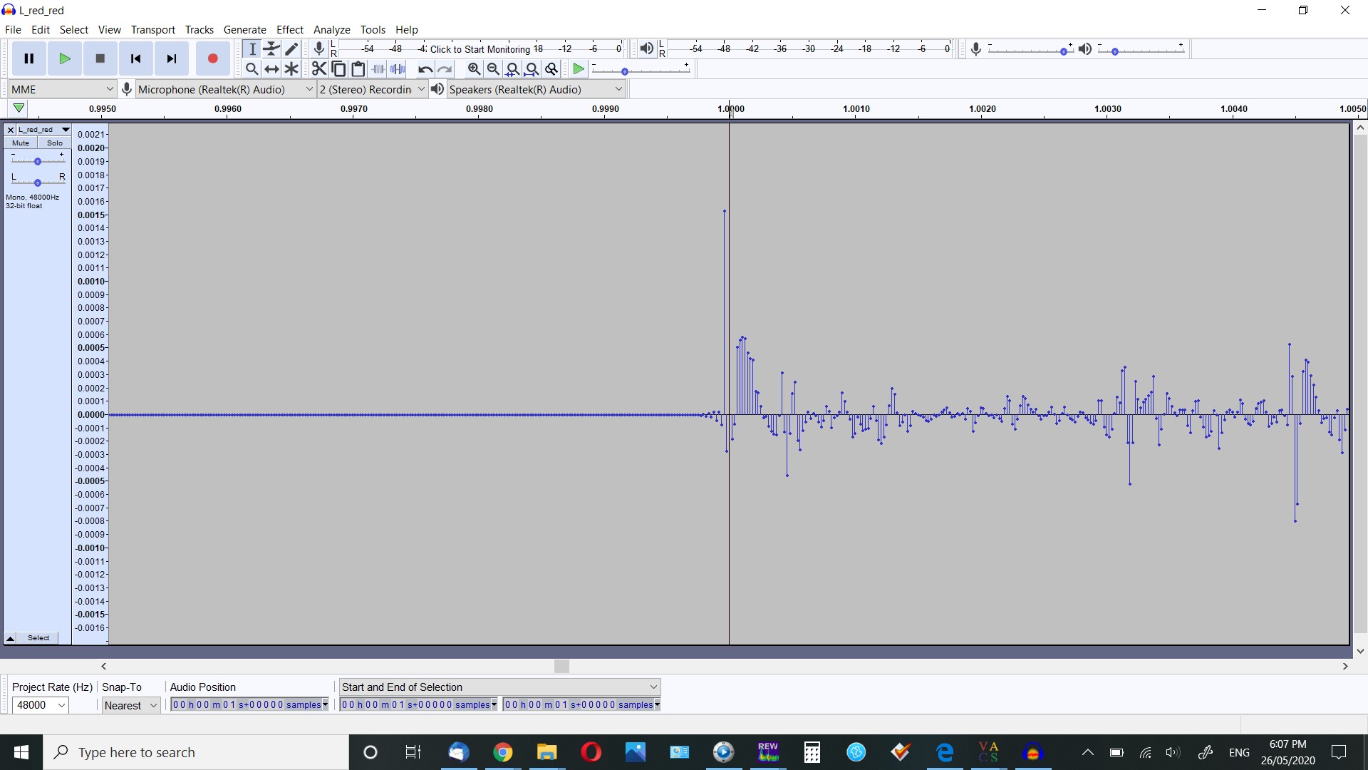

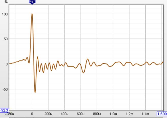

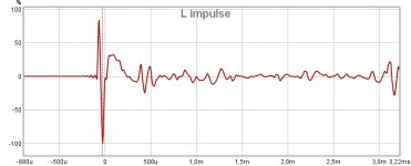

The peak of the exported response occurs 1 second after the start unless the IR window has been applied, in which case the export starts at the first windowed sample and the peak location depends on the IR window settings.
if you zoom into the 1s mark you will see your IR, you have to zoom in the y axis quite a way though as the peak is down at about -55dB
You are using an old version of REW that is why it looks different
The latest Beta's are really very stable and where all the new features are to be found
This is what it looks like for me
This is how far you have to zoom in Audacity to see it, see it is there 🙂

So FINALLY 🙂
Exported my own .wav into Audacity.
Took a little to figure out howto zoom into the y axis, but i figured it out.
So now that i can see that it's working i finally can move on to Gmad's scripts...
Thanks all for helping me out on this issue!

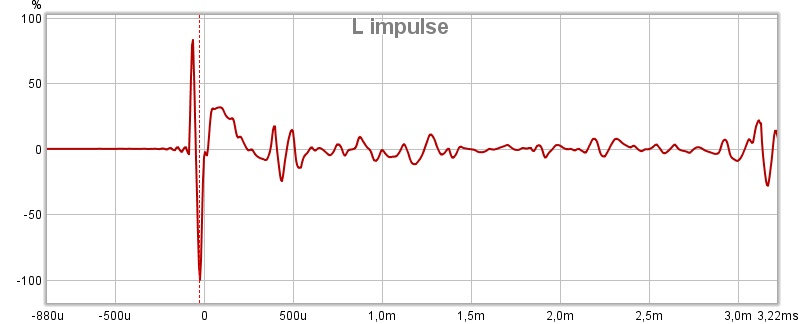

A few posts ago you wrote that my SPL was no in the middle. E.G my mic was not at the exact mittle when i measured, is this correct?
Do i have to have the dotted red line at "0" when measuring both at left and right?

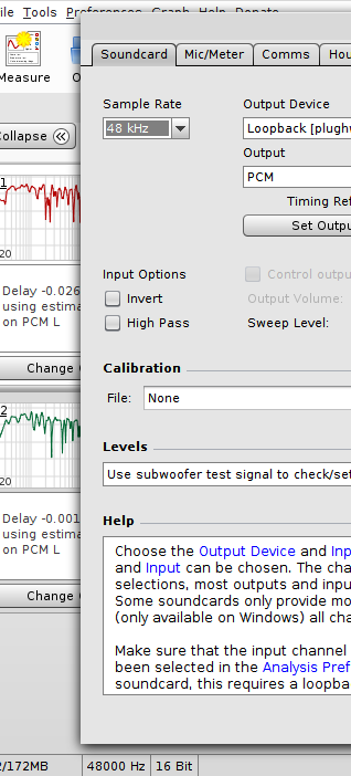

Some questions:
1 - DRC has provision for a mic cal file, but if I used the cal file in REW when capturing the response, I don't need any cal file in DRC, right?

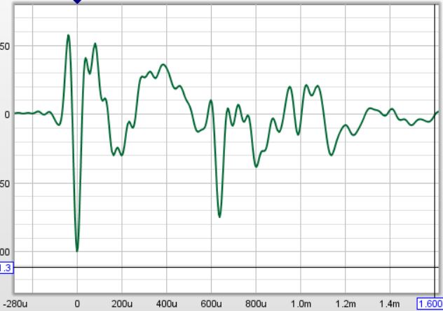

What wesayso was showing is that the first positive peak in your impulse is not the highest peak. DRC in Auto mode looks for the maximum sample value. He tried it both ways and it did not improve.
Measuring both speakers in the exact acoustic sweet spot between them is a good idea especially if you are going to listen to them there. It will make the two speakers more similar to each other when corrected.
That is about making sure that the Left and Right impulses overlay each other when measured together.
1. No you need to use the cal file in DRC and it will need to be formatted to work the way DRC wants it. No text at the beginning a single space between values.Some questions:

REW only applies the mic cal to the SPL response as viewed it does not affect the impulse response and will not be included when you export the Impulse.

1 - Yeah, I was afraid maybe REW was not correcting the export.
