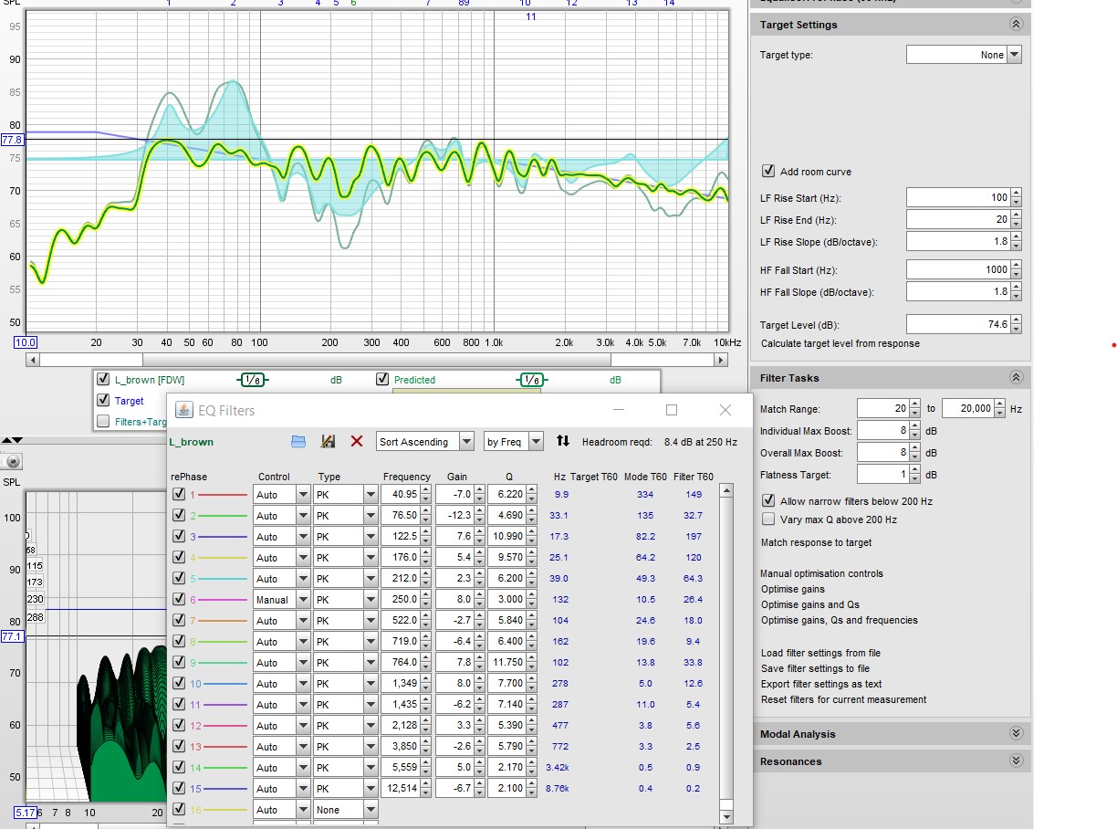

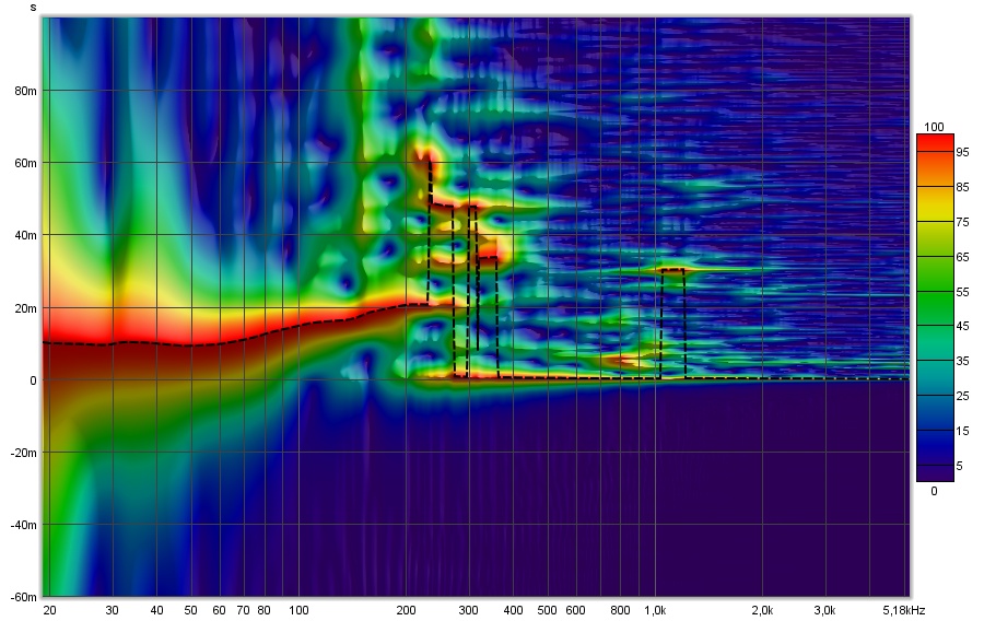

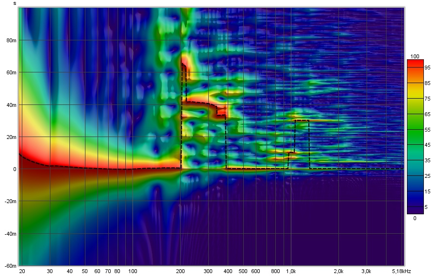

There are a lot of boundary related dips happening in the 200 to 300Hz region which is making this difficult and even if it looks good on the screen when you measure it again the dips may well be back as you can't fix a null by boosting it.Next goal is to make real good BiQuad's and i think i kindoff need some help with this.
My left's measurements have thoose "dips" which i still cannot correct like you could fluid? - Bellive me i tried 1000 times or more 😀 with all different settings and target's...
There must be something i do wrong or something i didn't enable or whatever, i donno?
Because that portion is below the target level REW doesn't want to deal with it the way you want all by itself. The way to help with that problem is to add a manual filter into the EQ after you get something reasonable with auto EQ. That manual EQ won't be overwritten when you re run the Auto EQ. Here is an example where I have used a fairly low Q boost at 250Hz to bring the level up and allowed Auto EQ to better match the target on your green measurement.

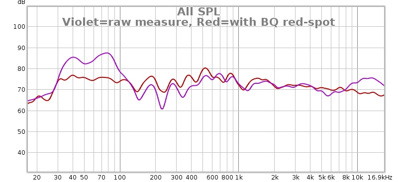

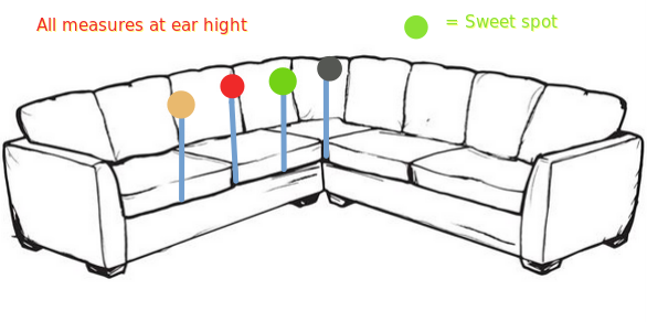

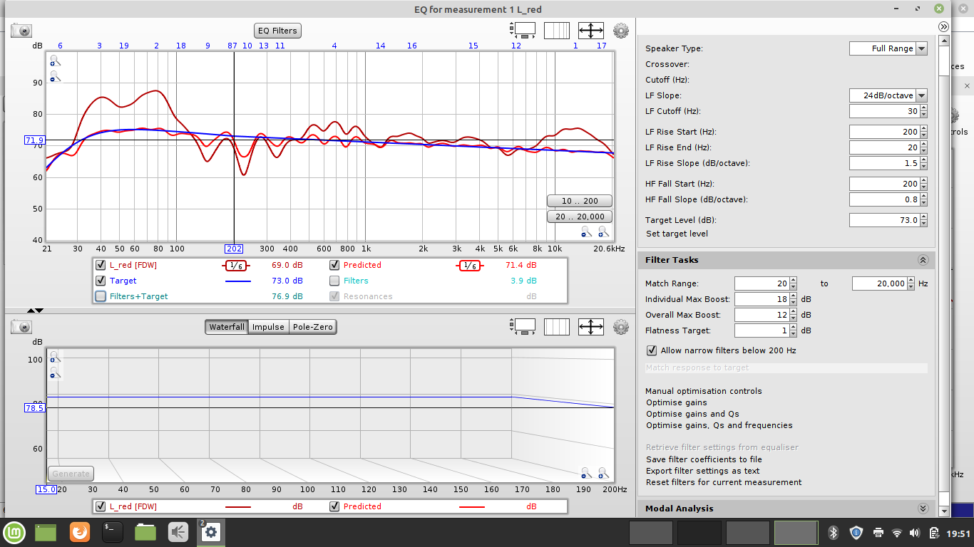

It's perfect... I raised the maxboost's factors, while looking at the EQ before and after that it only changed small amount of them, but i think that the auto EQ worked better when it was not told to behave 😛 !
I created BiQuad's in REW at 44100 at red and green spot's.
Then i loaded the red spot BiQuad without anything else into camilladsp and took new measurements at 44100.
The picture i attached shows that the BiQuads did a good job correcting into the "target", not that far from the predicted... Great... 🙂
The new measurements i took here i will export as impulse (no smoothing or window as you told me some post ago) and create DRC fir's with them.

You're well on your way! If using standard DRC filters I'd suggest using the soft filters.
You don't want to over-correct. You can try it though and compare, even better!

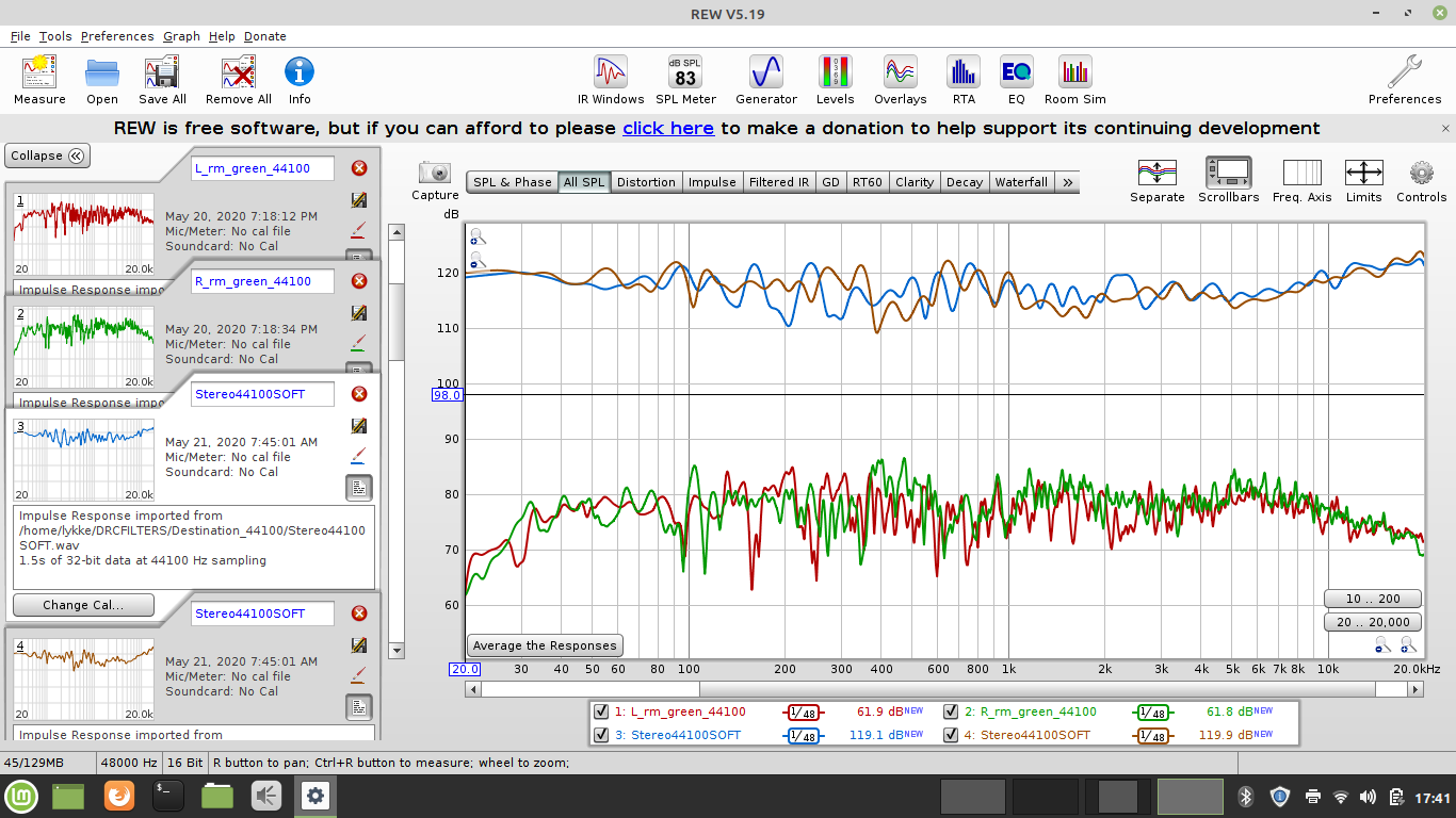

Hi...
I have my prefilter BiQuads running fine now on camilladsp, so this is good.
I took then measurements when they was in place and created the fir's with DRC with thoose measurements.
The attached picture shows the DRC created firs on top and the remeasure on the buttom, showing that the fir's are +40dB "higher"
I was then piping them after the BiQuad's but then i got real wild excessive clipping on the output.
Where did i go wrong? Why are the DRC created fir's so much "higher" in dB?

You didn't go wrong it is not unusual for the the filters to be computed at that level. It can depend on a few things including the level of your measurement.
Most convolvers have a normalization option where filter gain or reduction can be accounted for, perhaps camilla does not have this function.
A simple solution is to apply a gain reduction before or after the filter in camilla or open the filter wav in audacity to check the level and reduce it there or normalize it to whatever value you choose just be sure to use the same for both channels if they are well matched.

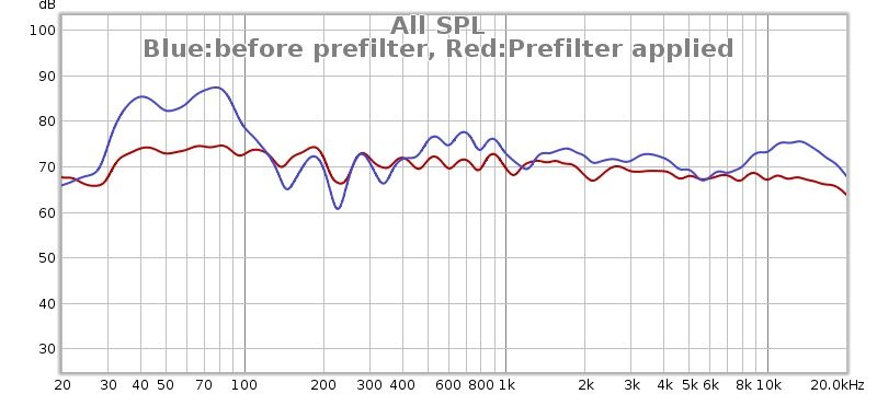

After some trials and errors regarding my Pre-filters, i got this partly working now. The DSP engine i am using (CamillaDSP) can handle more than on filter at it's pipeline without problems, excellent. So i created in REW my pre filters, with fluid's fullrange target and created .bin's with those EQ in rePhase and applied them into the Camilla Convolver. - I applied -6dB gain on the pipeline too.
The result is showed at the attached picture (the measurement is at my red spot, excatly in the middle of the speakers)
So next thing is to make some "real" filters, proberly now having an easier life correcting the allready Pre-corrected measurements.

I looked at your files and tried to correct it with a setup I currently use for my sims.
Even though the title of the zip file indicates it is 48000 sample rate, my REW version imported it as if it were 44100 native.
I ran the left one through my usual correction and got a correction with lots of internal hick-ups.
Next I changed my preference in REW to 48000 and opened the file again. After converting it to 44100 (outside of REW) and running the same correction again, the results were better, but not quite solid. There's still some evidence of internal errors in the correction (those small peaks).
All file formats I use have indicators of the sample rate so upon import REW knows what it is. Did you use DRCDesigner for the sweeps?
I'd say use REW for sweeps from now on and go from there. If you can, try to get the whole system to work on the same sample rate. Converting between sample rates is never a true solution and can lead to errors quickly.
DRC can work perfectly well at another sample rate, as long as the template is setup for that. The reason to suggest using REW for the sweeps is that you can examine them before feeding it to the next step. You can still use DRCDesigner, just name the files like DRC would and store them in the right directory/folder and it can still correct them.
Here's the two corrections I got:
The upper one is where I 'assumed' 44100 sample rate as REW could not tell it wasn't. The correction is all wrong because it won't correct at the right frequency positions with the crooked mismatch in sample rate. The bottom one is the one that was first converted to 44100.
See how the one where REW falsely assumed its sample rate was 44100 is all messed up? Little peaks everywhere. The one that was converted to the right sample rate looks a little better but still has some errors within the correction. Not the fault of DRC, the measurement file is to blame.

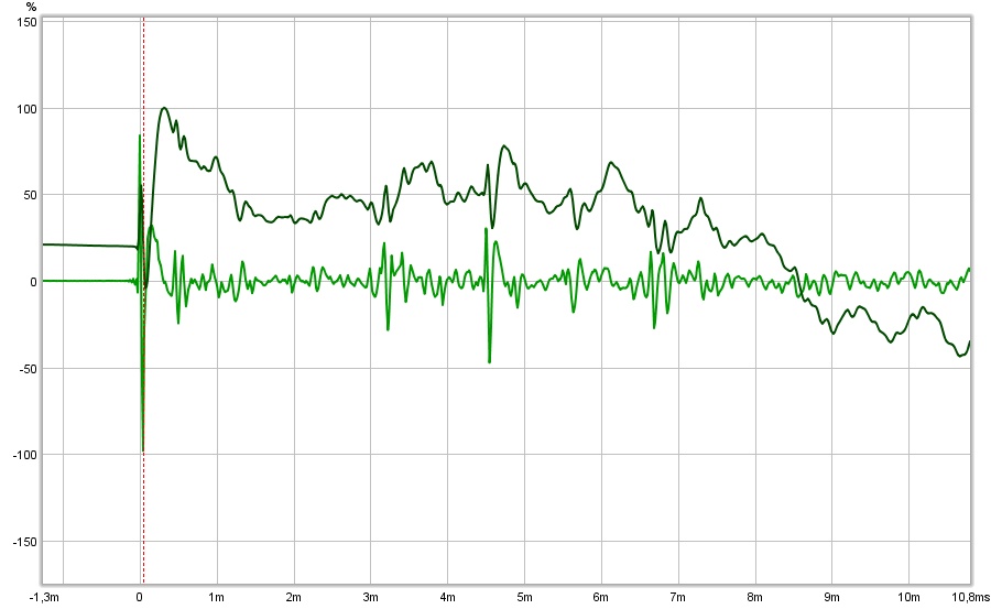

Judging your IR and seeing lots of early and strong reflections, you must not expect flawless graphs after correction. That doesn't mean it cannot sound good though. (the IR wasn't centered on the first peak either, however fixing that did not get me a cleaner correction).
Do you see there are strong peaks after the first impulse? That means there are closeby objects (near the speaker or near the measurement microphone) that reflect (lots of) energy.
A Wavelet proves that theory:
See how the strongest sound you get at the listening position at some frequencies isn't the direct sound, but the later reflections?
A prediction of the correction looks like this:
It looks a bit better at some spots, but we don't fix generally reflections with short windowed DRC corrections. We can't (or really shouldn't) correct those with DSP.
