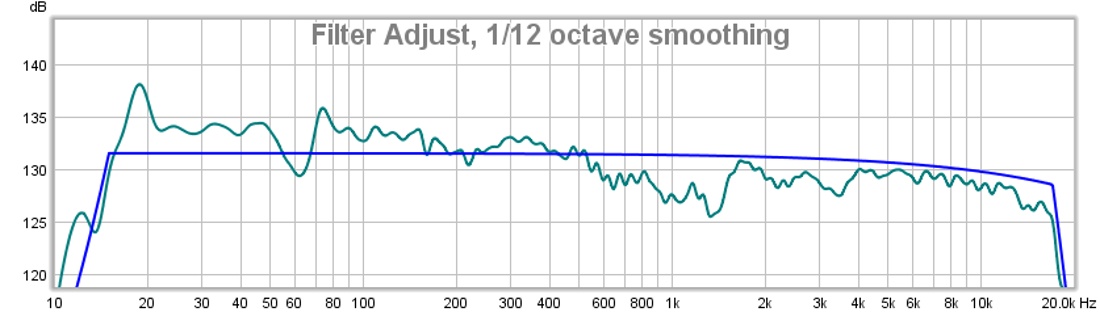

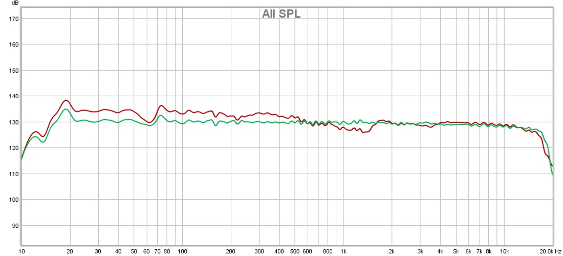

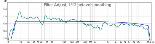

question for all. how can I make DRC adhere more tightly to the target???
attachment.php
