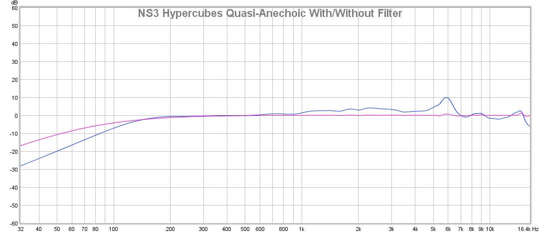

The thing I really like about this is the ability to correct towards a target (like REW’s auto EQ) but with any level of resolution desired (DRC applies the target response “blindly” and I end up having to subsequently tune the bottom end with REW).

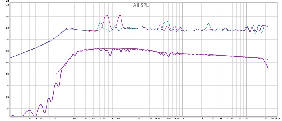

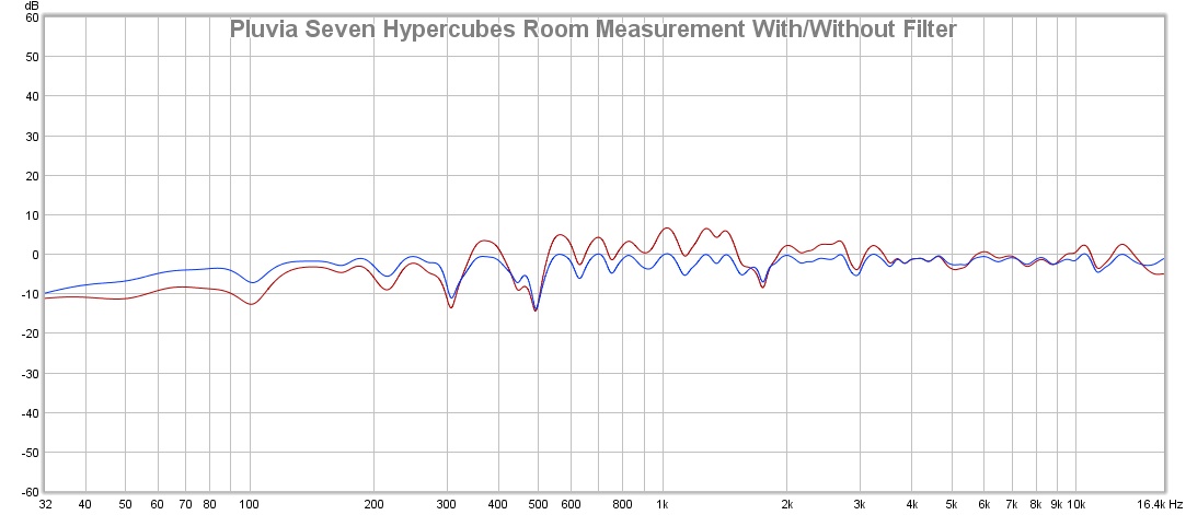

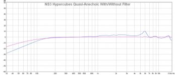

Here’s a tip for room correction: Try using psychoacoustic smoothing on top of a 1/24 octave FDW for the speaker cal file. This will prevent excessive dip correction and may result in a better magnitude response envelope (peaks of the FR forming a straight line). I’ve found this along with a 1 dB/oct. tilt above 1 kHz to work well.
The first graph shows the responses of a quasi-anechoic freefield measurement with and without a filter derived from a 1/12 oct smoothed cal file and IR of an 80 Hz HP filter with a Q of 0.5. The second graph shows the responses of a room measurement with and without a filter derived from a psychoacoustically smoothed 1/24 oct freq dependent windowed cal file and IR of a 40 Hz HP filter with a Q of 0.5.

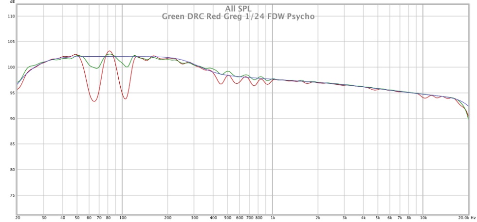

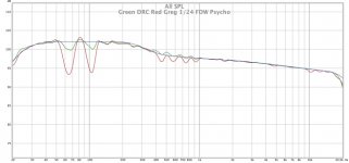

After a bit of head scratching and re-reading your post I tested out your method described above in a virtual convolution, and it does seem to work quite well in getting the response to conform to the target with some 1/6 oct smoothing applied afterwards the peaks do line up quite nicely with the target.
I haven't listened to it as it is pure minimum phase and I am preferring phase correction below 1K so I would need to generate that in another filter to be able to compare them just on the frequency balance alone.
This is the graph of my current preferred target (Blue) vs DRC correction (Green) and your method with 1/24 FDW and Psychacoustic smoothing, both smoothed 1/6 after convolution. The main difference is down to applying the psychoacoustic smoothing when generating the filter so that could easily be changed.

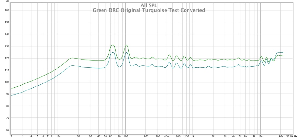

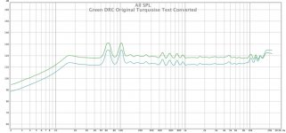

Your method got me thinking that this could be a way of transforming a text file into an impulse as REW won't do that.
I tried converting one of my convolver filters to text and running it back through to see if I could get MP impulse out of it but I get this strange lift in the very top end which is not consistent with the text values.
attachment.php
I tried bypassing the Mic compensation or setting it flat but it doesn't seem to be that. Using less or more resolution in the text file doesn't change anything. The only think different in the DRC messages is that it has run out of room in the Hilbert transform stage, do you think that could be causing it and do you have any idea what I could try to avoid that lift?

I thought I was using the most recent REW release, but I don't see an option for vector averaging (maybe I'm just missing it). Anyway, I used a very close mic placement for the nearfield portion of the NS3 measurement so the room really didn't come into play. I just couldn't get a perfect looking low freq response using the usual methods (maybe not even an audible difference in the end, but I was trying to avoid compounding errors).
Good point about left/right response matching and how that might play into the 2 channel average. My setup is symmetrical so it doesn't make a big difference either way. I'd be interested to know how it works for you.
Are you converting a non minimum phase impulse response to text format and back again? I haven't tried this but I think you would need to use PSFilterType = L (if you're not already). Also, just for best accuracy, try PSInterpolationType = H.

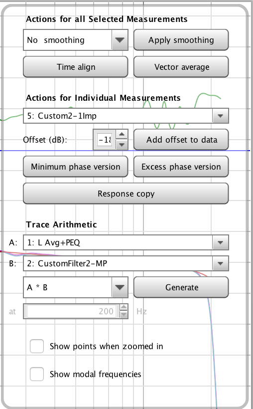

I am using Beta 6 but I think it was in Beta 5 as well, look in the All SPL controls here, (time align doesn't work well for me) the measurements selected at the bottom of the page (not shown) are the ones that will be averaged
The filter did have excess phase but I wasn't trying to preserve it. I tested with PSFilter type as linear and it preserved the excess phase but still had the tilt. Interpolation from R to H made no difference. I tried band limiting the Dirac Pulse which worked to stop the Hilbert transform from overflowing but didn't change the output. It was worth a try though and could probably be fixed with a post EQ shelf if I really need to use that method.

If you want to try correcting based on a single measurement, I'd recommend a filter that is min phase and not more than 4 cycles resolution. The (DRC) psycho configuration I posted takes things a little further by relaxing the dip correction, and offers a lot of possibilities in terms of initial windowing/filter resolution. You can always add phase correction later just to compensate for the low freq rolloff of the system.

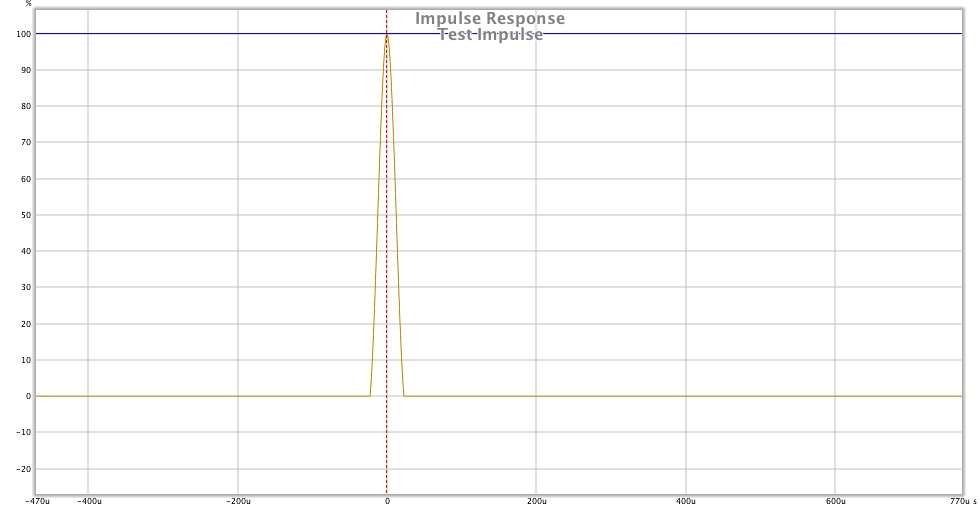

If you don't mind, try running DRC again with PSPointsFile = flat. The problem must be with either the impulse file or the text file...
Same thing happens, not sure why,
attachment.php
This is the impulse used as input, generated from Rephase

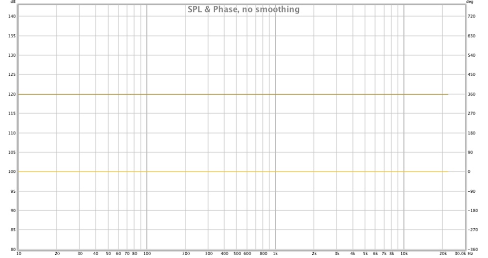

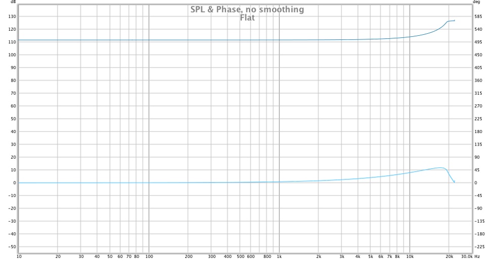

Ok, so we know it's not the text file. Impulse looks good in that shot but just verify that the FR is perfectly flat. Assuming it is, it must be the config file...very strange. In the mean time, use the custom config file to convert the text file to an IR since you're only using the target response stage anyway. If you want to send me the config file, I'll take a look when I can.
Regarding phase correction in the lower octaves, my experience doesn't match your description of the difference between the filter types; I'd want to look at those settings. I'm not sure what you mean by the filter doing phase correction but targeting a min phase response at the listening position...
FR looks straight to me 🙂

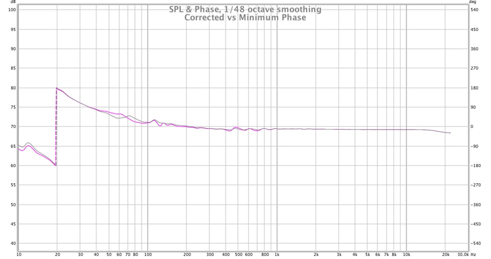

The phase correction is aiming to get as close to generated minimum phase as possible. This is what it looks like through an 8 cycle FDW. It's always difficult to compare the sounds of types of filters as there can be so many differences in other areas. I used REW to export a MP version of my correction IR with excess phase to compare and the template is quite different to yours so that could explain some of it.
attachment.php
I tried a few different things to try and get a flat response by using a Dirac pulse and flat target with no joy at all. I used your custom minimum phase template, bypassing the mic compensation, using flat.txt. I still get the lift which made me think it must be the impulse. I tried to manually set the impulse centre to 8192 which is where Audacity said it was as this was different to the value DRC gave in automatic mode. That just produced garbage. I tried moving the impulse to 1S exactly, same issue, if I set it back to automatic mode DRC reports 88200 as the impulse centre.
Could you test if you can get a flat response from a Dirac pulse and flat target? Not getting this working is starting to annoy me now 😡
Thanks for that Greg they work 🙂
As soon as I opened them to compare in Audacity I could see where I had gone wrong. My Dirac Pulse was a stereo file and when it was being converted to 32bit float both channels were combined. Doh.

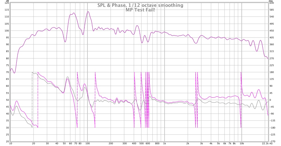

I think I may have found the reason why I noticed such a difference between the filters when I used REW to make a minimum phase version. This is the right channel with the filter applied, no wonder it sounded boomy and wild!
attachment.php

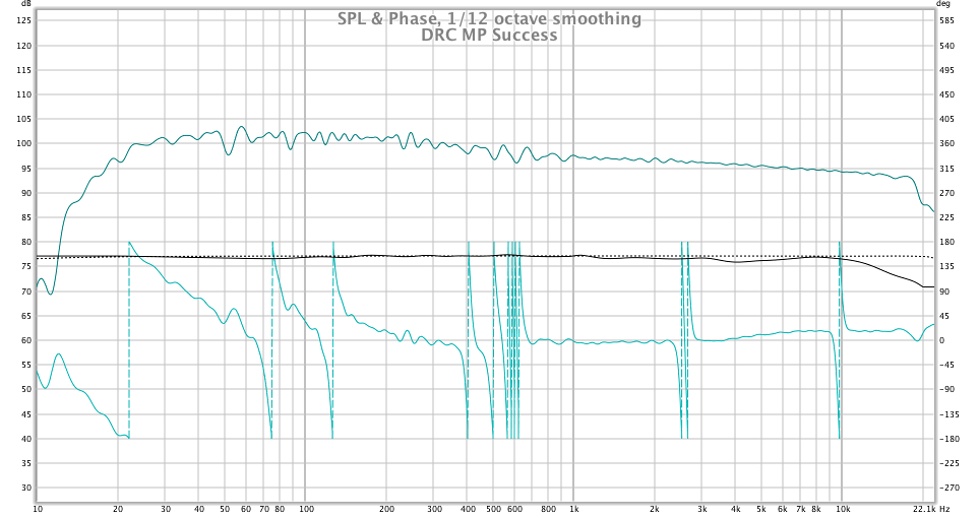

By using a minimum phase base measurement instead I get something much more reasonable, haven't tested it yet but just looking at the FR it should sound less wild.
attachment.php
Yes it does 🙂 So when I listen I will revise my thoughts as my previous impression was clearly due in part if not all to the FR issues.

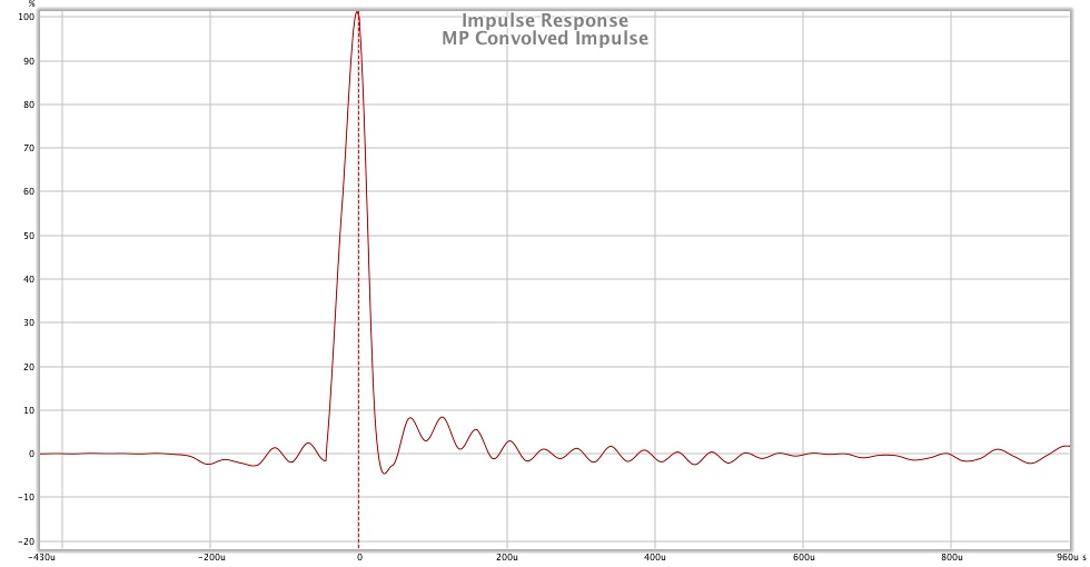

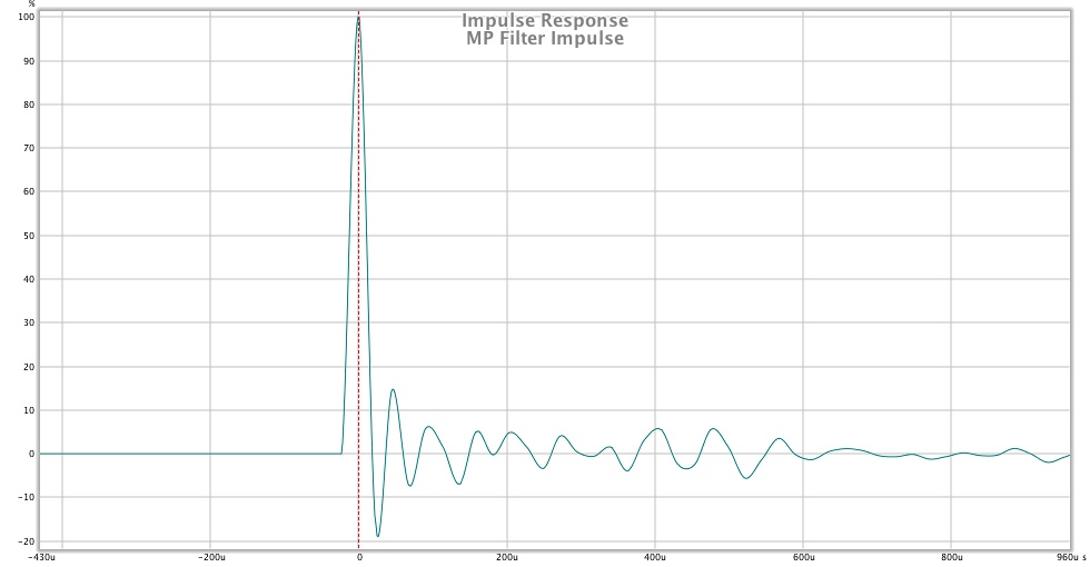

This is the minimum phase filters impulse response, no pre ringing.
attachment.php
This is the MP filter test convolution on Left Right Average. The pre ring there is due to the ADC and DAC filters and has not been corrected by DRC like it was with the excess phase correction.
attachment.php
