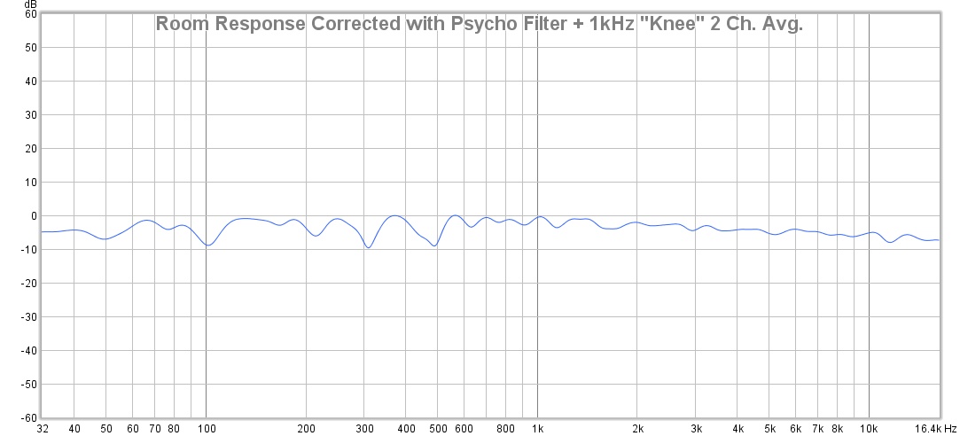

After a few weeks of using a speaker only correction*, I revisited the psycho filter. I changed the prefilter script to a straight 4 cycles (EQ portion is still ERB resolution), and I think it works pretty well with a 1kHz "knee" target response (now called knee3.txt). When I get a chance I'll try to post a virtual correction demo. Files are updated in case anyone wants to try it out.

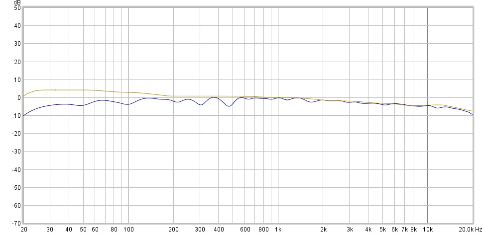

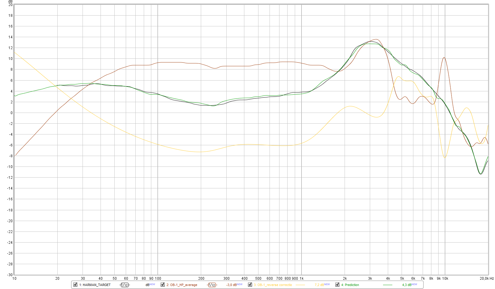

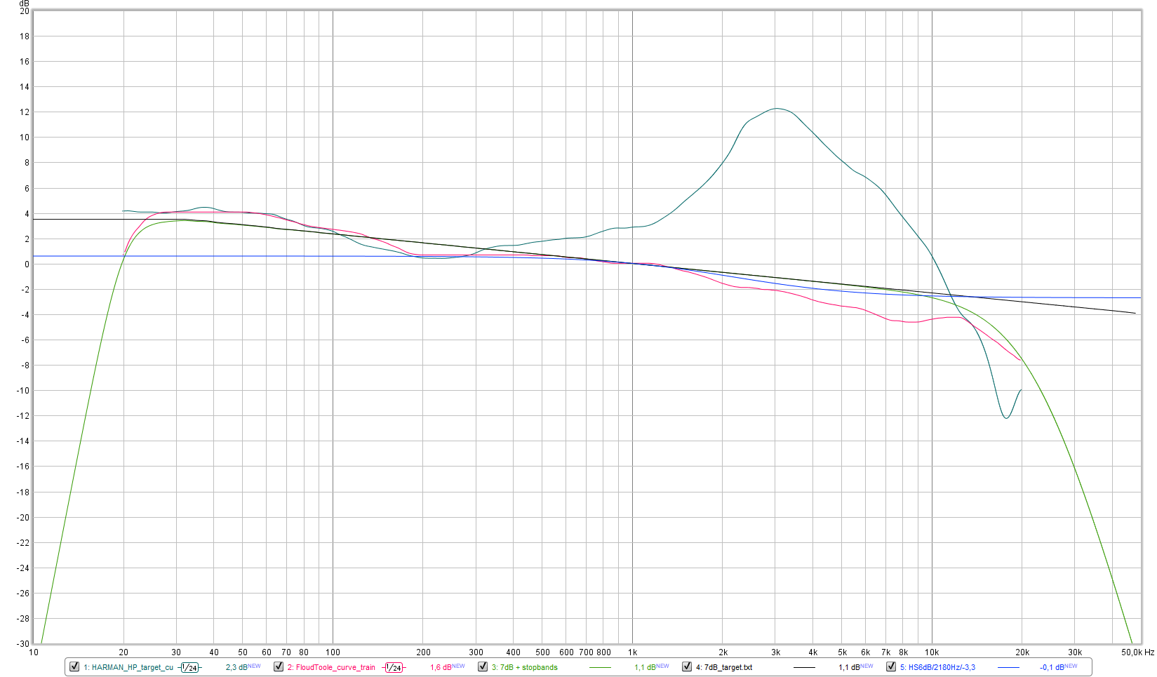

Thanks for EQ curve tip gmad, it looks follow a trend when offset around 1kHz point seen as the blue trace in below plot overlaid with JBL trained listener curve and 7dB targetcurve with and without stopbands and the funny peaking one is head phone curve from Harman group that transfer the trained listener curve in a good room to head phones on our ear canals, tell if you want a copy shared of any of those curves.

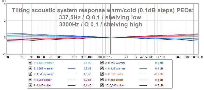

Second graph below is a homemade tilting EQ around 1kHz point using only 2 filters that think is good as a subjective last step of small tweaking.

For Harman headphone and JBL speaker curve have only as frd response files without extracted phase in they simply rough traced from pdf documents and smoothed 1/24, and it haven't bothered me to extract phase because i use them only to divide with measured response so one get a difference response that when EQed flat in Rephase will output either a convolution correction file or tell what PEQa to set in DSP for that difference correction. By the way used that HARMAN HP curve to kind of virtual correct some low cost head phones because i didn't like their natural sound stage, and for my particular head phone system setup it really moved mountains and now classify as one of the best cans i heard so far, i say virtual correction because in lack of pro lab gear to measure cans can only hope for it ends as predicted, HARMAN curve and a five point measurement from which took the average were borrowed for diy fiddle at innerfidelity.com, you can see predicted process for those Status Audio OB-1 cans below and it took 25x IIR PEQs to get there or a convolution file.
The 7dB target file have as Rephase settings file out to MHz so simply load it and add 2nd order natural stop bands at low and high end and export as IR to REW and if needed make it frd/txt file from there. Think its name is bit fun but looking closer there is a little logic for it in its +3,5dB at 30Hz and -3,5dB at 30kHz passing 0dB point exactly at 1kHz.

Thanks for sharing those curves. The attached graph is the JBL curve vs. my 2 ch avg room response with my psycho filter and the Katz 1kHz "knee" (1/24 oct fdw + psychoacoustic smoothing used for graph).
Nice work on that headphone response. That's something I'd like to try as well with my HD580s. My understanding at this point is that the curve with the ~2.7kHz peak is more for earphones while a flatter response is more appropriate for headphones. Let me know if you have any thoughts about that.

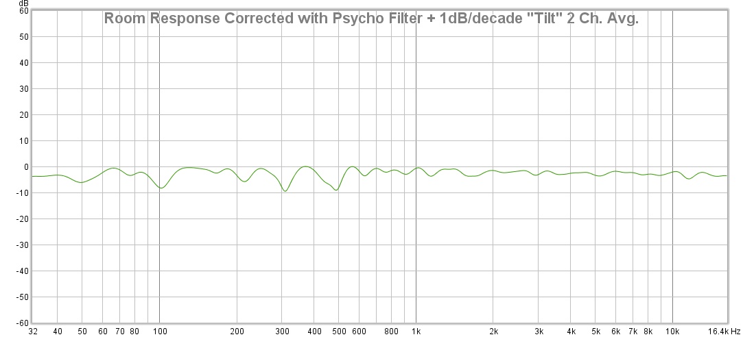

I added another file to the virtual correction demo folder; this one is corrected with a 1dB/decade target response (response graph is attached). For my close (5') listening position, I feel I still need a target closer to flat, and this seems to be working nicely for me right now. I added this new target response file (tilt2.txt) to the main folder.
