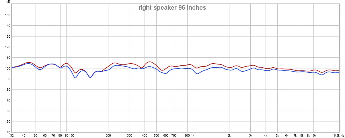

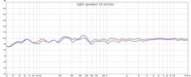

I've been using the term "off-axis" a lot, but maybe to avoid confusion, I should be saying "out of the sweetspot" since the response in different locations likely varies more due to the room than the speaker's polar response.

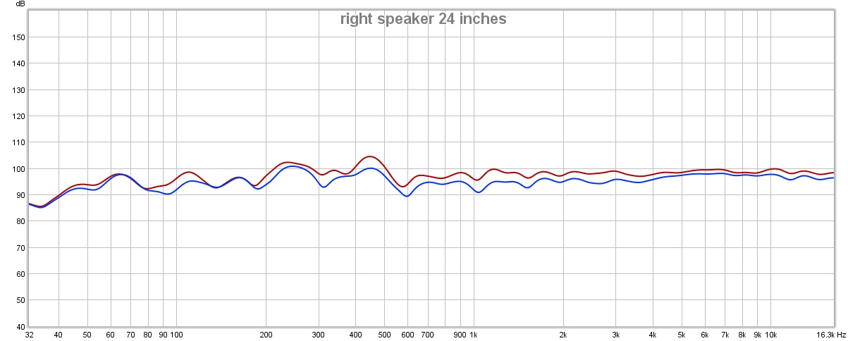

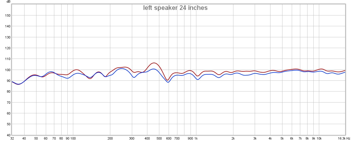

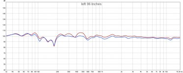

So, here are some comparisons of the two corrected responses with mic distances of 24 and 96 inches (the filter is based on a 60 inch mic distance). These are on-axis measurements, meaning that if we use the original mic location (sweetspot) as a reference, the mic was moved towards or away from each speaker by 36", and still points towards the dust cap. Since my speakers are angled upwards, this means that the height of the mic (floor/ceiling distance) is changing along with the sidewall distance.
Custom corrected response = red, psycho corrected response = blue.

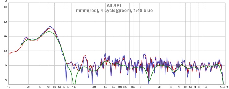

here is a graph to explain my point
attachment.php
red is an MMM response around the mlp, using about 150 averages from a moving mic.
blue is a single point measurement that just happens to look very similar to the mmm measurement
green is the the same as the blue measurement, but this time it has been windowed to 4 cycles.
I dont know how exactly drc fixes the magnitude response but if it is in cycles and we use a 4 cycle filter you can see that it will completely miss many peaks.
example, the peak at 146hz would be missed, 1185hz would be completely missed etc.

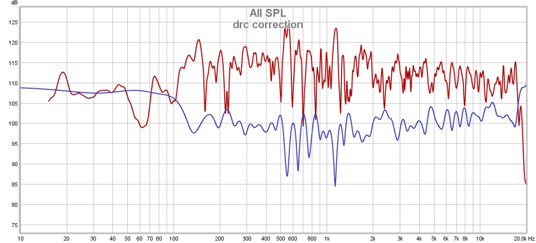

The 4 cycle window of DRC looks far more detailed than the one in REW. I've compared them one on one and REW's version looks like a 1/3 octave smoothed DRC FDW.
Quoting myself again... hmmm
The top graph is DRC doing a 1/3 octave 5 cycle window. (MPPrefilterType = b and MPBandSplit = 3)
Second one is DRC's sliding window (my favourite)
Third graph is REW's 5 cycle window
Fourth graph is DRC's 1/3 octave 5 cycle window we saw, but smoothed 1/6 octave.
In hindsight I see why, knowing the result of the first type of a frequency dependant window that was introduced in REW. Well, this satisfies all of my curiosity.
case closed? 🙂

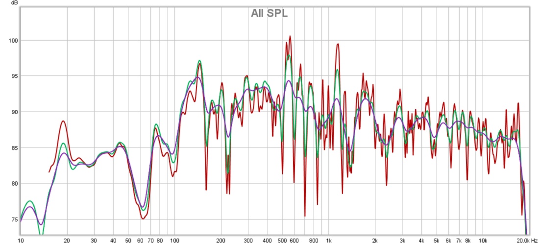

Remove the excess phase from the "blue" measurement (generate minimum phase) and export that impulse response (min phase version). Import the new min phase version and try increasing the FDW size to 8 cycles since REW's FDW is lower resolution than DRC's. They should match more closely now.

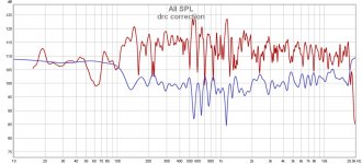

here is the result of that
attachment.php
non windowed, 8 cycles, and 18 cycles.
even 8 cycles of the min phase is still a very rough approximation.
for me, im thinking 20 averages of the listening position, averaged, and then non windowed.
i want to test this. how would I allow DRC to fix the magnitude response almost identically? or lets say an 18 cycle window.
I would be doing this strictly in the magnitude domain, so minimum phase only.
That's a 10 cycle window, Yet way more detailed than what REW would give you.
In this post: http://www.diyaudio.com/forums/multi-way/221434-rephase-loudspeaker-phase-linearization-eq-fir-filtering-tool-194.html#post5053302 John basically said REW mimics the way Acourate's FDW's look. And if one would want more resolution to just increase the number of cycles. But I don't necessarily want to increase the number of cycles (in my situation) because it would also increase the timing gate.
You'd need to almost double cycle count to get the same. That's a pretty long time increase at low frequencies.
In your case... it's an averaged measurement, so no worries.
Maybe you're starting to see what we like about DRC 🙂. You're the one in control of all the knobs too! Somewhere in the first few pages of this thread I mentioned how to extract the frequency dependent window as a wav in DRC. If you're interested. It might come in handy 🙂 (it's just one of those 150 settings)
