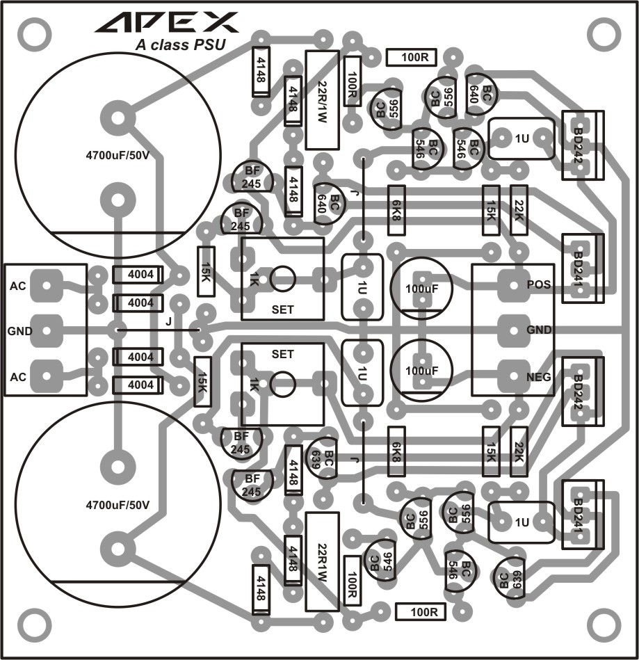

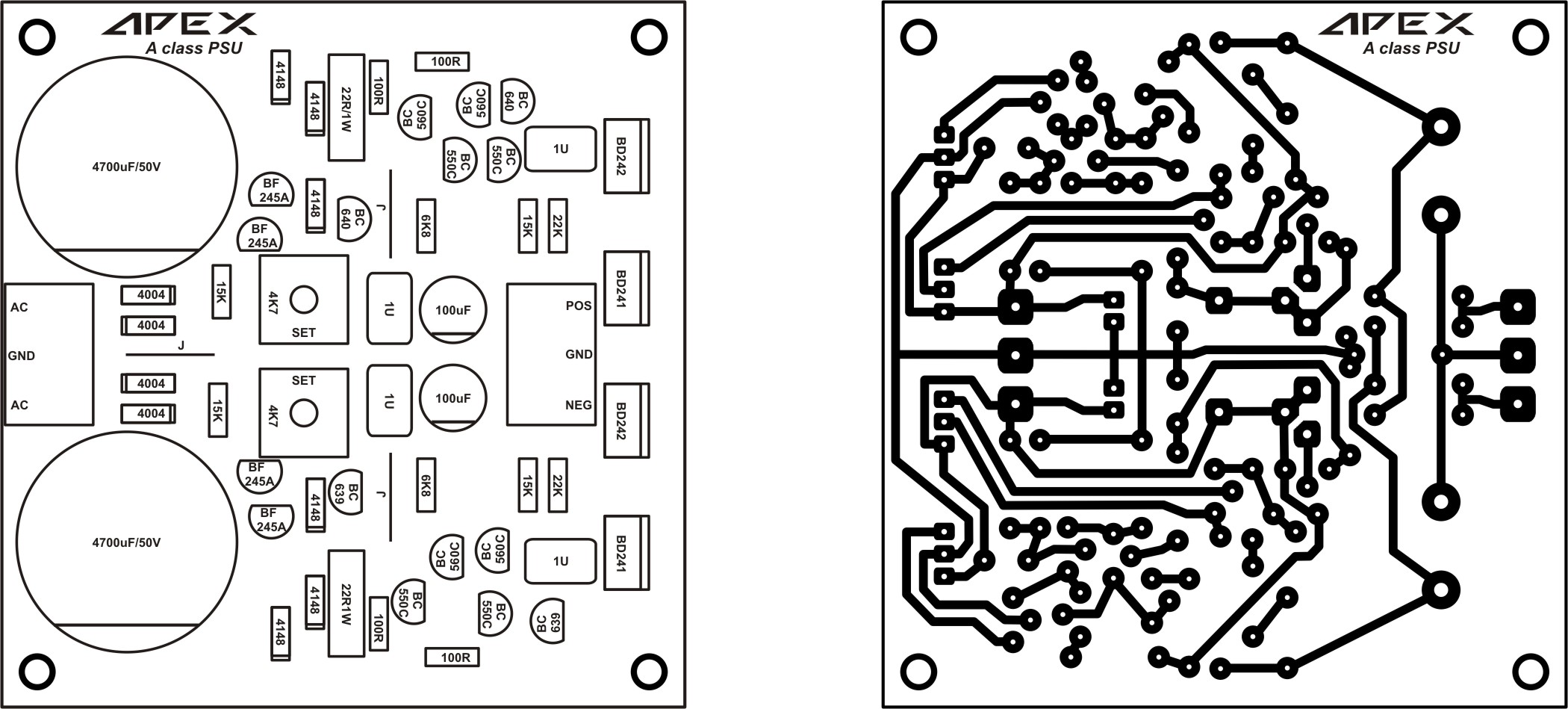

oh ok I see 500mA transformer got it, yes this layout is actually the one that goes with the first post I think I'm gonna make this one but sadly those BF245A are obsolete and hard to find unless a equivalent can change this part number 🙁
this layout goes with this schematic yes
I found this part number BF256B is this one can be use instead of BF245A?

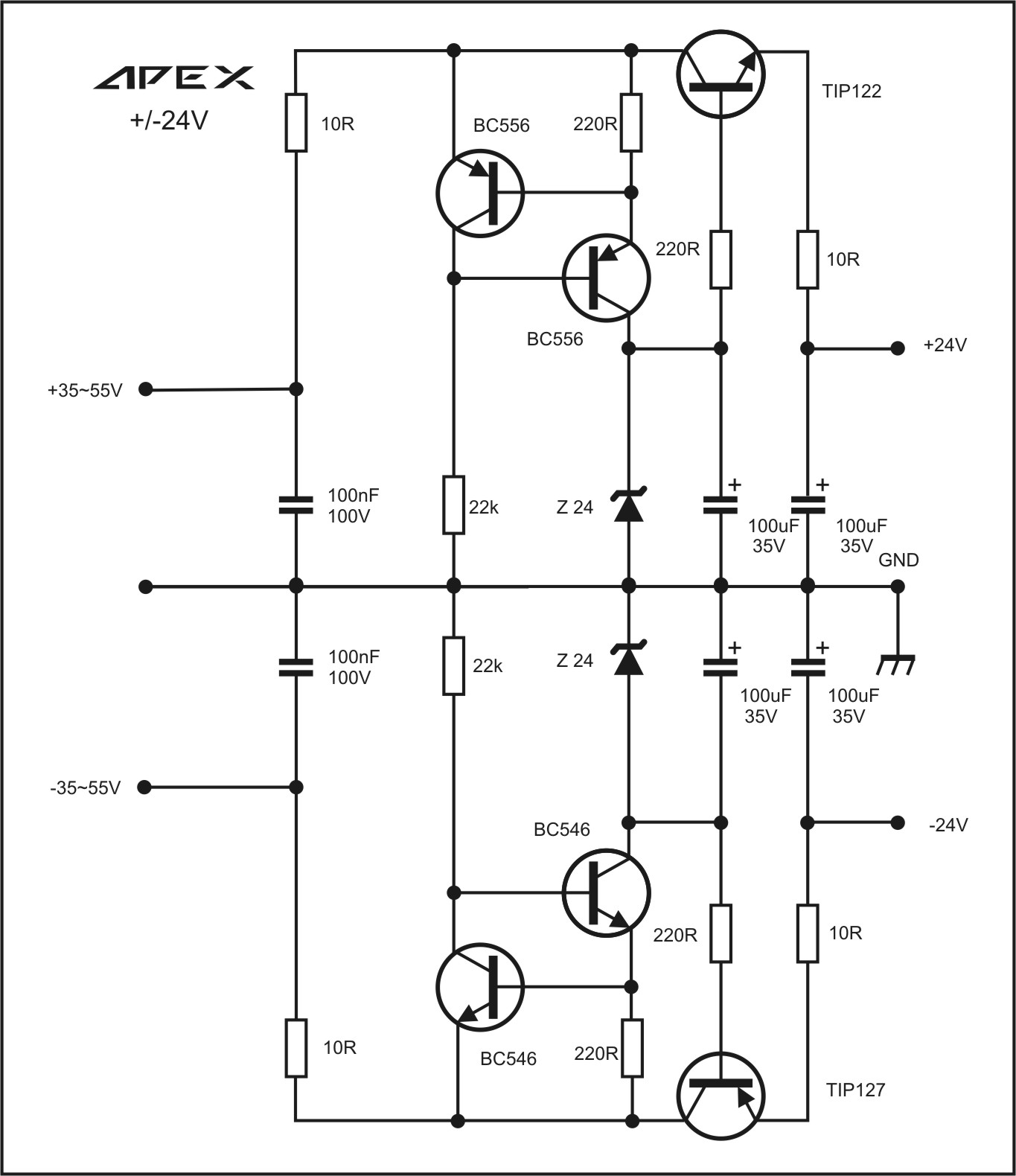

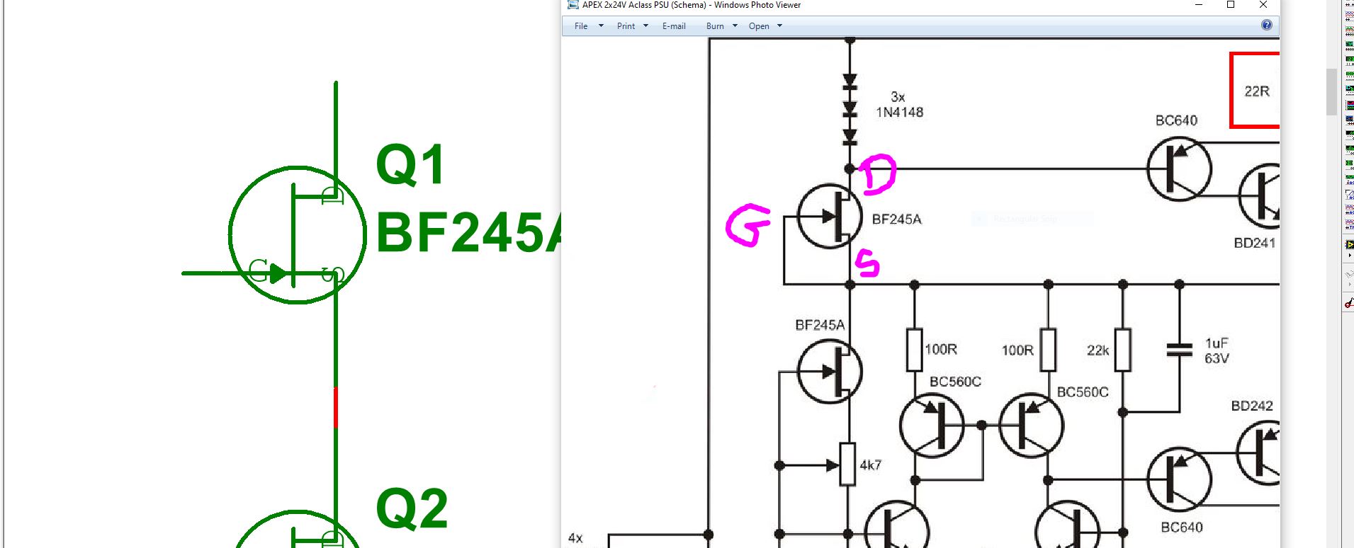

one more thing the original schematic does not show the pins identification I assume that is like this right 😕

Those JFETs are just used as a current source, so you don't need anything exotic, but you do want a similar Idss and low-noise. The BF256B meets the first criteria, but the datasheet makes no mention of noise.
What about a 2n5457?
(Note: you'll need to compare pinouts of any replacements as they aren't all the same.)

oh ok I'm gonna check the 2N5457 and yes I'm aware of pins can be different if I clone this layout and avoid errors
I know Mr. Miles must be occupied I hope he can identified the pins of those BF245A on the schematic so then I can modified the layout to accept ones that are available to purchase

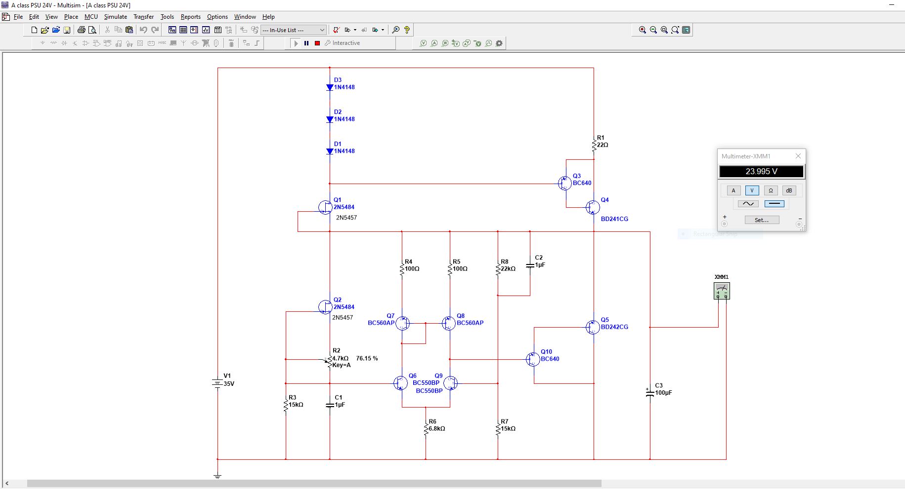

ok last post of the day I was able to simulated so now I know the pins and what they are the 2N5457 is not available on my simulation but I think is ok if 2N5484 have the same pins as the 2N5457 it should be ok thank for the help JeffYoung

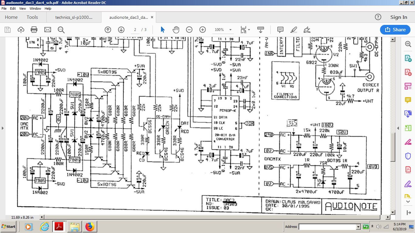

Yeah right...and the first two guys talking there are some of the the most expensive sellers of "high endish" useless toys in the diy world...today, if you have an Audio Precision to back your designs you can tell anything as a rule of thumb, but the rules of thumbs are many!

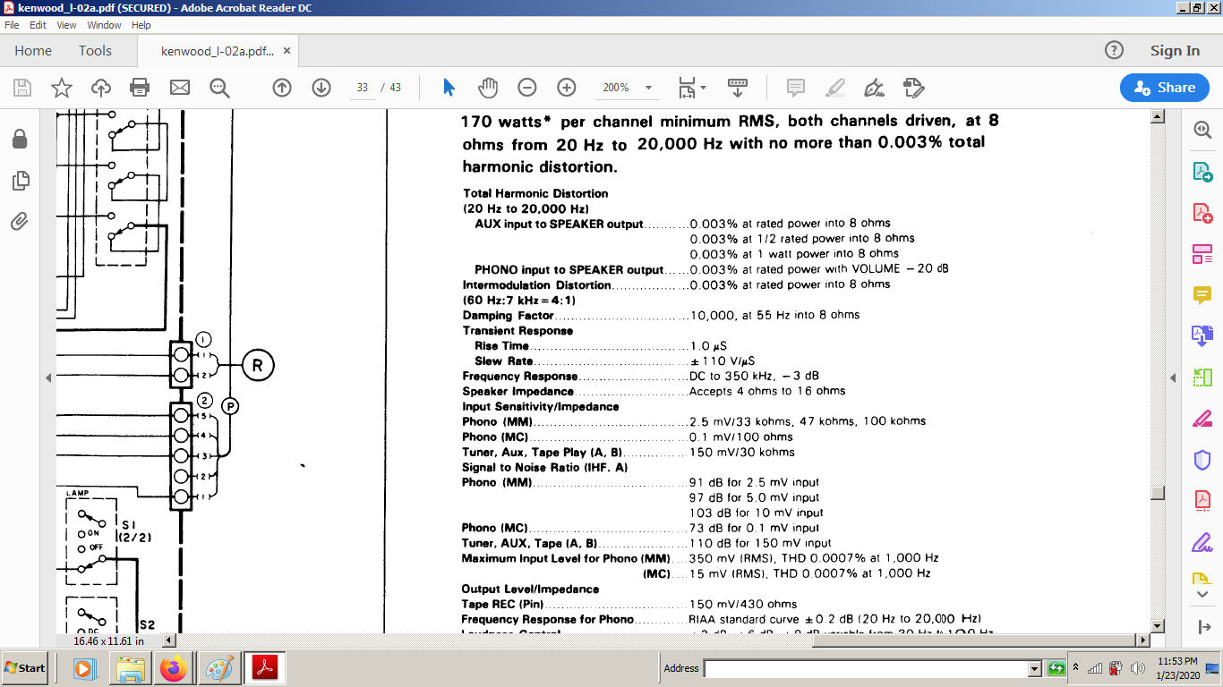

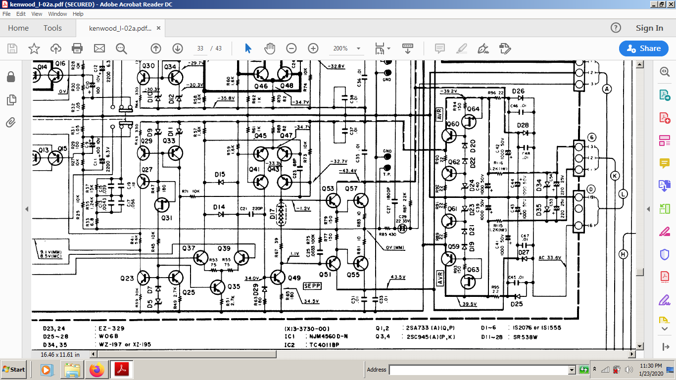

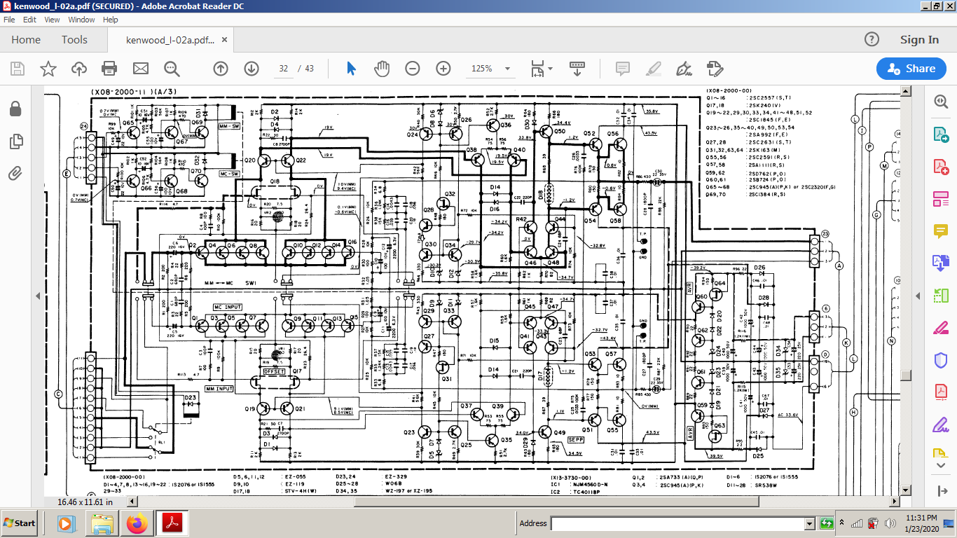

Well I just posted the most advanced phono preamp inside the most advanced integrated receiver ever made commercial by the same team that gave birth to Accuphase(Kenwood+ Kensonic). The input differential section by itself takes 34ma...
I'm talking about this:
Kenwood L-02A on thevintageknob.org
L-02A KENWOOD - HiFi-Do McIntosh/JBL/audio-technica/Jeff Rowland/Accuphase
Yeah, i saw it's full of cascodes with not so great PSRR while placed into a 2x 170w RMS class ab power amp ...
Is it up to you expectation?

Ummm... that Kenwood is using a series regulator, not a c-multiplier.
It's not a differential series regulator with global feedback -- the Kenwood employs only local feedback through emitter degeneration. Is it the differential topology you take issue with?

So it's a very basic one!!!
That was my answer for you ...the previous post had the capacitor multiplier article on ESP site. I can't count the number of low noise preamps supplied by a simple c-multiplier i saw in real life high quality equipment where they measure less than 0.003thd+IMD distortions over the full audio spectrum...
Now you have the most complicated c-multiplier i have ever seen following a faster regulator 🙂
