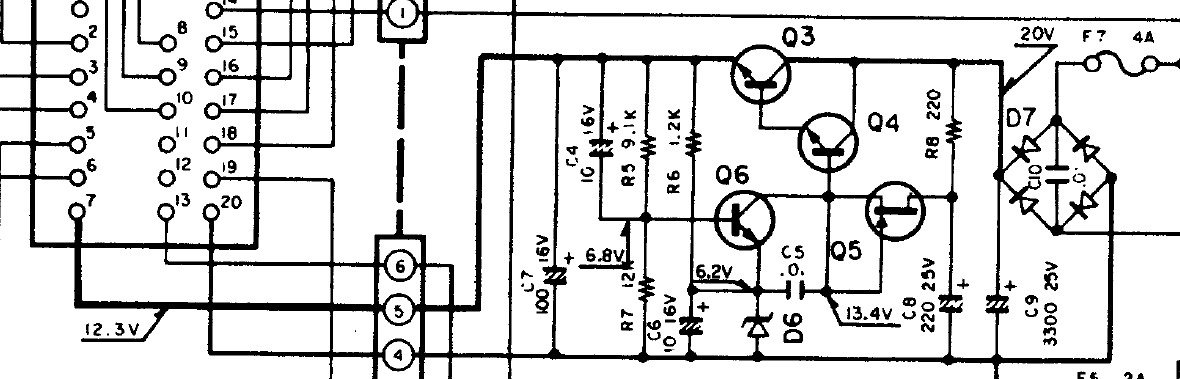

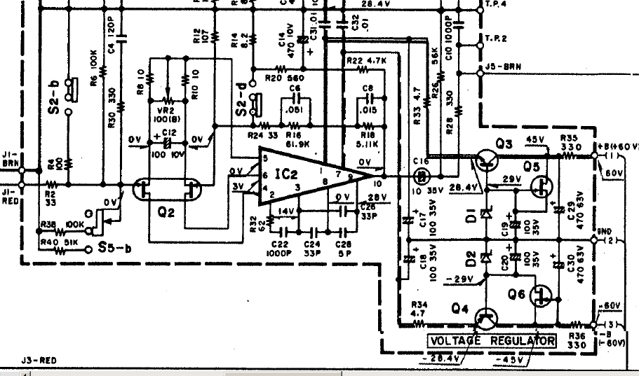

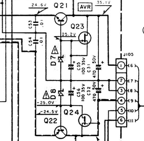

Just 80's "low fi commercial" stuff ...PSU for preamps with Serial Regulator.
Kenwood KA-1000 on thevintageknob.org
Kenwood KA-2200 on thevintageknob.org
Kenwood L-01A on thevintageknob.org
Kenwood L-08C on thevintageknob.org

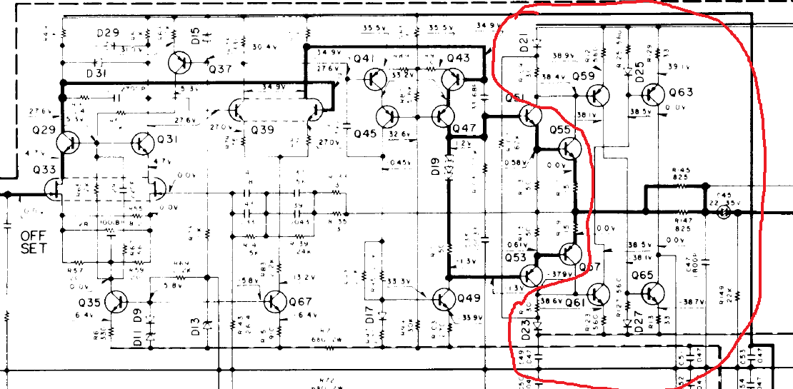

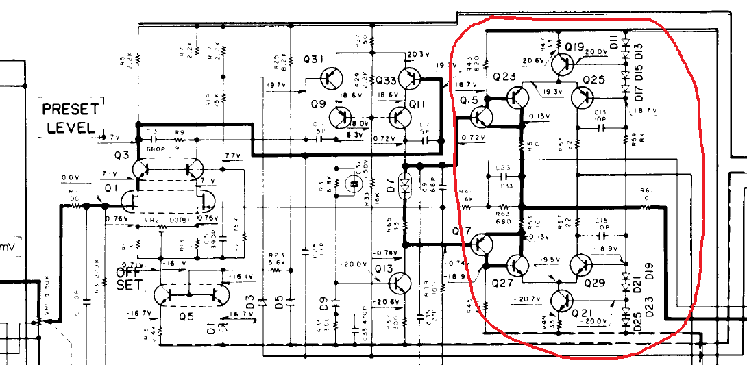

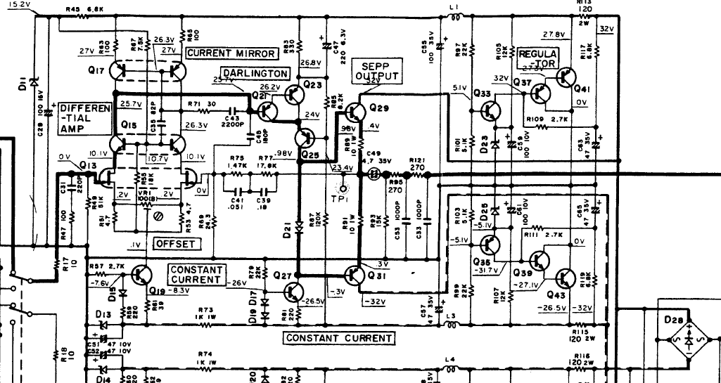

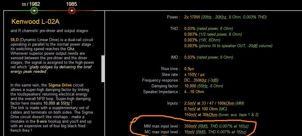

I put all the necessary links:What's that last one? It's the Hitachi topology again, but with Sziklai outputs.

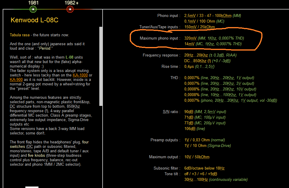

Kenwood l-08c preamp unit. I added the input max headroom printscreen at which it holds 0.007%THD...You find all the manuals on electrotanya and hifiengine.In Romania i can't acces hifiengine...but you can in Ireland.
I am not sure why you constantly would want to post random snippets of,Just 80's "low fi commercial" stuff ...
mainly Japanese, amplifier circuits, here and elsewhere in this forum.
Most of the time these are shown without source or description of their origin.
If it is of any interest everybody will be able to find these schematics themselves.
Where is the relation to the topic of this thread ?
On the other hand, if you want to teach us something, please analyse and
describe the circuits and tell why they may be important to others.
This is a DIY Audio Forum, no commercial schematic collection (I admit I initiated
an Accuphase circuit thread, but strictly for repair purpose). This particular thread
here started as a description of a nice discrete shunt regulator from an acknowledged
master. If you can contribute to that we will love it.
This is not a random schematic peep show - or start your own thread for that.

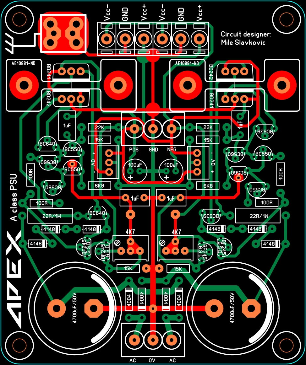

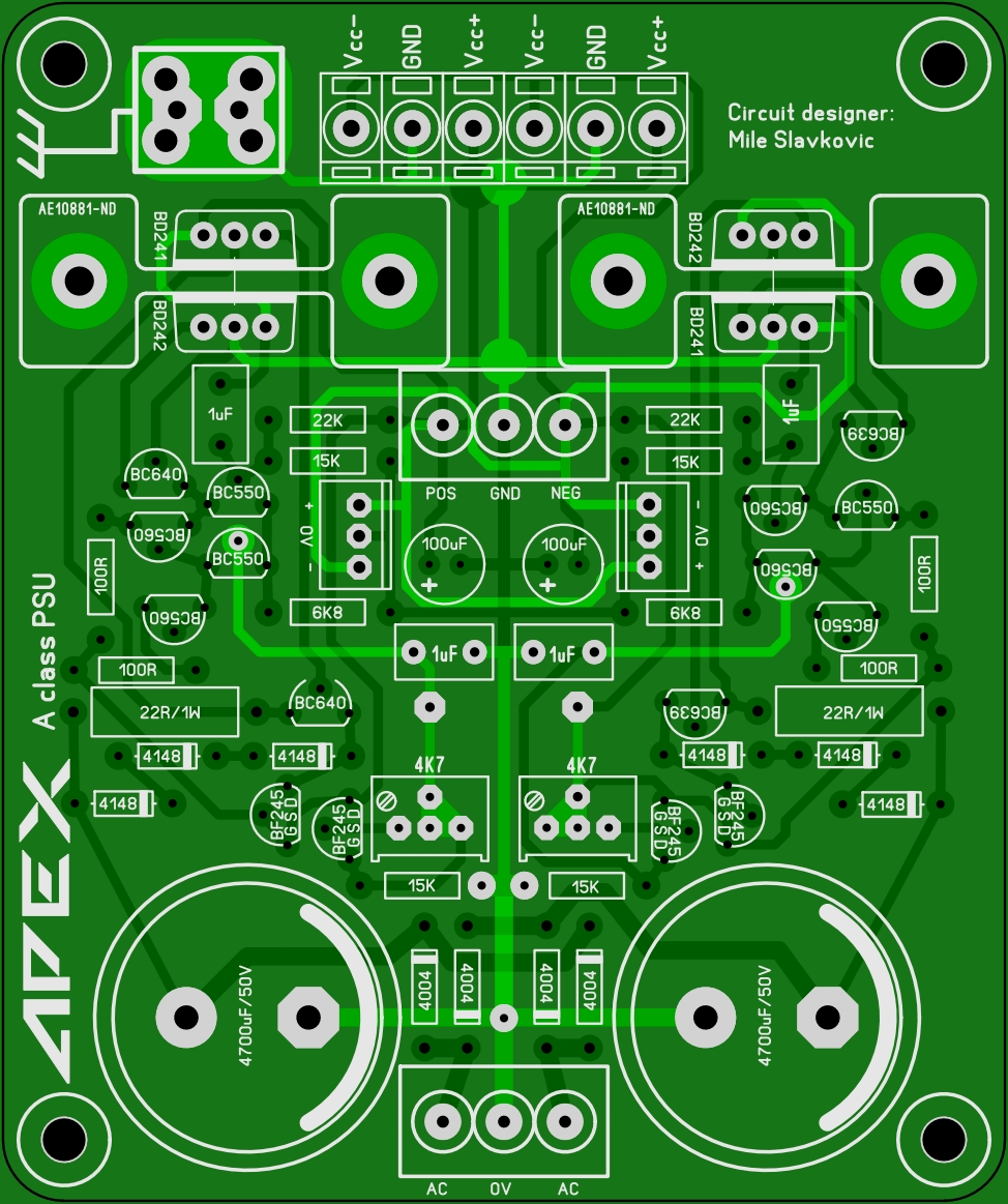

classic layout to a modern one
hi guys I decide to just make the layout same as the original but with more options of connectivity and I re-arrange the transistors to share a heat sink
"yes I know I got the floating GND I will used that thank you"
not many people like to use this time of circuit but I just want to try out here is the layout image

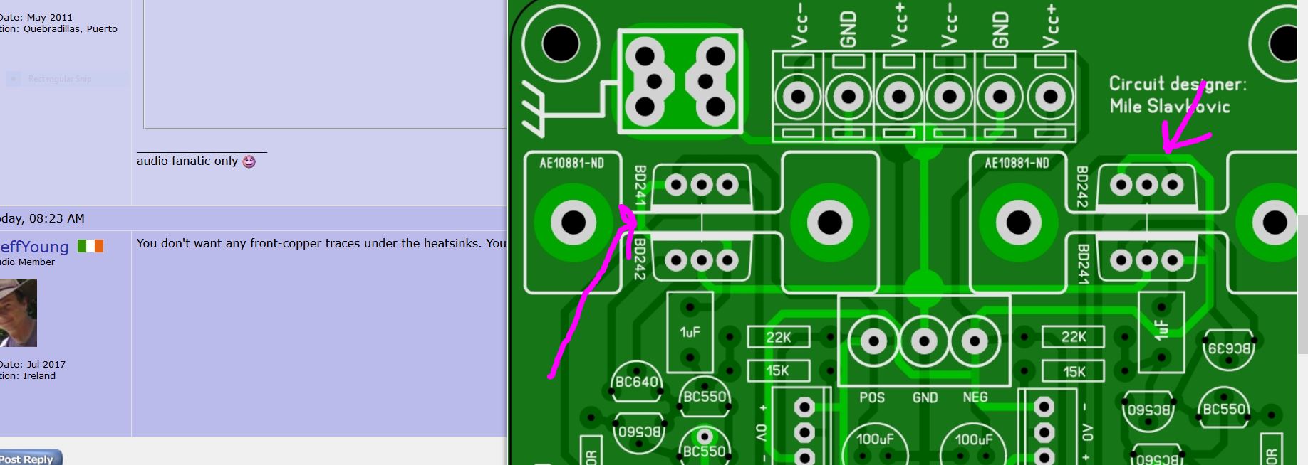

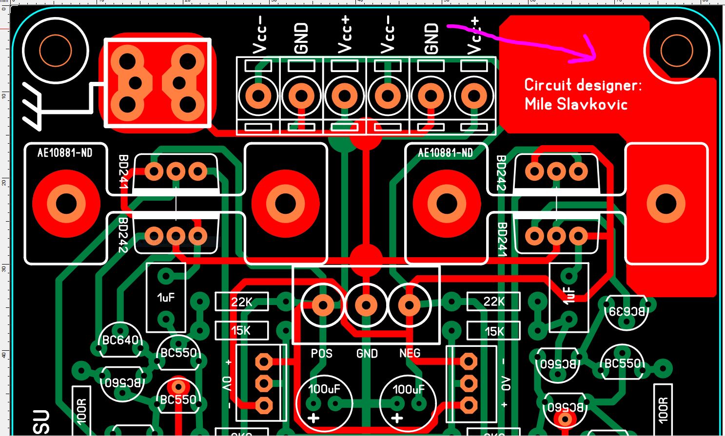

oh I see what you mean yes they are this top copper traces that might be compromise yes, the heatsink is gonna need a separation for the top PCB I guess
the red traces are top copper traces the green ones are bottom copper traces

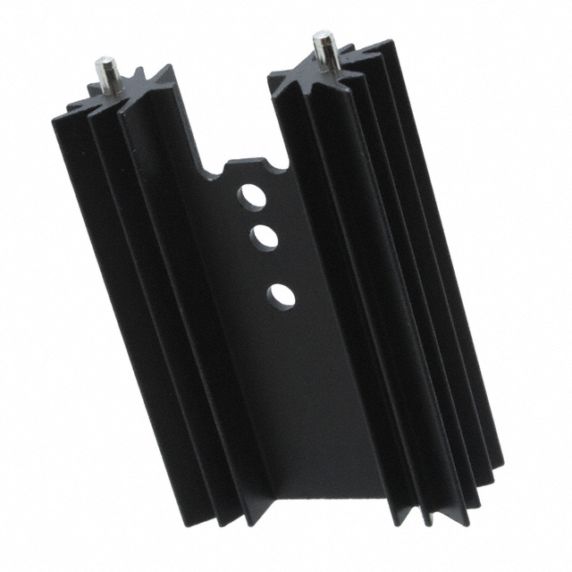

If you insert space between your heatsink and the board then you're relying on the bottom pad (plus whatever small amount of solder wicks to the top) to hold it. That's a pretty tall heatsink for that.
I'd move the top copper traces a little so they aren't under the heatsink, and then mount the heatsink flush to the board.
